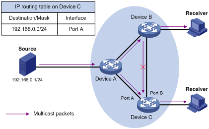

Figure 1 RPF check process
As shown in Figure 1, assume that unicast routes are available on the network, MBGP is not configured, and no static multicast routes have been configured on Device C. Multicast packets travel along the SPT from the multicast source to the receivers. The multicast forwarding table on Device C contains the (S, G) entry, with Port A as the incoming interface.
·          If a multicast packet arrives at Device C on Port A, the receiving interface is the incoming interface of the (S, G) entry. Device C forwards the packet out of all outgoing interfaces.
·          If a multicast packet arrives at Device C on Port B, the receiving interface is not the incoming interface of the (S, G) entry. Device C searches its unicast routing table and finds that the outgoing interface to the source (the RPF interface) is Port A. In this case, the (S, G) entry is correct, but the packet traveled along a wrong path. The packet fails the RPF check and Device C discards the packet.

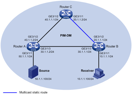

A static multicast route can change an RPF route or create an RPF route.

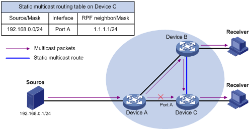

Changing an RPF route
Typically, the topology structure of a multicast network is the same as that of a unicast network, and multicast traffic follows the same transmission path as unicast traffic does. You can configure a static multicast route for a multicast source to change the RPF route. As a result, the device creates a transmission path for multicast traffic that is different from the transmission path for unicast traffic.
Figure 2 Changing an RPF route
As shown in Figure 2, when no static multicast route is configured, Device C's RPF neighbor on the path back to the source is Device A. The multicast data from the source travels through Device A to Device C. You can configure a static multicast route on Device C and specify Device B as Device C's RPF neighbor on the path back to the source. The multicast data from the source travels along the path: Device A to Device B and then to Device C.

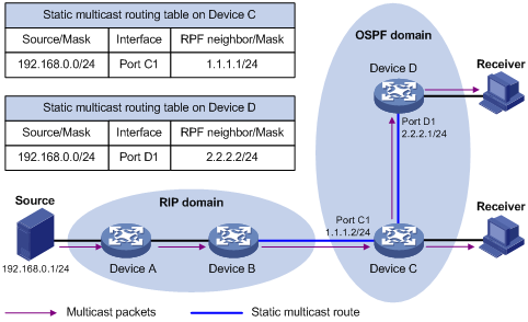

Creating an RPF route
When a unicast route is blocked, multicast forwarding might be stopped due to lack of an RPF route. You can configure a static multicast route to create an RPF route. In this way, a multicast routing entry is created to guide multicast forwarding.
Figure 3 Creating an RPF route
As shown in Figure 3, the RIP domain and the OSPF domain are unicast isolated from each other. For the receiver hosts in the OSPF domain to receive multicast packets from the multicast source in the RIP domain, you must configure Device C and Device D as follows:
·          On Device C, configure a static multicast route for the multicast source and specify Device B as the RPF neighbor.
·          On Device D, configure a static multicast route for the multicast source and specify Device C as the RPF neighbor.

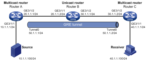

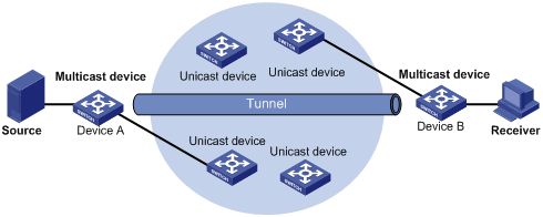

Multicast forwarding across unicast subnets
Multicast data transmission over a 6to4 or ISATAP tunnel is not supported in the current software version.
Devices forward the multicast data from a multicast source hop by hop along the forwarding tree, but some devices might not support multicast protocols in a network. When the multicast data is forwarded to a device that does not support IP multicast, the forwarding path is blocked. In this case, you can enable multicast forwarding across two unicast subnets by establishing a tunnel between the devices at the edges of the two unicast subnets.
Figure 4 Multicast data transmission through a tunnel
As shown in Figure 4, a tunnel is established between Device A and Device B. Device A encapsulates the multicast data in unicast IP packets, and forwards them to Device B across the tunnel through unicast devices. Then, Device B strips off the unicast IP header and continues to forward the multicast data to the receiver.
To use this tunnel only for multicast traffic, configure the tunnel as the outgoing interface only for multicast routes.

Example: Changing an RPF route
As shown in Figure 5:
·          PIM-DM runs on the network.
·          All routers on the network support multicast.
·          Router A, Router B, and Router C run OSPF.
·          Typically, the receiver host can receive the multicast data from the source through the path: Router A to Router B, which is the same as the unicast route.
Configure the routers so that the multicast data from the source travels to the receiver along the following path: Router A to Router C to Router B. This path is different from the unicast route.
Figure 5 Network diagram
1.        Assign an IP address and subnet mask for each interface, as shown in Figure 5. (Details not shown.)
2.        Configure OSPF on the routers in the PIM-DM domain. (Details not shown.)
3.        Enable IP multicast routing, and enable IGMP and PIM-DM:
# On Router B, enable IP multicast routing.
<RouterB> system-view
[RouterB] multicast routing
[RouterB-mrib] quit
# Enable IGMP on the receiver-side interface GigabitEthernet 3/1/1.
[RouterB] interface gigabitethernet 3/1/1
[RouterB-GigabitEthernet3/1/1] igmp enable
[RouterB-GigabitEthernet3/1/1] quit
# Enable PIM-DM on the other interfaces.
[RouterB] interface gigabitethernet 3/1/2
[RouterB-GigabitEthernet3/1/2] pim dm
[RouterB-GigabitEthernet3/1/2] quit
[RouterB] interface gigabitethernet 3/1/3
[RouterB-GigabitEthernet3/1/3] pim dm
[RouterB-GigabitEthernet3/1/3] quit
# On Router A, enable IP multicast routing.
<RouterA> system-view
[RouterA] multicast routing
[RouterA-mrib] quit
# Enable PIM-DM on each interface.
[RouterA] interface gigabitethernet 3/1/1
[RouterA-GigabitEthernet3/1/1] pim dm
[RouterA-GigabitEthernet3/1/1] quit
[RouterA] interface gigabitethernet 3/1/2
[RouterA-GigabitEthernet3/1/2] pim dm
[RouterA-GigabitEthernet3/1/2] quit
[RouterA] interface gigabitethernet 3/1/3
[RouterA-GigabitEthernet3/1/3] pim dm
[RouterA-GigabitEthernet3/1/3] quit
# Enable IP multicast routing and PIM-DM on Router C in the same way Router A is configured. (Details not shown.)
4.        Display RPF information for the source on Router B.
[RouterB] display multicast rpf-info 50.1.1.100
 RPF information about source 50.1.1.100:
     RPF interface: GigabitEthernet3/1/3, RPF neighbor: 30.1.1.2
     Referenced route/mask: 50.1.1.0/24
     Referenced route type: igp
     Route selection rule: preference-preferred
     Load splitting rule: disable
     Source AS: 0
     C-multicast route target: 0x0000000000000000
The output shows that the current RPF route on Router B is contributed by a unicast routing protocol and the RPF neighbor is Router A.
5.        On Router B, configure a static multicast route to the source and specify Router C as the RPF neighbor.
[RouterB] ip rpf-route-static 50.1.1.0 24 20.1.1.2
# Display RPF information for the source on Router B.
     RPF interface: GigabitEthernet3/1/2, RPF neighbor: 20.1.1.2
     Referenced route type: multicast static
     Source AS: 0
The output shows the following information:
·          The RPF route on Router B is the configured static multicast route.
·          The RPF neighbor of Router B is Router C.

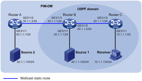

Example: Creating an RPF route
As shown in Figure 6:
·          All routers on the network support IP multicast.
·          Router B and Router C run OSPF, and have no unicast routes to Router A.
·          Typically, the receiver host receives the multicast data from the source 1 in the OSPF domain.
Configure the routers so that the receiver host can receive multicast data from Source 2, which is outside the OSPF domain.
Figure 6 Network diagram
1.        Assign an IP address and subnet mask for each interface, as shown in Figure 6. (Details not shown.)
2.        Configure OSPF on Router B and Router C. (Details not shown.)
# On Router C, enable IP multicast routing.
<RouterC> system-view
[RouterC] multicast routing
[RouterC-mrib] quit
[RouterC] interface gigabitethernet 3/1/1
[RouterC-GigabitEthernet3/1/1] igmp enable
[RouterC-GigabitEthernet3/1/1] quit
# Enable PIM-DM on GigabitEthernet 3/1/2.
[RouterC] interface gigabitethernet 3/1/2
[RouterC-GigabitEthernet3/1/2] pim dm
[RouterC-GigabitEthernet3/1/2] quit
[RouterA-mrib] quit
# Enable IP multicast routing and PIM-DM on Router B in the same way Router A is configured. (Details not shown.)
4.        Display RPF information for Source 2 on Router B and Router C.
[RouterC] display multicast rpf-info 50.1.1.100
No output is displayed because no RPF routes to Source 2 exist on Router B and Router C.
5.        Configure a static multicast route:
# Configure a static multicast route on Router B and specify Router A as its RPF neighbor to Source 2.
[RouterB] ip rpf-route-static 50.1.1.0 24 30.1.1.2
# Configure a static multicast route on Router C and specify Router B as its RPF neighbor to Source 2.
[RouterC] ip rpf-route-static 50.1.1.0 24 20.1.1.2
# Display RPF information for Source 2 on Router B.
     Source AS: 0
# Display RPF information for Source 2 on Router C.
     Source AS: 0
The output shows that the RPF routes to Source 2 exist on Router B and Router C. These RPF routes are the configured static multicast routes.
Example: Configuring multicast forwarding over a GRE tunnel
As shown in Figure 7:
·          Multicast routing and PIM-DM are enabled on Router A and Router C. Router B does not support multicast.
·          Router A, Router B, and Router C run OSPF. The source-side interface GigabitEthernet 3/1/1 on Router A does not run OSPF.
Configure a GRE tunnel so that the receiver host can receive the multicast data from the source.
Figure 7 Network diagram
1.        Assign an IP address and mask for each interface, as shown in Figure 7. (Details not shown.)
2.        Configure OSPF on all the routers. Do not enable OSPF on GigabitEthernet 3/1/1 on Router A. (Details not shown.)
3.        Configure a GRE tunnel:
# Create a GRE tunnel interface Tunnel 2 on Router A, and specify the tunnel mode as GRE/IPv4.
[RouterA] interface tunnel 2 mode gre
# Assign an IP address to interface Tunnel 2, and specify its source and destination addresses.
[RouterA-Tunnel2] ip address 50.1.1.1 24
[RouterA-Tunnel2] source 20.1.1.1
[RouterA-Tunnel2] destination 30.1.1.2
[RouterA-Tunnel2] quit
# Create a GRE tunnel interface Tunnel 2 on Router C, and specify the tunnel mode as GRE/IPv4.
[RouterC] interface tunnel 2 mode gre
[RouterC-Tunnel2] ip address 50.1.1.2 24
[RouterC-Tunnel2] source 30.1.1.2
[RouterC-Tunnel2] destination 20.1.1.1
[RouterC-Tunnel2] quit
4.        Enable IP multicast routing, PIM-DM, and IGMP:
[RouterA-mrib] quit
[RouterA-Tunnel2] pim dm
[RouterC-mrib] quit
# Enable PIM-DM on other interfaces.
[RouterC-Tunnel2] pim dm
5.        On Router C, configure a static multicast route to the source and specify Router A as the RPF neighbor.
[RouterC] ip rpf-route-static 10.1.1.0 24 50.1.1.1
# Send an IGMP report from Receiver to join multicast group 225.1.1.1. (Details not shown.)
# Send multicast data from the source to multicast group 225.1.1.1. (Details not shown.)
# Display PIM routing entries on Router C.
[RouterC] display pim routing-table
 Total 1 (*, G) entry; 1 (S, G) entry
 (*, 225.1.1.1)
     Protocol: pim-dm, Flag: WC
     UpTime: 00:04:25
     Upstream interface: NULL
         Upstream neighbor: NULL
         RPF prime neighbor: NULL
     Downstream interface(s) information:
     Total number of downstreams: 1
         1: GigabitEthernet3/1/1
             Protocol: igmp, UpTime: 00:04:25, Expires: -
 (10.1.1.100, 225.1.1.1)
     Protocol: pim-dm, Flag: ACT
     UpTime: 00:06:14
     Upstream interface: Tunnel2
         Upstream neighbor: 50.1.1.1
         RPF prime neighbor: 50.1.1.1
             Protocol: pim-dm, UpTime: 00:04:25, Expires: -
The output shows that Router A is the RPF neighbor of Router C and the multicast data from Router A is delivered over the GRE tunnel to Router C.
