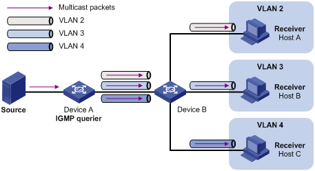

As shown in Figure 1, Host A, Host B, and Host C are in three different VLANs and the same multicast group. When Device A (Layer 3 device) receives multicast data for that group, it sends three copies of the multicast data to Device B (Layer 2 device). This occupies a large amount of bandwidth and increases the burden on the Layer 3 device.
Figure 1 Multicast transmission without the multicast VLAN feature
After a multicast VLAN is configured on Device B, Device A sends only one copy of the multicast data to the multicast VLAN on Device B. This method saves network bandwidth and lessens the burden on the Layer 3 device.

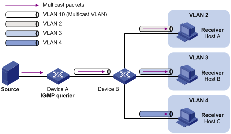

Sub-VLAN-based multicast VLAN
As shown in Figure 2:
·          Host A, Host B, and Host C are in VLAN 2 through VLAN 4, respectively.
·          On Device B, VLAN 10 is a multicast VLAN. VLAN 2 through VLAN 4 are sub-VLANs of VLAN 10.
·          IGMP snooping is enabled for the multicast VLAN and its sub-VLANs.
Figure 2 Sub-VLAN-based multicast VLAN
IGMP snooping manages router ports in the multicast VLAN and member ports in each sub-VLAN. When Device A receives multicast data from the multicast source, it sends only one copy of the multicast data to the multicast VLAN on Device B. Then, Device B sends a separate copy to each sub-VLAN in the multicast VLAN.

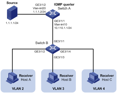

As shown in Figure 3:
·          Layer 3 device Device A runs IGMPv2 and acts as the IGMP querier. Layer 2 device Device B runs IGMPv2 snooping.
·          The multicast source sends multicast data to multicast group 224.1.1.1. Receivers Host A, Host B, and Host C belong to VLAN 2, VLAN 3, and VLAN 4, respectively.
Configure a sub-VLAN-based multicast VLAN on Device B to meet the following requirements:
·          Device A sends the multicast data to Device B through the multicast VLAN.
·          Device B forwards the multicast data to the receivers in different user VLANs.
Figure 3 Network diagram

# Configure VLAN 10 as a multicast VLAN, and assign VLAN 2 through VLAN 4 as sub-VLANs to multicast VLAN 10.
[DeviceB] multicast-vlan 10
[DeviceB-mvlan-10] subvlan 2 to 4
[DeviceB-mvlan-10] quit
# Display information about all multicast VLANs on Device B.
[DeviceB] display multicast-vlan
Total 1 multicast VLANs.
Multicast VLAN 10:
  Sub-VLAN list(3 in total):
     2-4
# Display information about multicast groups in multicast VLANs on Device B.
[DeviceB] display multicast-vlan group
Total 1 entries.
Multicast VLAN 10: Total 1 entries.
  (0.0.0.0, 224.1.1.1)
    Sub-VLANs (3 in total):
      VLAN 2
      VLAN 3
      VLAN 4
The output shows that multicast group 224.1.1.1 belongs to multicast VLAN 10. Multicast VLAN 10 contains sub-VLANs VLAN 2 through VLAN 4. Device B will replicate the multicast data of VLAN 10 to VLAN 2 through VLAN 4.
