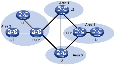

Figure 2 shows one IS-IS network topology. Area 1 is the backbone that comprises a set of Level-2 routers. The other four areas are non-backbone areas connected to the backbone through Level-1-2 routers.
Figure 2 IS-IS topology 1

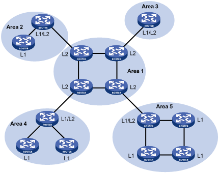

Figure 3 shows another IS-IS topology. No area is defined as the backbone in this topology. The backbone comprises all contiguous Level-2 and Level-1-2 routers in different areas. The IS-IS backbone does not need to be a specific area.
Figure 3 IS-IS topology 2
Both the Level-1 and Level-2 routers use the SPF algorithm to generate the shortest path tree.

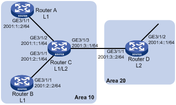

Configuring IPv6 IS-IS MTR
About IPv6 IS-IS MTR
On a network, IPv4 and IPv6 topologies must be consistent so that both IPv6 IS-IS and IPv4 IS-IS can use the SPF algorithm to perform route calculation. If they are different, routers supporting both IPv4 and IPv6 might send IPv6 packets to routers that do not support IPv6, resulting in packet loss.
To resolve this issue, configure IPv6 IS-IS MTR to perform route calculation separately in IPv4 and IPv6 topologies.
Figure 7 Network diagram
As shown in Figure 7, the numbers refer to the link costs. Router A, Router B, and Router D support both IPv4 and IPv6. Router C supports only IPv4 and cannot forward IPv6 packets.
Enable IPv6 IS-IS MTR on Router A, Router B, Router C, and Router D to make them perform route calculation separately in IPv4 and IPv6 topologies. With this configuration, Router A does not forward IPv6 packets destined to Router D through Router B, avoiding packet loss.
As a best practice to avoid route calculation failures, configure this feature when both IPv4 and IPv6 topologies exist in the network.

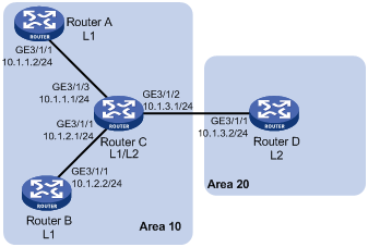

IS-IS configuration examples

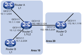

Example: Configuring basic IS-IS
As shown in Figure 10, Router A, Router B, Router C, and Router D reside in an AS.
Router A and Router B are Level-1 routers, Router D is a Level-2 router, and Router C is a Level-1-2 router connecting two areas. Router A, Router B, and Router C are in area 10, and Router D is in area 20.
Figure 10 Network diagram
1.        Configure IP addresses for interfaces. (Details not shown.)
2.        Configure IS-IS:
# Configure Router A
<RouterA> system-view
[RouterA] isis 1
[RouterA-isis-1] is-level level-1
[RouterA-isis-1] network-entity 10.0000.0000.0001.00
[RouterA-isis-1] quit
[RouterA] interface gigabitethernet 3/1/1
[RouterA-GigabitEthernet3/1/1] isis enable 1
[RouterA-GigabitEthernet3/1/1] quit
# Configure Router B.
<RouterB> system-view
[RouterB] isis 1
[RouterB-isis-1] is-level level-1
[RouterB-isis-1] network-entity 10.0000.0000.0002.00
[RouterB-isis-1] quit
[RouterB] interface gigabitethernet 3/1/1
[RouterB-GigabitEthernet3/1/1] isis enable 1
[RouterB-GigabitEthernet3/1/1] quit
# Configure Router C.
<RouterC> system-view
[RouterC] isis 1
[RouterC-isis-1] network-entity 10.0000.0000.0003.00
[RouterC-isis-1] quit
[RouterC] interface gigabitethernet 3/1/3
[RouterC-GigabitEthernet3/1/3] isis enable 1
[RouterC-GigabitEthernet3/1/3] quit
[RouterC] interface gigabitethernet 3/1/1
[RouterC-GigabitEthernet3/1/1] isis enable 1
[RouterC-GigabitEthernet3/1/1] quit
[RouterC] interface gigabitethernet 3/1/2
[RouterC-GigabitEthernet3/1/2] isis enable 1
[RouterC-GigabitEthernet3/1/2] quit
# Configure Router D
<RouterD> system-view
[RouterD] isis 1
[RouterD-isis-1] is-level level-2
[RouterD-isis-1] network-entity 20.0000.0000.0004.00
[RouterD-isis-1] quit
[RouterD] interface gigabitethernet 3/1/1
[RouterD-GigabitEthernet3/1/1] isis enable 1
[RouterD-GigabitEthernet3/1/1] quit
[RouterD] interface gigabitethernet 3/1/2
[RouterD-GigabitEthernet3/1/2] isis enable 1
[RouterD-GigabitEthernet3/1/2] quit
# Display the IS-IS LSDB information.
[RouterA] display isis lsdb
                        Database information for ISIS(1)
                          Level-1 Link State Database
LSPID                 Seq Num      Checksum      Holdtime      Length  ATT/P/OL
0000.0000.0001.00-00* 0x00000004   0xdf5e        1096          68      0/0/0
0000.0000.0002.00-00  0x00000004   0xee4d        1102          68      0/0/0
0000.0000.0002.01-00  0x00000001   0xdaaf        1102          55      0/0/0
0000.0000.0003.00-00  0x00000009   0xcaa3        1161          111     1/0/0
0000.0000.0003.01-00  0x00000001   0xadda        1112          55      0/0/0
    *-Self LSP, +-Self LSP(Extended), ATT-Attached, P-Partition, OL-Overload
[RouterB] display isis lsdb
0000.0000.0001.00-00  0x00000006   0xdb60        988           68      0/0/0
0000.0000.0002.00-00* 0x00000008   0xe651        1189          68      0/0/0
0000.0000.0002.01-00* 0x00000005   0xd2b3        1188          55      0/0/0
0000.0000.0003.00-00  0x00000014   0x194a        1190          111     1/0/0
0000.0000.0003.01-00  0x00000002   0xabdb        995           55      0/0/0
[RouterC] display isis lsdb
0000.0000.0001.00-00  0x00000006   0xdb60        847           68      0/0/0
0000.0000.0002.00-00  0x00000008   0xe651        1053          68      0/0/0
0000.0000.0002.01-00  0x00000005   0xd2b3        1052          55      0/0/0
0000.0000.0003.00-00* 0x00000014   0x194a        1051          111     1/0/0
0000.0000.0003.01-00* 0x00000002   0xabdb        854           55      0/0/0
                          Level-2 Link State Database
0000.0000.0003.00-00* 0x00000012   0xc93c        842           100     0/0/0
0000.0000.0004.00-00  0x00000026   0x331         1173          84      0/0/0
0000.0000.0004.01-00  0x00000001   0xee95        668           55      0/0/0
[RouterD] display isis lsdb
0000.0000.0003.00-00  0x00000013   0xc73d        1003          100     0/0/0
0000.0000.0004.00-00* 0x0000003c   0xd647        1194          84      0/0/0
0000.0000.0004.01-00* 0x00000002   0xec96        1007          55      0/0/0
# Display the IS-IS routing information on each router.
[RouterA] display isis route
                         Route information for IS-IS(1)
                         Level-1 IPv4 Forwarding Table
 IPv4 Destination     IntCost    ExtCost ExitInterface   NextHop         Flags
 10.1.1.0/24          10         NULL    GE3/1/1         Direct          D/L/-
 10.1.2.0/24          20         NULL    GE3/1/1         10.1.1.1        R/-/-
 192.168.0.0/24       20         NULL    GE3/1/1         10.1.1.1        R/-/-
 0.0.0.0/0            10         NULL    GE3/1/1         10.1.1.1        R/-/-
      Flags: D-Direct, R-Added to Rib, L-Advertised in LSPs, U-Up/Down Bit Set
[RouterC] display isis route
 10.1.2.0/24          10         NULL    GE3/1/3         Direct          D/L/-
 192.168.0.0/24       10         NULL    GE3/1/2         Direct          D/L/-
                         Level-2 IPv4 Forwarding Table
 10.1.1.0/24          10         NULL                                    D/L/-
 10.1.2.0/24          10         NULL                                    D/L/-
 192.168.0.0/24       10         NULL                                    D/L/-
 172.16.0.0/16        20         NULL    GE3/1/2         192.168.0.2     R/-/-
[RouterD] display isis route
 10.1.1.0/24          20         NULL    GE3/1/2         192.168.0.1     R/-/-
 10.1.2.0/24          20         NULL    GE3/1/2         192.168.0.1     R/-/-
 172.16.0.0/16        10         NULL    GE3/1/1         Direct          D/L/-
The output shows that the routing table of Level-1 routers contains a default route with the next hop as the Level-1-2 router. The routing table of Level-2 router contains all Level-1 and Level-2 routes.

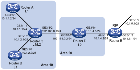

Example: Configuring IS-IS route redistribution
As shown in Figure 12, Router A, Router B, Router C, and Router D reside in the same AS. They use IS-IS to interconnect. Router A and Router B are Level-1 routers, Router D is a Level-2 router, and Router C is a Level-1-2 router.
Redistribute RIP routes into IS-IS on Router D.
Figure 12 Network diagram
2.        Configure basic IS-IS:
# Configure Router A.
[RouterA] isis 1
[RouterB] isis 1
[RouterC] isis 1
# Configure Router D.
[RouterD] isis 1
# Display IS-IS routing information on each router.
 10.1.4.0/24          10         NULL                                    D/L/-
 10.1.4.0/24          10         NULL    GE3/1/1         Direct          D/L/-
3.        Configure RIPv2 on Router D and Router E, and configure IS-IS to redistribute RIP routes on Router D:
# Configure RIPv2 on Router D.
[RouterD] rip 1
[RouterD-rip-1] network 10.0.0.0
[RouterD-rip-1] version 2
[RouterD-rip-1] undo summary
# Configure RIPv2 on Router E.
[RouterE] rip 1
[RouterE-rip-1] network 10.0.0.0
[RouterE-rip-1] version 2
[RouterE-rip-1] undo summary
# On Router D, configure IS-IS to redistribute routes from RIP.
[RouterD-rip-1] quit
[RouterD] isis 1
[RouterD–isis-1] address-family ipv4
[RouterD–isis-1-ipv4] import-route rip level-2
# Display IS-IS routing information on Router C.
 10.1.4.0/24          20         NULL    GE3/1/2         192.168.0.2     R/L/-
 10.1.5.0/24          10         0       GE3/1/2         192.168.0.2     R/L/-
 10.1.6.0/24          10         0       GE3/1/2         192.168.0.2     R/L/-
Example: Configuring IS-IS authentication
As shown in Figure 13, Router A, Router B, Router C, and Router D reside in the same IS-IS routing domain.
Router A, Router B, and Router C belong to Area 10, and Router D belongs to Area 20.
·          Configure neighbor relationship authentication between neighbors.
·          Configure area authentication in Area 10 to prevent untrusted routes from entering into the area.
·          Configure routing domain authentication on Router C and Router D to prevent untrusted routes from entering the routing domain.
Figure 13 Network diagram
[RouterA] isis 1
[RouterB] isis 1
[RouterC] isis 1
[RouterD] isis 1
[RouterD-isis-1] network-entity 20.0000.0000.0001.00
3.        Configure neighbor relationship authentication between neighbors:
# Set the authentication mode to MD5 and set the plaintext key to eRq on GigabitEthernet 3/1/1 of Router A and on GigabitEthernet 3/1/3 of Router C.
[RouterA-GigabitEthernet3/1/1] isis authentication-mode md5 plain eRg
[RouterC-GigabitEthernet3/1/3] isis authentication-mode md5 plain eRg
# Set the authentication mode to MD5 and set the plaintext key to t5Hr on GigabitEthernet 3/1/1 of Router B and on GigabitEthernet 3/1/1 of Router C.
[RouterB-GigabitEthernet3/1/1] isis authentication-mode md5 plain t5Hr
[RouterC-GigabitEthernet3/1/1] isis authentication-mode md5 plain t5Hr
# Set the authentication mode to MD5 and set the plaintext key to hSec on GigabitEthernet 3/1/1 of Router D and on GigabitEthernet 3/1/2 of Router C.
[RouterC-GigabitEthernet3/1/2] isis authentication-mode md5 plain hSec
[RouterD-GigabitEthernet3/1/1] isis authentication-mode md5 plain hSec
4.        Set the area authentication mode to MD5 and set the plaintext key to 10Sec on Router A, Router B, and Router C.

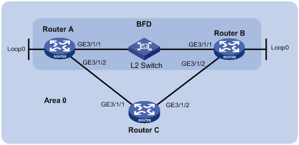

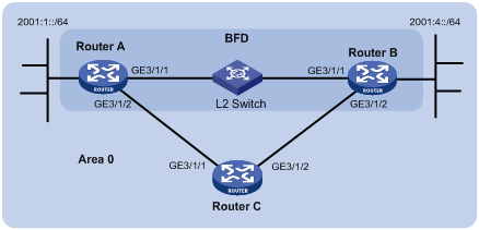

Example: Configuring BFD for IS-IS
·          As shown in Figure 16, run IS-IS on Router A, Router B and Router C so that they can reach each other at the network layer.
·          After the link over which Router A and Router B communicate through the Layer 2 switch fails, BFD can quickly detect the failure and notify IS-IS of the failure. Router A and Router B then communicate through Router C.
Figure 16 Network diagram
Table 4 Interface and IP address assignment
Device
Interface
IP address
Device
Interface
IP address
Router A
GE3/1/1
192.168.0.102/24
Router B
GE3/1/1
192.168.0.100/24
GE3/1/2
10.1.1.102/24
GE3/1/2
13.1.1.1/24
Loop0
121.1.1.1/32
Loop0
120.1.1.1/32
Router C
GE3/1/1
10.1.1.100/24
GE3/1/2
13.1.1.2/24
[RouterA] isis
[RouterA] interface loopback 0
[RouterA-LoopBack0] isis enable
[RouterA-LoopBack0] quit
[RouterA] interface gigabitethernet 3/1/2
[RouterA-GigabitEthernet3/1/2] isis enable
[RouterA-GigabitEthernet3/1/2] quit
[RouterB] isis
[RouterB] interface loopback 0
[RouterB-LoopBack0] isis enable
[RouterB-LoopBack0] quit
[RouterB] interface gigabitethernet 3/1/2
[RouterB-GigabitEthernet3/1/2] isis enable
[RouterB-GigabitEthernet3/1/2] quit
[RouterC] isis
3.        Configure BFD functions:
# Enable BFD and configure BFD parameters on Router A.
[RouterA] bfd session init-mode active
[RouterA-GigabitEthernet3/1/1] isis bfd enable
[RouterA-GigabitEthernet3/1/1] bfd min-receive-interval 500
[RouterA-GigabitEthernet3/1/1] bfd min-transmit-interval 500
[RouterA-GigabitEthernet3/1/1] bfd detect-multiplier 7
# Enable BFD and configure BFD parameters on Router B.
[RouterB] bfd session init-mode active
[RouterB-GigabitEthernet3/1/1] isis bfd enable
[RouterB-GigabitEthernet3/1/1] bfd min-receive-interval 500
[RouterB-GigabitEthernet3/1/1] bfd min-transmit-interval 500
[RouterB-GigabitEthernet3/1/1] bfd detect-multiplier 8
# Display the BFD session information on Router A.
<RouterA> display bfd session
 Total sessions: 1        Up sessions: 1        Init mode: Active
 IPv4 session working in control packet mode:
 LD/RD          SourceAddr      DestAddr        State    Holdtime    Interface
 3/1            192.168.0.102   192.168.0.100   Up       1700ms      GE3/1/1
# Display routes destined for 120.1.1.1/32 on Router A.
<RouterA> display ip routing-table 120.1.1.1 verbose
Summary count : 1
Destination: 120.1.1.1/32
   Protocol: IS_L1
 Process ID: 1
  SubProtID: 0x1                    Age: 04h20m37s
       Cost: 10              Preference: 10
      IpPre: N/A             QosLocalID: N/A
        Tag: 0                    State: Active Adv
  OrigTblID: 0x0                OrigVrf: default-vrf
    TableID: 0x2                 OrigAs: 0
      NibID: 0x26000002          LastAs: 0
     AttrID: 0xffffffff        Neighbor: 0.0.0.0
      Flags: 0x1008c        OrigNextHop: 192.168.0.100
      Label: NULL           RealNextHop: 192.168.0.100
    BkLabel: NULL             BkNextHop: N/A
    SRLabel: NULL             BkSRLabel: NULL
   SIDIndex: NULL               InLabel: NULL
  Tunnel ID: Invalid          Interface: GigabitEthernet3/1/1
BkTunnel ID: Invalid        BkInterface: N/A
   FtnIndex: 0x0           TrafficIndex: N/A
  Connector: N/A                 PathID: 0x0
The output shows that Router A and Router B communicate through Ethernet 1/1. Then the link over Ethernet 1/1 fails.
Summary count : 1
   Protocol: IS_L1
 Process ID: 1
       Cost: 20              Preference: 10
      Flags: 0x1008c        OrigNextHop: 10.1.1.100
      Label: NULL           RealNextHop: 10.1.1.100
  Tunnel ID: Invalid          Interface: GigabitEthernet3/1/2
The output shows that Router A and Router B communicate through Ethernet 1/2.

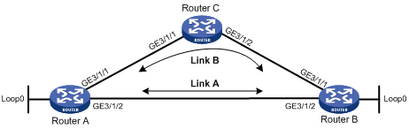

Example: Configuring IS-IS FRR
As shown in Figure 17, Router A, Router B, and Router C reside in the same IS-IS routing domain.
·          Run IS-IS on all the routers to interconnect them with each other.
·          Configure IS-IS FRR so that when Link A fails, traffic can be switched to Link B immediately.
Figure 17 Network diagram
Table 5 Interface and IP address assignment
Device
Interface
IP address
Device
Interface
IP address
Router A
GE3/1/1
12.12.12.1/24
Router B
GE3/1/1
24.24.24.4/24
GE3/1/2
13.13.13.1/24
GE3/1/2
13.13.13.2/24
Loop0
1.1.1.1/32
Loop0
4.4.4.4/32
Router C
GE3/1/1
12.12.12.2/24
GE3/1/2
24.24.24.2/24
1.        Configure IP addresses and subnet masks for interfaces on the routers. (Details not shown.)
2.        Configure IS-IS on the routers to make sure Router A, Router B, and Router C can communicate with each other at the network layer. (Details not shown.)
3.        Configure IS-IS FRR:
Enable IS-IS FRR to calculate a backup next hop through LFA calculation, or designate a backup next hop by using a routing policy.
¡  (Method 1.) Enable IS-IS FRR to calculate a backup next hop through LFA calculation:
[RouterA] isis 1
[RouterA-isis-1] address-family ipv4
[RouterA-isis-1-ipv4] fast-reroute lfa
[RouterA-isis-1-ipv4] quit
[RouterB] isis 1
[RouterB-isis-1] address-family ipv4
[RouterB-isis-1-ipv4] fast-reroute lfa
[RouterB-isis-1-ipv4] quit
¡  (Method 2.) Enable IS-IS FRR to designate a backup next hop by using a routing policy:
[RouterA] ip prefix-list abc index 10 permit 4.4.4.4 32
[RouterA] route-policy frr permit node 10
[RouterA-route-policy-frr-10] if-match ip address prefix-list abc
[RouterA-route-policy-frr-10] apply fast-reroute backup-interface gigabitethernet 3/1/1 backup-nexthop 12.12.12.2
[RouterA-route-policy-frr-10] quit
[RouterA] isis 1
[RouterA-isis-1-ipv4] fast-reroute route-policy frr
[RouterB] ip prefix-list abc index 10 permit 1.1.1.1 32
[RouterB] route-policy frr permit node 10
[RouterB-route-policy-frr-10] if-match ip address prefix-list abc
[RouterB-route-policy-frr-10] apply fast-reroute backup-interface gigabitethernet 3/1/1 backup-nexthop 24.24.24.2
[RouterB-route-policy-frr-10] quit
[RouterB] isis 1
[RouterB-isis-1-ipv4] fast-reroute route-policy frr
# Display route 4.4.4.4/32 on Router A to view the backup next hop information.
[RouterA] display ip routing-table 4.4.4.4 verbose
Summary count : 1
Destination: 4.4.4.4/32
   Protocol: IS_L1
 Process ID: 1
      Flags: 0x1008c        OrigNextHop: 13.13.13.2
      Label: NULL           RealNextHop: 13.13.13.2
    BkLabel: NULL             BkNextHop: 12.12.12.2
BkTunnel ID: Invalid        BkInterface: GigabitEthernet3/1/1
# Display route 1.1.1.1/32 on Router B to view the backup next hop information.
[RouterB] display ip routing-table 1.1.1.1 verbose
Summary count : 1
Destination: 1.1.1.1/32
   Protocol: IS_L1
 Process ID: 1
      Flags: 0x1008c        OrigNextHop: 13.13.13.1
      Label: NULL           RealNextHop: 13.13.13.1
    BkLabel: NULL             BkNextHop: 24.24.24.2
IPv6 IS-IS configuration examples
Example: Configuring IPv6 IS-IS basics
As shown in Figure 18, Router A, Router B, Router C, and Router D, all enabled with IPv6, reside in the same AS. Configure IPv6 IS-IS on the routers so that they can reach each other.
Figure 18 Network diagram
1.        Configure IPv6 addresses for interfaces. (Details not shown.)
2.        Configure IPv6 IS-IS:
[RouterA] isis 1
[RouterA-isis-1] address-family ipv6
[RouterA-isis-1-ipv6] quit
[RouterA-GigabitEthernet3/1/1] isis ipv6 enable 1
[RouterB] isis 1
[RouterB-isis-1] address-family ipv6
[RouterB-isis-1-ipv6] quit
[RouterB-GigabitEthernet3/1/1] isis ipv6 enable 1
[RouterC] isis 1
[RouterC-isis-1] address-family ipv6
[RouterC-isis-1-ipv6] quit
[RouterC-GigabitEthernet3/1/1] isis ipv6 enable 1
[RouterC-GigabitEthernet3/1/2] isis ipv6 enable 1
[RouterC-GigabitEthernet3/1/3] isis ipv6 enable 1
[RouterD] isis 1
[RouterD-isis-1] address-family ipv6
[RouterD-isis-1-ipv6] quit
[RouterD-GigabitEthernet3/1/1] isis ipv6 enable 1
[RouterD-GigabitEthernet3/1/2] isis ipv6 enable 1
# Display the IPv6 IS-IS routing table on Router A.
[RouterA] display isis route ipv6
                         Level-1 IPv6 forwarding table
 Destination : ::                                      PrefixLen: 0
 Flag        : R/-/-                                   Cost     : 10
 Next hop    : FE80::200:FF:FE0F:4                     Interface: GE3/1/1
 Destination : 2001:1::                                PrefixLen: 64
 Flag        : D/L/-                                   Cost     : 10
 Next hop    : Direct                                  Interface: GE3/1/1
 Destination : 2001:2::                                PrefixLen: 64
 Flag        : R/-/-                                   Cost     : 20
 Destination : 2001:3::                                PrefixLen: 64
# Display the IPv6 IS-IS routing table on Router B.
[RouterB] display isis route ipv6
# Display the IPv6 IS-IS routing table on Router C.
[RouterC] display isis route ipv6
 Next hop    : Direct                                  Interface: GE3/1/2
 Next hop    : Direct                                  Interface: GE3/1/3
                         Level-2 IPv6 forwarding table
 Destination : 2001:4::1                               PrefixLen: 64
 Next hop    : FE80::20F:E2FF:FE3E:FA3D                Interface: GE3/1/3
# Display the IPv6 IS-IS routing table on Router D.
[RouterD] display isis route ipv6
 Flag        : D/L/-                                   Cost     : 0
      Flags: D-Direct, R-Added to Rib, L-Advertised in LSPs, U-Up/Down bit set
Example: Configuring BFD for IPv6 IS-IS
As shown in Figure 19:
·          Configure IPv6 IS-IS on Router A, Router B, and Router C so that they can reach each other.
·          Enable BFD on GigabitEthernet 3/1/1 of Router A and Router B.
When the link between Router B and the Layer 2 switch fails, BFD can quickly detect the failure and notify IPv6 IS-IS of the failure. Then Router A and Router B communicate through Router C.
Figure 19 Network diagram
Table 6 Interface and IP address assignment
Device
Interface
IPv6 address
Device
Interface
IPv6 address
Router A
GE3/1/1
2001::1/64
Router B
GE3/1/1
2001::2/64
GE3/1/2
2001:2::1/64
GE3/1/2
2001:3::2/64
Router C
GE3/1/1
2001:2::2/64
GE3/1/2
2001:3::1/64
[RouterA] isis 1
[RouterA-GigabitEthernet3/1/2] isis ipv6 enable 1
[RouterB] isis 1
[RouterB-GigabitEthernet3/1/2] isis ipv6 enable 1
[RouterC] isis 1
[RouterC-GigabitEthernet3/1/1 quit
[RouterA-GigabitEthernet3/1/1] isis ipv6 bfd enable
[RouterA-GigabitEthernet3/1/1] return
[RouterB-GigabitEthernet3/1/1] isis ipv6 bfd enable
[RouterB-GigabitEthernet3/1/1] bfd detect-multiplier 6
# Display BFD session information on Router A.
 IPv6 session working in control packet mode:
       Local Discr: 1441                 Remote Discr: 1450
         Source IP: FE80::20F:FF:FE00:1202 (link-local address of GigabitEthernet3/1/1 on Router A)
    Destination IP: FE80::20F:FF:FE00:1200 (link-local address of GigabitEthernet3/1/1 on Router B)
     Session State: Up                      Interface: GE3/1/1
         Hold Time: 2319ms
# Display routes destined for 2001:4::0/64 on Router A.
<RouterA> display ipv6 routing-table 2001:4::0 64
Summary count : 2
Destination: 2001:4::/64                                 Protocol  : IS_L1
NextHop    : FE80::20F:FF:FE00:1200                      Preference: 15
Interface  : GE3/1/1                                     Cost      : 10
The output shows that Router A and Router B communicate through GigabitEthernet 3/1/1. Then the link over GigabitEthernet 3/1/1 fails.
Summary count : 1
NextHop    : FE80::BAAF:67FF:FE27:DCD0                   Preference: 15
Interface  : GE3/1/2                                     Cost      : 20
The output shows that Router A and Router B communicate through GigabitEthernet 3/1/2.
Example: Configuring IPv6 IS-IS FRR
As shown in Figure 20, Router A, Router B, and Router C reside in the same IS-IS routing domain.
·          Run IPv6 IS-IS on all the routers to interconnect them with each other.
·          Configure IPv6 IS-IS FRR so that when Link A fails, traffic can be switched to Link B immediately.
Figure 20 Network diagram
Table 7 Interface and IP address assignment
Device
Interface
IPv6 address
Device
Interface
IP address
Router A
GE3/1/1
1::1/64
Router B
GE3/1/1
3::1/64
GE3/1/2
2::1/64
GE3/1/2
2::2/64
Loop0
10::1/128
Loop0
20::1/128
Router C
GE3/1/1
1::2/64
GE3/1/2
3::2/64
1.        Configure IPv6 addresses for interfaces on the routers and enable IPv6 IS-IS. (Details not shown.)
2.        Configure IPv6 IS-IS FRR:
Enable IPv6 IS-IS FRR to calculate a backup next hop through LFA calculation, or designate a backup next hop by using a routing policy.
¡  (Method 1.) Enable IPv6 IS-IS FRR to calculate a backup next hop through LFA calculation:
<RouterA>system-view
[RouterA] isis 1
[RouterA-isis-1-ipv6] fast-reroute lfa
[RouterB] isis 1
[RouterB-isis-1-ipv6] fast-reroute lfa
¡  (Method 2.) Enable IPv6 IS-IS FRR to designate a backup next hop by using a routing policy:
[RouterA] ipv6 prefix-list abc index 10 permit 20::1 128
[RouterA-route-policy-frr-10] if-match ipv6 address prefix-list abc
[RouterA-route-policy-frr-10] apply ipv6 fast-reroute backup-interface gigabitethernet 3/1/1 backup-nexthop 1::2
[RouterA] isis 1
[RouterA-isis-1-ipv6] fast-reroute route-policy frr
[RouterB] ipv6 prefix-list abc index 10 permit 10::1 128
[RouterB-route-policy-frr-10] if-match ipv6 address prefix-list abc
[RouterB-route-policy-frr-10] apply ipv6 fast-reroute backup-interface gigabitethernet 3/1/1 backup-nexthop 3::2
[RouterB] isis 1
[RouterB-isis-1-ipv6] fast-reroute route-policy frr
# Display route 20::1/128 on Router A to view the backup next hop information.
[RouterA] display ipv6 routing-table 20::1 128 verbose
Summary count : 1
Destination: 20::1/128
   Protocol: IS_L1
 Process ID: 1
  SubProtID: 0x1                    Age: 00h27m45s
       Cost: 10              Preference: 15
  OrigTblID: 0xa                OrigVrf: default-vrf
    TableID: 0xa                 OrigAs: 0
      NibID: 0x24000005          LastAs: 0
     AttrID: 0xffffffff        Neighbor: ::
      Flags: 0x10041        OrigNextHop: FE80::34CD:9FF:FE2F:D02
      Label: NULL           RealNextHop: FE80::34CD:9FF:FE2F:D02
    BkLabel: NULL             BkNextHop: FE80::7685:45FF:FEAD:102
# Display route 10::1/128 on Router B to view the backup next hop information.
[RouterB] display ipv6 routing-table 10::1 128 verbose
Summary count : 1
Destination: 10::1/128
   Protocol: IS_L1
 Process ID: 1
  SubProtID: 0x1                    Age: 00h33m23s
      NibID: 0x24000006          LastAs: 0
      Flags: 0x10041        OrigNextHop: FE80::34CC:E8FF:FE5B:C02
      Label: NULL           RealNextHop: FE80::34CC:E8FF:FE5B:C02
