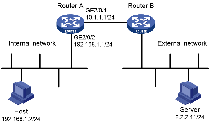

As shown in Figure 1, ACLs on the edge device deny incoming packets to the internal network. The ASPF application layer protocol inspection allows return packets from the external network to the internal network.
Figure 1 Application layer protocol inspection

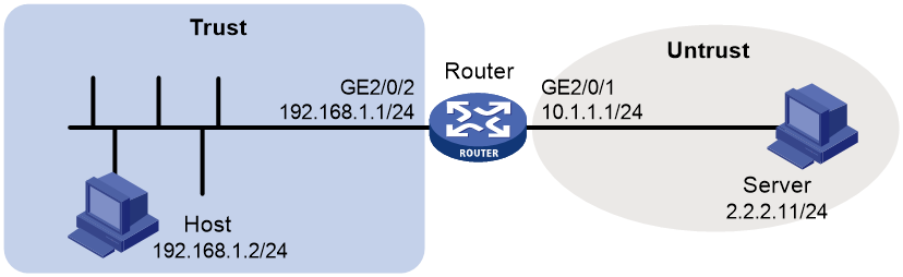

ASPF configuration examples
Example: Configuring ASPF FTP application inspection
Configure an ASPF policy on Router A to inspect the FTP traffic flows passing through Router A. Only return packets for FTP connections initiated by users on the internal network are permitted to pass through Router A and get into the internal network. All other types of packets from the external network to the internal network are blocked.
Figure 3 Network diagram

# Verify that only the return packets of FTP connections can enter the internal network. (Details not shown.)

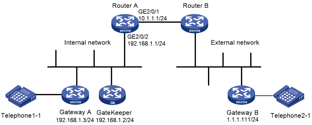

Example: Configuring ASPF H.323 application inspection
Figure 5 displays a typical H.323 application network. Gateway B on the external network needs to access the H.323 Gatekeeper, and with the assistance of Gatekeeper, to establish a connection with the H.323 Gateway A. Other protocol packets from the external network are dropped.
Configure a packet filter on Router A to permit only packets destined to the Gatekeeper. Configure an ASPF policy on Router A to detect H.323 protocol packets so that return packets to the external network can be passed through GigabitEthernet 2/0/1.
Figure 5 Network diagram
# Create ACL 3200 and configure two rules in the ACL: one to permit packets destined to Gatekeeper to pass, and one to deny all IP packets.
<RouterA> system-view
[RouterA] acl advanced 3200
[RouterA-acl-ipv4-adv-3200] rule 0 permit ip destination 192.168.1.2 0
[RouterA-acl-ipv4-adv-3200] rule 5 deny ip
[RouterA-acl-ipv4-adv-3200] quit
# Create ASPF policy 1 for H.323 inspection.
[RouterA] aspf policy 1
[RouterA-aspf-policy-1] detect h323
[RouterA-aspf-policy-1] quit
# Apply ACL 3200 to filter incoming packets on GigabitEthernet 2/0/1.
[RouterA] interface gigabitethernet 2/0/1
[RouterA-GigabitEthernet2/0/1] packet-filter 3200 inbound
# Apply ASPF policy 1 to incoming traffic on GigabitEthernet 2/0/1.
[RouterA-GigabitEthernet2/0/1] aspf apply policy 1 inbound
[RouterA-GigabitEthernet2/0/1] quit
# Verify that ASPF sessions have been created between Gateway B and Gatekeeper/Gateway A.
[RouterA] display aspf session ipv4
Slot 0:
Initiator:
  Source      IP/port: 1.1.1.111/33184
  Destination IP/port: 192.168.1.3/32828
  VPN instance/VLAN ID/Inline ID: -/-/-
  Protocol: UDP(17)
  Inbound interface: GigabitEthernet2/0/1
Initiator:
  Source      IP/port: 1.1.1.111/1719
  Destination IP/port: 192.168.1.2/1719
  Protocol: UDP(17)
Initiator:
  Source      IP/port: 1.1.1.111/3521
  Destination IP/port: 192.168.1.2/20155
  Protocol: TCP(6)
Initiator:
  Source      IP/port: 1.1.1.111/33185
  Destination IP/port: 192.168.1.3/32829
  Protocol: UDP(17)
Initiator:
  Source      IP/port: 1.1.1.111/3688
  Destination IP/port: 192.168.1.2/1720
  Protocol: TCP(6)
Total sessions found: 5
# Verify that only return packets that match the entries can pass through GigabitEthernet 2/0/1. (Details not shown.)
Example: Configuring ASPF for a zone pair
Configure an ASPF policy on the router to inspect FTP traffic that passes through the router to implement the following filtering:
·     Permits only return packets for the FTP connections initiated by users on the internal network to pass through the router .
·     Blocks all other types of packets from the external network to the internal network.
Figure 6 Network diagram
# Configure ACL 3500 to permit IP packets.
<Router> system-view
[Router] acl advanced 3500
[Router-acl-ipv4-adv-3500] rule permit ip
[Router-acl-ipv4-adv-3500] quit
# Add GigabitEthernet 2/0/2 to security zone Trust.
[Router] security-zone name trust
[Router-security-zone-Trust] import interface gigabitethernet 2/0/2
[Router-security-zone-Trust] quit
# Add GigabitEthernet 2/0/1 to security zone Untrust.
[Router] security-zone name untrust
[Router-security-zone-Untrust] import interface gigabitethernet 2/0/1
[Router-security-zone-Untrust] quit
# Create ASPF policy 1 for FTP inspection.
[Router] aspf policy 1
[Router-aspf-policy-1] detect ftp
[Router-aspf-policy-1] quit
# Create a zone pair and enter its view.
[Router] zone-pair security source trust destination untrust
# Apply the ACL to filter to permit outgoing packets in the zone pair.
[Router-zone-pair-security-Trust-Untrust] packet-filter 3500
# Apply the ASPF policy to the zone pair.
[Router-zone-pair-security-Trust-Untrust] aspf apply policy 1
[Router-zone-pair-security-Trust-Untrust] quit
# Verify that an ASPF session has been established for the FTP connection between the host and the server.
[Router] display aspf session ipv4
Slot 0:
Initiator:
  Source      IP/port: 192.168.1.2/1877
  Destination IP/port: 2.2.2.11/21
  Protocol: TCP(6)
  Inbound interface: GigabitEthernet2/0/2
  Source security zone: Trust
Total sessions found: 1
# Verify that only return packets that match the entries can enter the internal network. (Details not shown.)
