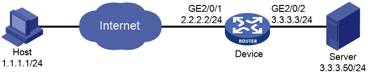

Transport mode
The security protocols protect the upper layer data of an IP packet. Only the transport layer data is used to calculate the security protocol headers. The calculated security protocol headers and the encrypted data (only for ESP encapsulation) are placed after the original IP header. You can use the transport mode when end-to-end security protection is required (the secured transmission start and end points are the actual start and end points of the data). The transport mode is typically used for protecting host-to-host communications, as shown in Figure 1.
Figure 1 IPsec protection in transport mode

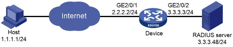

Tunnel mode
The security protocols protect the entire IP packet. The entire IP packet is used to calculate the security protocol headers. The calculated security protocol headers and the encrypted data (only for ESP encapsulation) are encapsulated in a new IP packet. In this mode, the encapsulated packet has two IP headers. The inner IP header is the original IP header. The outer IP header is added by the network device that provides the IPsec service. You must use the tunnel mode when the secured transmission start and end points are not the actual start and end points of the data packets (for example, when two gateways provide IPsec but the data start and end points are two hosts behind the gateways). The tunnel mode is typically used for protecting gateway-to-gateway communications, as shown in Figure 2.
Figure 2 IPsec protection in tunnel mode

Figure 4 Tunnel interface encapsulation
As shown in Figure 4, a tunnel interface encapsulates an IP packet as follows:
1.     Upon receiving a clear text packet, the input interface sends the packet to the forwarding module for routing.
2.     If the packet requires IPsec protection, the forwarding module sends the packet to the tunnel interface.
3.     The tunnel interface encapsulates the packet into a new IP packet. The source and destination IP addresses in the new IP header are the source and destination IP addresses of the tunnel interface. Then, the tunnel interface sends the packet back to the forwarding module.
4.     The forwarding module looks up the routing table again and sends the packet out of the physical interface of the tunnel interface.
Figure 5 Tunnel interface de-encapsulation
As shown in Figure 5, a tunnel interface de-encapsulates an IP packet as follows:
1.     Upon receiving an encrypted packet, the inbound interface sends the packet to the forwarding module for routing.
2.     Because the packet is destined for the tunnel interface' source address and the payload protocol is AH or ESP, the forwarding module sends the packet to the tunnel interface.
3.     The tunnel interface de-encapsulates the packet (removes the outer IP header) and sends the de-encapsulated packet back to the forwarding module.
4.     The forwarding module looks up the routing table again and sends the packet out of the output interface.

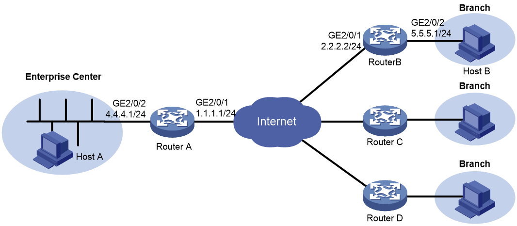

As shown in Figure 6, the traffic between the enterprise center and the branches are protected by IPsec. The gateway at the enterprise center is configured with static routes to route traffic to the IPsec-protected interfaces. It is difficult to add or modify static routes on the gateway at the enterprise center if the IPsec VPN has a large number of branches or if the network structure changes.
Figure 6 IPsec VPN
After you can enable IPsec RRI on the gateway, the gateway automatically adds a static route to the routing table each time an IPsec tunnel is established. The destination IP address is the protected private network. The next hop IP address can be the remote IP address of the IPsec tunnel (default) or a user-defined next hop IP address. Traffic destined for the peer end is routed to the IPsec tunnel interface and thereby protected by IPsec.
You can advertise the static routes created by IPsec RRI in the internal network, and the internal network device can use them to forward traffic in the IPsec VPN.
You can set preferences for the static routes created by IPsec RRI to implement flexible route management. For example, you can set the same preference for multiple routes to the same destination to implement load sharing, or you can set different preferences to implement route backup.
You can also set tags for the static routes created by IPsec RRI to implement flexible route control through routing policies.

Example: Configuring a manual mode IPsec tunnel for IPv4 packets
As shown in Figure 10, establish an IPsec tunnel between Router A and Router B to protect data flows between subnet 10.1.1.0/24 and subnet 10.1.2.0/24. Configure the tunnel as follows:
·     Specify the encapsulation mode as tunnel, the security protocol as ESP, the encryption algorithm as 128-bit AES, and the authentication algorithm as HMAC-SHA1.
·     Manually set up IPsec SAs.
Figure 10 Network diagram
1.     Configure Router A:
# Configure IP addresses for interfaces. (Details not shown.)
# Configure an IPv4 advanced ACL to identify data flows from subnet 10.1.1.0/24 to subnet 10.1.2.0/24.

Example: Configuring an IKE-based IPsec tunnel for IPv4 packets
As shown in Figure 11, establish an IPsec tunnel between Router A and Router B to protect data flows between subnet 10.1.1.0/24 and subnet 10.1.2.0/24. Configure the IPsec tunnel as follows:
·     Set up SAs through IKE negotiation.
Figure 11 Network diagram

Example: Configuring an IKE-based IPsec tunnel for IPv6 packets
As shown in Figure 12, establish an IPsec tunnel between Router A and Router B to protect data flows between subnet 333::/64 and subnet 555::/64. Configure the IPsec tunnel as follows:
Figure 12 Network diagram

Example: Configuring IPsec RRI
As shown in Figure 14, branches access the enterprise center through an IPsec VPN.
Configure the IPsec VPN as follows:
·     Configure an IPsec tunnel between Router A and each branch gateway (Router B, Router C, and Router D) to protect traffic between subnets 4.4.4.0/24 and 5.5.5.0/24.
·     Configure the tunnels to use security protocol ESP, encryption algorithm DES, and authentication algorithm SHA1-HMAC-96. Use IKE for IPsec SA negotiation.
·     On each router, configure an IKE proposal to use the preshared key authentication method, encryption algorithm 3DES, and authentication algorithm HMAC-SHA1.
·     Configure IPsec RRI on Router A to automatically create static routes to the branches based on the established IPsec SAs.
Figure 14 Network diagram
1.     Assign IPv4 addresses to the interfaces on the routers according to Figure 14. (Details not shown.)
2.     Configure Router A:

1.     Verify that IPsec RRI can automatically create a static route from Router A to Router B:
# Initiate a connection from subnet 5.5.5.0/24 to subnet 4.4.4.0/24. IKE negotiation is triggered to establish IPsec SAs between Router A and Router B. (Details not shown.)
# Verify that IPsec SAs are established on Router A.

Example: Configuring IPsec tunnel interface-based IPsec for IPv4 packets
As shown in Figure 15, both the branch and the headquarters use fixed IP addresses to access the Internet.
Configure IPsec tunnel interface-based IPsec on Router A and Router B to protect the traffic between the branch (10.1.1.0/24) and the headquarters (10.1.2.0/24). This IPsec implementation ensures that the IPsec configuration of the headquarters remains stable despite of changes of the branch subnet.
Figure 15 Network diagram
Configuring Router A
1.     Configure routing to make sure GE2/0/2 on Router A and GE2/0/1 on Router B can reach each other through the IPv4 network. (Details not shown.)
2.     Configure IP addresses for the interfaces. (Details not shown.)

As shown in Figure 16, IKE negotiates SAs for IPsec and transfers the SAs to IPsec, and IPsec uses the SAs to protect IP packets.
Figure 16 Relationship between IKE and IPsec

Figure 17 IKE exchange process in main mode
IKE exchange process in aggressive mode
As shown in Figure 18, the process of phase 1 IKE negotiation in aggressive mode is as follows:
1.     The initiator (peer 1) sends a message containing the local IKE information to peer 2. The message includes parameters used for IKE SA establishment, keying data, and peer 1's identity information.
2.     Peer 2 chooses the IKE establishment parameters to use, generate the key, and authenticate peer 1's identity. Then it sends the IKE data to peer 1.
3.     Peer 1 generates the key, authenticates peer 2's identity, and sends the results to peer 1.
After the preceding process, an IKE SA is established between peer 1 and peer 2.
The aggressive mode is faster than the main mode but it does not provide identity information protection. The main mode provides identity information protection but is slower. Choose the appropriate negotiation mode according to your requirements.
Figure 18 IKE exchange process in aggressive mode

Example: Configuring aggressive-mode IKE with RSA signature authentication
This configuration example is not available when the device is operating in FIPS mode.
As shown in Figure 20, configure an IKE-based IPsec tunnel between Device A and Device B to secure the communication between subnet 10.1.1.0/24 and subnet 10.1.2.0/24.
Configure Device A and Device B to use aggressive mode for IKE negotiation phase 1 and to use RSA signature authentication. Device A acts as the initiator, and the subnet where Device A resides uses IP addresses dynamically allocated.
Figure 20 Network diagram

Example: Configuring aggressive-mode IKE with NAT traversal
Device A is behind the NAT device. Hosts behind Device A use public IP address 3.3.3.1 to access the external network.
Configure an IKE-based IPsec tunnel between Device A and Device B to secure the communication between subnet 10.1.1.0/24 and subnet 10.1.2.0/24.
·     Configure Device A and Device B to use the default IKE proposal for the aggressive IKE negotiation to set up the IPsec SAs.
·     Configure the two devices to use the preshared key authentication method for the IKE negotiation phase 1.
Figure 21 Network diagram

Example: Configuring IKE remote extended authentication
As shown in Figure 22, configure an IPsec tunnel to protect the traffic between the host and the device.
·     Set up IPsec SAs through IKE negotiations.
·     Configure the host and the device to use preshared key for authentication in the phase-1 IKE negotiation.
·     Configure the device to use RADIUS to perform remote extended authentication on the host.
Figure 22 Network diagram
1.     Make sure the device, host, and server can reach one another.
2.     Configure the RADIUS server. Make sure the RADIUS server has an authentication account for the host. In this example, the account uses username test and password abc.
3.     Configure the device:

Example: Configuring IKE local extended authentication and address pool authorization
As shown in Figure 23, configure an IPsec tunnel to protect the traffic between the host and the server.
·     Configure the device to use AAA to perform local extended authentication on the host and assign an IPv4 address to the host.
Figure 23 Network diagram
1.     Make sure the device and the host can reach each other.
2.     Configure local users on the device. In this example, the authentication account uses username test and password abc.
