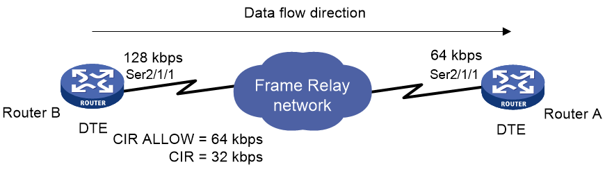

On an FR interface, you can use generic QoS services to perform interface-based traffic shaping, traffic policing, congestion management, and congestion avoidance. You can also use FR QoS to implement virtual circuit-based QoS, including FR traffic shaping (FRTS), FR traffic policing (FRTP), FR congestion management, FR discard eligibility (DE) rule list, and FR queuing management.
FR QoS works on a per-PVC basis and is more flexible than generic QoS. For more information about Frame Relay, see Layer 2—WAN Configuration Guide.

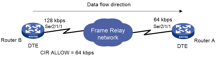

FRTS limits the outgoing traffic rate and smoothes bursts for PVCs. Then, PVCs can transmit traffic at a constant rate. FRTS applies to the outgoing interface of a switch. You can use FRTS to remove the bottleneck created when the input rate of a device is slower than the output rate of the sending device.
As shown in Figure 2:
·     Router B transmits packets to Router A at 128 kbps.
·     The maximum interface rate of Router A is only 64 kbps.
The disparity in traffic rate creates a bottleneck on the interface that connects Router A to the FR network.
To avoid packet loss, you can configure FRTS with the CIR ALLOW 64 kbps and the CIR 32 kbps on the outgoing interface Serial 2/1/1 of Router B. Then, the interface can transmit packets constantly at 64 kbps when no congestion occurs. Even if congestion occurs in the network, Router B can still transmit packets at the rate of 32 kbps.
Figure 2 FRTS implementation
FRTS uses the parameters CIR ALLOW, CIR, CBS, and EBS for traffic shaping. FR PVCs can transmit packets at the rate of CIR ALLOW when no congestion occurs. In the case of bursty packets, FRTS allows an FR PVC to transmit packets at a rate exceeding the CIR ALLOW.

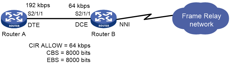

FRTP monitors the traffic entering the network from each PVC and limits the traffic to specified traffic parameters. If the traffic on a PVC exceeds the user-defined threshold, the device takes action to conserve network resources.
Figure 4 FR traffic policing implementation
As shown in Figure 4, Router A on the user side transmits packets at the rate of 192 kbps to Router B on the switching side. To provide Router A with only 64 kbps of bandwidth, the FR traffic policing settings in the figure are used on the DCE side of Router B.
·     When the traffic from Router A is smaller than the CBS, Router B forwards the packets without any other processing.
·     When the traffic from Router A is larger than the CBS and smaller than EBS + CBS, the packets can be transmitted. However, for those packets of the traffic that exceeds the CBS, Router B sets the DE bit in the FR header to 1.
·     When the traffic from Router A is larger than CBS + EBS, Router B performs the following operations:
¡     Transmits the traffic that is equal to CBS + EBS.
¡     Sets the DE bit in the FR header to 1 for the traffic that exceeds the CBS.
¡     Drops the traffic that exceeds CBS + EBS.

As shown in Figure 6:
·     The maximum rate of Serial 2/1/1 on Router A is 64 kbps.
·     Router B sends packets to Router A at 128 kbps.
Configure FRTS on the outgoing interface Serial 2/1/1 of Router B to limit its transmission rate to an average of 64 kbps.
Figure 6 Network diagram
# Create FR class 64k and configure its FRTS parameters.
<RouterB> system-view
[RouterB] fr class 64k
[RouterB-fr-class-64k] cir allow 64000
[RouterB-fr-class-64k] cir 32000
[RouterB-fr-class-64k] cbs 64000
[RouterB-fr-class-64k] ebs 32000
[RouterB-fr-class-64k] traffic-shaping adaptation becn
[RouterB-fr-class-64k] traffic-shaping adaptation percentage 20
[RouterB-fr-class-64k] quit
# Enable FR encapsulation and FRTS on Serial 2/1/1.
[RouterB] interface serial 2/1/1
[RouterB-Serial2/1/1] link-protocol fr
[RouterB-Serial2/1/1] fr traffic-shaping
# Create an FR PVC and associate FR class 64k with the FR PVC.
[RouterB-Serial2/1/1] fr dlci 16
[RouterB-Serial2/1/1-fr-dlci-16] fr-class 64k
# Display the FR QoS configuration and statistics for the PVC with DLCI 16.
[RouterB-Serial2/1/1-fr-dlci-16] display fr pvc dlci 16
PVC information for interface Serial2/1/1 (DTE, physically up)
  DLCI: 16  Type: Static  Interface: Serial2/1/1
    Encapsulation: IETF
    Creation time: 2014/02/19 01:38:00  Status: Active
    Input: 4 packets, 120 bytes, 0 dropped
    Output: 4 packets, 120 bytes, 0 dropped
    Traffic shaping: Active
      CIR allow: 64000 bps  CIR: 32000 bps
      CBS: 64000 bits  EBS: 32000 bits
      Current CIR: 64000 bps
      Output: 0 packets, 0 bytes, 0 dropped packets
      Delayed: 0 packets, 0 bytes
      Output queue: (Urgent queuing: Size/Length/Discards) 0/100/0
      Output queue: (Protocol queuing: Size/Length/Discards) 0/500/0
      Output queue: (FIFO queuing: Size/Length/Discards) 0/75/0
The output shows that traffic shaping is enabled and the CIR ALLOW is 64 kbps.
