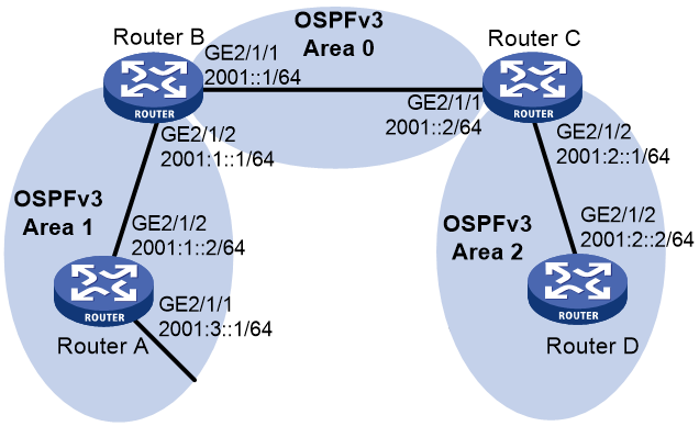

OSPFv3 configuration examples
Example: Configuring OSPFv3 stub area
As shown in Figure 2:
·     Enable OSPFv3 on all routers.
·     Split the AS into three areas.
·     Configure Router B and Router C as ABRs to forward routing information between areas.
·     Configure Area 2 as a stub area to reduce LSAs in the area without affecting route reachability.
Figure 2 Network diagram
1.     Configure IPv6 addresses for interfaces. (Details not shown.)
2.     Configure basic OSPFv3:

# Display OSPFv3 neighbors on Router B.
[RouterB] display ospfv3 peer
               OSPFv3 Process 1 with Router ID 2.2.2.2
 Area: 0.0.0.0
 Router ID       Pri State             Dead-Time InstID Interface
 3.3.3.3         1   Full/BDR          00:00:40  0      GE2/0/1
 Area: 0.0.0.1
 1.1.1.1         1   Full/DR           00:00:40  0      GE2/0/2
# Display OSPFv3 neighbors on Router C.
[RouterC] display ospfv3 peer
               OSPFv3 Process 1 with Router ID 3.3.3.3
 Area: 0.0.0.0
 2.2.2.2         1   Full/DR           00:00:40  0      GE2/0/1
 Area: 0.0.0.2
 4.4.4.4         1   Full/BDR          00:00:40  0      GE2/0/2
# Display OSPFv3 neighbors on Router D.

Example: Configuring OSPFv3 NSSA area
As shown in Figure 3:
·     Configure OSPFv3 on all routers and split the AS into three areas.
·     Configure Area 1 as an NSSA area and configure Router A as an ASBR to redistribute static routes into the AS.
Figure 3 Network diagram
2.     Configure basic OSPFv3 (see "Example: Configuring OSPFv3 stub area").
3.     Configure Area 1 as an NSSA area:

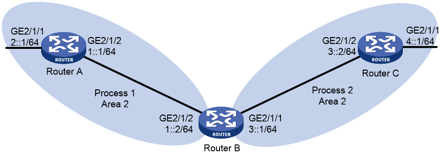

Example: Configuring OSPFv3 route redistribution
As shown in Figure 5:
·     Router A, Router B, and Router C are in Area 2.
·     OSPFv3 process 1 and OSPFv3 process 2 run on Router B. Router B communicates with Router A and Router C through OSPFv3 process 1 and OSPFv3 process 2.
·     Configure OSPFv3 process 2 to redistribute direct routes and the routes from OSPFv3 process 1 on Router B, and set the cost for redistributed routes to 3. Router C can then learn the routes destined for 1::0/64 and 2::0/64, and Router A cannot learn the routes destined for 3::0/64 or 4::0/64.
Figure 5 Network diagram
# Enable OSPFv3 process 1 on Router A.
<RouterA> system-view
[RouterA] ospfv3 1
[RouterA-ospfv3-1] router-id 1.1.1.1
[RouterA-ospfv3-1] quit
[RouterA] interface gigabitethernet 2/0/2
[RouterA-GigabitEthernet2/0/2] ospfv3 1 area 2
[RouterA-GigabitEthernet2/0/2] quit
[RouterA] interface gigabitethernet 2/0/1
[RouterA-GigabitEthernet2/0/1] ospfv3 1 area 2
[RouterA-GigabitEthernet2/0/1] quit
# Enable OSPFv3 process 1 and OSPFv3 process 2 on Router B.
<RouterB> system-view
[RouterB] ospfv3 1
[RouterB-ospfv3-1] router-id 2.2.2.2
[RouterB-ospfv3-1] quit
[RouterB] interface gigabitethernet 2/0/2
[RouterB-GigabitEthernet2/0/2] ospfv3 1 area 2
[RouterB-GigabitEthernet2/0/2] quit
[RouterB] ospfv3 2
[RouterB-ospfv3-2] router-id 3.3.3.3
[RouterB-ospfv3-2] quit
[RouterB] interface gigabitethernet 2/0/1
[RouterB-GigabitEthernet2/0/1] ospfv3 2 area 2
[RouterB-GigabitEthernet2/0/1] quit
# Enable OSPFv3 process 2 on Router C.
<RouterC> system-view
[RouterC] ospfv3 2
[RouterC-ospfv3-2] router-id 4.4.4.4
[RouterC-ospfv3-2] quit
[RouterC] interface gigabitethernet 2/0/2
[RouterC-GigabitEthernet2/0/2] ospfv3 2 area 2
[RouterC-GigabitEthernet2/0/2] quit
[RouterC] interface gigabitethernet 2/0/1
[RouterC-GigabitEthernet2/0/1] ospfv3 2 area 2
[RouterC-GigabitEthernet2/0/1] quit
# Display the routing table on Router C.
[RouterC] display ipv6 routing-table
Destinations : 7 Routes : 7
Destination: ::1/128                                     Protocol  : Direct
NextHop    : ::1                                         Preference: 0
Interface  : InLoop0                                     Cost      : 0
Destination: 3::/64                                      Protocol  : Direct
NextHop    : ::                                          Preference: 0
Interface  : GE2/0/2                                     Cost      : 0
Destination: 3::2/128                                    Protocol  : Direct
Destination: 4::/64                                      Protocol  : Direct
Interface  : GE2/0/1                                     Cost      : 0
Destination: 4::1/128                                    Protocol  : Direct
Destination: FE80::/10                                   Protocol  : Direct
Interface  : NULL0                                       Cost      : 0
Destination: FF00::/8                                    Protocol  : Direct
3.     Configure OSPFv3 route redistribution:
# Configure OSPFv3 process 2 to redistribute direct routes and the routes from OSPFv3 process 1 on Router B, and set the cost for redistributed routes to 3.
[RouterB] ospfv3 2
[RouterB-ospfv3-2] import-route ospfv3 1 cost 3
[RouterB-ospfv3-2] import-route direct cost 3

Example: Configuring OSPFv3 route summarization
As shown in Figure 6:
·     OSPFv3 process 1 and OSPFv3 process 2 run on Router B. Router B communicates with Router A and Router C through OSPFv3 process 1 and OSPFv3 process 2, respectively.
·     On Router A, configure IPv6 addresses 2:1:1::1/64, 2:1:2::1/64, and 2:1:3::1/64 for GigabitEthernet 2/0/1.
·     On Router B, configure OSPFv3 process 2 to redistribute direct routes and the routes from OSPFv3 process 1. Router C can then learn the routes destined for 2::/64, 2:1:1::/64, 2:1:2::/64, and 2:1:3::/64.
·     On Router B, configure route summarization to advertise only summary route 2::/16 to Router C.
Figure 6 Network diagram
2.     Configure OSPFv3:
[RouterA] ospfv3 1
[RouterA-GigabitEthernet2/0/1] ipv6 address 2:1:1::1 64
[RouterA-GigabitEthernet2/0/1] ipv6 address 2:1:2::1 64
[RouterA-GigabitEthernet2/0/1] ipv6 address 2:1:3::1 64
[RouterB] ospfv3 1
[RouterB] ospfv3 2
[RouterC] ospfv3 2
# Configure OSPFv3 process 2 to redistribute direct routes and the routes from OSPFv3 process 1 on Router B.
[RouterB] ospfv3 2
Destinations : 12 Routes : 12
Destination: 1::/64                                      Protocol  : O_ASE2
NextHop    : FE80::200:CFF:FE01:1C03                     Preference: 150
Interface  : GE2/0/2                                     Cost      : 1
Destination: 2::/64                                      Protocol  : O_ASE2
Destination: 2:1:1::/64                                  Protocol  : O_ASE2
Destination: 2:1:2::/64                                  Protocol  : O_ASE2
Destination: 2:1:3::/64                                  Protocol  : O_ASE2
NextHop    : 3::2                                        Preference: 0
NextHop    : 4::1                                        Preference: 0
4.     Configure ASBR route summarization:
# On Router B, configure OSPFv3 process 2 to advertise a summary route 2::/16.
[RouterB] ospfv3 2
[RouterB-ospfv3-2] asbr-summary 2:: 16
Destinations : 9 Routes : 9
Destination: 2::/16                                      Protocol  : O_ASE2
