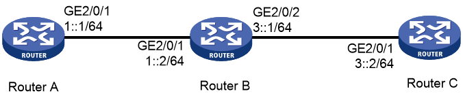

A link or router failure on a path can cause packet loss and even routing loop until RIPng completes routing convergence based on the new network topology. FRR enables fast rerouting to minimize the impact of link or node failures.
Figure 1 Network diagram for RIPng FRR
As shown in Figure 1, configure FRR on Router B by using a routing policy to specify a backup next hop. When the primary link fails, RIPng directs packets to the backup next hop. At the same time, RIPng calculates the shortest path based on the new network topology. Then, the device forwards packets over that path after network convergence.

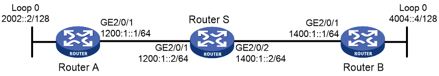

RIPng configuration examples
Example: Configuring basic RIPng
As shown in Figure 2, Router A, Router B, and Router C learn IPv6 routing information through RIPng.
Configure Router B to filter the route (2::/64) learned from Router A. The route will not be added to the routing table of Router B, and Router B forwards only the route 4::/64 to Router A.
Figure 2 Network diagram

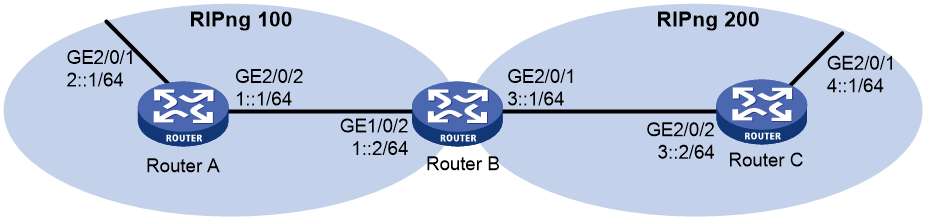

Example: Configuring RIPng route redistribution
As shown in Figure 3, Router B communicates with Router A through RIPng 100 and with Router C through RIPng 200.
Configure route redistribution on Router B, so the two RIPng processes can redistribute routes from each other.
Figure 3 Network diagram
1.     Configure IPv6 addresses for the interfaces. (Details not shown.)
2.     Configure basic RIPng settings:
# Enable RIPng 100 on Router A.
<RouterA> system-view
[RouterA] ripng 100
[RouterA-ripng-100] quit
[RouterA] interface gigabitethernet 2/0/1
[RouterA-GigabitEthernet2/0/1] ripng 100 enable
[RouterA-GigabitEthernet2/0/1] quit
[RouterA] interface gigabitethernet 2/0/2
[RouterA-GigabitEthernet2/0/2] ripng 100 enable
# Enable RIPng 100 and RIPng 200 on Router B.
<RouterB> system-view
[RouterB] ripng 100
[RouterB-ripng-100] quit
[RouterB] interface gigabitethernet 2/0/2
[RouterB-GigabitEthernet2/0/2] ripng 100 enable
[RouterB-GigabitEthernet2/0/2] quit
[RouterB] ripng 200
[RouterB-ripng-200] quit
[RouterB] interface gigabitethernet 2/0/1
[RouterB-GigabitEthernet2/0/1] ripng 200 enable
#  Enable RIPng 200 on Router C.
<RouterC> system-view
[RouterC] ripng 200
[RouterC] interface gigabitethernet 2/0/1
[RouterC-GigabitEthernet2/0/1] ripng 200 enable
[RouterC-GigabitEthernet2/0/1] quit
[RouterC] interface gigabitethernet 2/0/2
[RouterC-GigabitEthernet2/0/2] ripng 200 enable
[RouterC-GigabitEthernet2/0/2] quit
# Display the routing table on Router A.
[RouterA] display ipv6 routing-table
Destinations : 7 Routes : 7
Destination: ::1/128                                     Protocol  : Direct
NextHop    : ::1                                         Preference: 0
Interface  : InLoop0                                     Cost      : 0
Destination: 1::/64                                      Protocol  : Direct
NextHop    : 1::1                                        Preference: 0
Interface  : GE2/0/2                                     Cost      : 0
Destination: 1::1/128                                    Protocol  : Direct
Destination: 2::/64                                      Protocol  : Direct
NextHop    : ::                                          Preference: 0
Interface  : GE2/0/1                                     Cost      : 0
Destination: 2::1/128                                    Protocol  : Direct
Destination: FE80::/10                                   Protocol  : Direct
Interface  : NULL0                                       Cost      : 0
Destination: FF00::/8                                    Protocol  : Direct
3.     Configure RIPng route redistribution:
# Configure route redistribution between the two RIPng processes on Router B.
[RouterB] ripng 100
[RouterB-ripng-100] import-route ripng 200
[RouterB] ripng 200
[RouterB-ripng-200] import-route ripng 100

Example: Configuring RIPng GR
As shown in Figure 4, Router A, Router B, and Router C learn IPv6 routing information through RIPng.
Configure Router A as the GR restarter. Configure Router B and Router C as the GR helpers to synchronize their routing tables with Router A by using GR.
Figure 4 Network diagram
2.     Configure RIPng on the routers to ensure the following: (Details not shown.)
¡     Router A, Router B, and Router C can communicate with each other at Layer 3.
¡     Dynamic route update can be implemented among them with RIPng.
3.     Enable RIPng GR on Router A.
[RouterA] ripng 1
[RouterA-ripng-1] graceful-restart
# Restart RIPng or trigger an active/standby switchover, and then display GR status on Router A.
<RouterA> display ripng 1 graceful-restart
RIPng process: 1
 Graceful Restart capability    : Enabled
 Current GR state               : Normal
 Graceful Restart period        : 60  seconds
 Graceful Restart remaining time: 0   seconds
Example: Configuring RIPng NSR
As shown in Figure 5, Router S, Router A, and Router B learn IPv6 routing information through RIPng.
Enable RIPng NSR on Router S to ensure correct routing when an active/standby switchover occurs on Router S.
Figure 5 Network diagram
¡     Router S, Router A, and Router B can communicate with each other at Layer 3.
3.     Enable RIPng NSR on Router S.
<RouterS> system-view
[RouterS] ripng 1
[RouterS-ripng-1] non-stop-routing
[RouterS-ripng-1] quit
# Perform an active/standby switchover on Router S.
[RouterS] placement reoptimize
Predicted changes to the placement
Program                           Current location       New location
lb                                0/0                    0/0
lsm                               0/0                    0/0
slsp                              0/0                    0/0
rib6                              0/0                    0/0
routepolicy                       0/0                    0/0
rib                               0/0                    0/0
staticroute6                      0/0                    0/0
staticroute                       0/0                    0/0
eviisis                           0/0                    0/0
ospf                              0/0                    1/0
Continue? [y/n]:y
Re-optimization of the placement start. You will be notified on completion
Re-optimization of the placement complete. Use 'display placement' to view the new placement
# During the switchover period, display RIPng neighbors on Router A to verify the neighbor relationship between Router A and Router S.
[RouterA] display ripng 1 neighbor
 Neighbor Address: FE80::AE45:5CE7:422E:2867
     Interface  : GigabitEthernet2/0/1
     Version    : RIPng version 1     Last update: 00h00m23s
     Bad packets: 0                   Bad routes : 0
# Display RIPng routes on Router A to verify if Router A has a route to the loopback interface on Router B.
[RouterA] display ripng 1 route
   Route Flags: A - Aging, S - Suppressed, G - Garbage-collect, D - Direct
                O - Optimal, F - Flush to RIB
 Peer FE80::AE45:5CE7:422E:2867 on GigabitEthernet2/0/1
 Destination 1400:1::/64,
     via FE80::AE45:5CE7:422E:2867, cost 1, tag 0, AOF, 1 secs
 Destination 4004::4/128,
     via FE80::AE45:5CE7:422E:2867, cost 2, tag 0, AOF, 1 secs
 Local route
 Destination 2002::2/128,
     via ::, cost 0, tag 0, DOF
 Destination 1200:1::/64,
# Display RIPng neighbors on Router B to verify the neighbor relationship between Router B and Router S.
[RouterB] display ripng 1 neighbor
 Neighbor Address: FE80::20C:29FF:FECE:6277
     Version    : RIPng version 1     Last update: 00h00m18s
# Display RIPng routes on Router B to verify if Router B has a route to the loopback interface on Router A.
[RouterB] display ripng 1 route
 Peer FE80::20C:29FF:FECE:6277 on GigabitEthernet2/0/1
     via FE80::20C:29FF:FECE:6277, cost 2, tag 0, AOF, 24 secs
     via FE80::20C:29FF:FECE:6277, cost 1, tag 0, AOF, 24 secs
 Local route
The output shows the following when an active/standby switchover occurs on Router S:
·     The neighbor relationships and routing information on Router A and Router B have not changed.
·     The traffic from Router A to Router B has not been impacted.
