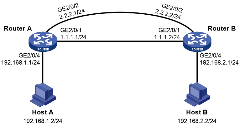

As shown in Figure 1, Port A on Router A is the primary interface. Port B (with a priority of 30) and Port C (with a priority of 20) are its backup interfaces.
·     When Port A is operating correctly, all traffic is transmitted through Port A.
·     When Port A fails, Port B takes over because it has higher priority than Port C. If Port B also fails, Port C takes over.
·     When Port A is recovered, it preempts the active backup interface because it is the primary interface. If Port B is recovered while Port A is still down, Port B cannot preempt Port C to forward traffic.
Figure 1 Strict active/backup mode

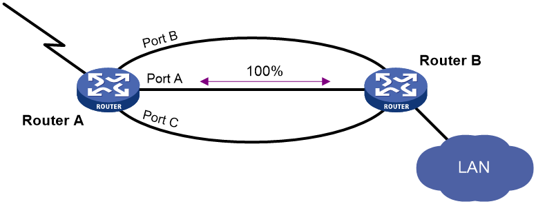

As shown in Figure 2, Port A on Router A is the primary interface. Port B (with a priority of 30) and Port C (with a priority of 20) are its backup interfaces.
·     When the amount of traffic on Port A exceeds the upper threshold, Port B is activated, because it has higher priority than Port C. If the amount of traffic on Port A still exceeds the upper threshold, Port C is activated.
·     When the total amount of traffic on all load-shared interfaces decreases below the lower threshold, Port C is first deactivated, because its priority is lower than Port B. If the total amount of traffic on Port A and Port B is still below the lower threshold, Port B is deactivated.
Figure 2 Load sharing mode

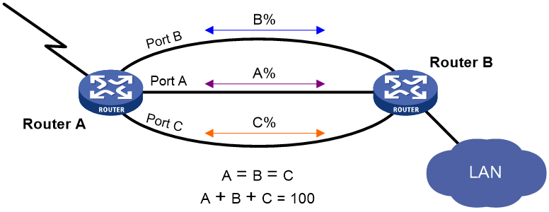

As shown in Figure 3:
·     Specify GigabitEthernet 2/0/2 and GigabitEthernet 2/0/3 on Router A to back up GigabitEthernet 2/0/1.
·     Assign GigabitEthernet 2/0/2 a higher priority than GigabitEthernet 2/0/3.
·     Set the up and down delay timers to 10 seconds for the backup interfaces.
Figure 3 Network diagram

Example: Configuring strict active/standby interface backup with the Track module
As shown in Figure 4, configure a track entry to monitor the link state of GigabitEthernet 2/0/1. When the link of GigabitEthernet 2/0/1 fails, the backup interface GigabitEthernet 2/0/2 comes up to take over.
Figure 4 Network diagram
1.     Assign IP addresses to the interfaces, as shown in Figure 4. (Details not shown.)
2.     Configure static routes:
# On Router A, configure static routes to 192.168.2.0/24 through the primary and backup interfaces.
<RouterA> system-view
[RouterA] ip route-static 192.168.2.0 24 gigabitethernet 2/0/1 1.1.1.2
[RouterA] ip route-static 192.168.2.0 24 gigabitethernet 2/0/2 2.2.2.2
# On Router B, configure static routes to 192.168.1.0/24.
<RouterB> system-view
[RouterB] ip route-static 192.168.1.0 24 gigabitethernet 2/0/1 1.1.1.1
[RouterB] ip route-static 192.168.1.0 24 gigabitethernet 2/0/2 2.2.2.1
3.     On Router A, configure Track settings:
# Configure track entry 1 to monitor the link state of GigabitEthernet 2/0/1.
[RouterA] track 1 interface gigabitethernet 2/0/1
# Associate track entry 1 with the backup interface GigabitEthernet 2/0/2.
[RouterA] interface gigabitethernet 2/0/2
[RouterA-GigabitEthernet2/0/2] backup track 1
[RouterA-GigabitEthernet2/0/2] quit
# Verify that the backup interface GigabitEthernet 2/0/2 is in STANDBY state while the primary link is operating correctly.
[RouterA] display interface-backup state
IB Track Information:
  GE2/0/2                   Track: 1    State: STANDBY
# Shut down the primary interface GigabitEthernet 2/0/1.
[RouterA] interface gigabitethernet 2/0/1
[RouterA-GigabitEthernet2/0/1] shutdown
# Verify that the backup interface GigabitEthernet 2/0/2 comes up after the primary link goes down.
[RouterA-GigabitEthernet2/0/1] display  interface-backup state
  GE2/0/2                   Track: 1    State: UP
Example: Configuring load-shared interface backup
As shown in Figure 5:
·     Configure GigabitEthernet 2/0/2 and GigabitEthernet 2/0/3 on Router A to back up the primary interface GigabitEthernet 2/0/1.
·     Assign GigabitEthernet 2/0/2 higher priority than GigabitEthernet 2/0/3.
·     On the primary interface:
¡     Specify the interface bandwidth used for traffic load calculation.
¡     Set the upper and lower thresholds to 80 and 20, respectively.
Figure 5 Network diagram
1.     Assign IP addresses to the interfaces, as shown in Figure 5. (Details not shown.)
[RouterA] ip route-static 192.168.2.0 24 gigabitethernet 2/0/3 3.3.3.2
[RouterB] ip route-static 192.168.1.0 24 gigabitethernet 2/0/3 3.3.3.1
3.     On Router A, configure backup interfaces and traffic thresholds:
# Specify GigabitEthernet 2/0/2 and GigabitEthernet 2/0/3 to back up GigabitEthernet 2/0/1, and assign them with a priority of 30 and 20, respectively.
[RouterA-GigabitEthernet2/0/1] backup interface gigabitethernet 2/0/2 30
[RouterA-GigabitEthernet2/0/1] backup interface gigabitethernet 2/0/3 20
# Set the expected bandwidth to 10000 kbps on the primary interface.
[RouterA-GigabitEthernet2/0/1] bandwidth 10000
# Set the upper and lower thresholds to 80 and 20, respectively.
[RouterA-GigabitEthernet2/0/1] backup threshold 80 20
# Display traffic statistics for load-shared interfaces.
[RouterA-GigabitEthernet2/0/1] display interface-backup statistics
Interface: GigabitEthernet2/0/1
  Statistics interval: 30 s
  Bandwidth: 10000000 bps
  PrimaryTotalIn: 102 bytes
  PrimaryTotalOut: 108 bytes
  PrimaryIntervalIn: 102 bytes
  PrimaryIntervalOut: 108 bytes
  Primary used bandwidth: 28 bps
  TotalIn: 102 bytes
  TotalOut: 108 bytes
  TotalIntervalIn: 102 bytes
  TotalIntervalOut: 108 bytes
  Total used bandwidth: 28 bps
The output shows that the upper traffic threshold has not been exceeded. All traffic is transmitted through the primary interface GigabitEthernet 2/0/1.
# Verify that both backup interfaces are in STANDBY state because the upper threshold has not been exceeded.
Interface: GE2/0/1
  UpDelay: 5 s
  DownDelay: 5 s
  Upper threshold: 80
  Lower threshold: 20
  State: UP
  Backup interfaces:
    GE2/0/2                Priority: 30   State: STANDBY
    GE2/0/3                Priority: 20   State: STANDBY
# Increase the incoming or outgoing traffic rate to be higher than 8000 kbps (80% of the specified bandwidth) on the primary interface. (Details not shown.)
# Verify that the backup interface GigabitEthernet 2/0/2 comes up to participate in traffic forwarding, because it has higher priority than GigabitEthernet 2/0/3.
Interface: GE2/0/1
  UpDelay: 5 s
  DownDelay: 5 s
  Upper threshold: 80
  Lower threshold: 20
  State: UP
  Backup interfaces:
    GE2/0/2                Priority: 30   State: UP
