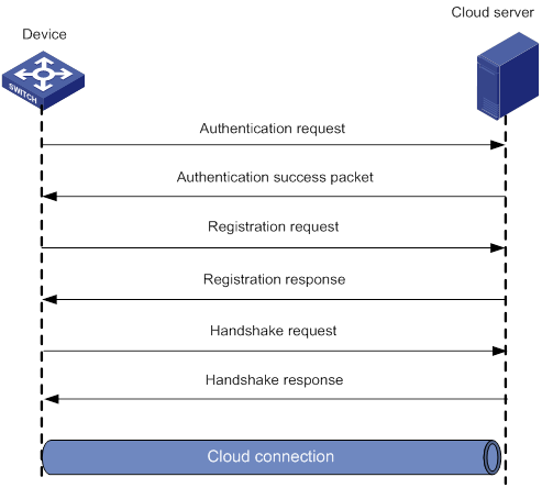

Cloud connection establishment
The cloud connection is established as follows:
1.        The device sends an authentication request to the cloud server.
2.        The cloud server sends an authentication success packet to the device.
The device passes the authentication only if the serial number of the device has been added to the cloud server. If the authentication fails, the cloud server sends an authentication failure packet to the device.
3.        The device sends a registration request to the cloud server.
4.        The cloud server sends a registration response to the device.
The registration response contains the uniform resource locator (URL) used to establish a cloud connection.
5.        The device uses the URL to send a handshake request (changing the protocol from HTTP to WebSocket) to the cloud server.
6.        The cloud server sends a handshake response to the device to finish establishing the cloud connection.
7.        The device sends a subconnection URL request to the cloud server.
8.        The cloud server sends a response that contains the microservice list and all subconnection URLs to the device.
9.        The service module registers on the cloud connection management module.
10.     The cloud connection management module sends the corresponding URLs to the service module.
11.     The service module establishes subconnections with the cloud server.
Figure 1 Establishing a cloud connection

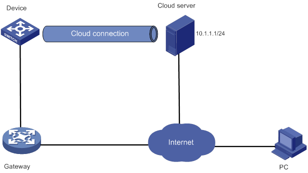

As shown in Figure 2, configure the device to establish a cloud connection with the cloud server.
Figure 2 Network diagram
1.        Configure IP addresses for interfaces, and configure a routing protocol to ensure that the devices can reach each other. (Details not shown.)
2.        Log in to the cloud server to add the serial number of the device to the server. (Details not shown.)
The IP address of the cloud server is 10.1.1.1/24 and the domain name is cloud.com.
3.        Configure the domain name of the cloud server as cloud.com.
<Device> system-view
[Device] cloud-management server domain cloud.com
# Map IP address 10.1.1.1 to host name cloud.com.
[Device] ip host cloud.com 10.1.1.1
# Verify that the device and the cloud server have established a cloud connection.
[Device] display cloud-management state
Cloud connection state   : Established
Device state             : Request_success
Cloud server address     : 10.1.1.1
Cloud server domain name : cloud.com
Cloud server port        : 443
Connected at             : Wed Jan  27 14:18:40 2016
Duration                 : 00d 00h 02m 01s
