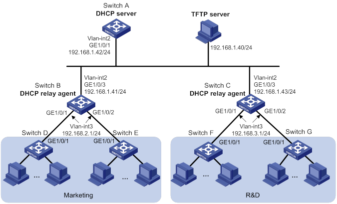

Example: Using a TFTP server for automatic configuration
As shown in Figure 2, two departments of a company are connected to the network through gateways (Switch B and Switch C). Access devices Switch D, Switch E, Switch F, and Switch G do not have a configuration file.
Configure the servers and gateways so the access devices can obtain a configuration file to complete the following configuration tasks:
·          Enable administrators of access devices to Telnet to and manage their respective access devices.
·          Require administrators to enter their respective usernames and passwords at login.
Figure 2 Network diagram
1.        Configure the DHCP server:
# Create a VLAN interface and assign an IP address to the interface.
<SwitchA> system-view
[SwitchA] vlan 2
[SwitchA-vlan2] port gigabitethernet 1/0/1
[SwitchA-vlan2] quit
[SwitchA-Vlan-interface2] ip address 192.168.1.42 24
# Enable DHCP.
[SwitchA] dhcp enable
# Enable the DHCP server on VLAN-interface 2.
[SwitchA-Vlan-interface2] dhcp select server
# Configure address pool market to assign IP addresses on the 192.168.2.0/24 subnet to clients in the Marketing department. Specify the TFTP server, gateway, and configuration file name for the clients.
[SwitchA] dhcp server ip-pool market
[SwitchA-dhcp-pool-market] network 192.168.2.0 24
[SwitchA-dhcp-pool-market] tftp-server ip-address 192.168.1.40
[SwitchA-dhcp-pool-market] gateway-list 192.168.2.1
[SwitchA-dhcp-pool-market] bootfile-name market.cfg
[SwitchA-dhcp-pool-market] quit
# Configure address pool rd to assign IP addresses on the 192.168.3.0/24 subnet to clients in the R&D department. Specify the TFTP server, gateway, and configuration file name for the clients.
[SwitchA] dhcp server ip-pool rd
[SwitchA-dhcp-pool-rd] network 192.168.3.0 24
[SwitchA-dhcp-pool-rd] tftp-server ip-address 192.168.1.40
[SwitchA-dhcp-pool-rd] gateway-list 192.168.3.1
[SwitchA-dhcp-pool-rd] bootfile-name rd.cfg
[SwitchA-dhcp-pool-rd] quit
# Configure static routes to the DHCP relay agents.
[SwitchA] ip route-static 192.168.2.0 24 192.168.1.41
[SwitchA] ip route-static 192.168.3.0 24 192.168.1.43
[SwitchA] quit
2.        Configure the gateway Switch B:
# Create VLAN interfaces and assign IP addresses to the interfaces.
<SwitchB> system-view
[SwitchB] vlan 2
[SwitchB-vlan2] port gigabitethernet 1/0/3
[SwitchB-vlan2] quit
[SwitchB-Vlan-interface2] ip address 192.168.1.41 24
[SwitchB-Vlan-interface2] quit
[SwitchB] vlan 3
[SwitchB-vlan3] port gigabitethernet 1/0/1
[SwitchB-vlan3] port gigabitethernet 1/0/2
[SwitchB-vlan3] quit
[SwitchB] interface vlan-interface 3
[SwitchB-Vlan-interface3] ip address 192.168.2.1 24
[SwitchB-Vlan-interface3] quit
# Enable DHCP.
[SwitchB] dhcp enable
# Enable the DHCP relay agent on VLAN-interface 3.
[SwitchB-Vlan-interface3] dhcp select relay
# Specify the DHCP server address.
[SwitchB-Vlan-interface3] dhcp relay server-address 192.168.1.42
3.        Configure the gateway Switch C:
<SwitchC> system-view
[SwitchC] vlan 2
[SwitchC-vlan2] port gigabitethernet 1/0/3
[SwitchC-vlan2] quit
[SwitchC] interface vlan-interface 2
[SwitchC-Vlan-interface2] ip address 192.168.1.43 24
[SwitchC-Vlan-interface2] quit
[SwitchC] vlan 3
[SwitchC-vlan3] port gigabitethernet 1/0/1
[SwitchC-vlan3] port gigabitethernet 1/0/2
[SwitchC-vlan3] quit
[SwitchC] interface vlan-interface 3
[SwitchC-Vlan-interface3] ip address 192.168.3.1 24
[SwitchC-Vlan-interface3] quit
# Enable DHCP.
[SwitchC] dhcp enable
[SwitchC-Vlan-interface3] dhcp select relay
[SwitchC-Vlan-interface3] dhcp relay server-address 192.168.1.42
4.        Configure the TFTP server:
# On the TFTP server, create a configuration file named market.cfg.
 sysname Market
 telnet server enable
vlan 3
local-user market
 password simple market
 service-type telnet
interface Vlan-interface3
 ip address dhcp-alloc
interface gigabitethernet 1/0/1
 port access vlan 3
user-interface vty 0 63
 authentication-mode scheme
 user-role network-admin
return
# On the TFTP server, create a configuration file named rd.cfg.
 sysname RD
vlan 3
local-user rd
 password simple rd
 service-type telnet
 port access vlan 3
return
# Start TFTP service software, and specify the folder where the two configuration files reside as the working directory. (Details not shown.)
# Verify that the TFTP server and DHCP relay agents can reach each other. (Details not shown.)
1.        Power on Switch D, Switch E, Switch F, and Switch G.
2.        After the access devices start up, display assigned IP addresses on Switch A.
<SwitchA> display dhcp server ip-in-use
IP address       Client-identifier/    Lease expiration      Type
                 Hardware address
192.168.2.2      3030-3066-2e65-3233-  May 6 05:21:25 2013   Auto(C)
                 642e-3561-6633-2d56-
                 6c61-6e2d-696e-7465-
                 7266-6163-6533
192.168.2.3      3030-3066-2e65-3230-  May 6 05:22:50 2013   Auto(C)
                 302e-3232-3033-2d56-
                 7266-6163-6533
192.168.3.2      3030-6530-2e66-6330-  May 6 05:23:15 2013   Auto(C)
                 302e-3335-3131-2d56-
                 7266-6163-6531
192.168.3.3      3030-6530-2e66-6330-  May 6 05:24:10 2013   Auto(C)
                 302e-3335-3135-2d56-
                 7266-6163-6532
3.        Telnet to 192.168.2.2 from Switch A.
<SwitchA> telnet 192.168.2.2
4.        Enter username market and password market as prompted. (Details not shown.)
You are logged in to Switch D or Switch E.

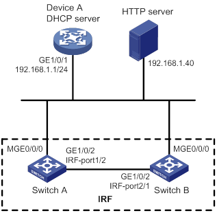

Example: Setting up an IRF fabric
As shown in Figure 5, Switch A and Switch B do not have a configuration file.
Configure the servers so the switches can obtain a Python script to complete their respective configurations and form an IRF fabric.
Figure 5 Network diagram
1.        Assign IP addresses to the interfaces. Make sure the devices can reach each other. (Details not shown.)
2.        Configure the following files on the HTTP server:
File
Content
Remarks
.cfg configuration file
Commands required for IRF setup.
You can create a configuration file by copying and modifying the configuration file of an existing IRF fabric.
sn.txt
Serial numbers of the member switches.
Each SN uniquely identifies a switch.
These SNs will be used for assigning a unique IRF member ID to each member switch.
(Optional.) .ipe or .bin software image file
Software images.
If the member switches are running different software versions, you must prepare the software image file used for software upgrade.
.py Python script file
Python commands that complete the following tasks:
a         (Optional.) Verify that the flash memory has sufficient space for the files to be downloaded.
b        Download the configuration file and sn.txt.
c         (Optional.) Download the software image file and specify it as the main startup image file.
d        Resolve sn.txt and assign a unique IRF member ID to each SN.
e         Specify the configuration file as the main next-startup configuration file.
f          Reboot the member switches.
For more information about Python script configuration, see "Using Python."
3.        Configure Device A as the DHCP server:
# Enable DHCP.
<DeviceA> system-view
[DeviceA] dhcp enable
# Configure address pool 1 to assign IP addresses on the 192.168.1.0/24 subnet to clients.
[DeviceA] dhcp server ip-pool 1
[DeviceA-dhcp-pool-1] network 192.168.1.0 24
# Specify the URL of the script file for the clients.
[DeviceA-dhcp-pool-1] bootfile-name http://192.168.1.40/device.py
[DeviceA-dhcp-pool-1] quit
# Enable the DHCP server on GigabitEthernet 1/0/1.
[DeviceA-GigabitEthernet1/0/1] dhcp select server
[DeviceA-GigabitEthernet1/0/1] quit
4.        Power on Switch A and Switch B.
Switch A and Switch B will obtain the Python script file from the DHCP server and execute the script. After completing the IRF configuration, Switch A and Switch B reboot.
5.        After Switch A and Switch B start up again, use a cable to connect Switch A and Switch B through their IRF physical ports.
Switch A and Switch B will elect a master member. The subordinate member will reboot to join the IRF fabric.
# On Switch A, display IRF member devices. You can also use the display irf command on Switch B to display IRF member devices.
<Switch A> display irf
MemberID  Slot  Role    Priority  CPU-Mac         Description
   1      1     Standby 1         00e0-fc0f-8c02  ---
 *+2      1     Master  30        00e0-fc0f-8c14  ---
 * indicates the device is the master.
 + indicates the device through which the user logs in.
 The Bridge MAC of the IRF is: 000c-1000-1111
 Auto upgrade                : yes
 Mac persistent              : always
 Domain ID                   : 0
 Auto merge                  : yes
The output shows that the switches have formed an IRF fabric.
