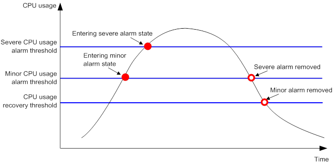

Monitoring CPU usage
About CPU usage monitoring
To monitor CPU usage, the device performs the following operations:
·          Samples CPU usage at 1-minute intervals, and compares the samples with CPU usage thresholds to identify the CPU usage status and send alarms or notifications accordingly.
·          Samples and saves CPU usage at a configurable interval if CPU usage tracking is enabled. You can use the display cpu-usage history command to display the historical CPU usage statistics in a coordinate system.
The device supports the following CPU usage thresholds:
·          Minor thresholdIf the CPU usage increases to or above the minor threshold but is less than the severe threshold, the CPU usage enters minor alarm state. The device sends minor alarms periodically until the CPU usage increases above the severe threshold or the minor alarm is removed.
·          Severe thresholdIf the CPU usage increases above the severe threshold, the CPU usage enters severe alarm state. The device sends severe alarms periodically until the severe alarm is removed.
·          Recovery thresholdIf the CPU usage decreases below the recovery threshold, the CPU usage enters recovered state. The device sends a recovery notification.
CPU usage alarms and notifications can be sent to NETCONF, SNMP, and the information center to be encapsulated as NETCONF events, SNMP traps and informs, and log messages. For more information, see NETCONF, SNMP, and information center in Network Management and Monitoring Configuration Guide.
Figure 1 CPU alarms and alarm-removed notifications
1.        Enter system view.
2.        Set the CPU usage alarm thresholds.
monitor cpu-usage threshold severe-threshold minor-threshold minor-threshold recovery-threshold recovery-threshold [ slot slot-number [ cpu cpu-number ] ]
The default settings are as follows:
¡  Severe CPU usage alarm threshold99%.
¡  Minor CPU usage alarm threshold98%.
¡  CPU usage recovery threshold50%.
3.        Set CPU usage alarm resending intervals.
monitor resend cpu-usage { minor-interval minor-interval | severe-interval severe-interval } * [ slot slot-number [ cpu cpu-number ] ]
By default, the minor alarm resending interval is 300 seconds and the severe alarm resending interval is 60 seconds.
4.        Set the sampling interval for CPU usage tracking.
monitor cpu-usage interval interval [ slot slot-number [ cpu cpu-number ] ]
By default, the sampling interval for CPU usage tracking is 1 minute.
5.        Enable CPU usage tracking.
monitor cpu-usage enable [ slot slot-number [ cpu cpu-number ] ]
By default, CPU usage tracking is enabled.

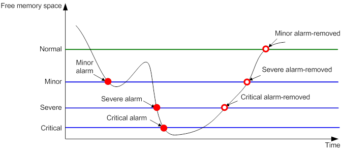

Setting memory alarm thresholds
About memory alarm thresholds
To ensure correct operation and improve memory efficiency, the system monitors the amount of free memory space in real time. If the amount of free memory space reaches the minor, severe, or critical alarm threshold, the system issues an alarm to affected service modules and processes.
As shown in Table 1 and Figure 2, the system supports the following free-memory thresholds:
·          Normal state threshold.
·          Minor alarm threshold.
·          Severe alarm threshold.
·          Critical alarm threshold.
Table 1 Memory alarm notifications and memory alarm-removed notifications
Notification
Triggering condition
Remarks
Minor alarm notification
The amount of free memory space decreases to or below the minor alarm threshold for the first time.
After generating and sending a minor alarm notification, the system does not generate and send any additional minor alarm notifications until the first minor alarm is removed.
Severe alarm notification
The amount of free memory space decreases to or below the severe alarm threshold for the first time.
After generating and sending a severe alarm notification, the system does not generate and send any additional severe alarm notifications until the first severe alarm is removed.
Critical alarm notification
The amount of free memory space decreases to or below the critical alarm threshold for the first time.
After generating and sending a critical alarm notification, the system does not generate and send any additional critical alarm notifications until the first critical alarm is removed.
Critical alarm-removed notification
The amount of free memory space increases to or above the severe alarm threshold.
N/A
Severe alarm-removed notification
The amount of free memory space increases to or above the minor alarm threshold.
N/A
Minor alarm-removed notification
The amount of free memory space increases to or above the normal state threshold.
N/A
Figure 2 Memory alarm notifications and alarm-removed notifications
2.        Set the memory usage threshold.
memory-threshold [ slot slot-number [ cpu cpu-number ] ] usage memory-threshold
By default, the memory usage threshold is 100%.
3.        Set the free-memory thresholds.
memory-threshold [ slot slot-number [ cpu cpu-number ] ] [ ratio ] minor minor-value severe severe-value critical critical-value normal normal-value
¡  Minor alarm threshold60 MB.
¡  Severe alarm threshold56 MB.
¡  Critical alarm threshold52 MB.
¡  Normal state threshold64 MB.

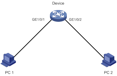

Example: Scheduling a task
As shown in Figure 3, two interfaces of the device are connected to users.
To save energy, configure the device to perform the following operations:
·          Enable the interfaces at 8:00 a.m. every Monday through Friday.
·          Disable the interfaces at 18:00 every Monday through Friday.
Figure 3 Network diagram
