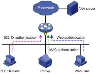

Typical network of triple authentication
Triple authentication is suitable for a LAN that comprises terminals that require different authentication services, as shown in Figure 1. The triple authentication-enabled access port can perform MAC authentication for the printer, 802.1X authentication for the PC installed with the 802.1X client, and Web authentication for the Web user.
Figure 1 Triple authentication network diagram
Triple authentication mechanism
The three types of authentication are triggered by different packets:
· The access port performs MAC authentication for a terminal when it receives an ARP or DHCP broadcast packet from the terminal for the first time. If the terminal passes MAC authentication, the terminal can access the network. If the MAC authentication fails, the access port performs 802.1X or Web authentication.
· The access port performs 802.1X authentication when it receives an EAP packet from an 802.1X client or a third-party client. If the unicast trigger feature of 802.1X is enabled on the access port, any packet from the client can trigger an 802.1X authentication.
· The access port performs Web authentication when it receives an HTTP packet from a terminal.
If a terminal triggers different types of authentication, the authentications are processed at the same time. The failure of one type of authentication does not affect the others. When a terminal passes one type of authentication, the other types of authentication are processed as follows:
· If the terminal first passes MAC authentication, Web authentication is terminated immediately, but 802.1X authentication will proceed. If the terminal also passes 802.1X authentication, the 802.1X authentication information will overwrite the MAC authentication information for the terminal. If the terminal fails 802.1X authentication, the user stays online as a MAC authentication user, and only 802.1X authentication can be triggered again.
· If the terminal first passes 802.1X or Web authentication, the other types of authentication are terminated immediately and cannot be triggered again.

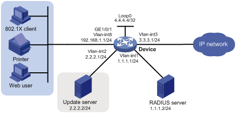

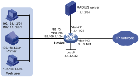

As shown in Figure 2, the terminals are connected to the device to access the IP network. Configure triple authentication on the device's Layer 2 interface that connects to the terminals. A terminal passing one of the three authentication methods, 802.1X authentication, Web authentication, and MAC authentication, can access the IP network.
· Assign IP addresses on subnet 192.168.1.0/24 to the terminals.
· Use the remote RADIUS server to perform authentication, authorization, and accounting. Configure the device to send usernames carrying no ISP domain names to the RADIUS server.
· Configure the local Web authentication server on the device to use listening IP address 4.4.4.4. Configure the device to send a default authentication page to the Web user and forward authentication data by using HTTP.
1. Make sure that the terminals, the server, and the device can reach each other. (Details not shown.)

Example: Configuring triple authentication to support authorization VLAN and authentication failure VLAN
As shown in Figure 3, the terminals are connected to the device to access the IP network. Configure triple authentication on the device's Layer 2 interface connected to the terminals. A terminal passing one of the three authentication methods, 802.1X authentication, Web authentication, and MAC authentication, can access the IP network.
· The Web authentication terminal uses DHCP to get an IP address in 192.168.1.0/24 before authentication and in 3.3.3.0/24 after passing authentication. If the terminal fails authentication, it requests IP addresses in 2.2.2.0/24 through DHCP.
You can use the access device or an attached device as the DHCP server. In this example, the access device (the device) provides the DHCP service.
· The 802.1X terminal uses DHCP to get an IP address in 192.168.1.0/24 before authentication and in 3.3.3.0/24 after passing authentication. If the terminal fails authentication, it requests IP addresses in 2.2.2.0/24 through DHCP.
· After passing authentication, the printer obtains IP address 3.3.3.111/24 that is bound with its MAC address through DHCP.
· Use the remote RADIUS server to perform authentication, authorization, and accounting. Configure the device to remove the ISP domain names from usernames sent to the RADIUS server.
· Configure VLAN 3 as the authorization VLAN. Users passing authentication are added to this VLAN.
· Configure VLAN 2 as the authentication failure VLAN. Users failing authentication are added to this VLAN.
