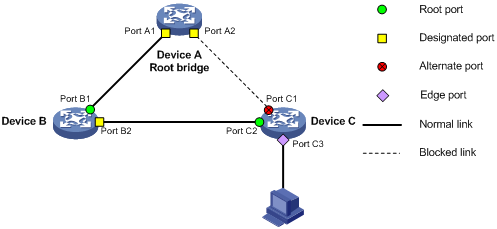

As shown in Figure 3, Device B and Device C are directly connected to a LAN.
If Device A forwards BPDUs to Device B through port A1, the designated bridge and designated port are as follows:
·          The designated bridge for Device B is Device A.
·          The designated port for Device B is port A1 on Device A.
If Device B forwards BPDUs to the LAN, the designated bridge and designated port are as follows:
·          The designated bridge for the LAN is Device B.
·          The designated port for the LAN is port B2 on Device B.
Figure 3 Designated bridges and designated ports

Example of STP calculation
Figure 4 provides an example showing how the STP algorithm works.
Figure 4 The STP algorithm
As shown in Figure 4, the priority values of Device A, Device B, and Device C are 0, 1, and 2, respectively. The path costs of links among the three devices are 5, 10, and 4.

Final calculated spanning tree
After the comparison processes described in Table 4, a spanning tree with Device A as the root bridge is established, as shown in Figure 5.
Figure 5 The final calculated spanning tree

Edge port rapid transition
As shown in Figure 12, Port C3 is an edge port connected to a host. When a network topology change occurs, the port can immediately transit from the blocking state to the forwarding state because no loop will be caused.
Because a device cannot determine whether a port is directly connected to a terminal, you must manually configure the port as an edge port.
Figure 12 Edge port rapid transition

Disabling dispute guard
About dispute guard
Dispute guard can be triggered by unidirectional link failures. If an upstream port receives inferior BPDUs from a downstream designated port in forwarding or learning state because of a unidirectional link failure, a loop appears. Dispute guard blocks the upstream designated port to prevent the loop.
As shown in Figure 19, in normal conditions, the spanning tree calculation result is as follows:
·          Device A is the root bridge, and Port A1 is a designated port.
·          Port B1 is blocked.
When the link between Port A1 and Port B1 fails in the direction of Port A1 to Port B1 and becomes unidirectional, the following events occur:
1.        Port A1 can only receive BPDUs and cannot send BPDUs to Port B1.
2.        Port B1 does not receive BPDUs from Port A1 for a certain period of time.
3.        Device B determines itself as the root bridge.
4.        Port B1 sends its BPDUs to Port A1.
5.        Port A1 determines the received BPDUs are inferior to its own BPDUs. A dispute is detected.
6.        Dispute guard is triggered and blocks Port A1 to prevent a loop.
Figure 19 Dispute guard triggering scenario (on a designated port)
As shown in Figure 20, in normal conditions, Device A is the root bridge, and Port B1 and Port C1 are root ports. When the links between Device A and Device B become unidirectional (the links fail in the direction of Port A1 to Port B1), the following events occur:
1.        Device B cannot receive BPDUs from Device A.
2.        Device B determines itself as the root bridge.
3.        Port B1 sends BPDUs in which the root bridge is Device B to Port C1.
4.        Port C1 receives BPDUs from two root bridges, Device A and Device B. A dispute is detected.
5.        Dispute guard is triggered and blocks Port C1 to avoid a loop.
Figure 20 Dispute guard triggering scenario (on a root port)
