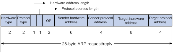

ARP uses two types of messages: ARP request and ARP reply. Figure 1 shows the format of ARP request/reply messages. Numbers in the figure refer to field lengths.
Figure 1 ARP message format
·          Hardware type—Hardware address type. The value 1 represents Ethernet.
·          Protocol type—Type of the protocol address to be mapped. The hexadecimal value 0x0800 represents IP.
·          Hardware address length and protocol address length—Length, in bytes, of a hardware address and a protocol address. For an Ethernet address, the value of the hardware address length field is 6. For an IPv4 address, the value of the protocol address length field is 4.
·          OP—Operation code, which describes the type of ARP message. The value 1 represents an ARP request, and the value 2 represents an ARP reply.
·          Sender hardware address—Hardware address of the device sending the message.
·          Sender protocol address—Protocol address of the device sending the message.
·          Target hardware address—Hardware address of the device to which the message is being sent.
·          Target protocol address—Protocol address of the device to which the message is being sent.

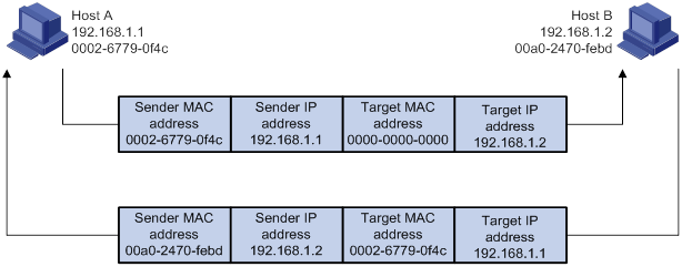

As shown in Figure 2, Host A and Host B are on the same subnet. Host A sends a packet to Host B as follows:
1.        Host A looks through the ARP table for an ARP entry for Host B. If one entry is found, Host A uses the MAC address in the entry to encapsulate the IP packet into a data link layer frame. Then Host A sends the frame to Host B.
2.        If Host A finds no entry for Host B, Host A buffers the packet and broadcasts an ARP request. The payload of the ARP request contains the following information:
¡  Sender IP address and sender MAC address—Host A's IP address and MAC address.
¡  Target IP address—Host B's IP address.
¡  Target MAC address—An all-zero MAC address.
All hosts on this subnet can receive the broadcast request, but only the requested host (Host B) processes the request.
3.        Host B compares its own IP address with the target IP address in the ARP request. If they are the same, Host B operates as follows:
a.    Adds the sender IP address and sender MAC address into its ARP table.
b.    Encapsulates its MAC address into an ARP reply.
c.    Unicasts the ARP reply to Host A.
4.        After receiving the ARP reply, Host A operates as follows:
a.    Adds the MAC address of Host B into its ARP table.
b.    Encapsulates the MAC address into the packet and sends the packet to Host B.
Figure 2 ARP address resolution process

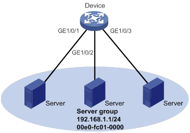

Configuring a multiport ARP entry
About multiport ARP entries
A multiport ARP entry contains an IP address, MAC address, and VLAN ID. The VLAN and output interfaces are specified by a multiport unicast MAC address entry or a multicast MAC address entry.
A multiport ARP entry can overwrite a dynamic, short static or long static ARP entry. Conversely, a short static or long static ARP entry can overwrite a multiport ARP entry.
For a multiport ARP entry to be effective for packet forwarding, make sure the following conditions are met:
·          A multiport unicast MAC address entry or a multicast MAC address entry exists.
·          The IP address in the multiport ARP entry must reside on the same subnet as the VLAN interface of the specified VLAN.
1.        Enter system view.
2.        Configure a multiport unicast MAC address entry or a multicast MAC address entry.
¡  Configure a multiport unicast MAC address entry.
mac-address multiport mac-address interface interface-list vlan vlan-id
For more information about multiport unicast MAC address entries, see the mac-address command in Layer 2—LAN Switching Command Reference.
¡  Configure a multicast MAC address entry.
mac-address multicast mac-address interface interface-list vlan vlan-id
For more information about multicast MAC address entries, see the mac-address multicast command in IGMP snooping commands in IP Multicast Command Reference.
3.        Configure a multiport ARP entry.
arp multiport ip-address mac-address vlan-id [ vpn-instance vpn-instance-name ]
The specified MAC address and VLAN ID must be the same as those in the multiport unicast MAC address entry or the multicast MAC address entry.

Example: Configuring a multiport ARP entry
As shown in Figure 5, a device connects to three servers through interfaces GigabitEthernet 1/0/1, GigabitEthernet 1/0/2, and GigabitEthernet 1/0/3 in VLAN 10. The servers share the IP address 192.168.1.1/24 and MAC address 00e0-fc01-0000.
Configure a multiport ARP entry so that the device sends IP packets with the destination IP address 192.168.1.1 to the three servers.
Figure 5 Network diagram
# Create VLAN 10.
<Device> system-view
[Device] vlan 10
[Device-vlan10] quit
# Add GigabitEthernet 1/0/1, GigabitEthernet 1/0/2, and GigabitEthernet 1/0/3 to VLAN 10.
[Device-GigabitEthernet1/0/1] port access vlan 10
[Device] interface gigabitethernet 1/0/2
[Device-GigabitEthernet1/0/2] port access vlan 10
[Device-GigabitEthernet1/0/2] quit
[Device] interface gigabitethernet 1/0/3
[Device-GigabitEthernet1/0/3] port access vlan 10
[Device-GigabitEthernet1/0/3] quit
# Create VLAN-interface 10 and specify its IP address.
[Device] interface vlan-interface 10
[Device-vlan-interface10] ip address 192.168.1.2 24
[Device-vlan-interface10] quit
# Configure a multiport unicast MAC address entry that has MAC address 00e0-fc01-0000, and output interfaces GigabitEthernet 1/0/1, GigabitEthernet 1/0/2, and GigabitEthernet 1/0/3 in VLAN 10.
[Device] mac-address multiport 00e0-fc01-0000 interface gigabitethernet 1/0/1 to gigabitethernet 1/0/3 vlan 10
# Configure a multiport ARP entry with IP address 192.168.1.1 and MAC address 00e0-fc01-0000.
[Device] arp multiport 192.168.1.1 00e0-fc01-0000 10
# Verify that the device has a multiport ARP entry with IP address 192.168.1.1 and MAC address 00e0-fc01-0000.
[Device] display arp
  Type: S-Static   D-Dynamic   O-Openflow   R-Rule   M-Multiport  I-Invalid
IP address      MAC address    VLAN/VSI   Interface/Link ID        Aging Type
192.168.1.1     00e0-fc01-0000 10         --                       --    M

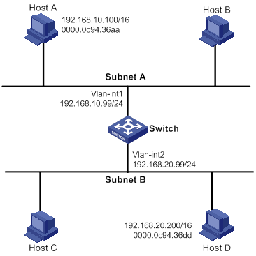

Common proxy ARP configuration example
Example: Configuring common proxy ARP
As shown in Figure 6, Host A and Host D have the same IP prefix and mask, but they are located on different subnets separated by the switch. Host A belongs to VLAN 1, and Host D belongs to VLAN 2. No default gateway is configured on Host A and Host D.
Configure common proxy ARP on the switch to enable communication between the two hosts.
Figure 6 Network diagram
# Create VLAN 2.
<Switch> system-view
[Switch] vlan 2
[Switch-vlan2] quit
# Configure the IP address of VLAN-interface 1.
[Switch] interface vlan-interface 1
[Switch-Vlan-interface1] ip address 192.168.10.99 255.255.255.0
# Enable common proxy ARP on VLAN-interface 1.
[Switch-Vlan-interface1] proxy-arp enable
[Switch-Vlan-interface1] quit
# Configure the IP address of VLAN-interface 2.
[Switch-Vlan-interface2] ip address 192.168.20.99 255.255.255.0
# Enable common proxy ARP on VLAN-interface 2.
[Switch-Vlan-interface2] proxy-arp enable.
# Verify that Host A and Host D can ping each other.
