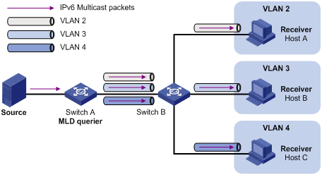

As shown in Figure 1, Host A, Host B, and Host C are in different VLANs and the same IPv6 multicast group. When Switch A (Layer 3 device) receives IPv6 multicast data for that group, it forwards three copies of the data to Switch B (Layer 2 device). This occupies a large amount of bandwidth and increases the burden on the Layer 3 device.
Figure 1 Multicast transmission without the IPv6 multicast VLAN feature
After an IPv6 multicast VLAN is configured on Switch B, Switch A sends one copy of the IPv6 multicast data to the IPv6 multicast VLAN on Switch B. This saves network bandwidth and lessens the burden on the Layer 3 device.

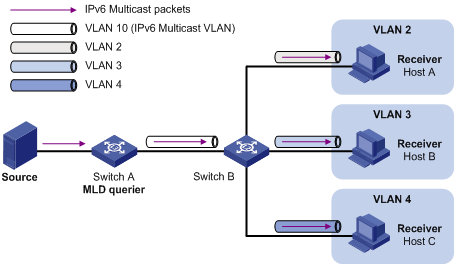

As shown in Figure 2:
·          Host A, Host B, and Host C are in VLAN 2 through VLAN 4, respectively.
·          On Switch B, VLAN 10 is an IPv6 multicast VLAN. VLAN 2 through VLAN 4 are sub-VLANs of VLAN 10.
·          MLD snooping is enabled for the multicast VLAN and its sub-VLANs.
Figure 2 Sub-VLAN-based multicast VLAN
MLD snooping manages router ports in the IPv6 multicast VLAN and member ports in each sub-VLAN. When Switch A receives IPv6 multicast data from the IPv6 multicast source, it sends only one copy of the IPv6 multicast data to the IPv6 multicast VLAN on Switch B. Then, Switch B sends a separate copy to each sub-VLAN of the IPv6 multicast VLAN.

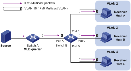

As shown in Figure 3:
·          Host A, Host B, and Host C are in VLAN 2 through VLAN 4, respectively. All the user ports (ports with attached hosts) on Switch B are hybrid ports.
·          On Switch B, VLAN 10 is an IPv6 multicast VLAN. All the user ports are assigned to VLAN 10.
·          MLD snooping is enabled for the IPv6 multicast VLAN and its sub-VLANs.
Figure 3 Port-based IPv6 multicast VLAN
MLD snooping manages the router ports and member ports in the IPv6 multicast VLAN. When Switch A receives IPv6 multicast data from the IPv6 multicast source, it sends only one copy of the IPv6 multicast data to the IPv6 multicast VLAN on Switch B. Then, Switch B sends a separate copy to each user port in the IPv6 multicast VLAN.

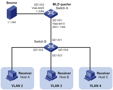

As shown in Figure 4:
·          Layer 3 device Switch A runs MLD and acts as the MLD querier. Layer 2 device Switch B runs MLDv1 snooping.
·          The IPv6 multicast source sends IPv6 multicast data to IPv6 multicast group FF1E::101. Receivers Host A, Host B, and Host C belong to VLAN 2, VLAN 3, and VLAN 4, respectively.
Configure a sub-VLAN-based IPv6 multicast VLAN on Switch B to meet the following requirements:
·          Switch A sends the IPv6 multicast data to Switch B through the IPv6 multicast VLAN.
·          Switch B forwards the IPv6 multicast data to the receivers in different user VLANs.
Figure 4 Network diagram

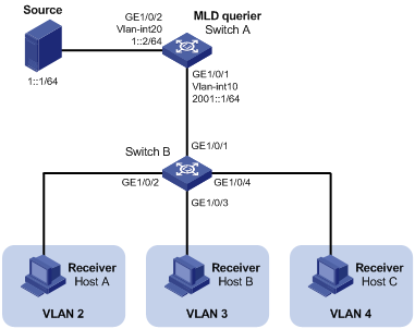

As shown in Figure 5:
·          Layer 3 device Switch A runs MLDv1 and acts as the MLD querier. Layer 2 device Switch B runs MLDv1 snooping.
Configure a port-based IPv6 multicast VLAN on Switch B to meet the following requirements:
·          Switch A sends IPv6 multicast data to Switch B through the IPv6 multicast VLAN.
Figure 5 Network diagram

# Create VLAN 10, assign GigabitEthernet 1/0/1 to the VLAN, and enable MLD snooping for the VLAN.
[SwitchB] vlan 10
[SwitchB-vlan10] port gigabitethernet 1/0/1
[SwitchB-vlan10] mld-snooping enable
[SwitchB-vlan10] quit
# Create VLAN 2, and enable MLD snooping for the VLAN.
[SwitchB] vlan 2
[SwitchB-vlan2] mld-snooping enable
[SwitchB-vlan2] quit
# Create VLAN 3, and enable MLD snooping for the VLAN.
[SwitchB] vlan 3
[SwitchB-vlan3] mld-snooping enable
[SwitchB-vlan3] quit
# Create VLAN 4, and enable MLD snooping for the VLAN.
[SwitchB] vlan 4
[SwitchB-vlan4] mld-snooping enable
[SwitchB-vlan4] quit
# Configure GigabitEthernet 1/0/2 as a hybrid port, and configure VLAN 2 as the PVID of the hybrid port.
[SwitchB] interface gigabitethernet 1/0/2
[SwitchB-GigabitEthernet1/0/2] port link-type hybrid
[SwitchB-GigabitEthernet1/0/2] port hybrid pvid vlan 2
# Assign GigabitEthernet 1/0/2 to VLAN 2 and VLAN 10 as an untagged VLAN member.
[SwitchB-GigabitEthernet1/0/2] port hybrid vlan 2 untagged
[SwitchB-GigabitEthernet1/0/2] port hybrid vlan 10 untagged
[SwitchB-GigabitEthernet1/0/2] quit
# Configure GigabitEthernet 1/0/3 as a hybrid port, and configure VLAN 3 as the PVID of the hybrid port.
[SwitchB] interface gigabitethernet 1/0/3
[SwitchB-GigabitEthernet1/0/3] port link-type hybrid
[SwitchB-GigabitEthernet1/0/3] port hybrid pvid vlan 3
# Assign GigabitEthernet 1/0/3 to VLAN 3 and VLAN 10 as an untagged VLAN member.
[SwitchB-GigabitEthernet1/0/3] port hybrid vlan 3 untagged
[SwitchB-GigabitEthernet1/0/3] port hybrid vlan 10 untagged
[SwitchB-GigabitEthernet1/0/3] quit
# Configure GigabitEthernet 1/0/4 as a hybrid port, and configure VLAN 4 as the PVID of the hybrid port.
[SwitchB] interface gigabitethernet 1/0/4
[SwitchB-GigabitEthernet1/0/4] port link-type hybrid
[SwitchB-GigabitEthernet1/0/4] port hybrid pvid vlan 4
# Assign GigabitEthernet 1/0/4 to VLAN 4 and VLAN 10 as an untagged VLAN member.
[SwitchB-GigabitEthernet1/0/4] port hybrid vlan 4 untagged
[SwitchB-GigabitEthernet1/0/4] port hybrid vlan 10 untagged
[SwitchB-GigabitEthernet1/0/4] quit
# Configure VLAN 10 as an IPv6 multicast VLAN.
[SwitchB] ipv6 multicast-vlan 10
# Assign GigabitEthernet 1/0/2 and GigabitEthernet 1/0/3 to VLAN 10.
[SwitchB-ipv6-mvlan-10] port gigabitethernet 1/0/2 to gigabitethernet 1/0/3
[SwitchB-ipv6-mvlan-10] quit
# Assign GigabitEthernet 1/0/4 to VLAN 10.
[SwitchB-GigabitEthernet1/0/4] ipv6 port multicast-vlan 10
# Display information about IPv6 multicast VLANs on Switch B.
[SwitchB] display ipv6 multicast-vlan
Total 1 IPv6 multicast VLANs.
IPv6 multicast VLAN 10:
  Sub-VLAN list(0 in total):
  Port list(3 in total):
    GE1/0/2
    GE1/0/3
    GE1/0/4
# Display dynamic MLD snooping forwarding entries on Switch B.
[SwitchB] display mld-snooping group
Total 1 entries.
VLAN 10: Total 1 entries.
  (::, FF1E::101)
    Host slots (0 in total):
    Host ports (3 in total):
      GE1/0/2         (00:03:23)
      GE1/0/3         (00:04:07)
      GE1/0/4         (00:04:16)
The output shows that MLD snooping maintains the user ports in the multicast VLAN (VLAN 10). Switch B will forward the IPv6 multicast data of VLAN 10 through these user ports.
