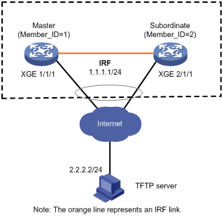

As shown in Figure 1, the two-chassis IRF fabric and the TFTP server can reach each other. The IRF members are running boot image BOOT-R7577P01 and system image SYSTEM-R7577P01.
Use patch image file SYSTEM-R7577P01H01.bin to fix bugs without rebooting the members.

# Download patch image file SYSTEM-R7577P01H01.bin from the TFTP server to the root directory on the master.
<Sysname> tftp 2.2.2.2 get SYSTEM-R7577P01H01.bin
Press CTRL+C to abort.
  % Total    % Received % Xferd  Average Speed   Time    Time     Time  Current
                                 Dload  Upload   Total   Spent    Left  Speed
100 25.2M    0 25.2M    0     0   210k      0 --:--:--  0:02:02 --:--:--  209k
# Activate the patch images on member devices.
<Sysname> install activate patch flash:/SYSTEM-R7577P01H01.bin slot 2
This operation maybe take several minutes, please wait.............Done.
<Sysname> install activate patch flash:/SYSTEM-R7577P01H01.bin slot 1
The patch images take effect immediately after they are activated.
