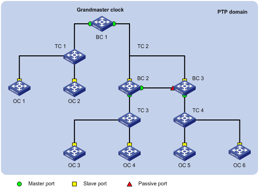

Clock node and PTP port
A node in a PTP domain is a clock node. A port enabled with PTP is a PTP port. PTP defines the following three types of basic clock nodes:
·           Ordinary Clock (OC)A PTP clock with a single PTP port in a PTP domain for time synchronization. It synchronizes time from its upstream clock node through the port. If a clock node works as the clock source and sends synchronization time through a single PTP port to its downstream clock node, it is also called an OC.
·           Boundary Clock (BC)A clock with more than one PTP port in a PTP domain for time synchronization. A BC uses one of the ports to synchronize time from its upstream clock node, and uses the other ports to synchronize time to the relevant upstream clock nodes. If a clock node works as the clock source and synchronizes time through multiple PTP ports to its downstream clock nodes, it is also called a BC, such as BC 1 in Figure 1.
·           Transparent Clock (TC)A TC does not need to keep time consistency with other clock nodes. A TC has multiple PTP ports. It only forwards PTP messages among these ports and performs delay corrections for the messages, instead of performing time synchronization. TCs include the following types:
¡  End-to-End Transparent Clock (E2ETC)Forwards non-P2P packets in the network and calculates the delay of the entire link.
¡  Peer-to-Peer Transparent Clock (P2PTC)Forwards only Sync, Follow_Up, and Announce messages, terminates other PTP messages, and calculates the delay of each link segment.
Figure 1 shows the positions of these three types of clock nodes in a PTP domain.
Figure 1 Clock nodes in a PTP domain
Besides the three basic types of clock nodes, PTP introduces some hybrid clock nodes. For example, a TC+OC has multiple PTP ports in a PTP domain: one port is the OC type, and the others are the TC type. A TC+OC forwards PTP messages through TC-type ports and performs delay corrections. In addition, it synchronizes time through its OC-type port. TC+OCs include these types: E2ETC+OC and P2PTC+OC.

Grandmaster clock
In Figure 1, all clock nodes are organized together and ultimately derive their time from a clock known as the "grandmaster clock (GM)." The GM clock source synchronizes its time to the entire PTP domain through PTP messages exchanged among the clock nodes.
A GM can be manually configured, or it can be elected through the Best Master Clock (BMC) algorithm as follows:
1.      By exchanging announce messages containing the priorities, time class, and time accuracy of GMs, clock nodes in a PTP domain elect a GM. The master nodes, member nodes, master ports, and subordinate ports are specified during the process. Then a loop-free, interconnected spanning tree with the GM as the root is generated for the PTP domain.
2.      The master node periodically sends announce messages to member nodes. If the member nodes do not receive announce messages from the master node, they consider the master node invalid and start to elect another GM.

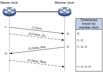

Request_Response
Figure 2 Operation procedure of the Request_Response mechanism
Figure 2 shows the operation procedure of the Request_Response mechanism, which applies only to peer-to-peer delay measurement. It shows an example of the Request_Response mechanism in two-step mode.
1.      The master clock sends a Sync message to the member clock, and records the sending time t1. Upon receiving the message, the member clock records the receiving time t2.
2.      After sending the Sync message, the master clock immediately sends a Follow_Up message carrying time t1.
3.      The member clock sends a Delay_Req message to calculate the transmission delay in the reverse direction, and records the sending time t3. Upon receiving the message, the master clock records the receiving time t4.
4.      The master clock returns a Delay_Resp message carrying time t4.
From the above process, the member clock collects four timestamps, t1 to t4, and obtains the round-trip delay to the master clock by using the following calculation:
·           [(t2 – t1) + (t4 – t3)]
The member clock also obtains the one-way delay by using the following calculation:
·           [(t2 – t1) + (t4 – t3)] / 2
The offset between the member and master clocks is obtained by using the following calculation:
·           (t2 – t1) – [(t2 – t1) + (t4 – t3)] / 2
·           [(t2 – t1) – (t4 – t3)] / 2
Depending on whether to send Follow_Up messages, the Request_Response mechanism includes two modes: single-step and two-step.
·           In single-step mode, t1 is carried in the Sync message, and no Follow_Up message is sent.
·           In two-step mode, t1 is carried in the Follow_Up message.

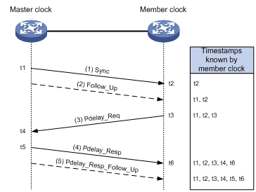

Peer Delay
Figure 3 Operation procedure of the Peer Delay mechanism
The Peer Delay mechanism uses Pdelay messages to calculate link delay, which applies only to point-to-point delay measurement. Figure 3 shows an example of the Peer Delay mechanism by using the two-step mode.
2.      After sending the Sync message, the master clock sends a Follow_Up message carrying time t1 immediately.
3.      The member clock sends a Pdelay_Req message to calculate the transmission delay in the reverse direction, and records the sending time t3. Upon receiving the message, the master clock records the receiving time t4.
4.      The master clock returns a Pdelay_Resp message carrying time t4, and records the sending time t5. Upon receiving the message, the member clock records the receiving time t6.
5.      After sending the Pdelay_Resp message, the master clock sends a Pdelay_Resp_Follow_Up message carrying time t5 immediately.
From the above process, the member clock collects six timestamps, t1 to t6, and obtains the round-trip delay to the master clock by using the following calculation:
·           [(t4 – t3) + (t6 – t5)]
·           [(t4 – t3) + (t6 – t5)] / 2
The offset between the member and master clocks is as follows:
·           (t2 – t1) – [(t4 – t3) + (t6 – t5)] / 2
Depending on whether to send Follow_Up messages, the Peer Delay mechanism includes two modes: single-step and two-step.
·           In single-step mode, t1 is carried in the Sync message, and no Follow_Up message is sent. The offset between t5 and t4 is carried in the Pdelay_Resp message, and no Pdelay_Resp_Follow_Up message is sent.
·           In two-step mode, t1 is carried in the Follow_Up message, and t4 and t5 are carried in the Pdelay_Resp and Pdelay_Resp_Follow_Up messages.

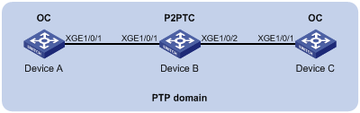

PTP configuration examples
PTP configuration example (IEEE 1588 version 2)
Network requirements
As shown in Figure 4, a PTP domain comprises Device A, Device B, and Device C.
·           Configure all devices to use PTP standard IEEE 1588 version 2.
·           Configure the clock node type of Device A and Device C as OC, and that of Device B as P2PTC. All clock nodes elect a GM through BMC based on their respective default GM attributes.
·           Configure the delay measurement mechanism for Device A and Device C as p2p.
Figure 4 Network diagram
Configuration procedure
1.      Configure Device A:
# Specify the PTP standard as IEEE 1588 version 2.
<DeviceA> system-view
[DeviceA] ptp profile 1588v2
# Specify the clock node type as OC.
[DeviceA] ptp mode oc
# On Ten-GigabitEthernet 1/0/1, specify the delay measurement mechanism as p2p, and enable PTP.
[DeviceA] interface ten-gigabitethernet 1/0/1
[DeviceA-Ten-GigabitEthernet1/0/1] ptp delay-mechanism p2p
[DeviceA-Ten-GigabitEthernet1/0/1] ptp enable
[DeviceA-Ten-GigabitEthernet1/0/1] quit
2.      Configure Device B:
<DeviceB> system-view
[DeviceB] ptp profile 1588v2
# Specify the clock node type as P2PTC.
[DeviceB] ptp mode p2ptc
# Enable PTP for Ten-GigabitEthernet 1/0/1.
[DeviceB] interface ten-gigabitethernet 1/0/1
[DeviceB-Ten-GigabitEthernet1/0/1] ptp enable
[DeviceB-Ten-GigabitEthernet1/0/1] quit
# Enable PTP for Ten-GigabitEthernet 1/0/2.
[DeviceB] interface ten-gigabitethernet 1/0/2
[DeviceB-Ten-GigabitEthernet1/0/2] ptp enable
[DeviceB-Ten-GigabitEthernet1/0/2] quit
3.      Configure Device C:
<DeviceC> system-view
[DeviceC] ptp profile 1588v2
[DeviceC] ptp mode oc
[DeviceC] interface ten-gigabitethernet 1/0/1
[DeviceC-Ten-GigabitEthernet1/0/1] ptp delay-mechanism p2p
[DeviceC-Ten-GigabitEthernet1/0/1] ptp enable
[DeviceC-Ten-GigabitEthernet1/0/1] quit
4.      Verify the configuration:
# Display PTP clock information on Device A.

PTP configuration example (IEEE 802.1AS)
·           Configure all devices to use PTP standard IEEE 802.1AS.
Figure 5 Network diagram
# Specify the PTP standard as IEEE 802.1AS.
[DeviceA] ptp profile 802.1AS
# Enable PTP on Ten-GigabitEthernet 1/0/1.
[DeviceB] ptp profile 802.1AS
# Specify the PTP standard as IEEE 1588 802.1AS.
[DeviceC] ptp profile 802.1AS
When the network is stable, perform the following tasks:
¡  Use the display ptp clock command to display PTP clock information.
¡  Use the display ptp interface brief command to display brief PTP statistics on an interface.
[DeviceA] display ptp clock
PTP profile         : IEEE 802.1AS
PTP mode            : OC
Slave only          : No
Clock ID            : 000FE2-FFFE-FF0000
Clock type          : Local
Clock domain        : 0
Number of PTP ports : 1
Priority1     : 246
Priority2     : 248
Clock quality :
 Class                 : 248
 Accuracy              : 254
 Offset (log variance) : 16640
Offset from master : 0 (ns)
Mean path delay    : 0 (ns)
Steps removed      : 0
Local clock time   : Sun Jan 15 20:57:29 2011
# Display brief PTP statistics on Device A.
[DeviceA] display ptp interface brief
Name         State         Delay mechanism  Clock step  Asymmetry correction
XGE1/0/1       Master        P2P              Two         0
# Display PTP clock information on Device B.
[DeviceB] display ptp clock
PTP mode            : P2PTC
Slave only          : No
Clock ID            : 000FE2-FFFE-FF0001
Clock type          : Local
Clock domain        : 0
Number of PTP ports : 2
Priority1     : 246
Priority2     : 248
Clock quality :
 Class                 : 248
 Accuracy              : 254
Offset from master : N/A
Mean path delay    : N/A
Steps removed      : N/A
# Display brief PTP statistics on Device B.
[DeviceB] display ptp interface brief
XGE1/0/1       N/A           P2P              Two         0
XGE1/0/2       N/A           P2P              Two         0
