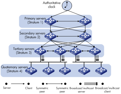

NTP architecture
NTP uses stratums 1 to 16 to define clock accuracy, as shown in Figure 2. A lower stratum value represents higher accuracy. Clocks at stratums 1 through 15 are in synchronized state, and clocks at stratum 16 are not synchronized.
Figure 2 NTP architecture
Typically, a stratum 1 NTP server gets its time from an authoritative time source, such as an atomic clock, and provides time for other devices as the primary NTP server. The accuracy of each server is the stratum, with the topmost level (primary servers) assigned as one and each level downwards in the hierarchy assigned as one greater than the preceding level. NTP uses a stratum to describe how many NTP hops away a device is from the primary time server. A stratum 2 time server receives its time from a stratum 1 time server, and so on.
To ensure time accuracy and availability, you can specify multiple NTP servers for a device. The device selects an optimal NTP server as the clock source based on parameters such as stratum. The clock that the device selects is called the reference source. For more information about clock selection, see the related protocols and standards.
If the devices in a network cannot synchronize to an authoritative time source, you can select a device that has a relatively accurate clock from the network, and use the local clock of the device as the reference clock to synchronize other devices in the network.
