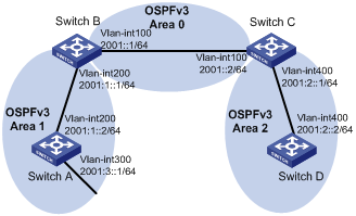

OSPFv3 configuration examples
OSPFv3 stub area configuration example
Network requirements
As shown in Figure 1:
·           Enable OSPFv3 on all switches.
·           Split the AS into three areas.
·           Configure Switch B and Switch C as ABRs to forward routing information between areas.
·           Configure Area 2 as a stub area to reduce LSAs in the area without affecting route reachability.
Figure 1 Network diagram
Configuration procedure
1.      Configure IPv6 addresses for interfaces. (Details not shown.)
2.      Configure basic OSPFv3:
# On Switch A, enable OSPFv3 and specify the router ID as 1.1.1.1.
<SwitchA> system-view
[SwitchA] ospfv3
[SwitchA-ospfv3-1] router-id 1.1.1.1
[SwitchA-ospfv3-1] quit
[SwitchA] interface vlan-interface 300
[SwitchA-Vlan-interface300] ospfv3 1 area 1
[SwitchA-Vlan-interface300] quit
[SwitchA] interface vlan-interface 200
[SwitchA-Vlan-interface200] ospfv3 1 area 1
[SwitchA-Vlan-interface200] quit
# On Switch B, enable OSPFv3 and specify the router ID as 2.2.2.2.
<SwitchB> system-view
[SwitchB] ospfv3
[SwitchB-ospfv3-1] router-id 2.2.2.2
[SwitchB-ospfv3-1] quit
[SwitchB-Vlan-interface100] ospfv3 1 area 0
[SwitchB] interface vlan-interface 200
[SwitchB-Vlan-interface200] ospfv3 1 area 1
[SwitchB-Vlan-interface200] quit
# On Switch C, enable OSPFv3 and specify the router ID as 3.3.3.3.
<SwitchC> system-view
[SwitchC] ospfv3
[SwitchC-ospfv3-1] router-id 3.3.3.3
[SwitchC-ospfv3-1] quit
[SwitchC] interface vlan-interface 100
[SwitchC-Vlan-interface100] ospfv3 1 area 0
[SwitchC-Vlan-interface100] quit
[SwitchC] interface vlan-interface 400
[SwitchC-Vlan-interface400] ospfv3 1 area 2
[SwitchC-Vlan-interface400] quit
# On Switch D, enable OSPFv3 and specify the router ID as 4.4.4.4.
<SwitchD> system-view
[SwitchD] ospfv3
[SwitchD-ospfv3-1] router-id 4.4.4.4
[SwitchD-ospfv3-1] quit
[SwitchD] interface vlan-interface 400
[SwitchD-Vlan-interface400] ospfv3 1 area 2
[SwitchD-Vlan-interface400] quit
# Display OSPFv3 neighbors on Switch B.
[SwitchB] display ospfv3 peer
               OSPFv3 Process 1 with Router ID 2.2.2.2
 Area: 0.0.0.0
 Router ID       Pri State             Dead-Time InstID Interface
 3.3.3.3         1   Full/BDR          00:00:40  0      Vlan100
 Area: 0.0.0.1
 1.1.1.1         1   Full/DR           00:00:40  0      Vlan200
# Display OSPFv3 neighbors on Switch C.
[SwitchC] display ospfv3 peer
               OSPFv3 Process 1 with Router ID 3.3.3.3
 Area: 0.0.0.0
 2.2.2.2         1   Full/DR           00:00:40  0      Vlan100
 Area: 0.0.0.2
 4.4.4.4         1   Full/BDR          00:00:40  0      Vlan400
# Display OSPFv3 routing table information on Switch D.
[SwitchD] display ospfv3 routing
               OSPFv3 Process 1 with Router ID 4.4.4.4
 I  - Intra area route,  E1 - Type 1 external route,  N1 - Type 1 NSSA route
 IA - Inter area route,  E2 - Type 2 external route,  N2 - Type 2 NSSA route
 *  - Selected route
 *Destination: 2001::/64
  Type       : IA                                        Cost     : 2
  NextHop    : FE80::F40D:0:93D0:1                       Interface: Vlan400
  AdvRouter  : 3.3.3.3                                   Area     : 0.0.0.2
  Preference : 10
 *Destination: 2001:1::/64
  Type       : IA                                        Cost     : 3
  Preference : 10
 *Destination: 2001:2::/64
  Type       : I                                         Cost     : 1
  Nexthop    : ::                                        Interface: Vlan400
  AdvRouter  : 4.4.4.4                                   Area     : 0.0.0.2
  Preference : 10
 *Destination: 2001:3::/64
  Type       : IA                                        Cost     : 4
  Preference : 10
 Total: 4
 Intra area: 1         Inter area: 3         ASE: 0         NSSA: 0
3.      Configure Area 2 as a stub area:
# Configure Switch D.
[SwitchD] ospfv3
[SwitchD-ospfv3-1] area 2
[SwitchD-ospfv3-1-area-0.0.0.2] stub
# Configure Switch C, and specify the cost of the default route sent to the stub area as 10.
[SwitchC] ospfv3
[SwitchC-ospfv3-1] area 2
[SwitchC-ospfv3-1-area-0.0.0.2] stub
[SwitchC-ospfv3-1-area-0.0.0.2] default-cost 10
 *  - Selected route
 *Destination: ::/0
  Type       : IA                                        Cost     : 11
  Preference : 10
  Type       : IA                                        Cost     : 2
  Preference : 10
  Type       : IA                                        Cost     : 3
  Preference : 10
  Type       : I                                         Cost     : 1
  Preference : 10
  Type       : IA                                        Cost     : 4
  Preference : 10
 Total: 5
 Intra area: 1         Inter area: 4         ASE: 0         NSSA: 0
The output shows that a default route is added, and its cost is the cost of a direct route plus the configured cost.
4.      Configure Area 2 as a totally stub area:
# Configure Area 2 as a totally stub area on Switch C.
[SwitchC-ospfv3-1-area-0.0.0.2] stub no-summary
 *  - Selected route
 *Destination: ::/0
  Type       : IA                                        Cost     : 11
  Preference : 10
  Type       : I                                         Cost     : 1
  Preference : 10
 Total: 2
 Intra area: 1         Inter area: 1         ASE: 0         NSSA: 0
The output shows that route entries are reduced. All indirect routes are removed, except the default route.
OSPFv3 NSSA area configuration example
As shown in Figure 2:
·           Configure OSPFv3 on all switches and split the AS into three areas.
·           Configure Area 1 as an NSSA area and configure Switch A as an ASBR to redistribute static routes into the AS.

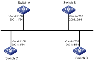

OSPFv3 DR election configuration example
As shown in Figure 3:
·           Configure router priority 100 for Switch A, the highest priority on the network, so it will become the DR.
·           Configure router priority 2 for Switch C, the second highest priority on the network, so it will become the BDR.
·           Configure router priority 0 for Switch B, so it cannot become a DR or BDR.
·           Switch D uses the default router priority 1.
Figure 3 Network diagram
[SwitchA] ospfv3
[SwitchA-Vlan-interface100] ospfv3 1 area 0
[SwitchB] ospfv3
[SwitchB-Vlan-interface200] ospfv3 1 area 0
[SwitchC] ospfv3
[SwitchD] ospfv3
[SwitchD] interface vlan-interface 200
[SwitchD-Vlan-interface200] ospfv3 1 area 0
[SwitchD-Vlan-interface200] quit
# Display neighbor information on Switch A. The switches have the same default DR priority 1, so Switch D (the switch with the highest router ID) is elected as the DR, and Switch C is the BDR.
[SwitchA] display ospfv3 peer
               OSPFv3 Process 1 with Router ID 1.1.1.1
 Area: 0.0.0.0
 2.2.2.2         1   2-Way/DROther     00:00:36  0      Vlan200
 3.3.3.3         1   Full/BDR          00:00:35  0      Vlan100
 4.4.4.4         1   Full/DR           00:00:33  0      Vlan200
# Display neighbor information on Switch D. The neighbor states are all full.
[SwitchD] display ospfv3 peer
 Area: 0.0.0.0
 1.1.1.1         1   Full/DROther      00:00:30  0      Vlan100
 2.2.2.2         1   Full/DROther      00:00:37  0      Vlan200
 3.3.3.3         1   Full/BDR          00:00:31  0      Vlan100
3.      Configure router priorities for interfaces:
# Configure the router priority of VLAN-interface 100 as 100 on Switch A.
[SwitchA] interface Vlan-interface 100
[SwitchA-Vlan-interface100] ospfv3 dr-priority 100
# Configure the router priority of VLAN-interface 200 as 0 on Switch B.
[SwitchB-Vlan-interface200] ospfv3 dr-priority 0
# Configure the router priority of VLAN-interface 100 of Switch C as 2.
[SwitchC] interface Vlan-interface 100
[SwitchC-Vlan-interface100] ospfv3 dr-priority 2
# Display neighbor information on Switch A. Router priorities have been updated, but the DR and BDR are not changed.
 Area: 0.0.0.0
 2.2.2.2         0   2-Way/DROther     00:00:36  0      Vlan200
 3.3.3.3         2   Full/BDR          00:00:35  0      Vlan200
# Display neighbor information on Switch D. Switch D is still the DR.
 Area: 0.0.0.0
 1.1.1.1         100 Full/DROther      00:00:30  0      Vlan100
 2.2.2.2         0   Full/DROther      00:00:37  0      Vlan200
 3.3.3.3         2   Full/BDR          00:00:31  0      Vlan100
4.      Restart DR and BDR election:
# Use the shutdown and undo shutdown commands on interfaces to restart DR and BDR election. (Details not shown.)
# Display neighbor information on Switch A. The output shows that Switch C becomes the BDR.
 Area: 0.0.0.0
 2.2.2.2         0   Full/DROther      00:00:36  0      Vlan200
 3.3.3.3         2   Full/BDR          00:00:35  0      Vlan100
 4.4.4.4         1   Full/DROther      00:00:33  0      Vlan200
 Area: 0.0.0.0
 1.1.1.1         100 Full/DR           00:00:30  0      Vlan100
 2.2.2.2         0   2-Way/DROther     00:00:37  0      Vlan200
The output shows that Switch A becomes the DR.

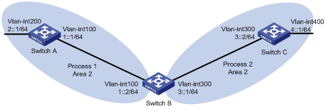

OSPFv3 route redistribution configuration example
As shown in Figure 4:
·           Switch A, Switch B, and Switch C are in Area 2.
·           OSPFv3 process 1 and OSPFv3 process 2 run on Switch B. Switch B communicates with Switch A and Switch C through OSPFv3 process 1 and OSPFv3 process 2.
·           Configure OSPFv3 process 2 to redistribute direct routes and the routes from OSPFv3 process 1 on Switch B, and set the default metric for redistributed routes to 3. Switch C can then learn the routes destined for 1::0/64 and 2::0/64, and Switch A cannot learn the routes destined for 3::0/64 or 4::0/64.
Figure 4 Network diagram
# Enable OSPFv3 process 1 on Switch A.
[SwitchA] ospfv3 1
[SwitchA-Vlan-interface100] ospfv3 1 area 2
[SwitchA-Vlan-interface200] ospfv3 1 area 2
# Enable OSPFv3 process 1 and OSPFv3 process 2 on Switch B.
[SwitchB] ospfv3 1
[SwitchB-Vlan-interface100] ospfv3 1 area 2
[SwitchB] ospfv3 2
[SwitchB-ospfv3-2] router-id 3.3.3.3
[SwitchB-ospfv3-2] quit
[SwitchB] interface vlan-interface 300
[SwitchB-Vlan-interface300] ospfv3 2 area 2
[SwitchB-Vlan-interface300] quit
# Enable OSPFv3 process 2 on Switch C.
[SwitchC] ospfv3 2
[SwitchC-ospfv3-2] router-id 4.4.4.4
[SwitchC-ospfv3-2] quit
[SwitchC] interface vlan-interface 300
[SwitchC-Vlan-interface300] ospfv3 2 area 2
[SwitchC-Vlan-interface300] quit
[SwitchC-Vlan-interface400] ospfv3 2 area 2
# Display the routing table on Switch C.
[SwitchC] display ipv6 routing-table
Destinations : 7 Routes : 7
Destination: ::1/128                                     Protocol  : Direct
NextHop    : ::1                                         Preference: 0
Interface  : InLoop0                                     Cost      : 0
Destination: 3::/64                                      Protocol  : Direct
NextHop    : 3::2                                        Preference: 0
Interface  : Vlan300                                     Cost      : 0
Destination: 3::2/128                                    Protocol  : Direct
Destination: 4::/64                                      Protocol  : Direct
NextHop    : 4::1                                        Preference: 0
Interface  : Vlan400                                     Cost      : 0
Destination: 4::1/128                                    Protocol  : Direct
Destination: FE80::/10                                   Protocol  : Direct
NextHop    : ::                                          Preference: 0
Interface  : NULL0                                       Cost      : 0
Destination: FF00::/8                                    Protocol  : Direct
Interface  : NULL0
3.      Configure OSPFv3 route redistribution:
# Configure OSPFv3 process 2 to redistribute direct routes and the routes from OSPFv3 process 1 on Switch B.
[SwitchB] ospfv3 2
[SwitchB-ospfv3-2] default cost 3
[SwitchB-ospfv3-2] import-route ospfv3 1
[SwitchB-ospfv3-2] import-route direct
Destinations : 9 Routes : 9
Destination: 1::/64                                      Protocol  : OSPFv3
NextHop    : FE80::200:CFF:FE01:1C03                     Preference: 150
Interface  : Vlan300                                     Cost      : 3
Destination: 2::/64                                      Protocol  : OSPFv3
Interface  : NULL0

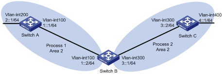

OSPFv3 route summarization configuration example
As shown in Figure 5:
·           OSPFv3 process 1 and OSPFv3 process 2 run on Switch B. Switch B communicates with Switch A and Switch C through OSPFv3 process 1 and OSPFv3 process 2, respectively.
·           On Switch A, configure IPv6 addresses 2:1:1::1/64, 2:1:2::1/64, and 2:1:3::1/64 for VLAN-interface 200.
·           On Switch B, configure OSPFv3 process 2 to redistribute direct routes and the routes from OSPFv3 process 1. Switch C can then learn the routes destined for 2::/64, 2:1:1::/64, 2:1:2::/64, and 2:1:3::/64.
·           On Switch B, configure route summarization to advertise only summary route 2::/16 to Switch C.
Figure 5 Network diagram
2.      Configure OSPFv3:
[SwitchA] ospfv3 1
[SwitchA-Vlan-interface200] ipv6 address 2:1:1::1 64
[SwitchA-Vlan-interface200] ipv6 address 2:1:2::1 64
[SwitchA-Vlan-interface200] ipv6 address 2:1:3::1 64
[SwitchB] ospfv3 1
[SwitchB] ospfv3 2
[SwitchC] ospfv3 2
[SwitchB] ospfv3 2
Destinations : 12 Routes : 12
Destination: 1::/64                                      Protocol  : O_ASE2
Interface  : Vlan300                                     Cost      : 1
Destination: 2::/64                                      Protocol  : O_ASE2
Destination: 2:1:1::/64                                  Protocol  : O_ASE2
Destination: 2:1:2::/64                                  Protocol  : O_ASE2
Destination: 2:1:3::/64                                  Protocol  : O_ASE2
Interface  : NULL0
4.      Configure ASBR route summarization:
# On Switch B, configure OSPFv3 process 2 to advertise a single route 2::/16.
[SwitchB] ospfv3 2
[SwitchB-ospfv3-2] asbr-summary 2:: 16
Destination: 2::/16                                      Protocol  : O_ASE2
Interface  : NULL0

# Configure the inbound and outbound SA keys for AH.
[SwitchB-ipsec-profile-profile001-manual] sa string-key inbound ah simple abc
[SwitchB-ipsec-profile-profile001-manual] sa string-key outbound ah simple abc
# Configure the inbound and outbound SA keys for ESP.
[SwitchB-ipsec-profile-profile001-manual] sa string-key inbound esp simple 123
[SwitchB-ipsec-profile-profile001-manual] sa string-key outbound esp simple 123
[SwitchB-ipsec-profile-profile001-manual] quit
# Create a manual IPsec profile named profile002.
[SwitchB] ipsec profile profile002 manual
# Reference IPsec transform set trans.
[SwitchB-ipsec-profile-profile002-manual] transform-set trans
# Configure the inbound and outbound SPIs for AH.
[SwitchB-ipsec-profile-profile002-manual] sa spi inbound ah 4294967295
[SwitchB-ipsec-profile-profile002-manual] sa spi outbound ah 4294967295
# Configure the inbound and outbound SPIs for ESP.
[SwitchB-ipsec-profile-profile002-manual] sa spi inbound esp 256
[SwitchB-ipsec-profile-profile002-manual] sa spi outbound esp 256
[SwitchB-ipsec-profile-profile002-manual] sa string-key inbound ah simple hello
[SwitchB-ipsec-profile-profile002-manual] sa string-key outbound ah simple hello
[SwitchB-ipsec-profile-profile002-manual] sa string-key inbound esp simple byebye
[SwitchB-ipsec-profile-profile002-manual] sa string-key outbound esp simple byebye
[SwitchB-ipsec-profile-profile002-manual] quit
¡  On Switch C:
# Create an IPsec transform set named trans.
[SwitchC] ipsec transform-set trans
# Specify the encapsulation mode as transport.
[SwitchC-ipsec-transform-set-trans] encapsulation-mode transport
# Specify the ESP encryption and authentication algorithms.
[SwitchC-ipsec-transform-set-trans] esp encryption-algorithm 3des-cbc
# Specify the AH authentication algorithm.
[SwitchC-ipsec-transform-set-trans] esp authentication-algorithm md5
[SwitchC-ipsec-transform-set-trans] ah authentication-algorithm md5
[SwitchC-ipsec-transform-set-trans] quit
[SwitchC] ipsec profile profile002 manual
[SwitchC-ipsec-profile-profile002-manual] transform-set trans
[SwitchC-ipsec-profile-profile002-manual] sa spi inbound ah 4294967295
[SwitchC-ipsec-profile-profile002-manual] sa spi outbound ah 4294967295
[SwitchC-ipsec-profile-profile002-manual] sa spi inbound esp 256
[SwitchC-ipsec-profile-profile002-manual] sa spi outbound esp 256
[SwitchC-ipsec-profile-profile002-manual] sa string-key inbound ah simple hello
[SwitchC-ipsec-profile-profile002-manual] sa string-key outbound ah simple hello
[SwitchC-ipsec-profile-profile002-manual] sa string-key inbound esp simple byebye
[SwitchC-ipsec-profile-profile002-manual] sa string-key outbound esp simple byebye
[SwitchC-ipsec-profile-profile002-manual] quit
4.      Apply the IPsec profiles to areas:
# Configure Switch A.
[SwitchA] ospfv3 1
[SwitchA-ospfv3-1] area 1
[SwitchA-ospfv3-1-area-0.0.0.1] enable ipsec-profile profile001
[SwitchA-ospfv3-1-area-0.0.0.1] quit
# Configure Switch B.
[SwitchB] ospfv3 1
[SwitchB-ospfv3-1] area 0
[SwitchB-ospfv3-1-area-0.0.0.0] enable ipsec-profile profile002
[SwitchB-ospfv3-1-area-0.0.0.0] quit
[SwitchB-ospfv3-1] area 1
[SwitchB-ospfv3-1-area-0.0.0.1] enable ipsec-profile profile001
[SwitchB-ospfv3-1-area-0.0.0.1] quit
# Configure Switch C.
[SwitchC] ospfv3 1
[SwitchC-ospfv3-1] area 0
[SwitchC-ospfv3-1-area-0.0.0.0] enable ipsec-profile profile002
[SwitchC-ospfv3-1-area-0.0.0.0] quit
# Verify that OSPFv3 packets between Switches A, B, and C are protected by IPsec. (Details not shown.)
