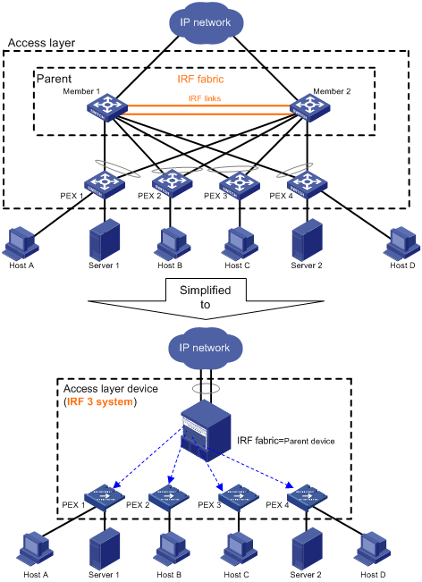

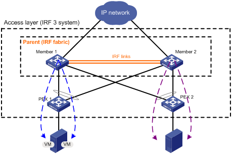

Setting up an IRF 3 system·· 51
Overview· 51
Basic concepts· 53
IRF 3 operating mechanisms· 54

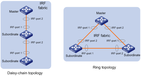

An IRF fabric can use a daisy-chain or ring topology. IRF does not support the full mesh topology. For information about connecting IRF member devices, see "Connecting IRF physical interfaces."

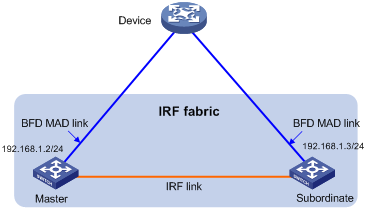

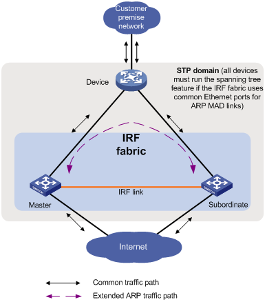

MAD
An IRF link failure causes an IRF fabric to split in two IRF fabrics operating with the same Layer 3 settings, including the same IP address. To avoid IP address collision and network problems, IRF uses multi-active detection (MAD) mechanisms to detect the presence of multiple identical IRF fabrics, handle collisions, and recover from faults.

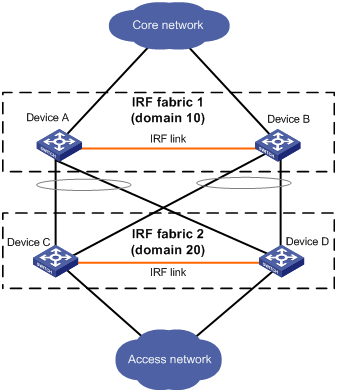

One IRF fabric forms one IRF domain. IRF uses IRF domain IDs to uniquely identify IRF fabrics and prevent IRF fabrics from interfering with one another.
As shown in Figure 2, IRF fabric 1 contains Device A and Device B, and IRF fabric 2 contains Device C and Device D. Both fabrics use the LACP aggregate links between them for MAD. When a member device receives an extended LACPDU for MAD, it checks the domain ID to see whether the packet is from the local IRF fabric. Then, the device can handle the packet correctly.
Figure 2 A network that contains two IRF domains

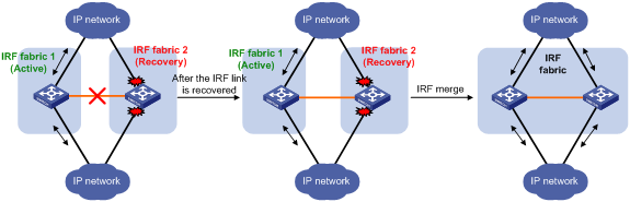

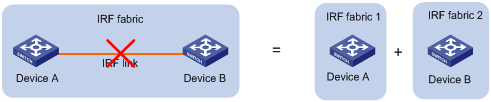

IRF split occurs when an IRF fabric breaks up into multiple IRF fabrics because of IRF link failures, as shown in Figure 3. The split IRF fabrics operate with the same IP address. IRF split causes routing and forwarding problems on the network. To quickly detect a multi-active collision, configure a minimum of one MAD mechanism (see "Configuring MAD").
Figure 3 IRF split
IRF merge

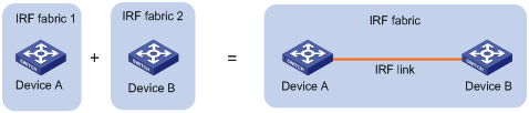

IRF merge occurs when two split IRF fabrics reunite or when two independent IRF fabrics are united, as shown in Figure 4.
Figure 4 IRF merge

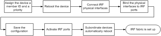

For the setup of a new IRF fabric, the subordinate devices must reboot to complete the setup after the master election.
For an IRF merge, devices must reboot if they are in the IRF fabric that fails the master election.

MAD identifies each IRF fabric with a domain ID and an active ID (the member ID of the master). If multiple active IDs are detected in a domain, MAD determines that an IRF collision or split has occurred.
For more information about the MAD mechanisms and their application scenarios, see "MAD mechanisms."

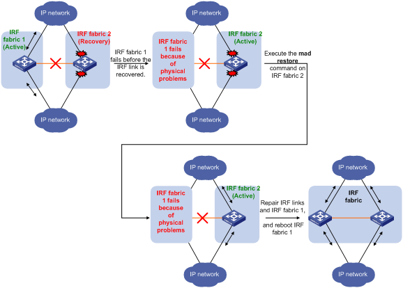

When MAD detects a multi-active collision, it sets all IRF fabrics except one to the Recovery state. The fabric that is not placed in Recovery state can continue to forward traffic. The Recovery-state IRF fabrics are inactive and cannot forward traffic.

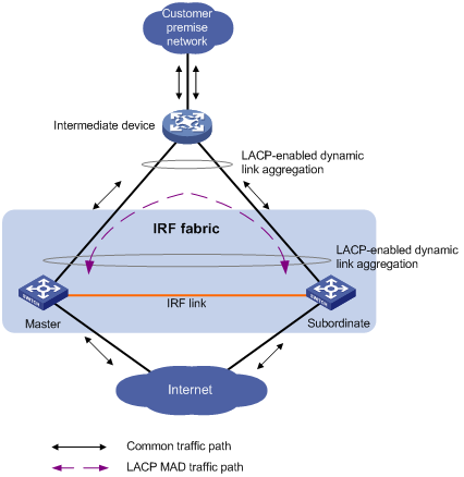

LACP MAD uses the following process to handle a multi-active collision:
1.      Compares the number of members in each fabric.
2.      Sets all fabrics to the Recovery state except the one that has the most members.
3.      Compares the member IDs of the masters if all IRF fabrics have the same number of members.
4.      Sets all fabrics to the Recovery state except the one that has the lowest numbered master.
5.      Shuts down all physical network ports in the Recovery-state fabrics except for the following ports:
?  IRF physical interfaces.
?  Ports you have specified with the mad exclude interface command.
In contrast, BFD MAD, ARP MAD, and ND MAD do not compare the number of members in fabrics. These MAD mechanisms use the following process to hand a multi-active collision:

Failure recovery
To merge two split IRF fabrics, first repair the failed IRF link and remove the IRF link failure.
·           If the IRF fabric in Recovery state fails before the failure is recovered, repair the failed IRF fabric and the failed IRF link.
·           If the active IRF fabric fails before the failure is recovered, enable the inactive IRF fabric to take over the active IRF fabric. Then, recover the MAD failure.

LACP MAD
As shown in Figure 5, LACP MAD has the following requirements:
·           Every IRF member must have a link with an intermediate device.
·           All the links form a dynamic link aggregation group.
·           The intermediate device must be a device that supports extended LACP for MAD.
The IRF member devices send extended LACPDUs that convey a domain ID and an active ID. The intermediate device transparently forwards the extended LACPDUs received from one member device to all the other member devices.
·           If the domain IDs and active IDs sent by all the member devices are the same, the IRF fabric is integrated.
·           If the extended LACPDUs convey the same domain ID but different active IDs, a split has occurred. LACP MAD handles this situation as described in "Collision handling."
Figure 5 LACP MAD scenario

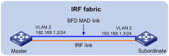

BFD MAD
You can use common or management Ethernet ports for BFD MAD links.
·           If management Ethernet ports are used, BFD MAD must work with an intermediate device. Make sure the following requirements are met:
?  Each IRF member device has a BFD MAD link to the intermediate device.
?  Each member device is assigned a MAD IP address on the master's management Ethernet port.
·           If common Ethernet ports are used, BFD MAD has the following requirements:
?  If an intermediate device is used, each member device must have a BFD MAD link to the intermediate device. If no intermediate device is used, all member devices must have a BFD MAD link to each other. As a best practice, use an intermediate device to connect IRF member devices if the IRF fabric has more than two member devices. A full mesh of IRF members might cause broadcast loops.
?  Each member device is assigned a MAD IP address on a VLAN interface.
The BFD MAD links must be dedicated. Do not use BFD MAD links for any other purposes.
·       The MAD addresses identify the member devices and must belong to the same subnet.
·       Of all management Ethernet ports on an IRF fabric, only the master's management Ethernet port is accessible.
Figure 6 shows a typical BFD MAD scenario that uses an intermediate device. Figure 7 shows a typical BFD MAD scenario that does not use an intermediate device.
With BFD MAD, the master attempts to establish BFD sessions with other member devices by using its MAD IP address as the source IP address.
·           If the IRF fabric is integrated, only the MAD IP address of the master takes effect. The master cannot establish a BFD session with any other member. If you execute the display bfd session command, the state of the BFD sessions is Down.
·           When the IRF fabric splits, the IP addresses of the masters in the split IRF fabrics take effect. The masters can establish a BFD session. If you execute the display bfd session command, the state of the BFD session between the two devices is Up.
Figure 6 BFD MAD scenario with an intermediate device
Figure 7 BFD MAD scenario without an intermediate device
ARP MAD
ARP MAD detects multi-active collisions by using extended ARP packets that convey the IRF domain ID and the active ID.
You can use common or management Ethernet ports for ARP MAD.
·           If management Ethernet ports are used, ARP MAD must work with an intermediate device. Make sure the following requirements are met:
?  Connect the management Ethernet port on each member device to the intermediate device.
?  On the intermediate device, you must assign the ports used for ARP MAD to the same VLAN.
·           If common Ethernet ports are used, ARP MAD can work with or without an intermediate device. Make sure the following requirements are met:
?  If an intermediate device is used, connect each IRF member device to the intermediate device. Run the spanning tree feature between the IRF fabric and the intermediate device. In this situation, data links can be used.
?  If an intermediate device is not used, connect each IRF member device to all other member devices. In this situation, IRF links cannot be used for ARP MAD.
Figure 8 shows a typical ARP MAD scenario that uses an intermediate device.
Each IRF member compares the domain ID and the active ID in incoming extended ARP packets with its domain ID and active ID.
·           If the domain IDs are different, the extended ARP packet is from a different IRF fabric. The device does not continue to process the packet with the MAD mechanism.
·           If the domain IDs are the same, the device compares the active IDs.
?  If the active IDs are different, the IRF fabric has split.
?  If the active IDs are the same, the IRF fabric is integrated.
Figure 8 ARP MAD scenario

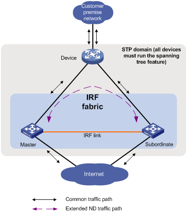

ND MAD
ND MAD detects multi-active collisions by using NS packets to transmit the IRF domain ID and the active ID.
You can set up ND MAD links between neighbor IRF member devices or between each IRF member device and an intermediate device (see Figure 9). If an intermediate device is used, you must also run the spanning tree protocol between the IRF fabric and the intermediate device.
Each IRF member device compares the domain ID and the active ID in incoming NS packets with its domain ID and active ID.
·           If the domain IDs are different, the NS packet is from a different IRF fabric. The device does not continue to process the packet with the MAD mechanism.
Figure 9 ND MAD scenario

As a best practice, use the basic IRF setup procedure in Figure 10. Perform the tasks in this figure on each member device.
Figure 10 Basic IRF setup flow chart

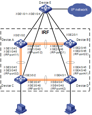

When you connect two neighboring IRF members, connect the physical interfaces of IRF-port 1 on one member to the physical interfaces of IRF-port 2 on the other (see Figure 11).
For example, you have four chassis: A, B, C, and D. IRF-port 1 and IRF-port 2 are represented by A1 and A2 on chassis A, represented by B1 and B2 on chassis B, and so on. To connect the four chassis into a ring topology of A-B-C-D(A), the IRF link cabling scheme must be one of the following:
·           A1-B2, B1-C2, C1-D2, and D1-A2.
·           A2-B1, B2-C1, C2-D1, and D2-A1.
IMPORTANT
IMPORTANT:
No intermediate devices are allowed between neighboring members.
Figure 11 Connecting IRF physical interfaces
Connect the devices into a daisy-chain topology or a ring topology. A ring topology is more reliable (see Figure 12). In ring topology, the failure of one IRF link does not cause the IRF fabric to split as in daisy-chain topology. Rather, the IRF fabric changes to a daisy-chain topology without interrupting network services.
Figure 12 Daisy-chain topology vs. ring topology

To bind physical interfaces to IRF ports:
Step
Remarks
1.      Enter system view.
N/A
2.      Enter interface view or interface range view.
·          Enter interface range view:
interface range { interface-type interface-number [ to interface-type interface-number ] } &<1-24>
·          Enter interface view:
To shut down a range of IRF physical interfaces, enter interface range view.
To shut down one IRF physical interface, enter its interface view.
3.      Shut down the interface or the range of interfaces.
shutdown
By default, all interfaces are up.
4.      Return to system view.
N/A
5.      Enter IRF port view.
irf-port member-id/port-number
N/A
6.      Bind each physical interface to the IRF port.
port group interface interface-type interface-number
By default, no physical interfaces are bound to an IRF port.
Repeat this step to assign multiple physical interfaces to the IRF port for link redundancy.
You can bind up to eight physical interfaces to an IRF port.
7.      Return to system view.
N/A
8.      Enter interface view or interface range view.
N/A
9.      Bring up the interface or the range of interfaces.
undo shutdown
N/A
10.   Return to system view.
N/A
11.   Save the configuration.
save
Activating IRF port settings causes IRF merge and reboot. To avoid data loss, save the running configuration to the startup configuration file before you perform the operation.
12.   Activate the IRF port settings.
irf-port-configuration active
After this step is performed, the state of the IRF port changes to UP, the member devices elect a master automatically, and the subordinate device reboots automatically.
After the IRF fabric is formed, you can add additional physical interfaces to an IRF port (in UP state) without repeating this step.

·           You can configure multiple MAD mechanisms on an IRF fabric for prompt IRF split detection.
?  Do not configure LACP MAD together with BFD MAD, ARP MAD, or ND MAD, because they handle collisions differently.
?  Do not configure BFD MAD together with ARP MAD or ND MAD if common Ethernet ports are used for MAD. BFD MAD is mutually exclusive with the spanning tree feature, but ARP MAD and ND MAD require the spanning tree feature.
·           If LACP MAD, ARP MAD, or ND MAD runs between two IRF fabrics, assign each fabric a unique IRF domain ID. (For BFD MAD, this task is optional.)
·           An IRF fabric has only one IRF domain ID. You can change the IRF domain ID by using the following commands: irf domain, mad enable, mad arp enable, or mad nd enable. The IRF domain IDs configured by using these commands overwrite each other.
·           To prevent a port from being shut down when the IRF fabric transits to the Recovery state, use the mad exclude interface command. To bring up ports in a Recovery-state IRF fabric, use the mad restore command instead of the undo shutdown command. The mad restore command activates the Recovery-state IRF fabric.
Configuring LACP MAD
When you use LACP MAD, follow these guidelines:
·           If the intermediate device is also an IRF fabric, assign the two IRF fabrics different domain IDs for correct split detection.
·           Use dynamic link aggregation mode. MAD is LACP dependent. Even though LACP MAD can be configured on both static and dynamic aggregate interfaces, it takes effect only on dynamic aggregate interfaces.
·           Configure link aggregation settings on the intermediate device.
To configure LACP MAD:
Step
Remarks
N/A
2.      Assign a domain ID to the IRF fabric.
irf domain domain-id
The default IRF domain ID is 0.
3.      Create a Layer 2 aggregate interface and enter Layer 2 aggregate interface view.
Perform this step also on the intermediate device.
4.      Configure the aggregation group to operate in dynamic aggregation mode.
link-aggregation mode dynamic
By default, an aggregation group operates in static aggregation mode.
5.      Enable LACP MAD.
mad enable
By default, LACP MAD is disabled.

Configuring BFD MAD
Before you configure BFD MAD, choose a BFD MAD link scheme as described in "BFD MAD."
As a best practice, connect the BFD MAD links after you finish the BFD MAD configuration.
Configuring BFD MAD that uses common Ethernet ports
Configure BFD MAD on a VLAN interface if you use common Ethernet ports for BFD MAD.
When you use BFD MAD on a VLAN interface, follow these restrictions and guidelines:
Category
BFD MAD VLAN
·          Do not enable BFD MAD on VLAN-interface 1.
·          If you are using an intermediate device, perform the following tasks on both the IRF fabric and the intermediate device:
?  Create a VLAN and VLAN interface for BFD MAD.
?  Assign the ports of BFD MAD links to the BFD MAD VLAN.
·          Make sure the IRF fabrics on the network use different BFD MAD VLANs.
·          Make sure the BFD MAD VLAN contains only ports on the BFD MAD links. Exclude a port from the BFD MAD VLAN if the port is not on the BFD MAD link. For example, if you have assigned the port to all VLANs by using the port trunk permit vlan all command, use the undo port trunk permit command to exclude the port from the BFD MAD VLAN.
BFD MAD VLAN and feature compatibility
Do not use the BFD MAD VLAN for any purpose other than configuring BFD MAD.
·          Configure only the mad bfd enable and mad ip address commands on the VLAN interface used for BFD MAD. If you configure other features, both BFD MAD and other features on the interface might run incorrectly.
·          Disable the spanning tree feature on all Layer 2 Ethernet ports in the BFD MAD VLAN. The MAD feature is mutually exclusive with the spanning tree feature.
MAD IP address
·          Use the mad ip address command instead of the ip address command to configure MAD IP addresses on the BFD MAD-enabled VLAN interface.
·          Make sure all the MAD IP addresses are on the same subnet.
To configure BFD MAD that uses common Ethernet ports:
Step
Remarks
N/A
2.      (Optional.) Assign a domain ID to the IRF fabric.
By default, the domain ID of an IRF fabric is 0.
3.      Create a VLAN dedicated to BFD MAD.
vlan vlan-id
The default VLAN on the device is VLAN 1.
N/A
5.      Enter interface view or interface range view.
To assign a range of ports to the BFD MAD VLAN, enter interface range view.
To assign one port to the BFD MAD VLAN, enter Ethernet interface view.
6.      Assign the port or the range of ports to the BFD MAD VLAN.
·          Assign the port to the VLAN as an access port:
port access vlan vlan-id
·          Assign the port to the VLAN as a trunk port:
vlan-id
·          Assign the port to the VLAN as a hybrid port:
port hybrid vlan
vlan-id { tagged | untagged }
The link type of BFD MAD ports can be access, trunk, or hybrid.
The default link type of a port is access.
N/A
8.      Create the VLAN interface and enter VLAN interface view.
interface vlan-interface vlan-interface-id
N/A
9.      Enable BFD MAD.
mad bfd enable
By default, BFD MAD is disabled.
10.   Assign a MAD IP address to each member device on the VLAN interface.
mad ip address ip-address { mask | mask-length } member member-id
By default, no MAD IP address is configured for an IRF member device on a VLAN interface.

Configuring ARP MAD
Before you configure ARP MAD, choose an ARP MAD link scheme as described in "ARP MAD."
As a best practice, connect the ARP MAD links after you finish the ARP MAD configuration if you are not using existing data links as ARP MAD links.
Configuring ARP MAD that uses common Ethernet ports
Configure ARP MAD on a VLAN interface if you use common Ethernet ports for ARP MAD.
When you configure ARP MAD that uses common Ethernet ports, follow these restrictions and guidelines:
Category
ARP MAD VLAN
·          Do not enable ARP MAD on VLAN-interface 1.
?  Create a VLAN and VLAN interface for ARP MAD.
?  Assign the ports of ARP MAD links to the ARP MAD VLAN.
·          Do not use the ARP MAD VLAN for any other purposes.
ARP MAD and feature configuration
If an intermediate device is used, make sure the following requirements are met:
·          Run the spanning tree feature between the IRF fabric and the intermediate device to ensure that there is only one ARP MAD link in forwarding state. For more information about the spanning tree feature and its configuration, see Layer 2—LAN Switching Configuration Guide.
·          Enable the IRF fabric to change its bridge MAC address as soon as the address owner leaves.
To configure ARP MAD that uses common Ethernet ports:
Step
Remarks
N/A
3.      Configure the IRF bridge MAC address to change as soon as the address owner leaves.
undo irf mac-address persistent
By default, the IRF bridge MAC address remains unchanged for 6 minutes after the address owner leaves.
4.      Create a VLAN dedicated to ARP MAD.
vlan vlan-id
5.      Return to system view.
N/A
6.      Enter Ethernet interface view.
N/A
7.      Assign the port to the ARP MAD VLAN.
vlan-id
port hybrid vlan
The link type of ARP MAD ports can be access, trunk, or hybrid.
8.      Return to system view.
N/A
9.      Create the VLAN interface and enter VLAN interface view.
N/A
10.   Assign the interface an IP address.
By default, no IP address is assigned to a VLAN interface.
11.   Enable ARP MAD.
mad arp enable
By default, ARP MAD is disabled.

Configuring ND MAD
When you use ND MAD, follow these guidelines:
·           Do not configure ND MAD on VLAN-interface 1.
·           Do not use the VLAN configured for ND MAD for any other purpose.
·           If an intermediate device is used, you can use common data links as ND MAD links. If no intermediate device is used, set up dedicated ND MAD links between IRF member devices.
·           If an intermediate device is used, make sure the following requirements are met:
?  Run the spanning tree feature between the IRF fabric and the intermediate device. Make sure there is only one ND MAD link in forwarding state. For more information about the spanning tree feature and its configuration, see Layer 2—LAN Switching Configuration Guide.
?  Enable the IRF fabric to change its bridge MAC address as soon as the address owner leaves.
?  Create an ND MAD VLAN and assign the ports on the ND MAD links to the VLAN.
?  If the intermediate device is also an IRF fabric, assign the two IRF fabrics different domain IDs for correct split detection.
To configure ND MAD:
Step
Remarks
N/A
4.      Create a VLAN dedicated to ND MAD.
vlan vlan-id
N/A
N/A
7.      Assign the port to the ND MAD VLAN.
vlan-id
port hybrid vlan
The link type of ND MAD ports can be access, trunk, or hybrid.
N/A
N/A
ipv6 address { ipv6-address/pre-length | ipv6 address pre-length }
By default, no IPv6 address is assigned to a VLAN interface.
11.   Enable ND MAD.
mad nd enable
By default, ND MAD is disabled.

Recovering an IRF fabric
When the failed IRF link between two split IRF fabrics is recovered, all member devices in the inactive IRF fabric automatically join the active IRF fabric as subordinate members. The network ports that have been shut down by MAD automatically restore their original physical state, as shown in Figure 13.
Figure 13 Recovering the IRF fabric
If the active IRF fabric fails before the IRF link is recovered (see Figure 14), use the mad restore command on the inactive IRF fabric to recover the inactive IRF fabric. The command also brings up all network ports that were shut down by MAD. After you repair the IRF link, the two parts merge into a unified IRF fabric.
Figure 14 Active IRF fabric fails before the IRF link is recovered
To manually recover an inactive IRF fabric:
Step
2.      Recover the inactive IRF fabric.
mad restore
After the IRF fabric is recovered, all ports that have been shut down by MAD come up automatically.

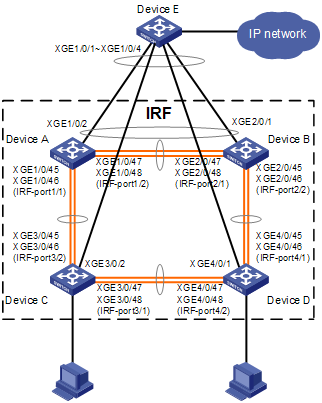

Network requirements
As shown in Figure 15, set up a four-chassis IRF fabric at the access layer of the enterprise network.
Configure LACP MAD on the multichassis aggregation to Device E, an H3C device that supports extended LACP.
Figure 15 Network diagram
Configuration procedure
1.      Configure Device A:
# Shut down the physical interfaces used for IRF links. This example uses the SFP+ port group that contains Ten-GigabitEthernet 1/0/45 to Ten-GigabitEthernet 1/0/48 for IRF links.
<Sysname> system-view
[Sysname] interface range ten-gigabitethernet 1/0/45 to ten-gigabitethernet 1/0/48
[Sysname-if-range] shutdown
[Sysname-if-range] quit
# Bind Ten-GigabitEthernet 1/0/45 and Ten-GigabitEthernet 1/0/46 to IRF-port 1/1.
[Sysname] irf-port 1/1
[Sysname-irf-port1/1] port group interface ten-gigabitethernet 1/0/45
[Sysname-irf-port1/1] port group interface ten-gigabitethernet 1/0/46
[Sysname-irf-port1/1] quit
# Bind Ten-GigabitEthernet 1/0/47 and Ten-GigabitEthernet 1/0/48 to IRF-port 1/2.
[Sysname] irf-port 1/2
[Sysname-irf-port1/2] port group interface ten-gigabitethernet 1/0/47
[Sysname-irf-port1/2] port group interface ten-gigabitethernet 1/0/48
[Sysname-irf-port1/2] quit
# Bring up the SFP+ ports and save the configuration.
[Sysname-if-range] undo shutdown
[Sysname] save
# Activate the IRF port configuration.
[Sysname] irf-port-configuration active
2.      Configure Device B:
# Change the member ID of Device B to 2 and reboot the device to validate the change.
[Sysname] irf member 1 renumber 2
Renumbering the member ID may result in configuration change or loss. Continue? [Y/N]:y
[Sysname] quit
<Sysname> reboot
# Connect Device B to Device A as shown in Figure 15, and log in to Device B. This example uses the SFP+ group that contains Ten-GigabitEthernet 2/0/45 to Ten-GigabitEthernet 2/0/48 for IRF links.
# Shut down the physical interfaces.
[Sysname] interface range ten-gigabitethernet 2/0/45 to ten-gigabitethernet 2/0/48
# Bind Ten-GigabitEthernet 2/0/47 and Ten-GigabitEthernet 2/0/48 to IRF-port 2/1.
[Sysname] irf-port 2/1
[Sysname-irf-port2/1] port group interface ten-gigabitethernet 2/0/47
[Sysname-irf-port2/1] port group interface ten-gigabitethernet 2/0/48
[Sysname-irf-port2/1] quit
# Bind Ten-GigabitEthernet 2/0/45 and Ten-GigabitEthernet 2/0/46 to IRF-port 2/2.
[Sysname] irf-port 2/2
[Sysname-irf-port2/2] port group interface ten-gigabitethernet 2/0/45
[Sysname-irf-port2/2] port group interface ten-gigabitethernet 2/0/46
[Sysname-irf-port2/2] quit
[Sysname] save
The two devices perform master election, and the one that has lost the election reboots to form an IRF fabric with the master.
3.      Configure Device C:
# Change the member ID of Device C to 3 and reboot the device to validate the change.
[Sysname] irf member 1 renumber 3
[Sysname] quit
<Sysname> reboot
# Connect Device C to Device A as shown in Figure 15, and log in to Device C. This example uses the SFP+ port group that contains Ten-GigabitEthernet 3/0/45 to Ten-GigabitEthernet 3/0/48 for IRF links.
[Sysname] interface range ten-gigabitethernet 3/0/45 to ten-gigabitethernet 3/0/48
# Bind Ten-GigabitEthernet 3/0/47 and Ten-GigabitEthernet 3/0/48 to IRF-port 3/1.
[Sysname] irf-port 3/1
[Sysname-irf-port3/1] port group interface ten-gigabitethernet 3/0/47
[Sysname-irf-port3/1] port group interface ten-gigabitethernet 3/0/48
[Sysname-irf-port3/1] quit
# Bind Ten-GigabitEthernet 3/0/45 and Ten-GigabitEthernet 3/0/46 to IRF-port 3/2.
[Sysname] irf-port 3/2
[Sysname-irf-port3/2] port group interface ten-gigabitethernet 3/0/45
[Sysname-irf-port3/2] port group interface ten-gigabitethernet 3/0/46
[Sysname-irf-port3/2] quit
[Sysname] save
Device C reboots to join the IRF fabric.
4.      Configure Device D:
# Change the member ID of Device D to 4 and reboot the device to validate the change.
[Sysname] irf member 1 renumber 4
[Sysname] quit
<Sysname> reboot
# Connect Device D to Device B and Device C as shown in Figure 15, and log in to Device D. This example uses the SFP+ port group that contains Ten-GigabitEthernet 4/0/45 to Ten-GigabitEthernet 4/0/48 for IRF links.
[Sysname] interface range ten-gigabitethernet 4/0/45 to ten-gigabitethernet 4/0/48
# Bind Ten-GigabitEthernet 4/0/45 and Ten-GigabitEthernet 4/0/46 to IRF-port 4/1.
[Sysname] irf-port 4/1
[Sysname-irf-port4/1] port group interface ten-gigabitethernet 4/0/45
[Sysname-irf-port4/1] port group interface ten-gigabitethernet 4/0/46
[Sysname-irf-port4/1] quit
# Bind Ten-GigabitEthernet 4/0/47 and Ten-GigabitEthernet 4/0/48 to IRF-port 4/2.
[Sysname] irf-port 4/2
[Sysname-irf-port4/2] port group interface ten-gigabitethernet 4/0/47
[Sysname-irf-port4/2] port group interface ten-gigabitethernet 4/0/48
[Sysname-irf-port4/2] quit
[Sysname] save
Device D reboots to join the IRF fabric. A four-chassis IRF fabric is formed.
5.      Configure LACP MAD on the IRF fabric:
# Set the domain ID of the IRF fabric to 1.
[Sysname] irf domain 1
# Create a dynamic aggregate interface and enable LACP MAD.
[Sysname] interface bridge-aggregation 2
[Sysname-Bridge-Aggregation2] link-aggregation mode dynamic
[Sysname-Bridge-Aggregation2] mad enable
You need to assign a domain ID (range: 0-4294967295)
[Current domain is: 1]:
 The assigned  domain ID is: 1
 Info: MAD LACP only enable on dynamic aggregation interface.
[Sysname-Bridge-Aggregation2] quit
# Assign Ten-GigabitEthernet 1/0/2, Ten-GigabitEthernet 2/0/1, Ten-GigabitEthernet 3/0/2, and Ten-GigabitEthernet 4/0/1 to the aggregate interface.
[Sysname] interface range ten-gigabitethernet 1/0/2 ten-gigabitethernet 2/0/1 ten-gigabitethernet 3/0/2 ten-gigabitethernet 4/0/1
[Sysname-if-range] port link-aggregation group 2
6.      Configure Device E as the intermediate device:
CAUTION:
If the intermediate device is also an IRF fabric, assign the two IRF fabrics different domain IDs for correct split detection. False detection causes IRF split.
# Create a dynamic aggregate interface.
# Assign Ten-GigabitEthernet 1/0/1, Ten-GigabitEthernet 1/0/2, Ten-GigabitEthernet 1/0/3, and Ten-GigabitEthernet 1/0/4 to the aggregate interface.
[Sysname] interface range ten-gigabitethernet 1/0/1 to ten-gigabitethernet 1/0/4
BFD MAD-enabled IRF configuration example
As shown in Figure 16, set up a four-chassis IRF fabric at the core layer of the enterprise network.
·           Configure BFD MAD in the IRF fabric and set up BFD MAD links between each member device and the intermediate device.
·           Disable the spanning tree feature on the ports used for BFD MAD, because the two features conflict with each other.
Figure 16 Network diagram

ARP MAD-enabled IRF configuration example
As shown in Figure 17, set up a four-chassis IRF fabric in the enterprise network.
·           Configure ARP MAD in the IRF fabric and use the links connected to Device E for transmitting ARP MAD packets.
·           To prevent loops, run the spanning tree feature between Device E and the IRF fabric.
Figure 17 Network diagram
[Sysname] save
[Sysname] quit
<Sysname> reboot
# Connect Device B to Device A as shown in Figure 17, and log in to Device B. This example uses the SFP+ group that contains Ten-GigabitEthernet 2/0/45 to Ten-GigabitEthernet 2/0/48 for IRF links.
[Sysname] save
[Sysname] quit
<Sysname> reboot
# Connect Device C to Device A as shown in Figure 17, and log in to Device C. This example uses the SFP+ port group that contains Ten-GigabitEthernet 3/0/45 to Ten-GigabitEthernet 3/0/48 for IRF links.
[Sysname] save
[Sysname] quit
<Sysname> reboot
# Connect Device D to Device B and Device C as shown in Figure 17, and log in to Device D. This example uses the SFP+ port group that contains Ten-GigabitEthernet 4/0/45 to Ten-GigabitEthernet 4/0/48 for IRF links.
[Sysname] save
5.      Configure ARP MAD on the IRF fabric:
# Enable the spanning tree feature globally. Map the ARP MAD VLAN to MSTI 1 in the MST region.
[Sysname] stp global enable
[Sysname] stp region-configuration
[Sysname-mst-region] region-name arpmad
[Sysname-mst-region] instance 1 vlan 3
[Sysname-mst-region] active region-configuration
[Sysname-mst-region] quit
# Configure the IRF fabric to change its bridge MAC address as soon as the address owner leaves.
[Sysname] undo irf mac-address persistent
# Create VLAN 3, and assign Ten-GigabitEthernet 1/0/2, Ten-GigabitEthernet 2/0/1, Ten-GigabitEthernet 3/0/2, and Ten-GigabitEthernet 4/0/1 to VLAN 3.
[Sysname] vlan 3
[Sysname-vlan3] port ten-gigabitethernet 1/0/2 ten-gigabitethernet 2/0/1 ten-gigabitethernet 3/0/2 ten-gigabitethernet 4/0/1
[Sysname-vlan3] quit
# Create VLAN-interface 3, assign it an IP address, and enable ARP MAD on the interface.
[Sysname] interface vlan-interface 3
[Sysname-Vlan-interface3] ip address 192.168.2.1 24
[Sysname-Vlan-interface3] mad arp enable
CAUTION:
If the intermediate device is also in an IRF fabric, assign the two IRF fabrics different domain IDs for correct split detection. False detection causes IRF split.
<DeviceE> system-view
[DeviceE] stp global enable
[DeviceC] stp region-configuration
[DeviceC-mst-region] region-name arpmad
[DeviceC-mst-region] instance 1 vlan 3
[DeviceC-mst-region] active region-configuration
[DeviceC-mst-region] quit
# Create VLAN 3, and assign ports Ten-GigabitEthernet 1/0/1, Ten-GigabitEthernet 1/0/2, Ten-GigabitEthernet 1/0/3, and Ten-GigabitEthernet 1/0/4 to VLAN 3 for forwarding ARP MAD packets.
[DeviceE] vlan 3
[DeviceE-vlan3] port ten-gigabitethernet 1/0/1 to ten-gigabitethernet 1/0/4
[DeviceE-vlan3] quit

# Connect Device C to Device A as shown in Figure 18, and log in to Device C. This example uses the SFP+ port group that contains Ten-GigabitEthernet 3/0/45 to Ten-GigabitEthernet 3/0/48 for IRF links.
[Sysname] save
[Sysname] quit
<Sysname> reboot
# Connect Device D to Device B and Device C as shown in Figure 18, and log in to Device D. This example uses the SFP+ port group that contains Ten-GigabitEthernet 4/0/45 to Ten-GigabitEthernet 4/0/48 for IRF links.
[Sysname] save
5.      Configure ND MAD on the IRF fabric:
# Enable the spanning tree feature globally. Map the ND MAD VLAN to MSTI 1 in the MST region.
[Sysname-mst-region] region-name ndmad
# Create VLAN 3, and add Ten-GigabitEthernet 1/0/2, Ten-GigabitEthernet 2/0/1, Ten-GigabitEthernet 3/0/2, and Ten-GigabitEthernet 4/0/1 to VLAN 3.
[Sysname] vlan 3
# Create VLAN-interface 3, assign it an IPv6 address, and enable ND MAD on the interface.
[Sysname-Vlan-interface3] ipv6 address 2001::1 64
[Sysname-Vlan-interface3] mad nd enable
CAUTION:
[DeviceC-mst-region] region-name ndmad
# Create VLAN 3, and add ports Ten-GigabitEthernet 1/0/1, Ten-GigabitEthernet 1/0/2, Ten-GigabitEthernet 1/0/3, and Ten-GigabitEthernet 1/0/4 to VLAN 3 for forwarding ND MAD packets.
[DeviceE] vlan 3
Overview
IRF 3 integrates multiple lower-layer devices with a higher-layer IRF fabric to provide high-density, low-cost connectivity at the access layer.
In an IRF 3 system, the higher-layer IRF fabric is called the parent fabric and the lower-layer devices are called port extenders (PEXs). You can manage and configure the PEXs from the parent fabric as if they were interface cards on the parent fabric.
Typically, IRF 3 works at the access layer of data centers. As shown in Figure 19, the access layer of a network is virtualized into an IRF 3 system. The system contains one parent fabric (a two-chassis IRF fabric) and multiple PEXs to provide connectivity for servers and hosts.
Figure 19 IRF 3 application scenario
IRF 3 provides the following benefits:
·           Simplified topologyDevices in an IRF 3 system appear as one node. For redundancy and load balancing, a downstream or upstream device can connect to the IRF 3 system through multichassis link aggregation. Together with link aggregation, IRF 3 creates a loop-free Layer 2 network. The spanning tree feature is not needed among devices in the IRF 3 system or on the link aggregations. IRF 3 also simplifies the Layer 3 network topology because it reduces the number of routing peers. The network topology does not change when a device is added to or removed from the IRF 3 system.
·           Single point of managementAn IRF 3 system is accessible at a single IP address on the network. You can use this IP address to log in through any network port to manage all the devices in the system. For an SNMP NMS, an IRF 3 system is one managed network node.
·           Network scalability and resiliency—You can increase the number of ports in an IRF 3 system by adding PEXs without changing network topology.
·           High availability—Each PEX has multiple high-speed physical ports for uplink connectivity to the parent fabric. The links on these ports are aggregated and load balanced automatically.
·           Decreased TCO—IRF 3 decreases hardware investments and management costs. In an IRF 3 system, the parent fabric performs all the management and routing functions, and the PEXs only forwards traffic. You can add low-performance devices as PEXs to an IRF 3 system for network scalability. In addition, PEXs can load software and synchronize configuration from the parent fabric without administrative intervention.
Basic concepts

Data forwarding
By default, the PEXs do not have local forwarding capability.
The PEXs send any incoming traffic to the parent fabric. The parent fabric makes the forwarding decisions and sends the traffic to the outgoing interfaces. Figure 20 shows the data forwarding model.
