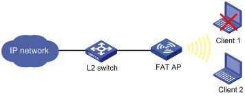

Blacklist and white list
You can configure the blacklist and white list functions to filter frames from WLAN clients and implement client access control.
WLAN client access control is accomplished through the following types of lists.
·          White list—Contains the MAC addresses of all clients allowed to access the WLAN. If the white list is used, only permitted clients can access the WLAN, and all frames from other clients are discarded.
·          Static blacklist—Contains the MAC addresses of clients forbidden to access the WLAN. This list is manually configured.
·          Dynamic blacklist—Contains the MAC addresses of clients forbidden to access the WLAN. A client is dynamically added to the list if it is considered sending attacking frames until the timer of the entry expires.
When an AP receives an 802.11 frame, it checks the source MAC address of the frame and processes the frame by following these rules:
1.        If the source MAC address does not match any entry in the white list, the frame is dropped. If there is a match, the frame is considered valid and is processed further.
2.        If no white list entries exist, the static and dynamic blacklists are searched.
3.        If the source MAC address matches an entry in any of the two lists, the frame is dropped.
4.        If there is no match, or no blacklist entries exist, the frame is considered valid and is processed further.
Figure 1 Frame filtering
If client 1 is present in the backlist, it cannot associate with the fat AP. If it is only in the white list, it can get associated with the fat AP.
