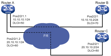

Example: Connecting routers through POS interfaces across a Frame Relay network
As shown in Figure 2, use POS subinterfaces to connect Router A to Router B and Router C across a Frame Relay network. The routers are all DTEs on the Frame Relay network.
1. Configure Router A:
# Set the clock mode to slave on POS 2/2/1.
<RouterA> system-view
[RouterA] interface pos 2/2/1
[RouterA-Pos2/2/1] clock slave
# Enable Frame Relay on POS 2/2/1.
[RouterA-Pos2/2/1] link-protocol fr
# Configure POS 2/2/1 as DTE.
[RouterA-Pos2/2/1] fr interface-type dte
[RouterA-Pos2/2/1] quit
# Create subinterface 1 on POS 2/2/1 and assign an IP address to it.
[RouterA] interface pos 2/2/1.1
[RouterA-Pos2/2/1.1] ip address 10.10.10.1 255.255.255.0
# Assign a virtual circuit with DLCI 50 to subinterface 1.
[RouterA-Pos2/2/1.1] fr dlci 50
[RouterA-Pos2/2/1.1-fr-dlci-50] quit
# Map DLCI 50 to the peer IP address 10.10.10.2.
[RouterA-Pos2/2/1.1] fr map ip 10.10.10.2 50
# Set the MTU to 1500 for subinterface 1.
[RouterA-Pos2/2/1.1] mtu 1500
[RouterA-Pos2/2/1.1] quit
# Create subinterface 2 on POS 2/2/1 and assign an IP address to it.
[RouterA] interface pos 2/2/1.2
[RouterA-Pos2/2/1.2] ip address 20.10.10.1 255.255.255.0
# Assign a virtual circuit with DLCI 60 to subinterface 2.
[RouterA-Pos2/2/1.2] fr dlci 60
[RouterA-Pos2/2/1.2-fr-dlci-60] quit
# Map DLCI 60 to the peer IP address 20.10.10.2.
[RouterA-Pos2/2/1.2] fr map ip 20.10.10.2 60
# Set the MTU to 1500 for subinterface 2.
[RouterA-Pos2/2/1.2] mtu 1500
[RouterA-Pos2/2/1.2] quit
2. Configure Router B:
[RouterB] interface pos 2/2/1
[RouterB-Pos2/2/1] clock slave
[RouterB-Pos2/2/1] link-protocol fr
[RouterB-Pos2/2/1] fr interface-type dte
# Assign an IP address to POS 2/2/1.
[RouterB-Pos2/2/1] ip address 10.10.10.2 255.255.255.0
# Assign a virtual circuit with DLCI 70 to POS 2/2/1.
[RouterB-Pos2/2/1] fr dlci 70
[RouterB-Pos2/2/1-fr-dlci-70] quit
# Map DLCI 70 to the peer IP address 10.10.10.1.
[RouterB-Pos2/2/1] fr map ip 10.10.10.1 70
# Set the MTU to 1500 for POS 2/2/1.
[RouterB-Pos2/2/1] mtu 1500
[RouterB-Pos2/2/1] quit
3. Configure Router C in the same way Router B is configured. (Details not shown.)
# Display brief information about the POS interfaces on Router A.
[RouterA] display interface pos brief
Brief information on interfaces in route mode:
Link: ADM - administratively down; Stby - standby
Protocol: (s) - spoofing
Interface Link Protocol Primary IP Description
Pos2/2/1.1 UP UP 10.10.10.1
Pos2/2/1.2 UP UP 20.10.10.1
The output shows that both the physical state and the link layer protocol state of POS 2/2/1.1 and POS 2/2/1.2 on Router A are up.
# Display brief information about the POS interfaces on Router B.
[RouterB] display interface pos brief
Pos2/2/1.1 UP UP 10.10.10.2
Pos2/2/1.2 UP UP 20.10.10.2
The output shows that both the physical state and the link layer protocol state of POS 2/2/1.1 and POS 2/2/1.2 on Router B are up.
# Ping Router B from Router A.
[RouterA] ping 10.10.10.2
Ping 10.10.10.2 (10.10.10.2): 56 data bytes, press CTRL_C to break
56 bytes from 10.10.10.2: icmp_seq=0 ttl=255 time=0.127 ms
56 bytes from 10.10.10.2: icmp_seq=1 ttl=255 time=0.091 ms
56 bytes from 10.10.10.2: icmp_seq=2 ttl=255 time=0.072 ms
56 bytes from 10.10.10.2: icmp_seq=3 ttl=255 time=0.074 ms
56 bytes from 10.10.10.2: icmp_seq=4 ttl=255 time=0.079 ms
--- Ping statistics for 10.10.10.2 ---
round-trip min/avg/max/std-dev = 0.072/0.089/0.127/0.020 ms
The output shows that Router A and Router B can reach each other.
# Ping Router C from Router A.
[RouterA] ping 20.10.10.2
Ping 20.10.10.2 (20.10.10.2): 56 data bytes, press CTRL_C to break
56 bytes from 20.10.10.2: icmp_seq=0 ttl=255 time=0.127 ms
56 bytes from 20.10.10.2: icmp_seq=1 ttl=255 time=0.091 ms
56 bytes from 20.10.10.2: icmp_seq=2 ttl=255 time=0.072 ms
56 bytes from 20.10.10.2: icmp_seq=3 ttl=255 time=0.074 ms
56 bytes from 20.10.10.2: icmp_seq=4 ttl=255 time=0.079 ms
--- Ping statistics for 20.10.10.2 ---
The output shows that Router A and Router C can reach each other.
