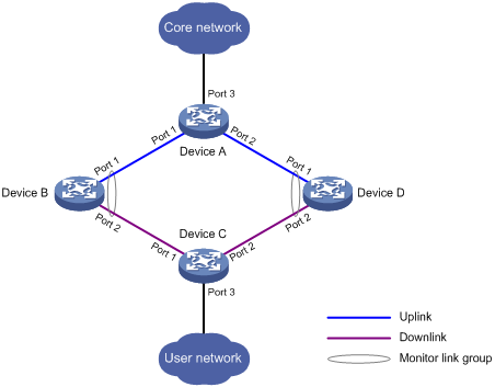

Overview
Monitor Link associates the state of downlink interfaces with the state of uplink interfaces in a monitor link group. When Monitor Link shuts down the downlink interfaces because of an uplink failure, the downstream device changes connectivity to another link.
Figure 1 Monitor Link application scenario
A monitor link group contains uplink and downlink interfaces. An interface can belong to only one monitor link group.
·     Uplink interfaces are the monitored interfaces. The state of a monitor link group is associated with the state of its member uplink interfaces. When the number of uplink interfaces in up state in a monitor link group is less than the specified threshold, the monitor link group goes down and shuts down its downlink interfaces. When the number of uplink interfaces in up state reaches the threshold, the monitor link group comes up and brings up all its downlink interfaces.
·     Downlink interfaces are the monitoring interfaces. The state of the downlink interfaces is associated with the state of the monitor link group. When the state of the monitor link group changes, the state of its member downlink interfaces changes to be consistent with the group state.
As shown in Figure 1:
·     Port 1 and Port 2 of Device B form a monitor link group.
·     Port 1 and Port 2 of Device D form another monitor link group.
·     Port 1 is an uplink interface on both devices, and Port 2 is a downlink interface on both devices.
A monitor link group works independently of other monitor link groups. When the number of uplink interfaces in up state in a monitor link group is less than the specified threshold, the monitor link group goes down. It forces all downlink interfaces down at the same time. When the number of uplink interfaces in up state reaches the threshold, the monitor link group comes up and brings up all the downlink interfaces.

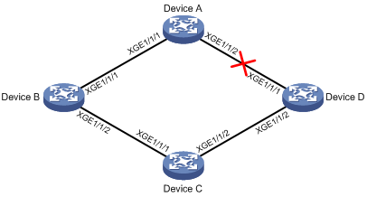

Monitor Link configuration example
Network requirements
As shown in Figure 2:
·     Device C is a Smart Link device, and Device A, Device B, and Device D are associated devices. Traffic of VLANs 1 through 30 on Device C is dual-uplinked to Device A through a smart link group.
·     Implement dual uplink backup on Device C. When the link between Device A and Device B (or Device D) fails, Device C can detect the link fault. It then performs uplink switchover in the smart link group.
For more information about Smart Link, see "Configuring Smart Link."
Figure 2 Network diagram
Configuration procedure
1.     Configure Device C:
# Create VLANs 1 through 30.
<DeviceC> system-view
[DeviceC] vlan 1 to 30
# Map these VLANs to MSTI 1.
[DeviceC] stp region-configuration
[DeviceC-mst-region] instance 1 vlan 1 to 30
# Activate MST region configuration.
[DeviceC-mst-region] active region-configuration
[DeviceC-mst-region] quit
# Shut down Ten-GigabitEthernet 1/1/1.
[DeviceC] interface ten-gigabitethernet 1/1/1
[DeviceC-Ten-GigabitEthernet1/1/1] shutdown
# Disable the spanning tree feature on the interface.
[DeviceC-Ten-GigabitEthernet1/1/1] undo stp enable
# Configure the interface as a trunk port.
[DeviceC-Ten-GigabitEthernet1/1/1] port link-type trunk
# Assign the interface to VLANs 1 through 30.
[DeviceC-Ten-GigabitEthernet1/1/1] port trunk permit vlan 1 to 30
[DeviceC-Ten-GigabitEthernet1/1/1] quit
# Configure Ten-GigabitEthernet 1/1/2 in the same way Ten-GigabitEthernet 1/1/1 is configured.
[DeviceC] interface ten-gigabitethernet 1/1/2
[DeviceC-Ten-GigabitEthernet1/1/2] shutdown
[DeviceC-Ten-GigabitEthernet1/1/2] undo stp enable
[DeviceC-Ten-GigabitEthernet1/1/2] port link-type trunk
[DeviceC-Ten-GigabitEthernet1/1/2] port trunk permit vlan 1 to 30
[DeviceC-Ten-GigabitEthernet1/1/2] quit
# Create smart link group 1, and configure all the VLANs mapped to MSTI 1 as the protected VLANs for smart link group 1.
[DeviceC] smart-link group 1
[DeviceC-smlk-group1] protected-vlan reference-instance 1
# Configure Ten-GigabitEthernet 1/1/1 as the primary port and Ten-GigabitEthernet 1/1/2 as the secondary port for smart link group 1.
[DeviceC-smlk-group1] port ten-gigabitethernet 1/1/1 primary
[DeviceC-smlk-group1] port ten-gigabitethernet 1/1/2 secondary
# Enable the smart link group to transmit flush messages.
[DeviceC-smlk-group1] flush enable
[DeviceC-smlk-group1] quit
# Bring up Ten-GigabitEthernet 1/1/1 and Ten-GigabitEthernet 1/1/2.
[DeviceC-Ten-GigabitEthernet1/1/1] undo shutdown
[DeviceC-Ten-GigabitEthernet1/1/2] undo shutdown
[DeviceD-Ten-GigabitEthernet1/1/2] port trunk permit vlan 1 to 30
# Enable flush message receiving on the interface.
[DeviceD-Ten-GigabitEthernet1/1/2] smart-link flush enable
[DeviceD-Ten-GigabitEthernet1/1/2] quit
# Create monitor link group 1.
[DeviceD] monitor-link group 1
# Configure Ten-GigabitEthernet 1/1/1 as an uplink interface for monitor link group 1.
[DeviceD-mtlk-group1] port ten-gigabitethernet 1/1/1 uplink
# Configure Ten-GigabitEthernet 1/1/2 as a downlink interface for monitor link group 1.
[DeviceD-mtlk-group1] port ten-gigabitethernet 1/1/2 downlink
[DeviceD-mtlk-group1] quit
# When Ten-GigabitEthernet 1/1/2 on Device A goes down because of a link fault, verify information about monitor link group 1 on Device B.
[DeviceB] display monitor-link group 1
Monitor link group 1 information:
  Group status     : UP
  Downlink up-delay: 0(s)
  Last-up-time     : 16:38:26 2012/4/21
  Last-down-time   : 16:37:20 2012/4/21
  Up-port-threshold: 1
  Member                    Role       Status
  XGE1/1/1                  UPLINK     UP
  XGE1/1/2                  DOWNLINK   UP
# Verify information about monitor link group 1 on Device D.
[DeviceD] display monitor-link group 1
  Group status     : DOWN
  Last-up-time     : 16:37:20 2012/4/21
  Last-down-time   : 16:38:26 2012/4/21
  Member                    Role       Status
  XGE1/1/1                  UPLINK     DOWN
  XGE1/1/2                  DOWNLINK   DOWN
