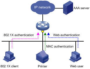

Triple authentication enables an access port to perform Web, MAC, and 802.1X authentication. A terminal can access the network if it passes one type of authentication.
Triple authentication is suitable for a LAN that comprises terminals that require different authentication services, as shown in Figure 1. The triple authentication-enabled access port can perform MAC authentication for the printer, 802.1X authentication for the PC installed with the 802.1X client, and Web authentication for the Web user.
Figure 1 Triple authentication network diagram
In triple authentication, 802.1X authentication supports only the MAC-based access control method.
For more information about Web authentication, MAC authentication and 802.1X authentication, see "Configuring Web authentication," "Configuring MAC authentication," and "Configuring 802.1X."
Triple authentication mechanism
The three types of authentication are triggered by different packets:
·     The access port performs MAC authentication for a terminal when it receives an ARP or DHCP broadcast packet from the terminal for the first time. If the terminal passes MAC authentication, the terminal can access the network. If the MAC authentication fails, the access port performs 802.1X or Web authentication.
·     The access port performs 802.1X authentication when it receives an EAP packet from an 802.1X client or a third-party client. If the unicast trigger feature of 802.1X is enabled on the access port, any packet from the client can trigger an 802.1X authentication.
·     The access port performs Web authentication when it receives an HTTP packet from a terminal.
If a terminal triggers different types of authentication, the authentications are processed at the same time. The failure of one type of authentication does not affect the others. When a terminal passes one type of authentication, the other types of authentication are processed as follows:
·     If the terminal first passes MAC authentication, Web authentication is terminated immediately, but 802.1X authentication will proceed. If the terminal also passes 802.1X authentication, the 802.1X authentication information will overwrite the MAC authentication information for the terminal. If the terminal fails 802.1X authentication, the user stays online as a MAC authentication user, and only 802.1X authentication can be triggered again.
·     If the terminal first passes 802.1X or Web authentication, the other types of authentication are terminated immediately and cannot be triggered again.

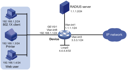

Network requirements
As shown in Figure 2, the terminals are connected to the device to access the IP network. Configure triple authentication on the device's Layer 2 interface that connects to the terminals. A terminal passing one of the three authentication methods, 802.1X authentication, Web authentication, and MAC authentication, can access the IP network.
·     Assign IP addresses on subnet 192.168.1.0/24 to the terminals.
·     Use the remote RADIUS server to perform authentication, authorization, and accounting. Configure the device to send usernames carrying no ISP domain names to the RADIUS server.
·     Configure the local Web authentication server on the device to use listening IP address 4.4.4.4. Configure the device to send a default authentication page to the Web user and forward authentication data by using HTTP.
Figure 2 Network diagram
Configuration prerequisites and restrictions
·     Make sure that the terminals, the server, and the device can reach each other.
·     Make sure the terminal of the Web user has a route to the listening IP address of the local Web authentication server.
·     Configure the RADIUS server to provide normal authentication, authorization, and accounting for users. In this example, configure the following on the RADIUS server:
?     An 802.1X user with username userdot.
?     A Web authentication user with username userpt.
?     A MAC authentication user with a username and password both being the MAC address of the printer f07d6870725f.
·     Edit authentication pages, compress the pages to a .zip file named abc, and upload the .zip file to the device by FTP.
Configuration procedure
1.     Configure Web authentication:
# Configure VLANs and IP addresses for the VLAN interfaces, and add ports to specific VLANs. (Details not shown.)
# Create an HTTP-based local portal Web service, and specify file abc.zip as the default authentication page file of the local Web service.
<Device> system-view
[Device] portal local-web-server http
[Device-portal-local-websvr-http] default-logon-page abc.zip
[Device-portal-local-websvr-http] quit
# Configure the IP address of interface loopback 0 as 4.4.4.4.
[Device] interface loopback 0
[Device-LoopBack0] ip address 4.4.4.4 32
[Device-LoopBack0] quit
# Create a Web authentication server named webserver and enter its view.
[Device] web-auth server webserver
# Configure the redirection URL for the Web authentication server as http://4.4.4.4/portal/.
[Device-web-auth-server-webserver] url http://4.4.4.4/portal/
# Set the IP address and port number of Web authentication server to 4.4.4.4 and 80.
[Device-web-auth-server-webserver] ip 4.4.4.4 port 80
[Device-web-auth-server-webserver] quit
# Enable Web authentication on GigabitEthernet 1/0/1, and specify the Web authentication server webserver for the port.
[Device–GigabitEthernet1/0/1] web-auth enable apply server webserver
[Device–GigabitEthernet1/0/1] quit
2.     Configure 802.1X authentication:
# Enable 802.1X authentication globally.
[Device] dot1x
# Enable 802.1X authentication (MAC-based access control required) on GigabitEthernet 1/0/1.
[Device–GigabitEthernet1/0/1] dot1x port-method macbased
3.     Configure MAC authentication:
# Enable MAC authentication globally.
[Device] mac-authentication
# Enable MAC authentication on GigabitEthernet 1/0/1.
[Device–GigabitEthernet1/0/1] mac-authentication
4.     Configure a RADIUS scheme:
# Create a RADIUS scheme named rs1.
[Device] radius scheme rs1
# Specify the primary authentication and accounting servers and keys.
[Device-radius-rs1] primary authentication 1.1.1.2
[Device-radius-rs1] primary accounting 1.1.1.2
[Device-radius-rs1] key authentication simple radius
[Device-radius-rs1] key accounting simple radius
# Specify usernames sent to the RADIUS server to carry no domain names.
[Device-radius-rs1] user-name-format without-domain
[Device-radius-rs1] quit
5.     Configure an ISP domain:
# Create an ISP domain named triple.
[Device] domain triple
# Configure the domain to use RADIUS scheme rs1 for authentication, authorization and accounting of LAN access users.
[Device-isp-triple] authentication lan-access radius-scheme rs1
[Device-isp-triple] authorization lan-access radius-scheme rs1
[Device-isp-triple] accounting lan-access radius-scheme rs1
[Device-isp-triple] quit
# Configure domain triple as the default domain. If a username entered by a user includes no ISP domain name, the AAA method of the default domain is used.
[Device] domain default enable triple

·     After passing authentication, the printer obtains IP address 3.3.3.111/24 that is bound with its MAC address through DHCP.
·     Use the remote RADIUS server to perform authentication, authorization, and accounting. Configure the device to remove the ISP domain names from usernames sent to the RADIUS server.
·     Configure VLAN 3 as the authorization VLAN. Users passing authentication are added to this VLAN.
·     Configure VLAN 2 as the authentication failure VLAN. Users failing authentication are added to this VLAN.
Figure 3 Network diagram
Configuration prerequisites and guidelines
·     Make sure the terminals, the servers, and the device can reach each other.
?     An authorization VLAN (VLAN 3).
·     Configure the IP address of server update as the authentication-free IP address.
·     Edit authentication pages, compress the pages to a .zip file named defaultfile and upload the .zip file to the device by FTP.
·     Set the DHCP lease according to the network condition and how the terminals update their IP addresses.
A short lease is recommended to shorten the time that terminals use to re-acquire IP addresses after passing or failing authentication. This example uses the lease of 1 minute.
Some terminals do not need to wait for the lease to update their IP addresses. For example, the iNode 802.1X client can automatically renew its IP address after disconnecting from the server.
