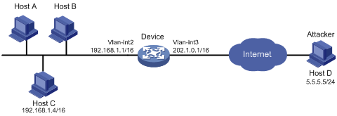

Attack detection and prevention configuration examples
Interface-based attack detection and prevention configuration example
Network requirements
As shown in Figure 1, the device is the gateway for the internal network.
Configure an attack defense policy and apply the policy to VLAN-interface 3 to meet the following requirements:
·     Provide low-level scanning attack detection for internal hosts and servers. If a scanning attack is detected, log the attack and keep the attacker on the blacklist for 10 minutes.
·     Protect internal hosts and servers against smurf attacks. If a smurf attack is detected, log the attack.
Figure 1 Network diagram
Configuration procedure

IP blacklist configuration example
As shown in Figure 2, configure the IP blacklist feature on the device to block packets from the attacker Host D permanently and from Host C for 50 minutes.
Figure 2 Network diagram
# Configure IP addresses for the interfaces on the device. (Details not shown.)
# Enable the global blacklist feature.
<Device> system-view
[Device] blacklist global enable
# Add an IPv4 blacklist entry for Host D.
[Device] blacklist ip 5.5.5.5
# Add an IPv4 blacklist entry for Host C and set the blacklist entry aging time to 50 minutes.
[Device] blacklist ip 192.168.1.4 timeout 50
# Verify that the IPv4 blacklist entries are successfully added.
<Device> display blacklist ip
IP address      VPN instance   DS-Lite tunnel peer  Type    TTL(sec) Dropped
5.5.5.5         --             --                   Manual  Never    0
192.168.1.4     --             --                   Manual  2989     0
# Verify that the device drops packets from Host D. (Details not shown.)
# Execute the undo blacklist ip 5.5.5.5 command and verify that the device forwards packets from Host D. (Details not shown.)
# Verify that the device drops packets from Host C for 50 minutes and forwards packets from Host C after 50 minutes. (Details not shown.)
