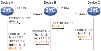

The principle of ping –r is as shown in Figure 1.
1.        The source (Device A) sends an ICMP echo request with the RR option being empty to the destination (Device C).
2.        The intermediate device (Device B) adds the IP address (1.1.2.1) of its outbound interface to the RR option of the ICMP echo request, and forwards the packet.
3.        Upon receiving the request, the destination device copies the RR option in the request and adds the IP address (1.1.2.2) of its outbound interface to the RR option. Then the destination device sends an ICMP echo reply.
4.        The intermediate device adds the IP address (1.1.1.2) of its outbound interface to the RR option in the ICMP echo reply, and then forwards the reply.
5.        Upon receiving the reply, the source device adds the IP address (1.1.1.1) of its inbound interface to the RR option. Finally, you can get the detailed information of routes from Device A to Device C: 1.1.1.1 <-> {1.1.1.2; 1.1.2.1} <-> 1.1.2.2.

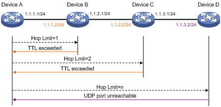

Tracert
Introduction
To check whether a network is available, you can use the tracert command to trace the Layer 3 device involved in delivering an IP packet from source to destination. This is useful for identification of failed node(s) in the event of network failure.
Figure 2 Tracert diagram
The tracert function is implemented through ICMP, as shown in Figure 2:
1.        The source (Device A) sends a packet with a TTL value of 1 to the destination (Device D). The UDP port of the packet is a port number that will not be used by any application of the destination.
2.        The first hop (Device B) (the Layer 3 device that first receives the packet) responds by sending a TTL-expired ICMP error message to the source, with its IP address 1.1.1.2 encapsulated. In this way, the source device receives the address (1.1.1.2) of the first Layer 3 device.
3.        The source device sends a packet with a TTL value of 2 to the destination device.
4.        The second hop (Device C) responds with a TTL-expired ICMP error message, which gives the source device the address (1.1.2.2) of the second Layer 3 device.
5.        The above process continues until the ultimate destination device is reached. No application of the destination uses this UDP port. Therefore, the destination replies a port unreachable ICMP error message with the destination IP address 1.1.3.2.
6.        When the source device receives the port unreachable ICMP error message, it knows that the packet has reached the destination, and that it has received the addresses of all the Layer 3 devices involved in delivering the packet to the destination device (1.1.1.2, 1.1.2.2, 1.1.3.2).
