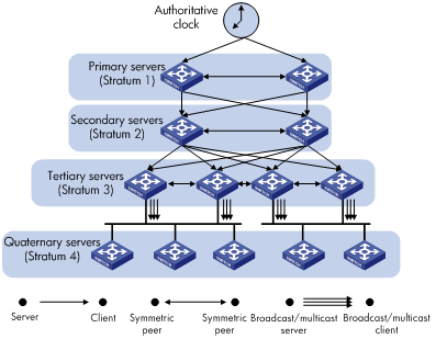

NTP architecture
NTP uses stratums 1 to 16 to define clock accuracy, as shown in Figure 2. A lower stratum value represents higher accuracy. Clocks at stratums 1 through 15 are in synchronized state, and clocks at stratum 16 are not synchronized.
Figure 2 NTP architecture
Typically, a stratum 1 NTP server gets its time from an authoritative time source, such as an atomic clock, and provides time for other devices as the primary NTP server. The accuracy of each server is the stratum, with the topmost level (primary servers) assigned as one and each level downwards in the hierarchy assigned as one greater than the preceding level. NTP uses a stratum to describe how many NTP hops away a device is from the primary time server. A stratum 2 time server receives its time from a stratum 1 time server, and so on.
To ensure time accuracy and availability, you can specify multiple NTP servers for a device. The device selects an optimal NTP server as the clock source based on parameters such as stratum. The clock that the device selects is called the reference source. For more information about clock selection, see the related protocols and standards.
If the devices in a network cannot synchronize to an authoritative time source, you can select a device that has a relatively accurate clock from the network, and use the local clock of the device as the reference clock to synchronize other devices in the network.

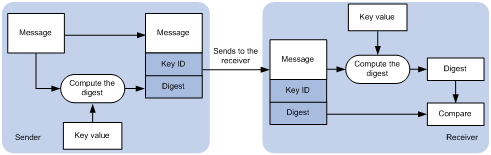

NTP authentication
Use this feature to authenticate the NTP messages for security purposes. If an NTP message passes authentication, the device can receive it and get time synchronization information. If not, the device discards the message. This function makes sure the device does not synchronize to an unauthorized time server.
Figure 3 NTP authentication
In Release 1118P02, NTP authentication works as follows:
1.     The sender uses the MD5 algorithm to calculate the NTP message according to the key identified by a key ID, and sends the calculated digest together with the NTP message and key ID to the receiver.
2.     Upon receiving the message, the receiver performs the following actions:
a.     Finds the key according to the key ID in the message.
b.     Uses the MD5 algorithm to calculate the digest.
c.     Compares the digest with the digest contained in the NTP message.
-     If they are the same, the receiver accepts the message.
-     If they are different, the receiver discards the message.
In Release 1122 and later, NTP authentication works as follows:
1.     The sender uses the algorithm to calculate the NTP message according to the key identified by a key ID, and sends the calculated digest together with the NTP message and key ID to the receiver.
b.     Uses the algorithm to calculate the digest.
-     If they are the same, the receiver determines whether the sender is allowed to use the authentication ID. If the sender is allowed to use the authentication ID, the receiver accepts the message. If the sender is not allowed to use the authentication ID, the receiver discards the message.

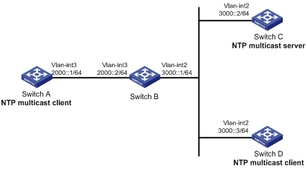

IPv6 NTP multicast mode configuration example
Network requirements
As shown in Figure 10, Switch C functions as the NTP server for multiple devices on different network segments and synchronizes the time among multiple devices.
·     Configure Switch C's local clock as a reference source, with the stratum level 2.
·     Configure Switch C to operate in IPv6 multicast server mode and send out IPv6 multicast messages from VLAN-interface 2.
·     Configure Switch A and Switch D to operate in IPv6 multicast client mode and receive IPv6 multicast messages through VLAN-interface 3 and VLAN-interface 2, respectively.
Figure 10 Network diagram
Configuration procedure
1.     Set the IP address for each interface, and make sure the switches can reach each other, as shown in Figure 10. (Details not shown.)
2.     Configure Switch C:
# Enable the NTP service.
<SwitchC> system-view
[SwitchC] ntp-service enable
# Specify the local clock as the reference source, with the stratum level 2.
[SwitchC] ntp-service refclock-master 2
# Configure Switch C to operate in IPv6 multicast server mode and send multicast messages through VLAN-interface 2.
[SwitchC] interface vlan-interface 2
[SwitchC-Vlan-interface2] ntp-service ipv6 multicast-server ff24::1
3.     Configure Switch D:
<SwitchD> system-view
[SwitchD] ntp-service enable
# Configure Switch D to operate in IPv6 multicast client mode and receive multicast messages on VLAN-interface 2.
[SwitchD] interface vlan-interface 2
[SwitchD-Vlan-interface2] ntp-service ipv6 multicast-client ff24::1
4.     Verify the configuration:
Switch D and Switch C are on the same subnet, so Switch D can do the following:
¡     Receive the IPv6 multicast messages from Switch C without being enabled with the IPv6 multicast functions.
¡     Synchronize to Switch C.
# Verify that Switch D has synchronized to Switch C, and the clock stratum level is 3 on Switch D and 2 on Switch C.
[SwitchD-Vlan-interface2] display ntp-service status
 Clock status: synchronized
 Clock stratum: 3
 System peer: 3000::2
 Local mode: bclient
 Reference clock ID: 165.84.121.65
 Leap indicator: 00
 Clock jitter: 0.000977 s
 Stability: 0.000 pps
 Clock precision: 2^-10
 Root delay: 0.00000 ms
 Root dispersion: 8.00578 ms
 Reference time: d0c60680.9754fb17  Wed, Dec 29 2010 19:12:00.591
# Verify that an IPv6 NTP association has been established between Switch D and Switch C.
[SwitchD-Vlan-interface2] display ntp-service ipv6 sessions
Notes: 1 source(master), 2 source(peer), 3 selected, 4 candidate, 5 configured.
 Source:  [1234]3000::2
 Reference: 127.127.1.0           Clock stratum: 2
 Reachabilities: 111              Poll interval: 64
 Last receive time: 23            Offset: -0.0
 Roundtrip delay: 0.0             Dispersion: 0.0
 Total sessions: 1
5.     Configure Switch B:
Because Switch A and Switch C are on different subnets, you must enable the IPv6 multicast functions on Switch B before Switch A can receive IPv6 multicast messages from Switch C.
# Enable IPv6 multicast functions.
<SwitchB> system-view
[SwitchB] ipv6 multicast routing
[SwitchB-mrib6] quit
[SwitchB-Vlan-interface2] ipv6 pim dm
[SwitchB-Vlan-interface2] quit
[SwitchB] vlan 3
[SwitchB-vlan3] port gigabitethernet 1/0/1
[SwitchB-vlan3] quit
[SwitchB] interface vlan-interface 3
[SwitchB-Vlan-interface3] mld enable
[SwitchB-Vlan-interface3] mld static-group ff24::1
[SwitchB-Vlan-interface3] quit
[SwitchB] mld-snooping
[SwitchB-mld-snooping] quit
[SwitchB] interface gigabitethernet 1/0/1
[SwitchB-GigabitEthernet1/0/1] mld-snooping static-group ff24::1 vlan 3
6.     Configure Switch A:
<SwitchA> system-view
[SwitchA] ntp-service enable
# Configure Switch A to operate in IPv6 multicast client mode and receive IPv6 multicast messages on VLAN-interface 3.
[SwitchA] interface vlan-interface 3
[SwitchA-Vlan-interface3] ntp-service ipv6 multicast-client ff24::1
7.     Verify the configuration:
# Verify that Switch A has synchronized to Switch C, and the clock stratum level is 3 on Switch A and 2 on Switch C.
[SwitchA-Vlan-interface3] display ntp-service status
 Clock stratum: 3
 Local mode: bclient
 Leap indicator: 00
 Clock jitter: 0.165741 s
 Root delay: 0.00534 ms
 Root dispersion: 4.51282 ms
 Reference time: d0c61289.10b1193f  Wed, Dec 29 2010 20:03:21.065
# Verify that an IPv6 NTP association has been established between Switch A and Switch C.
[SwitchA-Vlan-interface3] display ntp-service ipv6 sessions
 Source:   [124]3000::2
 Reachabilities: 2                Poll interval: 64
 Last receive time: 71            Offset: -0.0
 Total sessions: 1
