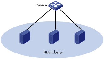

Adding or modifying a multiport unicast MAC address entry
You can configure a multiport unicast MAC address entry to associate a unicast destination MAC address with multiple ports. The frame with a destination MAC address matching the entry is sent out of multiple ports.
For example, in NLB unicast mode:
·     All servers within the cluster uses the cluster's MAC address as their own address.
·     Frames destined for the cluster are forwarded to every server in the group.
In this case, you can configure a multiport unicast MAC address entry on the device connected to the server group. Then, the device forwards the frame destined for the server group through all ports connected to the servers within the cluster.
Figure 1 NLB cluster
Do not configure an interface as the output interface of a multiport unicast MAC address entry if the interface receives frames destined for the multiport unicast MAC address. Otherwise, the frames are flooded on the VLAN to which they belong.
You can configure a multiport unicast MAC address entry globally or on an interface.

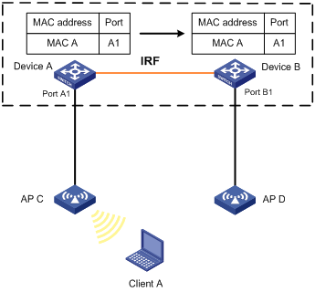

Enabling MAC address synchronization
To avoid unnecessary floods and improve forwarding speed, make sure all member devices have the same MAC address table. After you enable MAC address synchronization, each member device advertises learned MAC address entries to other member devices.
As shown in Figure 2,
·     Device A and Device B form an IRF fabric enabled with MAC address synchronization.
·     Device A and Device B connect to AP C and AP D, respectively.
When Client A associates with AP C, Device A learns a MAC address entry for Client A and advertises it to Device B.
Figure 2 MAC address tables of devices when Client A accesses AP C

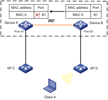

When Client A roams to AP D, Device B learns a MAC address entry for Client A. Device B advertises it to Device A to ensure service continuity for Client A, as shown in Figure 3.
Figure 3 MAC address tables of devices when Client A roams to AP D

ARP fast update for MAC address moves allows the device to update an ARP entry immediately after the outgoing interface for a MAC address changes. This feature ensures data connection without interruption.
As shown in Figure 4, a mobile user Laptop accesses the network by connecting to AP 1 or AP 2. When the AP to which the user connects changes, the switch updates the ARP entry for the user immediately after it detects a MAC address move.
Figure 4 ARP fast update application scenario

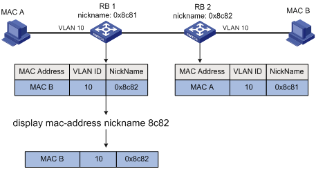

Figure 5 An example for the display mac-address nickname command

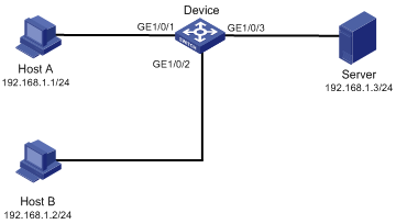

Network requirements
Host A at MAC address 000f-e235-dc71 is connected to interface GigabitEthernet 1/0/1 of Device and belongs to VLAN 1.
Host B at MAC address 000f-e235-abcd, which behaved suspiciously on the network, also belongs to VLAN 1.
Configure the MAC address as follows:
·     To prevent MAC address spoofing, add a static entry for Host A in the MAC address table of Device.
·     To drop all frames destined for Host B, add a blackhole MAC address entry for the host.
·     Set the aging timer to 500 seconds for dynamic MAC address entries.

# Enable MAC Information globally.
[Device] mac-address information enable
# Configure the MAC Information mode as syslog.
[Device] mac-address information mode syslog
# Enable MAC Information on interface GigabitEthernet 1/0/1 to enable GigabitEthernet 1/0/1 to record MAC address change information when the interface performs either of the following operations:
¡     Learns a new MAC address.
¡     Deletes an existing MAC address.
[Device-GigabitEthernet1/0/1] mac-address information enable added
[Device-GigabitEthernet1/0/1] mac-address information enable deleted
# Set the MAC Information queue length to 100.
[Device] mac-address information queue-length 100
# Set the MAC change notification interval to 20 seconds.
[Device] mac-address information interval 20
