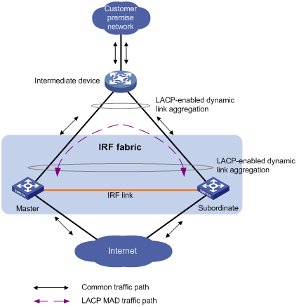

MAD mechanisms· 7
LACP MAD·· 9

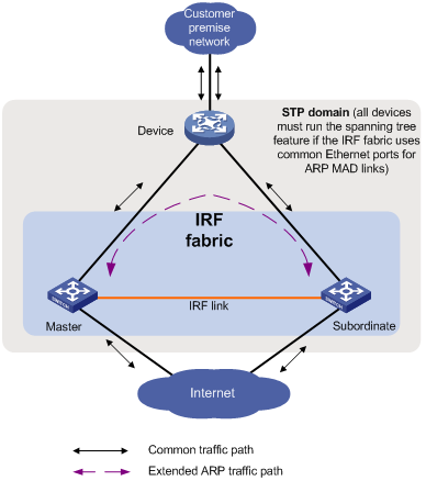

ARP MAD·· 11

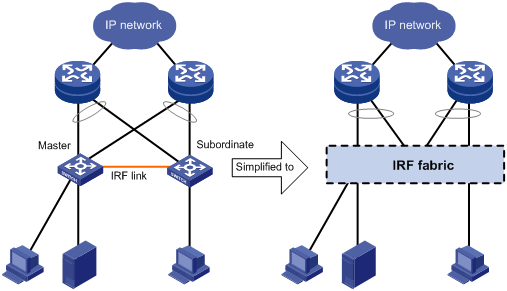

The Intelligent Resilient Framework (IRF) technology virtualizes multiple physical devices at the same layer into one virtual fabric to provide data center class availability and scalability. IRF virtualization technology offers processing power, interaction, unified management, and uninterrupted maintenance of multiple devices.
Figure 1 shows an IRF fabric that has two member devices, which appear as a single node to the upper-layer and lower-layer devices.
Figure 1 IRF application scenario
IRF provides the following benefits:
·     Simplified topology and easy management—An IRF fabric appears as one node and is accessible at a single IP address on the network. You can use this IP address to log in at any member device to manage all the members of the IRF fabric. In addition, you do not need to run the spanning tree feature among the IRF members.
·     1:N redundancy—In an IRF fabric, one member acts as the master to manage and control the entire IRF fabric. All the other members process services while backing up the master. When the master fails, all the other member devices elect a new master from among them to take over without interrupting services.
·     IRF link aggregation—You can assign several physical links between neighboring members to their IRF ports to create a load-balanced aggregate IRF connection with redundancy.
·     Multichassis link aggregation—You can use the Ethernet link aggregation feature to aggregate the physical links between the IRF fabric and its upstream or downstream devices across the IRF members.
·     Network scalability and resiliency—Processing capacity of an IRF fabric equals the total processing capacities of all the members. You can increase ports, network bandwidth, and processing capacity of an IRF fabric simply by adding member devices without changing the network topology.

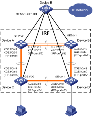

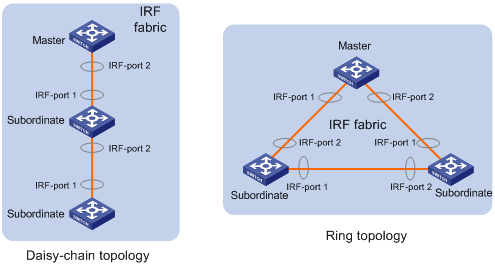

An IRF fabric can use a daisy-chain or ring topology. IRF does not support the full mesh topology. For information about connecting IRF member devices, see "Connecting IRF physical interfaces."

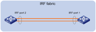

An IRF port is a logical interface that connects IRF member devices. Every IRF-capable device supports two IRF ports. The IRF ports are named IRF-port n/1 and IRF-port n/2, where n is the member ID of the device. The two IRF ports are referred to as IRF-port 1 and IRF-port 2 in this book.
To use an IRF port, you must bind a minimum of one physical interface to it. The physical interfaces assigned to an IRF port automatically form an aggregate IRF link. An IRF port goes down only if all its IRF physical interfaces are down.

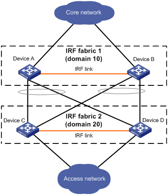

IRF domain ID
One IRF fabric forms one IRF domain. IRF uses IRF domain IDs to uniquely identify IRF fabrics and prevent IRF fabrics from interfering with one another.
As shown in Figure 2, IRF fabric 1 contains Device A and Device B, and IRF fabric 2 contains Device C and Device D. Both fabrics use the LACP aggregate links between them for MAD. When a member device receives an extended LACPDU for MAD, it checks the domain ID to determine whether the packet is from the local IRF fabric. Then, the member device can handle the packet correctly.

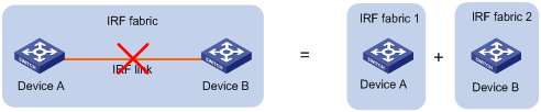

IRF split
IRF split occurs when an IRF fabric breaks up into multiple IRF fabrics because of IRF link failures, as shown in Figure 3. The split IRF fabrics operate with the same IP address. IRF split causes routing and forwarding problems on the network. To quickly detect a multi-active collision, configure a minimum of one MAD mechanism (see "Configuring MAD").

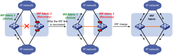

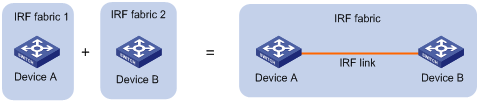

IRF merge
IRF merge occurs when two split IRF fabrics reunite or when two independent IRF fabrics are united, as shown in Figure 4.

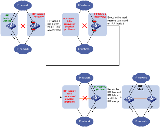

Collision handling
When detecting a multi-active collision, MAD disables all IRF fabric except one from forwarding data traffic by placing them in Recovery state. The IRF fabrics placed in Recovery state are called inactive IRF fabrics. The IRF fabric that continues to forward traffic is called the active IRF fabric.
LACP MAD uses the following process to handle a multi-active collision:
1.     Compares the number of members in each fabric.
2.     Sets all fabrics to the Recovery state except the one that has the most members.
3.     Compares the member IDs of the masters if all IRF fabrics have the same number of members.
4.     Sets all fabrics to the Recovery state except the one that has the lowest numbered master.
5.     Shuts down all physical network ports in the Recovery-state fabrics except for the following ports:

Failure recovery
To merge two split IRF fabrics, first repair the failed IRF link and remove the IRF link failure.
·     If the IRF fabric in Recovery state fails before the failure is recovered, repair the failed IRF fabric and the failed IRF link.
·     If the active IRF fabric fails before the failure is recovered, enable the inactive IRF fabric to take over the active IRF fabric. Then, recover the MAD failure.

LACP MAD
As shown in Figure 5, LACP MAD has the following requirements:
·     Every IRF member must have a link with an intermediate device.
·     All the links form a dynamic link aggregation group.
·     The intermediate device must be a device that supports extended LACP for MAD.
The IRF member devices send extended LACPDUs that convey a domain ID and an active ID. The intermediate device transparently forwards the extended LACPDUs received from one member device to all the other member devices.
·     If the domain IDs and active IDs sent by all the member devices are the same, the IRF fabric is integrated.
·     If the extended LACPDUs convey the same domain ID but different active IDs, a split has occurred. LACP MAD handles this situation as described in "Collision handling."
Figure 5 LACP MAD scenario

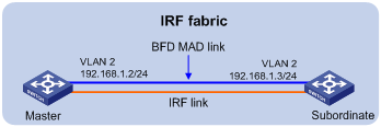

BFD MAD
You can use common or management Ethernet ports for BFD MAD links.
·     If management Ethernet ports are used, BFD MAD must work with an intermediate device. Make sure the following requirements are met:
?     Each IRF member device has a BFD MAD link to an intermediate device.
?     Each member device is assigned a MAD IP address on the master's management Ethernet port.
·     If common Ethernet ports are used, BFD MAD has the following requirements:
?     If an intermediate device is used, each member device must have a BFD MAD link to the intermediate device. If no intermediate device is used, all member devices must have a BFD MAD link to each other. As a best practice, use an intermediate device to connect IRF member devices if the IRF fabric has more than two member devices. A full mesh of IRF members might cause broadcast loops.
?     Each member device is assigned a MAD IP address on a VLAN interface.
The BFD MAD links must be dedicated. Do not use BFD MAD links for any other purposes.
·     The MAD addresses identify the member devices and must belong to the same subnet.
·     Of all management Ethernet ports on an IRF fabric, only the master's management Ethernet port is accessible.

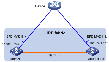

Figure 6 shows a typical BFD MAD scenario that uses an intermediate device. Figure 7 shows a typical BFD MAD scenario that does not use an intermediate device.
BFD MAD, the master attempts to establish BFD sessions with other member devices by using its MAD IP address as the source IP address.
·     If the IRF fabric is integrated, only the MAD IP address of the master takes effect. The master cannot establish a BFD session with any other member. If you execute the display bfd session command, the state of the BFD sessions is Down.
·     When the IRF fabric splits, the IP addresses of the masters in the split IRF fabrics take effect. The masters can establish a BFD session. If you execute the display bfd session command, the state of the BFD session between the two devices is Up.
Figure 6 BFD MAD scenario with an intermediate device
Figure 7 BFD MAD scenario without an intermediate device
ARP MAD
ARP MAD detects multi-active collisions by using extended ARP packets that convey the IRF domain ID and the active ID.
You can use common or management Ethernet ports for ARP MAD.
·     If management Ethernet ports are used, ARP MAD must work with an intermediate device. Make sure the following requirements are met:
?     Connect a management Ethernet port on each member device to the intermediate device.
?     On the intermediate device, you must assign the ports used for ARP MAD to the same VLAN.
·     If common Ethernet ports are used, ARP MAD can work with or without an intermediate device. Make sure the following requirements are met:
?     If an intermediate device is used, connect each IRF member device to the intermediate device. Run the spanning tree feature between the IRF fabric and the intermediate device. In this situation, data links can be used.
?     If no intermediate device is used, connect each IRF member device to all other member devices. In this situation, IRF links cannot be used for ARP MAD.
Figure 8 shows a typical ARP MAD scenario that uses an intermediate device.
Each IRF member compares the domain ID and the active ID in incoming extended ARP packets with its domain ID and active ID.
·     If the domain IDs are different, the extended ARP packet is from a different IRF fabric. The device does not continue to process the packet with the MAD mechanism.
·     If the domain IDs are the same, the device compares the active IDs.
?     If the active IDs are different, the IRF fabric has split.
?     If the active IDs are the same, the IRF fabric is integrated.
Figure 8 ARP MAD scenario

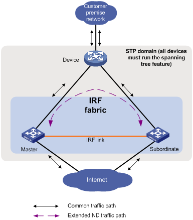

ND MAD
ND MAD detects multi-active collisions by using NS packets to transmit the IRF domain ID and the active ID.
You can set up ND MAD links between neighbor IRF member devices or between each IRF member device and an intermediate device (see Figure 9). If an intermediate device is used, you must also run the spanning tree protocol between the IRF fabric and the intermediate device.
Each IRF member device compares the domain ID and the active ID in incoming NS packets with its domain ID and active ID.
·     If the domain IDs are different, the NS packet is from a different IRF fabric. The device does not continue to process the packet with the MAD mechanism.
Figure 9 ND MAD scenario

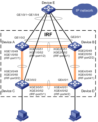

When you connect two neighboring IRF members, connect the physical interfaces of IRF-port 1 on one member to the physical interfaces of IRF-port 2 on the other (see Figure 10).
For example, you have four chassis: A, B, C, and D. IRF-port 1 and IRF-port 2 are represented by A1 and A2 on chassis A, represented by B1 and B2 on chassis B, and so on. To connect the four chassis into a ring topology of A-B-C-D(A), the IRF link cabling scheme must be one of the following:
·     A1-B2, B1-C2, C1-D2, and D1-A2.
·     A2-B1, B2-C1, C2-D1, and D2-A1.
IMPORTANT
IMPORTANT:
No intermediate devices are allowed between neighboring members.
Figure 10 Connecting IRF physical interfaces
Connect the devices into a daisy-chain topology or a ring topology. A ring topology is more reliable (see Figure 11). In ring topology, the failure of one IRF link does not cause the IRF fabric to split as in daisy-chain topology. Rather, the IRF fabric changes to a daisy-chain topology without interrupting network services.
Figure 11 Daisy-chain topology vs. ring topology

·     If ARP MAD or ND MAD is used with the spanning tree feature, configure IRF bridge MAC persistence by using the undo irf mac-address persistent command.

·     If LACP MAD, ARP MAD, or ND MAD runs between two IRF fabrics, assign each fabric a unique IRF domain ID. (For BFD MAD, this task is optional.)
·     An IRF fabric has only one IRF domain ID. You can change the IRF domain ID by using the following commands: irf domain, mad enable, mad arp enable, or mad nd enable. The IRF domain IDs configured by using these commands overwrite each other.
·     To prevent a port from being shut down when the IRF fabric transits to the Recovery state, use the mad exclude interface command. To bring up ports in a Recovery-state IRF fabric, use the mad restore command instead of the undo shutdown command. The mad restore command activates the Recovery-state IRF fabric.
Configuring LACP MAD
When you use LACP MAD, follow these guidelines:
·     If the intermediate device is also an IRF fabric, assign the two IRF fabrics different domain IDs for correct split detection.
·     Use dynamic link aggregation mode. MAD is LACP dependent. Even though LACP MAD can be configured on both static and dynamic aggregate interfaces, it takes effect only on dynamic aggregate interfaces.
·     Configure link aggregation settings on the intermediate device.

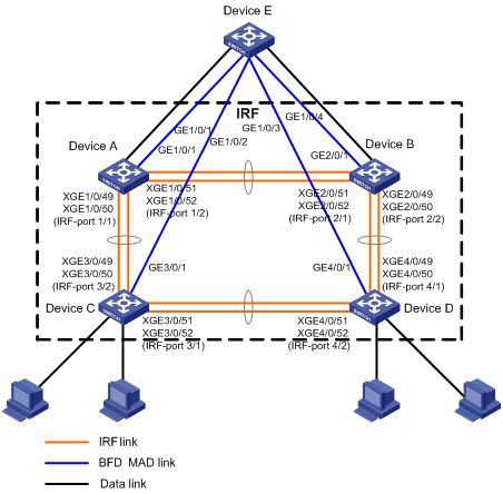

Configuring BFD MAD
Before you configure BFD MAD, choose a BFD MAD link scheme as described in "BFD MAD."
As a best practice, connect the BFD MAD links after you finish the BFD MAD configuration.
Configuring BFD MAD that uses common Ethernet ports
Configure BFD MAD on a VLAN interface if you use common Ethernet ports for BFD MAD.
When you configure BFD MAD settings, follow these restrictions and guidelines:
Category
BFD MAD VLAN
·     Do not enable BFD MAD on VLAN-interface 1.
·     If you are using an intermediate device, perform the following tasks on both the IRF fabric and the intermediate device:
?     Create a VLAN and VLAN interface for BFD MAD.
?     Assign the ports of BFD MAD links to the BFD MAD VLAN.
·     Make sure the IRF fabrics on the network use different BFD MAD VLANs.
·     Make sure the BFD MAD VLAN contains only ports on the BFD MAD links. Exclude a port from the BFD MAD VLAN if the port is not on the BFD MAD link. For example, if you have assigned the port to all VLANs by using the port trunk permit vlan all command, use the undo port trunk permit command to exclude the port from the BFD MAD VLAN.
BFD MAD VLAN and feature compatibility
Do not use the BFD MAD VLAN for any purpose other than configuring BFD MAD.
·     Use only the mad bfd enable and mad ip address commands on the VLAN interface used for BFD MAD. If you configure other features, both BFD MAD and other features on the interface might run incorrectly.
·     Disable the spanning tree feature on all Layer 2 Ethernet ports in the BFD MAD VLAN. The MAD feature is mutually exclusive with the spanning tree feature.
MAD IP address
·     Use the mad ip address command instead of the ip address command to configure MAD IP addresses on the BFD MAD-enabled VLAN interface.
·     Make sure all the MAD IP addresses are on the same subnet.

Configuring BFD MAD that uses management Ethernet ports
When you configure BFD MAD that uses management Ethernet ports, follow these restrictions and guidelines:
Category
Management Ethernet ports for BFD MAD
Connect a management Ethernet port on each member device to the common Ethernet ports on the intermediate device.
BFD MAD VLAN
·     On the intermediate device, create a VLAN for BFD MAD, and assign the ports used for BFD MAD to the VLAN. On the IRF fabric, you do not need to assign the management Ethernet ports to the VLAN.
·     Make sure the BFD MAD VLAN on the intermediate device contains only ports on the BFD MAD links.
MAD IP address
·     Use the mad ip address command instead of the ip address command to configure MAD IP addresses on the BFD MAD-enabled management Ethernet ports.
To configure BFD MAD that uses management Ethernet ports:
Step
Remarks
N/A
2.     (Optional.) Assign a domain ID to the IRF fabric.
irf domain domain-id
By default, the domain ID of an IRF fabric is 0.
3.     Enter management Ethernet interface view.
interface M-GigabitEthernet interface-number
4.     Enable BFD MAD.
mad bfd enable
By default, BFD MAD is disabled.
5.     Assign a MAD IP address to each member device.
mad ip address ip-address { mask | mask-length } member member-id
By default, no MAD IP addresses are configured.
Configuring ARP MAD
Before you configure ARP MAD, choose an ARP MAD link scheme as described in "ARP MAD."
As a best practice, connect the ARP MAD links after you finish the ARP MAD configuration if you are not using existing data links as ARP MAD links.
Configuring ARP MAD that uses common Ethernet ports
Configure ARP MAD on a VLAN interface if you use common Ethernet ports for ARP MAD.
When you configure ARP MAD that uses common Ethernet ports, follow these restrictions and guidelines:
Category
ARP MAD VLAN
·     Do not enable ARP MAD on VLAN-interface 1.
?     Create a VLAN and VLAN interface for ARP MAD.
?     Assign the ports of ARP MAD links to the ARP MAD VLAN.
·     Do not use the ARP MAD VLAN for any other purposes.
ARP MAD and feature configuration
If an intermediate device is used, make sure the following requirements are met:
·     Run the spanning tree feature between the IRF fabric and the intermediate device to ensure that there is only one ARP MAD link in forwarding state. For more information about the spanning tree feature and its configuration, see Layer 2—LAN Switching Configuration Guide.
·     Enable the IRF fabric to change its bridge MAC address as soon as the address owner leaves.
To configure ARP MAD that uses common Ethernet ports:
Step
Remarks
N/A
2.     Assign a domain ID to the IRF fabric.
The default IRF domain ID is 0.
3.     Configure the IRF bridge MAC address to change as soon as the address owner leaves.

Configuring ND MAD
When you use ND MAD, follow these guidelines:
·     Do not configure ND MAD on VLAN-interface 1.
·     Do not use the VLAN configured for ND MAD for any other purposes.
·     If an intermediate device is used, you can use common data links as ND MAD links. If no intermediate device is used, set up dedicated ND MAD links between IRF member devices.
·     If an intermediate device is used, make sure the following requirements are met:
?     Run the spanning tree feature between the IRF fabric and the intermediate device. Make sure there is only one ND MAD link in forwarding state. For more information about the spanning tree feature and its configuration, see Layer 2—LAN Switching Configuration Guide.
?     Enable the IRF fabric to change its bridge MAC address as soon as the address owner leaves.
?     Create an ND MAD VLAN and assign the ports on the ND MAD links to the VLAN.
?     If the intermediate device is also an IRF fabric, assign the two IRF fabrics different domain IDs for correct split detection.
To configure ND MAD:
Step
Remarks
N/A
By default, the IRF bridge MAC address remains unchanged for 6 minutes after the address owner leaves.
4.     Create a VLAN dedicated to ND MAD.
vlan vlan-id
By default, only VLAN 1 exists.
5.     Return to system view.
N/A
6.     Enter Ethernet interface view.
N/A
7.     Assign the port to the ND MAD VLAN.
·     Assign the port to the VLAN as an access port:
port access vlan vlan-id
·     Assign the port to the VLAN as a trunk port:
vlan-id
·     Assign the port to the VLAN as a hybrid port:
port hybrid vlan
vlan-id { tagged | untagged }
The link type of ND MAD ports can be access, trunk, or hybrid.
The default link type of a port is access.
8.     Return to system view.
N/A
9.     Enter VLAN interface view.
interface vlan-interface vlan-interface-id
N/A
10.     Assign the interface an IP address.
ipv6 address { ipv6-address/pre-length | ipv6 address pre-length }
By default, no IPv6 addresses are assigned to a VLAN interface.
11.     Enable ND MAD.
mad nd enable
By default, ND MAD is disabled.

Recovering an IRF fabric
When the failed IRF link between two split IRF fabrics is recovered, all member devices in the inactive IRF fabric automatically join the active IRF fabric as subordinate members. The network ports that have been shut down by MAD automatically restore their original physical state, as shown in Figure 12.
Figure 12 Recovering the IRF fabric
If the active IRF fabric fails before the IRF link is recovered (see Figure 13), use the mad restore command on the inactive IRF fabric to recover the inactive IRF fabric. The command brings up all network ports that were shut down by MAD. After you repair the IRF link, the two parts merge into a unified IRF fabric.
Figure 13 Active IRF fabric fails before the IRF link is recovered
To manually recover an inactive IRF fabric:
Step
2.     Recover the inactive IRF fabric.
mad restore
After the IRF fabric is recovered, all ports that have been shut down by MAD come up automatically.

LACP MAD-enabled IRF configuration example
Network requirements
As shown in Figure 14, set up a four-chassis IRF fabric at the access layer of the enterprise network.
Configure LACP MAD on the multichassis aggregation to Device E, an H3C device that supports extended LACP.
Figure 14 Network diagram
Configuration procedure
1.     Configure Device A:
# Shut down the physical interfaces used for IRF links. This example uses the SFP+ port group that contains Ten-GigabitEthernet 1/0/49 to Ten-GigabitEthernet 1/0/52 for IRF links.
<Sysname> system-view
[Sysname] interface range ten-gigabitethernet 1/0/49 to ten-gigabitethernet 1/0/52
[Sysname-if-range] shutdown
[Sysname-if-range] quit
# Bind Ten-GigabitEthernet 1/0/49 and Ten-GigabitEthernet 1/0/50 to IRF-port 1/1.
[Sysname] irf-port 1/1
[Sysname-irf-port1/1] port group interface ten-gigabitethernet 1/0/49
[Sysname-irf-port1/1] port group interface ten-gigabitethernet 1/0/50
[Sysname-irf-port1/1] quit
# Bind Ten-GigabitEthernet 1/0/51 and Ten-GigabitEthernet 1/0/52 to IRF-port 1/2.

# Connect Device B to Device A as shown in Figure 14, and log in to Device B. This example uses the SFP+ group that contains Ten-GigabitEthernet 2/0/49 to Ten-GigabitEthernet 2/0/52 for IRF links.
# Shut down the physical interfaces.
[Sysname] interface range ten-gigabitethernet 2/0/49 to ten-gigabitethernet 2/0/52

# Connect Device C to Device A as shown in Figure 14, and log in to Device C. This example uses the SFP+ port group that contains Ten-GigabitEthernet 3/0/49 to Ten-GigabitEthernet 3/0/52 for IRF links.
[Sysname] interface range ten-gigabitethernet 3/0/49 to ten-gigabitethernet 3/0/52

# Connect Device D to Device B and Device C as shown in Figure 14, and log in to Device D. This example uses the SFP+ port group that contains Ten-GigabitEthernet 4/0/49 to Ten-GigabitEthernet 4/0/52 for IRF links.
[Sysname] interface range ten-gigabitethernet 4/0/49 to ten-gigabitethernet 4/0/52

5.     Configure LACP MAD on the IRF fabric:
# Set the domain ID of the IRF fabric to 1.
[Sysname] irf domain 1
# Create a dynamic aggregate interface and enable LACP MAD.
[Sysname] interface bridge-aggregation 2
[Sysname-Bridge-Aggregation2] link-aggregation mode dynamic
[Sysname-Bridge-Aggregation2] mad enable
You need to assign a domain ID (range: 0-4294967295)
[Current domain is: 1]:
 The assigned  domain ID is: 1
 Info: MAD LACP only enable on dynamic aggregation interface.
[Sysname-Bridge-Aggregation2] quit
# Assign GigabitEthernet 1/0/2, GigabitEthernet 2/0/1, GigabitEthernet 3/0/2, and GigabitEthernet 4/0/1 to the aggregate interface.
[Sysname] interface range gigabitethernet 1/0/2 gigabitethernet 2/0/1 gigabitethernet 3/0/2 gigabitethernet 4/0/1
[Sysname-if-range] port link-aggregation group 2
6.     Configure Device E as the intermediate device:
CAUTION
CAUTION:
If the intermediate device is also an IRF fabric, assign the two IRF fabrics different domain IDs for correct split detection. False detection causes IRF split.
# Create a dynamic aggregate interface.
# Assign GigabitEthernet 1/0/1, GigabitEthernet 1/0/2, GigabitEthernet 1/0/3, and GigabitEthernet 1/0/4 to the aggregate interface.
[Sysname] interface range gigabitethernet 1/0/1 to gigabitethernet 1/0/4
BFD MAD-enabled IRF configuration example
As shown in Figure 15, set up a four-chassis IRF fabric at the core layer of the enterprise network.
·     Configure BFD MAD in the IRF fabric and set up BFD MAD links between each member device and the intermediate device.
·     Disable the spanning tree feature on the ports used for BFD MAD, because the two features conflict with each other.
Figure 15 Network diagram
[Sysname] irf-port 1/2
[Sysname-irf-port1/2] port group interface ten-gigabitethernet 1/0/51
[Sysname-irf-port1/2] port group interface ten-gigabitethernet 1/0/52
[Sysname-irf-port1/2] quit
# Bring up the SFP+ ports and save the configuration.
[Sysname-if-range] undo shutdown
[Sysname] save
# Activate the IRF port configuration.
[Sysname] irf-port-configuration active
2.     Configure Device B:
# Change the member ID of Device B to 2 and reboot the device to have the change take effect.
[Sysname] irf member 1 renumber 2
Renumbering the member ID may result in configuration change or loss. Continue? [Y/N]:y
[Sysname] quit
<Sysname> reboot
# Connect Device B to Device A as shown in Figure 15, and log in to Device B. This example uses the SFP+ group that contains Ten-GigabitEthernet 2/0/49 to Ten-GigabitEthernet 2/0/52 for IRF links.
# Bind Ten-GigabitEthernet 2/0/51 and Ten-GigabitEthernet 2/0/52 to IRF-port 2/1.
[Sysname] irf-port 2/1
[Sysname-irf-port2/1] port group interface ten-gigabitethernet 2/0/51
[Sysname-irf-port2/1] port group interface ten-gigabitethernet 2/0/52
[Sysname-irf-port2/1] quit
# Bind Ten-GigabitEthernet 2/0/49 and Ten-GigabitEthernet 2/0/50 to IRF-port 2/2.
[Sysname] irf-port 2/2
[Sysname-irf-port2/2] port group interface ten-gigabitethernet 2/0/49
[Sysname-irf-port2/2] port group interface ten-gigabitethernet 2/0/50
[Sysname-irf-port2/2] quit
[Sysname] save
The two devices perform master election, and the one that has lost the election reboots to form an IRF fabric with the master.
3.     Configure Device C:
# Change the member ID of Device C to 3 and reboot the device to have the change take effect.
[Sysname] irf member 1 renumber 3
[Sysname] quit
<Sysname> reboot
# Connect Device C to Device A as shown in Figure 15, and log in to Device C. This example uses the SFP+ port group that contains Ten-GigabitEthernet 3/0/49 to Ten-GigabitEthernet 3/0/52 for IRF links.
# Bind Ten-GigabitEthernet 3/0/51 and Ten-GigabitEthernet 3/0/52 to IRF-port 3/1.
[Sysname] irf-port 3/1
[Sysname-irf-port3/1] port group interface ten-gigabitethernet 3/0/51
[Sysname-irf-port3/1] port group interface ten-gigabitethernet 3/0/52
[Sysname-irf-port3/1] quit
# Bind Ten-GigabitEthernet 3/0/49 and Ten-GigabitEthernet 3/0/50 to IRF-port 3/2.
[Sysname] irf-port 3/2
[Sysname-irf-port3/2] port group interface ten-gigabitethernet 3/0/49
[Sysname-irf-port3/2] port group interface ten-gigabitethernet 3/0/50
[Sysname-irf-port3/2] quit
[Sysname] save
Device C reboots to join the IRF fabric.
4.     Configure Device D:
# Change the member ID of Device D to 4 and reboot the device to have the change take effect.
[Sysname] irf member 1 renumber 4
[Sysname] quit
<Sysname> reboot
# Connect Device D to Device B and Device C as shown in Figure 15, and log in to Device D. This example uses the SFP+ port group that contains Ten-GigabitEthernet 4/0/49 to Ten-GigabitEthernet 4/0/52 for IRF links.
# Bind Ten-GigabitEthernet 4/0/49 and Ten-GigabitEthernet 4/0/50 to IRF-port 4/1.
[Sysname] irf-port 4/1
[Sysname-irf-port4/1] port group interface ten-gigabitethernet 4/0/49
[Sysname-irf-port4/1] port group interface ten-gigabitethernet 4/0/50
[Sysname-irf-port4/1] quit
# Bind Ten-GigabitEthernet 4/0/51 and Ten-GigabitEthernet 4/0/52 to IRF-port 4/2.
[Sysname] irf-port 4/2
[Sysname-irf-port4/2] port group interface ten-gigabitethernet 4/0/51
[Sysname-irf-port4/2] port group interface ten-gigabitethernet 4/0/52
[Sysname-irf-port4/2] quit
[Sysname] save
Device D reboots to join the IRF fabric. A four-chassis IRF fabric is formed.
5.     Configure BFD MAD on the IRF fabric:
# Create VLAN 3, and add GigabitEthernet 1/0/1, GigabitEthernet 2/0/1, GigabitEthernet 3/0/1, and GigabitEthernet 4/0/1 to VLAN 3.
[Sysname] vlan 3
[Sysname-vlan3] port gigabitethernet 1/0/1 gigabitethernet 2/0/1 gigabitethernet 3/0/1 gigabitethernet 4/0/1
[Sysname-vlan3] quit
# Create VLAN-interface 3, and configure a MAD IP address for each member device on the VLAN interface.
[Sysname] interface vlan-interface 3
[Sysname-Vlan-interface3] mad bfd enable
[Sysname-Vlan-interface3] mad ip address 192.168.2.1 24 member 1

ARP MAD-enabled IRF configuration example
As shown in Figure 16, set up a four-chassis IRF fabric in the enterprise network.
·     Configure ARP MAD in the IRF fabric and use the links connected to Device E for transmitting ARP MAD packets.
·     To prevent loops, run the spanning tree feature between Device E and the IRF fabric.
Figure 16 Network diagram
[Sysname] save
[Sysname] quit
<Sysname> reboot
# Connect Device D to Device B and Device C as shown in Figure 17, and log in to Device D. This example uses the SFP+ port group that contains Ten-GigabitEthernet 4/0/49 to Ten-GigabitEthernet 4/0/52 for IRF links.
[Sysname] save
5.     Configure ND MAD on the IRF fabric:
# Enable the spanning tree feature globally. Map the ND MAD VLAN to MSTI 1 in the MST region.
[Sysname] stp global enable
[Sysname] stp region-configuration
[Sysname-mst-region] region-name ndmad
[Sysname-mst-region] instance 1 vlan 3
[Sysname-mst-region] active region-configuration
[Sysname-mst-region] quit
# Configure the IRF fabric to change its bridge MAC address as soon as the address owner leaves.
[Sysname] undo irf mac-address persistent
# Create VLAN 3, and add GigabitEthernet 1/0/2, GigabitEthernet 2/0/1, GigabitEthernet 3/0/2, and GigabitEthernet 4/0/1 to VLAN 3.
[Sysname] vlan 3
[Sysname-vlan3] port gigabitethernet 1/0/2 gigabitethernet 2/0/1 gigabitethernet 3/0/2 gigabitethernet 4/0/1
# Create VLAN-interface 3, assign it an IPv6 address, and enable ND MAD on the interface.
[Sysname-Vlan-interface3] ipv6 address 2001::1 64
[Sysname-Vlan-interface3] mad nd enable
CAUTION
CAUTION:
If the intermediate device is also in an IRF fabric, assign the two IRF fabrics different domain IDs for correct split detection. False detection causes IRF split.
<DeviceE> system-view
[DeviceE] stp global enable
[DeviceC] stp region-configuration
[DeviceC-mst-region] region-name ndmad
[DeviceC-mst-region] instance 1 vlan 3
[DeviceC-mst-region] active region-configuration
[DeviceC-mst-region] quit
# Create VLAN 3, and add ports GigabitEthernet 1/0/1, GigabitEthernet 1/0/2, GigabitEthernet 1/0/3, and GigabitEthernet 1/0/4 to VLAN 3 for forwarding ND MAD packets.
[DeviceE] vlan 3
[DeviceE-vlan3] port gigabitethernet 1/0/1 to gigabitethernet 1/0/4
[DeviceE-vlan3] quit
