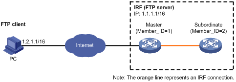

FTP server configuration example
Network requirements
·          Configure the device as an FTP server.
·          Create a local user account with username abc and password 123456 on the FTP server.
·          Use the user account to log in to the FTP server from the FTP client.
·          Upload the file temp.bin from the FTP client to the FTP server.
·          Download the configuration file config.cfg from the FTP server to the FTP client for backup.
Figure 2 Network diagram
Configuration procedure
1.        Configure IP addresses as shown in Figure 2. Make sure the IRF fabric and the PC can reach each other. (Details not shown.)
2.        Configure the FTP server:
# Examine the storage space on the member devices. If the free space is insufficient, use the delete/unreserved file-url command to delete unused files. (Details not shown.)
# Create a local user account abc, set the password to 123456, the user role to network-admin, the working directory to the root directory of the Flash, and the service type to FTP. (To set the working directory to the Flash root directory of the subordinate member, replace flash:/ in the authorization-attribute command with slot2#flash:/.)
# Create a local user with the username abc and password 123456.
<Sysname> system-view
[Sysname] local-user abc class manage
[Sysname-luser-manage-abc] password simple 123456
# Assign the user role network-admin to the user. Set the working directory to the root directory of the flash memory.
[Sysname-luser-manage-abc] authorization-attribute user-role network-admin work-directory flash:/
# Assign the service type FTP to the user.
[Sysname-luser-manage-abc] service-type ftp
[Sysname-luser-manage-abc] quit
# Enable the FTP server.
[Sysname] ftp server enable
[Sysname] quit
3.        Perform FTP operations from the FTP client:
# Log in to the FTP server at 1.1.1.1 using the username abc and password 123456.
c:\> ftp 1.1.1.1
Connected to 1.1.1.1.
220 FTP service ready.
User(1.1.1.1:(none)):abc
331 Password required for abc.
Password:
230 User logged in.
# Use the ASCII mode to download the configuration file config.cfg from the FTP server to the PC for backup.
ftp> ascii
200 TYPE is now ASCII
ftp> get config.cfg back-config.cfg
# Use the binary mode to upload the file temp.bin from the PC to the Flash root directory of the master.
ftp> binary
200 TYPE is now 8-bit binary
ftp> put temp.bin
# Exit FTP.
ftp> bye

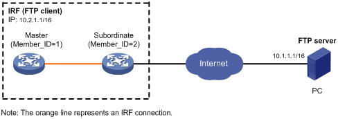

FTP client configuration example
As shown in Figure 3, the PC is acting as an FTP server. A user account with the username abc and password 123456 has been created on the PC.
·          Use the IRF fabric as an FTP client to log in to the FTP server.
·          Download the file temp.bin from the FTP server to the FTP client.
·          Upload the configuration file config.cfg from the FTP client to the FTP server for backup.
Figure 3 Network diagram
# Configure IP addresses as shown in Figure 3. Make sure the IRF fabric and PC can reach each other. (Details not shown.)
# Log in to the FTP server at 10.1.1.1 using the username abc and password 123456.
<Sysname> ftp 10.1.1.1
Press CTRL+C to abort.
Connected to 10.1.1.1 (10.1.1.1).
220 WFTPD 2.0 service (by Texas Imperial Software) ready for new user
User (10.1.1.1:(none)): abc
331 Give me your password, please
Password:
230 Logged in successfully
Remote system type is MSDOS.
ftp>
# Set the file transfer mode to binary.
ftp> binary
# Download the file temp.bin from the PC to the Flash root directory of the master device.
ftp> get temp.bin
227 Entering Passive Mode (192,168,0,20,207,117)
150 "C:\Users\wKF5122\Desktop\FTP\temp.bin" file ready to send (13507003 byt
es) in IMAGE / Binary mode
226 Transfer finished successfully.
13507003 bytes received in 17.188 seconds (767.42 Kbytes/s)
# Download the file temp.bin from the PC to the Flash root directory of the subordinate member (with member ID of 2).
ftp> get temp.bin slot2#flash:/temp.bin
# Use the ASCII mode to upload the configuration file config.cfg from the IRF fabric to the PC for backup.
ftp> ascii
227 Entering Passive Mode (192,168,0,20,207,237)
150 "C:\Users\wKF5122\Desktop\FTP\config.cfg" file ready to receive in ASCII
 mode
5205 bytes sent in 0.000 seconds (11.28 Mbytes/s)
ftp> bye
221-Goodbye. You uploaded 2 and downloaded 2 kbytes.
221 Logout.
<Sysname>
