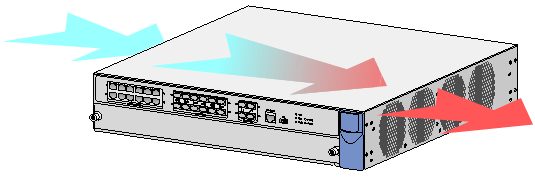

Cooling system
The device provides left-side intake and right-side exhaust airflow. For adequate cooling, make sure the following requirements are met:
·           A minimum clearance of 100 mm (3.94 in) is reserved around the inlet and outlet air vents.
·           The installation site has a good cooling system.

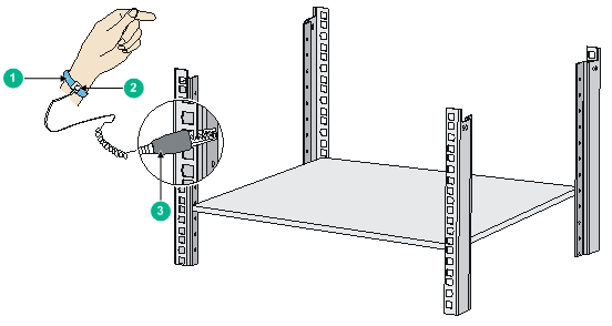

Attaching an ESD wrist strap
CAUTION
CAUTION:
Before you attach an ESD wrist strap, make sure the rack or workbench is reliably grounded.
No ESD wrist strap is provided with the device. Purchase one yourself.
To attach the ESD wrist strap:
1.      Wear the wrist strap on your wrist.
2.      Lock the wrist strap tight around your wrist to keep good contact with the skin.
3.      Secure the wrist strap lock and the alligator clip lock together.
4.      Attach the alligator clip to the rack.
Figure 2 Attaching an ESD wrist strap
(1) ESD wrist strap
(2) Lock
(3) Alligator clip

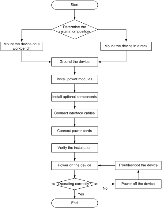

The installation procedure is similar for the H3C SecPath F5010, F5020, and F5040 firewalls. This section installs an F5020 firewall.
Figure 5 Installation flow

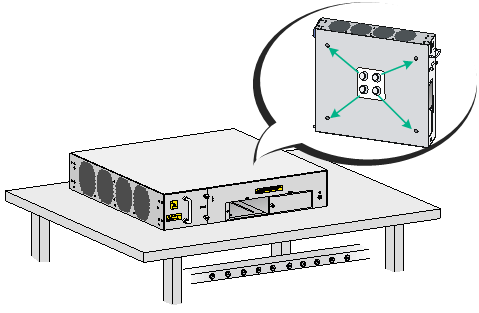

1.      Unpack the device and its accessories.
2.      Place the device with bottom up. Clean the recessed areas on the chassis bottom with a dry cloth.
3.      Attach the four rubber feet to the recessed areas on the chassis bottom.
4.      Place the device with upside up on the workbench.
Figure 6 Mounting the device on a workbench

1.      Wear an ESD wrist strap and make sure the wrist strap makes good skin contact and is reliably grounded.

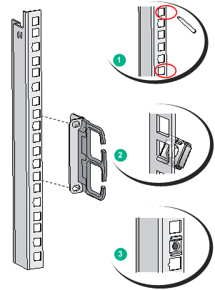

3.      Use a mounting bracket to mark cage nut installation positions on the front rack posts and install cage nuts.
Figure 7 Installing cage nuts

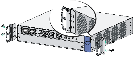

4.      Use the supplied M4 screws to attach the mounting brackets to the device.
Figure 8 Attaching the mounting brackets to the device

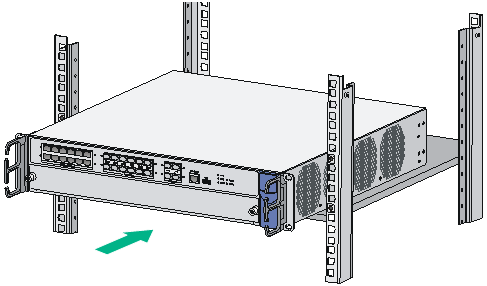

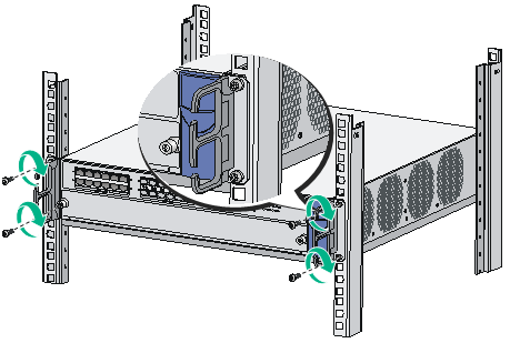

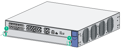

5.      Mount the device in the rack.
Figure 9 Mounting the device in the rack
6.      Use M6 screws to secure the mounting brackets to the front rack posts.
Figure 10 Securing the device to the rack

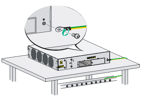

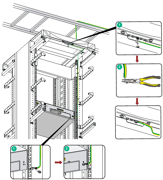

Grounding the device by using a grounding strip
1.      Connect the grounding cable to the device.
a.    Remove the grounding screw from the grounding hole in the rear panel of the chassis.
b.    Use the grounding screw to attach the ring terminal of the grounding cable to the grounding hole and fasten the screw.
2.      Connect the other end of the grounding cable to the grounding strip.
a.    Remove the nut from a grounding post on the grounding strip.
b.    Use needle-nose pliers to make a hook at the other end of the grounding cable. Attach the hook to the grounding post and then fasten the nut.
Figure 11 Grounding the device by using a grounding strip

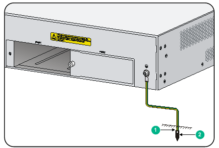

Grounding the device by using a grounding conductor buried in the earth
If earth is available at the installation site, hammer a 0.5 m (1.64 ft) or longer angle iron or steel tube into the earth to serve as a grounding conductor. Weld the yellow-green grounding cable to the angel iron or steel tube and treat the joint for corrosion protection.
Figure 13 Grounding the device by burying a grounding conductor into the earth
(1) Joint
(2) Grounding conductor

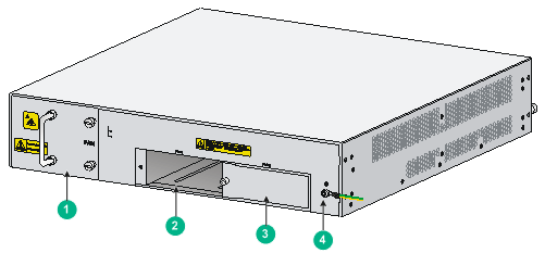

Installing a power module
CAUTION
CAUTION:
·       Before installing a power module, make sure the power is disconnected and the grounding cable is connected reliably.
·       Do not install power modules of different models on the same device.

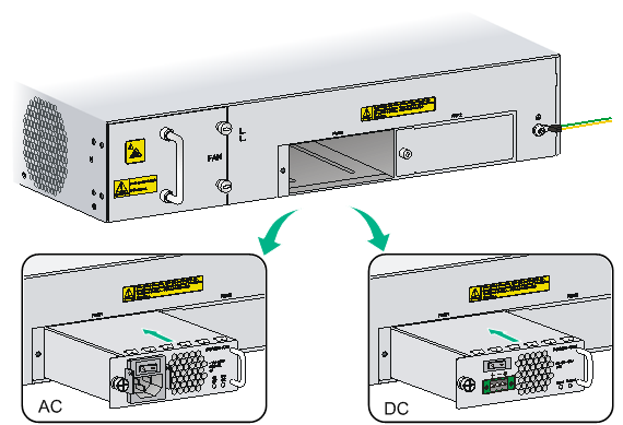

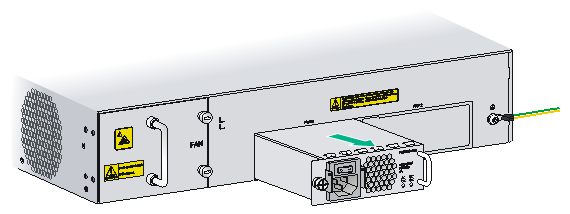

To install the power module:
1.      Face the rear panel of the device.
2.      Select the slot to install the power module.
3.      (Optional.) Use a Phillips screwdriver to loosen the captive screws on the filler panel and remove the filler panel.
Skip this step for the PWR1 slot.
4.      Orient the power module with its handle at the right. Holding the handle of the module with one hand and supporting the module bottom with the other, slide the power module slowly into the slot along the guide rails.
5.      Use a Phillips screwdriver to fasten the captive screws on the power module to secure the power module in place.
Figure 14 Installing a power module

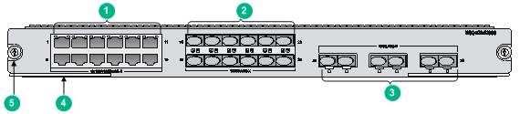

The NSQ1G24XS60 interface module is available for the device. It is not hot swappable.

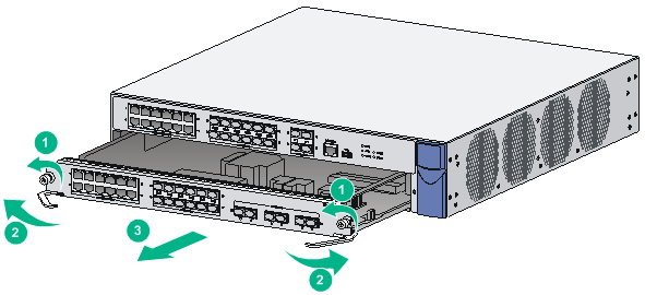

To install an interface module:
1.      Face the front panel of the device.
2.      Use a Phillips screwdriver to loosen the screws on the filler panel and remove the filler panel.
Keep the removed filler panel secure for future use.
3.      Open the ejector levers on the module and slide the module slowly into the slot along the guide rails.
4.      Close the ejector levers and make sure the interface module is seated securely in the slot.
5.      Use a Phillips screwdriver to fasten the captive screws on the module.
Figure 15 Installing an NSQ1G24XS60 interface module

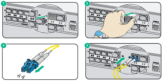

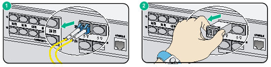

To connect a fiber port:
1.      Remove the dust plug from the fiber port.
2.      Remove the dust cap from the transceiver module and insert it into the fiber port.
3.      Remove the dust cap from the optical fiber connector, and use dust free paper and absolute alcohol clean the end face of the fiber connector.
4.      Identify the Rx and Tx ports on the transceiver module. Use the optical fiber to connect the Rx port and Tx port on the transceiver module to the Tx port and Rx port on the peer end, respectively.
Figure 18 Connecting an optical fiber

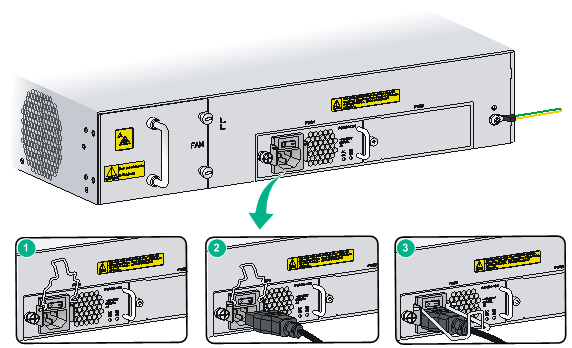

Connecting the AC power cord
1.      Attach the power cord retainer to the power module and pivot the retainer upwards.
2.      Connect the AC power cord connector to the AC-input power receptacle on the device.
3.      Pivot the power cord retainer down to secure the connector to the power receptacle.
4.      Connect the other end of the power cord to an AC power source.
Figure 19 Connecting the AC power cord

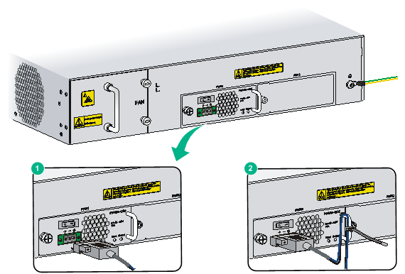

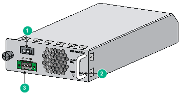

Connecting the DC power cord
1.      Correctly orient the DC power cord connector and insert the connector into the receptacle.
2.      Use a cable tie to secure the DC power cord to the power module handle.
3.      Connect the other end of the power cord to a DC power source.
Figure 20 Connecting the DC power cord

Replacing a power module
WARNING
WARNING!
Before you remove a power module, turn off the switch on the power module and remove the power cord from the power module.
The replacement procedure is the same for AC and DC power modules. The following procedure replaces an AC power module
To replace a power module:
2.      Use a Phillips screwdriver to loosen the captive screw on the power module.
3.      Holding the power module handle with one hand and supporting the module bottom with the other, gently pull the power module out of the slot along the slide rails.
Figure 21 Removing a power module
4.      Put the removed power module on a workbench or into an antistatic bag.
5.      Install a new power module. For the power module installation procedure, see "Installing a power module."
Replacing the interface module
CAUTION
CAUTION:
The NSQ1G24XS60 interface module is not hot swappable. Power off the device before replacing the interface module.
To replace the interface module:
1.      Power off the device.
2.      Use a Phillips screwdriver to loosen the captive screws on the interface module.
3.      Open the ejector levers of the interface module. Pull the module part way out of the slot along the guide rails.
4.      Supporting the bottom of the module with one hand, use the other hand to gently pull the module out of the slot.
5.      Put the removed interface module on an antistatic workbench or into an antistatic bag, with its component side facing up.
6.      If you do not install a new interface module, install a filler panel in the interface module slot.
Figure 22 Removing an NSQ1G24XS60 interface module
(1) Loosen the captive screws
(2) Open the ejector levers
(3) Pull the module out of the slot

To replace a transceiver module:
1.      Use the shutdown command in interface view at the CLI to shut down the port.
2.      Remove the LC connectors of the optical fiber from the transceiver module.
Install dust caps for the LC connectors to prevent contamination and ESD damage.
3.      Pivot the clasp of the transceiver module down to the horizontal position, and then gently pull the transceiver module out.
Figure 24 Removing a transceiver module
4.      Install dust caps for the removed transceiver module, and then put it into the package.
5.      Install a new transceiver module. For the installation procedure, see "Connecting a fiber port."

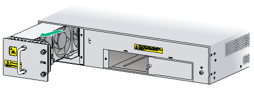

The device supports automatic fan speed adjustment and hot swapping of the fan tray.
To replace the fan tray:
1.      Face the rear of the device.
2.      Use a Phillips screwdriver to loosen the captive screws on the fan tray.
3.      Grasping the fan tray handle with one hand and supporting the fan tray bottom with the other, pull the fan tray slowly out of the slot along the guide rails.
Figure 25 Removing the fan tray
4.      Install a new fan tray. Grasping the fan tray handle with one hand and supporting the fan tray bottom with the other, push the fan tray slowly into the slot along the guide rails. Make sure the fan tray is seated securely in the slot.
5.      Use a Phillips screwdriver to fasten the captive screws on the fan tray.

Fan tray failure
Symptom
After the device is booted, the following information is displayed on the configuration terminal:
%Jun 22 16:11:37:485 2014 H3C DEV/4/FAN FAILED:
 Fan 1 failed.
The output indicates a fan tray failure.
Solution
To resolve the issue:
1.      Verify that a fan tray is installed in the fan tray slot.
2.      Verify that the fan tray is in firm contact with the backplane.
3.      If the issue persists, contact H3C Support.

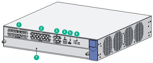

Front view
On the front panel, the device provides the following ports:
·           Twelve 10/100/1000BASE-T autosensing copper Ethernet ports
·           Twelve 1000BASE-X fiber Ethernet ports
·           Four 10GBASE-R fiber Ethernet ports
·           One USB port
·           One console port
Figure 26 Front view
(1) 10/100/1000BASE-T copper Ethernet ports
(2) 1000BASE-X fiber Ethernet ports
(3) 10GBASE-R fiber Ethernet ports
(4) Console port (CONSOLE)
(5) USB port
(6) LEDs
(7) Interface module slot
Rear view
Figure 27 Rear view
(1) Fan tray
(2) Power module slot 1
(3) Power module slot 2
(4) Grounding screw

Interface module
The NSQ1G24XS60 interface module is available for the device. It provides the following ports:
·           Twelve 10/100/1000BASE-T copper Ethernet ports
·           Six 10GBASE-R fiber Ethernet ports
Figure 28 Front panel
(1) 10/100/1000BASE-T copper Ethernet ports 0 to 11
(2) 1000BASE-X fiber Ethernet ports 12 to 23
(3) 10BASE-R fiber Ethernet ports 24 to 29
(4) Ejector lever
(5) Captive screw

The device provides two power module slots (PWR1 and PWR2) and comes with a filler panel installed in the PWR2 slot.
The device supports AC and DC power modules. It supports hot swapping of power modules and 1+1 power module redundancy. To install two power modules for the device, make sure they are the same model.
No power modules are shipped with the device. Purchase AC or DC power modules yourself as required.

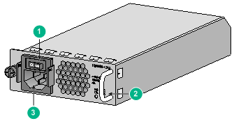

AC power module
The PSR300-12A2 AC power module is available for the device. It provides a maximum output of 300 W.
Figure 29 PSR300-12A2 AC power module
(1) Power switch
(2) Handle
(3) Power receptacle
Table 16 PSR300-12A2 AC power module specifications
Item
Specification
Rated input voltage range
100 VAC to 240 VAC @ 50 Hz or 60 Hz
Maximum input current
4 A
Maximum power
300 W
DC power module
The PSR300-12D2 DC power module is available for the device. It provides a maximum output of 300 W.
Figure 30 PSR300-12D2 DC power module
(1) Power switch
(2) Handle
Table 17 PSR300-12D2 DC power module specifications
Item
Specification
–48 VDC to –60 VDC
10 A
Maximum power
300 W

GE fiber Ethernet port
The device provides twelve 1000BASE-X fiber Ethernet ports.
Table 22 Fiber Ethernet port specifications
Item
Specification
Connector type
LC
Transceiver module type
SFP transceiver module. See Table 23 for the available SFP transceiver modules.

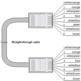

EIA/TIA cabling specifications define two standards, 568A and 568B, for cable pinouts.
·           Standard 568A—pin 1: white/green stripe, pin 2: green solid, pin 3: white/orange stripe, pin 4: blue solid, pin 5: white/blue stripe, pin 6: orange solid, pin 7: white/brown stripe, pin 8: brown solid.
·           Standard 568B—pin 1: white/orange stripe, pin 2: orange solid, pin 3: white/green stripe, pin 4: blue solid, pin 5: white/blue stripe, pin 6: green solid, pin 7: white/brown stripe, pin 8: brown solid.

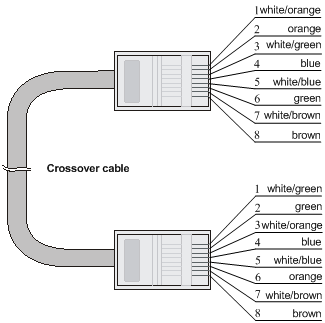

Ethernet twisted pair cables can be classified into straight-through and crossover cables based on their pinouts.
·           Straight-throughThe pinouts at both ends are T568B compliant, as shown in Figure 33.
·           CrossoverThe pinouts are T568B compliant at one end and T568A compliant at the other end, as shown in Figure 34.
Figure 33 Straight-through cable
Figure 34 Crossover cable
Select an Ethernet twisted pair cable according to the RJ-45 Ethernet port type on your device. An RJ-45 Ethernet port can be MDI (for routers and PCs) or MDIX (for switches). Table 30 and Table 31 show their pinouts.

Fiber connectors are indispensable passive components in an optical fiber communication system. They allow the removable connection between optical channels, which makes the optical system debugging and maintenance more convenient. There are multiple types of fiber connectors. Figure 35 shows an LC connector.
Figure 35 Appearance of an LC connector
LC连接器外观
Follow these guidelines when you connect an optical fiber:
·           Before connecting an optical fiber, make sure the connector and cable type match the hot swappable interface module.
·           The fiber Ethernet port of the firewall supports only the LC connector.
·           Fiber connectors are fitted with dust caps. Keep the dust caps secure when the fiber connectors are in use. Install dust caps when the fiber connectors are not in use to avoid damage to their end face. Replace the dust cap if it is loose or polluted.
·           Before connecting an optical fiber, use dust free paper and absolute alcohol to clean the end face of the two fiber connectors. You can brush the end faces only in one direction.
·           Never bend or curve a fiber when connecting it.
·           If the fiber has to pass through a metallic board hole, when passing through a metallic board hole or bending along the acute side of mechanical parts, the fiber must wear jackets or cushions.
