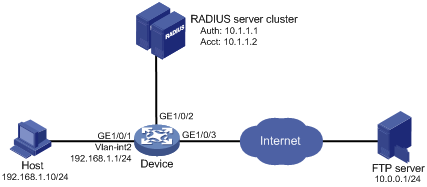

802.1X support for VXLANs
The device can act as a VTEP in a VXLAN network. As shown in Figure 11, when VTEPs in a VXLAN network act as NASs, users' VLANs cannot identify their service information. To resolve this issue, you must configure the RADIUS server to assign VSIs to authenticated 802.1X users. The VTEPs will map the users' traffic to the VXLANs that are associated with the users' respective authorization VSIs. The mapping criteria include the user access VLAN, access port, and MAC address.
For information about VSIs and VXLANs, see VXLAN Configuration Guide.
Figure 11 VXLAN network diagram for 802.1X authentication

802.1X with ACL assignment configuration example
Network requirements
As shown in Figure 14, the host that connects to GigabitEthernet 1/0/1 must pass 802.1X authentication to access the Internet.
Perform 802.1X authentication on GigabitEthernet 1/0/1. Use the RADIUS server at 10.1.1.1 as the authentication and authorization server, and the RADIUS server at 10.1.1.2 as the accounting server.
Configure ACL assignment on GigabitEthernet 1/0/1 to deny access of 802.1X users to the FTP server from 8:00 to 18:00 on weekdays.
Figure 14 Network diagram
Configuration procedure
For information about the RADIUS commands used on the access device in this example, see Security Command Reference.
1.     Configure the RADIUS servers to provide authentication, authorization, and accounting services. Add user accounts and specify the ACL (ACL 3000 in this example) for the users. (Details not shown.)
2.     Assign an IP address to each interface, as shown in Figure 14. (Details not shown.)
3.     Configure a RADIUS scheme on the access device:
# Create RADIUS scheme 2000 and enter RADIUS scheme view.
<Device> system-view
[Device] radius scheme 2000
# Specify the server at 10.1.1.1 as the primary authentication server, and set the authentication port to 1812.
[Device-radius-2000] primary authentication 10.1.1.1 1812
# Specify the server at 10.1.1.2 as the primary accounting server, and set the accounting port to 1813.
[Device-radius-2000] primary accounting 10.1.1.2 1813
# Set the shared key to abc in plain text for secure communication between the authentication server and the device.
[Device-radius-2000] key authentication simple abc
# Set the shared key to abc in plain text for secure communication between the accounting server and the device.
[Device-radius-2000] key accounting simple abc
# Exclude the ISP domain names from the usernames sent to the RADIUS server.
[Device-radius-2000] user-name-format without-domain
[Device-radius-2000] quit
4.     Configure an ISP domain on the access device:
# Create ISP domain bbb and enter ISP domain view.
[Device] domain bbb
# Apply RADIUS scheme 2000 to the ISP domain for authentication, authorization, and accounting.
[Device-isp-bbb] authentication lan-access radius-scheme 2000
[Device-isp-bbb] authorization lan-access radius-scheme 2000
[Device-isp-bbb] accounting lan-access radius-scheme 2000
[Device-isp-bbb] quit
5.     Configure a time range named ftp from 8:00 to 18:00 on weekdays on the access device.
[Device] time-range ftp 8:00 to 18:00 working-day
6.     Configure ACL 3000 to deny packets destined for the FTP server at 10.0.0.1 during the specified time range on the access device.
[Device] acl advanced 3000
[Device-acl-ipv4-adv-3000] rule 0 deny ip destination 10.0.0.1 0 time-range ftp
[Device-acl-ipv4-adv-3000] quit
7.     Configure 802.1X on the access device:
# Enable 802.1X on GigabitEthernet 1/0/1.
[Device-GigabitEthernet1/0/1] dot1x
# Enable 802.1X globally.
[Device] dot1x
8.     Configure the 802.1X client. Make sure the client is able to update its IP address after the access port is assigned to the 802.1X guest VLAN or an authorization VLAN. (Details not shown.)
# Use the user account to pass authentication. (Details not shown.)
# Verify that the user cannot ping the FTP server at any time from 8:00 to 18:00 on any weekday.
C:\>ping 10.0.0.1
Pinging 10.0.0.1 with 32 bytes of data:
Request timed out.
Request timed out.
Request timed out.
Request timed out.
Ping statistics for 10.0.0.1:
    Packets: Sent = 4, Received = 0, Lost = 4 (100% loss),
The output shows that ACL 3000 is active on the user, and the user cannot access the FTP server.

802.1X with EAD assistant configuration example (with DHCP relay agent)
As shown in Figure 16:
·     The intranet 192.168.1.0/24 is attached to GigabitEthernet 1/0/1 of the access device.
·     The hosts use DHCP to obtain IP addresses.
·     A DHCP server and a Web server are deployed on the 192.168.2.0/24 subnet for users to obtain IP addresses and download client software.
Deploy an EAD solution for the intranet to meet the following requirements:
·     Allow unauthenticated users and users that have failed 802.1X authentication to access 192.168.2.0/24. The users can obtain IP addresses and download software.
·     If these users use a Web browser to access a network other than 192.168.2.0/24, redirect them to the Web server for 802.1X client downloading.
·     Allow authenticated 802.1X users to access the network.
Figure 16 Network diagram
1.     Make sure the DHCP server, the Web server, and the authentication servers have been configured correctly. (Details not shown.)
