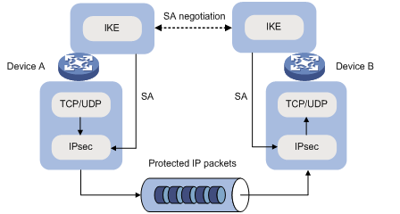

IPsec implementation
To implement IPsec protection for packets between two peers, complete the following tasks on each peer:
·     Configure an IPsec policy, which defines the range of packets to be protected by IPsec and the security parameters used for the protection.
·     Apply the IPsec policy to an interface or an application.
When you apply an IPsec policy to an interface, you implement IPsec based on the interface. Packets received and sent by the interface are protected according to the IPsec policy. When you apply an IPsec policy to an application, you implement IPsec based on the application. Packets of the application are protected according to the IPsec policy, regardless of the receiving and sending interface of the packets.
IPsec protects packets as follows:
·     When an IPsec peer identifies the packets to be protected according to the IPsec policy, it sets up an IPsec tunnel and sends the packet to the remote peer through the tunnel. The IPsec tunnel can be manually configured beforehand, or it can be set up through IKE negotiation triggered by the packet. The IPsec tunnels are actually the IPsec SAs. The inbound packets are protected by the inbound SA, and the outbound packets are protected by the outbound SA.
·     When the remote IPsec peer receives the packet, it drops, de-encapsulates, or directly forwards the packet according to the configured IPsec policy.
Interface-based IPsec supports setting up IPsec tunnels based on ACLs.

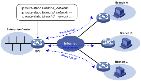

IPsec RRI
As shown in Figure 4, the traffic between the enterprise center and the branches are protected by IPsec. The gateway at the enterprise center is configured with static routes to route traffic to the IPsec-protected interfaces. It is difficult to add or modify static routes on the gateway at the enterprise center if the IPsec VPN has a large number of branches or if the network structure changes.
Figure 4 IPsec VPN
IPsec Reverse Route Injection (RRI) enables an IPsec tunnel gateway to automatically add static routes destined for protected private networks or static routes destined for peer IPsec tunnel gateways to a routing table. As shown in Figure 4, you can enable IPsec RRI on the gateway at the enterprise center. After an IPsec tunnel is established, the gateway automatically adds a static route to the routing table, which can be looked up. The destination IP address is the protected private network, and the next hop is the remote IP address of the IPsec tunnel. The traffic destined for the peer end is routed to the IPsec tunnel interface and thereby protected by IPsec.
You can advertise the static routes created by IPsec RRI in the internal network, and the internal network device can use them to forward traffic in the IPsec VPN.
In an MPLS L3VPN network, IPsec RRI can add static routes to VPN instances' routing tables.
IPsec RRI is applicable to gateways that must provide many IPsec tunnels (for example, a headquarters gateway).

Configuring IPsec RRI
Configuration guidelines
When you enable or disable IPsec RRI for an IPsec policy, the device deletes all IPsec SAs created by this IPsec policy, and the associated static routes.
If you change the preference value or tag value for an IPsec policy, the device deletes all IPsec SAs created by this IPsec policy, and the associated static routes. Your change takes effect for future IPsec RRI-created static routes.
You can set preferences for the static routes created by IPsec RRI to flexibly apply route management policies. For example, you can set the same preference for multiple routes to the same destination to implement load sharing, or you can set different preferences to implement route backup.
You can also set tags for the static routes created by IPsec RRI to implement flexible route control through routing policies.
IPsec RRI does not generate a static route to a destination address to be protected if the destination address is not defined in the ACL used by an IPsec policy or an IPsec policy template. You must manually configure a static route to the destination address.
Configuration procedure
To configure IPsec RRI:
Step
Remarks
N/A
2.     Enter IPsec policy view or IPsec policy template view.
·     To enter IPsec policy view:
ipsec { policy | ipv6-policy } policy-name seq-number  isakmp
·     To enter IPsec policy template view:
ipsec { policy-template | ipv6-policy-template } template-name seq-number
N/A
3.     Enable IPsec RRI.
reverse-route dynamic
By default, IPsec RRI is disabled.
IPsec RRI is supported in both tunnel mode and transport mode.
4.     Optional.) Set the preference value for the static routes created by IPsec RRI.
reverse-route preference number
The default value is 60.
5.     (Optional.) Set the tag value for the static routes created by IPsec RRI.
reverse-route tag tag-value
The default value is 0.

As shown in Figure 6, IKE negotiates SAs for IPsec and transfers the SAs to IPsec, and IPsec uses the SAs to protect IP packets.

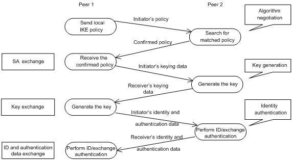

Figure 7 IKE exchange process in main mode
As shown in Figure 7, the main mode of IKE negotiation in phase 1 involves three pairs of messages:
·     SA exchange—Used for negotiating the IKE security policy.
·     Key exchange—Used for exchanging the DH public value and other values, such as the random number. The two peers use the exchanged data to generate key data and use the encryption key and authentication key to ensure the security of IP packets.
·     ID and authentication data exchange—Used for identity authentication.
The main difference between the main mode and the aggressive mode is that the aggressive mode does not provide identity information protection and exchanges only three messages, rather than three pairs. The main mode provides identity information protection but is slower.

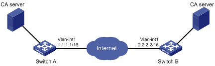

Network requirements
As shown in Figure 8, configure an IKE-based IPsec tunnel between Switch A and Switch B to secure the communication in between.
Configure Switch A and Switch B to use the default IKE proposal for the IKE negotiation to set up the IPsec SAs. Configure the two switches to use the pre-shared key authentication method for the IKE negotiation phase 1.
Figure 8 Network diagram
1.     Configure Switch A:
# Configure an IP address for VLAN-interface 1.
<SwitchA> system-view
[SwitchA] interface vlan-interface 1
[SwitchA-vlan-interface1] ip address 1.1.1.1 255.255.0.0
[SwitchA-vlan-interface1] quit
# Configure ACL 3101 to identify traffic between Switch A and Switch B.
[SwitchA] acl advanced 3101
[SwitchA-acl-ipv4-adv-3101] rule 0 permit ip source 1.1.1.1 0 destination 2.2.2.2 0
[SwitchA-acl-ipv4-adv-3101] quit
# Create an IPsec transform set named tran1.
[SwitchA] ipsec transform-set tran1
# Set the packet encapsulation mode to tunnel.
[SwitchA-ipsec-transform-set-tran1] encapsulation-mode tunnel
# Use the ESP protocol for the IPsec transform set.
[SwitchA-ipsec-transform-set-tran1] protocol esp
# Specify the encryption and authentication algorithms.
[SwitchA-ipsec-transform-set-tran1] esp encryption-algorithm aes-cbc-128
[SwitchA-ipsec-transform-set-tran1] esp authentication-algorithm sha1
[SwitchA-ipsec-transform-set-tran1] quit
# Create an IKE keychain named keychain1.
[SwitchA] ike keychain keychain1
# Specify 123456TESTplat&! in plain text as the pre-shared key to be used with the remote peer at 2.2.2.2.
[SwitchA-ike-keychain-keychain1] pre-shared-key address 2.2.2.2 255.255.0.0 key simple 123456TESTplat&!
[SwitchA-ike-keychain-keychain1] quit
# Create an IKE profile named profile1.
[SwitchA] ike profile profile1
# Specify IKE keychain keychain1.
[SwitchA-ike-profile-profile1] keychain keychain1
# Configure the local ID with the identity type as IP address and the value as 1.1.1.1.
[SwitchA-ike-profile-profile1] local-identity address 1.1.1.1
# Configure a peer ID with the identity type as IP address and the value as 2.2.2.2/24.
[SwitchA-ike-profile-profile1] match remote identity address 2.2.2.2 255.255.0.0
[SwitchA-ike-profile-profile1] quit
# Create an IKE-based IPsec policy entry. Specify the policy name as map1 and set the sequence number to 10.
[SwitchA] ipsec policy map1 10 isakmp
# Specify the remote IP address 2.2.2.2 for the IPsec tunnel.
[SwitchA-ipsec-policy-isakmp-map1-10] remote-address 2.2.2.2
# Specify ACL 3101 to identify the traffic to be protected.
[SwitchA-ipsec-policy-isakmp-map1-10] security acl 3101
# Specify IPsec transform set tran1 for the IPsec policy.
[SwitchA-ipsec-policy-isakmp-map1-10] transform-set tran1
# Specify IKE profile profile1 for the IPsec policy.
[SwitchA-ipsec-policy-isakmp-map1-10] ike-profile profile1
[SwitchA-ipsec-policy-isakmp-map1-10] quit
# Apply IPsec policy map1 to VLAN-interface 1.
[SwitchA-Vlan-interface1] ipsec apply policy map1
2.     Configure Switch B:
<SwitchB> system-view
[SwitchB] interface Vlan-interface1
[SwitchB-Vlan-interface1] ip address 2.2.2.2 255.255.0.0
[SwitchB-Vlan-interface1] quit
# Configure ACL 3101 to identify traffic between Switch B and Switch A.
[SwitchB] acl advanced 3101
[SwitchB-acl-ipv4-adv-3101] rule 0 permit ip source 2.2.2.2 0 destination 1.1.1.1 0
[SwitchB-acl-ipv4-adv-3101] quit
[SwitchB] ipsec transform-set tran1
[SwitchB-ipsec-transform-set-tran1] encapsulation-mode tunnel
[SwitchB-ipsec-transform-set-tran1] protocol esp
[SwitchB-ipsec-transform-set-tran1] esp encryption-algorithm aes-cbc-128
[SwitchB-ipsec-transform-set-tran1] esp authentication-algorithm sha1
[SwitchB-ipsec-transform-set-tran1] quit
[SwitchB]ike keychain keychain1
# Specify 123456TESTplat&! in plain text as the pre-shared key to be used with the remote peer at 1.1.1.1.
[SwitchB-ike-keychain-keychain1] pre-shared-key address 1.1.1.1 255.255.0.0 key simple 123456TESTplat&!
[SwitchB-ike-keychain-keychain1] quit
[SwitchB] ike profile profile1
[SwitchB-ike-profile-profile1] keychain keychain1
# Configure the local ID with the identity type as IP address and the value as 2.2.2.2.
[SwitchB-ike-profile-profile1] local-identity address 2.2.2.2
# Configure a peer ID with the identity type as IP address and the value as 1.1.1.1/24.
[SwitchB-ike-profile-profile1] match remote identity address 1.1.1.1 255.255.0.0
[SwitchB-ike-profile-profile1] quit
# Create an IKE-based IPsec policy entry. Specify the policy name as use1 and set the sequence number to 10.
[SwitchB] ipsec policy use1 10 isakmp
# Specify the remote IP address 1.1.1.1 for the IPsec tunnel.
[SwitchB-ipsec-policy-isakmp-use1-10] remote-address 1.1.1.1
[SwitchB-ipsec-policy-isakmp-use1-10] security acl 3101
[SwitchB-ipsec-policy-isakmp-use1-10] transform-set tran1
[SwitchB-ipsec-policy-isakmp-use1-10] ike-profile profile1
[SwitchB-ipsec-policy-isakmp-use1-10] quit
# Apply IPsec policy use1 to VLAN-interface 1.
[SwitchB] interface vlan-interface 1
[SwitchB-Vlan-interface1] ipsec apply policy use1
# Initiate a connection from Switch A to Switch B to trigger IKE negotiation. After IPsec SAs are successfully negotiated by IKE, traffic between the two switches is IPsec protected.

[SwitchB] ike profile profile2
# Specify PKI domain domain2.
[SwitchB-ike-profile-profile2] certificate domain domain2
# Set the local identity to the FQDN name www.switchb.com.
[SwitchB-ike-profile-profile2] local-identity fqdn www.switchb.com
# Configure a peer ID with the identity type of FQDN name and the value of www.switcha.com.
[SwitchB-ike-profile-profile2] match remote identity fqdn www.switcha.com
[SwitchB-ike-profile-profile2] quit
# Create an IKE proposal named 10.
[SwitchB] ike proposal 10
# Specify the authentication algorithm as HMAC-MD5.
[SwitchB-ike-proposal-10] authentication-algorithm md5
# Specify the RSA signature authentication method.
[SwitchB-ike-proposal-10] authentication-method rsa-signature
[SwitchB-ike-proposal-10] quit
# Create an IPsec policy template entry. Specify the template name as template1 and set the sequence number to 1.
[SwitchB] ipsec policy-template template1 1
# Specify IPsec transform set tran1 for the IPsec policy template.
[SwitchB-ipsec-policy-template-template1-1] transform-set tran1
# Specify IKE profile profile2 for the IPsec policy template.
[SwitchB-ipsec-policy-template-template1-1] ike-profile profile2
[SwitchB-ipsec-policy-template-template1-1] quit
# Create an IKE-based IPsec policy entry by using IPsec policy template template1. Specify the policy name as use1 and set the sequence number to 1.
[SwitchB] ipsec policy use1 1 isakmp template template1

IKEv2 with pre-shared key authentication configuration example
As shown in Figure 11, configure an IKE-based IPsec tunnel between Switch A and Switch B to secure the communication between them.
·     Configure Switch A and Switch B to use the default IKEv2 proposal and the default IKEv2 policy in IKEv2 negotiation to set up IPsec SAs.
·     Configure the two switches to use the pre-shared key authentication method in IKEv2 negotiation.
Figure 11 Network diagram
Configuration procedures

IKEv2 with RSA signature authentication configuration example
As shown in Figure 12, configure an IKE-based IPsec tunnel between Switch A and Switch B to secure the communication between them.
Configure Switch A and Switch B to use IKEv2 negotiation and RSA signature authentication.
Figure 12 Network diagram
[SwitchB-ipsec-policy-template-template1-1] remote-address 1.1.1.1
[SwitchB-ipsec-policy-template-template1-1] security acl 3101
# Specify IKEv2 profile profile2 for the IPsec policy template.
[SwitchB-ipsec-policy-template-template1-1] ikev2-profile profile2
# Initiate a connection between Switch A and Switch B to trigger IKEv2 negotiation. After IPsec SAs are successfully negotiated by IKEv2, traffic between the switches is IPsec protected.
