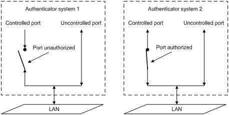

Controlled/uncontrolled port and port authorization status
802.1X defines two logical ports for the network access port: controlled port and uncontrolled port. Any packet arriving at the network access port is visible to both logical ports.
·     Uncontrolled port—Is always open to receive and transmit authentication packets.
·     Controlled port—Filters packets depending on the port state.
¡     Authorized state—The controlled port is in authorized state when the client has passed authentication. The port allows traffic to pass through.
¡     Unauthorized state—The port is in unauthorized state when the client has failed authentication. The port controls traffic by using one of the following methods:
-     Performs bidirectional traffic control to deny traffic to and from the client.
-     Performs unidirectional traffic control to deny traffic from the client. The H3C devices support only unidirectional traffic control.
Figure 2 Authorization state of a controlled port

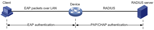

·     EAP termination mode.
As shown in Figure 8, the access device performs the following operations in EAP termination mode:
a.     Terminates the EAP packets received from the client.
b.     Encapsulates the client authentication information in standard RADIUS packets.
c.     Uses PAP or CHAP to authenticate to the RADIUS server.
Figure 8 EAP termination

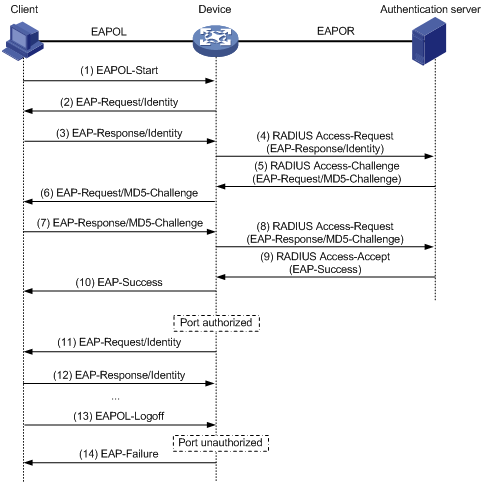

EAP relay
Figure 9 shows the basic 802.1X authentication procedure in EAP relay mode, assuming that EAP-MD5 is used.
Figure 9 802.1X authentication procedure in EAP relay mode
The following steps describe the 802.1X authentication procedure:
1.     When a user launches the 802.1X client and enters a registered username and password, the 802.1X client sends an EAPOL-Start packet to the access device.
2.     The access device responds with an EAP-Request/Identity packet to ask for the client username.
3.     In response to the EAP-Request/Identity packet, the client sends the username in an EAP-Response/Identity packet to the access device.
4.     The access device relays the EAP-Response/Identity packet in a RADIUS Access-Request packet to the authentication server.
5.     The authentication server uses the identity information in the RADIUS Access-Request to search its user database. If a matching entry is found, the server uses a randomly generated challenge (EAP-Request/MD5-Challenge) to encrypt the password in the entry. Then, the server sends the challenge in a RADIUS Access-Challenge packet to the access device.
6.     The access device transmits the EAP-Request/MD5-Challenge packet to the client.
7.     The client uses the received challenge to encrypt the password, and sends the encrypted password in an EAP-Response/MD5-Challenge packet to the access device.
8.     The access device relays the EAP-Response/MD5-Challenge packet in a RADIUS Access-Request packet to the authentication server.
9.     The authentication server compares the received encrypted password with the encrypted password it generated at step 5. If the two passwords are identical, the server considers the client valid and sends a RADIUS Access-Accept packet to the access device.
10.     Upon receiving the RADIUS Access-Accept packet, the access device performs the following operations:
a.     Sends an EAP-Success packet to the client.
b.     Sets the controlled port in authorized state.
The client can access the network.
11.     After the client comes online, the access device periodically sends handshake requests to check whether the client is still online. By default, if two consecutive handshake attempts fail, the device logs off the client.
12.     Upon receiving a handshake request, the client returns a response. If the client fails to return a response after a number of consecutive handshake attempts (two by default), the access device logs off the client. This handshake mechanism enables timely release of the network resources used by 802.1X users that have abnormally gone offline.
13.     The client can also send an EAPOL-Logoff packet to ask the access device for a logoff.
14.     In response to the EAPOL-Logoff packet, the access device changes the status of the controlled port from authorized to unauthorized. Then, the access device sends an EAP-Failure packet to the client.

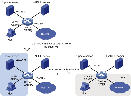

802.1X support for VXLANs
The device can act as a VTEP in a VXLAN network. As shown in Figure 11, when VTEPs in a VXLAN network act as NASs, users' VLANs cannot identify their service information. To resolve this issue, you must configure the RADIUS server to assign VSIs to authenticated 802.1X users. The VTEPs will map the users' traffic to the VXLANs that are associated with the users' respective authorization VSIs. The mapping criteria include the user access VLAN, access port, and MAC address.
For information about VSIs and VXLANs, see VXLAN Configuration Guide.
Figure 11 VXLAN network diagram for 802.1X authentication
Authorization VSI
An authorization VSI is associated with a VXLAN that has network resources inaccessible to unauthenticated users.
802.1X supports remote VSI authorization. When a user passes remote 802.1X authentication, the remote server assigns the authorization VSI information of the user to the user's access port. Upon receiving the authorization VSI information, the VTEP performs the following operations:
1.     Dynamically creates an AC based on the user's access port, VLAN, and MAC address.
2.     Maps the AC to the authorization VSI.
The user then can access resources in the VXLAN associated with the authorization VSI.
If the VTEP does not receive authorization VSI information for the user, the user cannot access resources in any VXLAN after passing authentication.
For information about dynamic creation of ACs, see VXLAN configuration Guide.

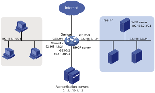

EAD assistant
Endpoint Admission Defense (EAD) is an H3C integrated endpoint access control solution to improve the threat defensive capability of a network. The solution enables the security client, security policy server, access device, and third-party server to operate together. If a terminal device seeks to access an EAD network, it must have an EAD client, which performs 802.1X authentication.
The EAD assistant feature enables the access device to redirect the HTTP or HTTPS requests of a user to a redirect URL for downloading and installing an EAD client. This feature eliminates the administrative task to deploy EAD clients.
EAD assistant is implemented by the following functionality:
·     Free IP.
A free IP is a freely accessible network segment, which has a limited set of network resources such as software and DHCP servers. To ensure security strategy compliance, an unauthenticated user can access only this segment to perform operations. For example, the user can download EAD client from a software server or obtain a dynamic IP address from a DHCP server.
·     Redirect URL.
If an unauthenticated 802.1X user is using a Web browser to access the network, EAD assistant redirects the HTTP or HTTPS requests of the user to a specific URL. For example, you can use this feature to redirect the user to the EAD client software download page.
The EAD assistant feature creates an ACL-based EAD rule automatically to open access to the redirect URL for each redirected user.
EAD rules are implemented by using ACL resources. When the EAD rule timer expires or the user passes authentication, the rule is removed. If users fail to download EAD client or fail to pass authentication before the timer expires, they must reconnect to the network to access the free IP.

Enabling EAP relay or EAP termination
When configuring EAP relay or EAP termination, consider the following factors:
·     Support of the RADIUS server for EAP packets.
·     Authentication methods supported by the 802.1X client and the RADIUS server.
You can use both EAP termination and EAP relay in any of the following situations:
·     The client is using only MD5-Challenge EAP authentication. If EAP termination is used, you must enable CHAP authentication on the access device.
·     The client is an iNode 802.1X client and initiates only the username and password EAP authentication. If EAP termination is used, you can enable either PAP or CHAP authentication on the access device. However, if the password is required to be transmitted in cipher text, you must use CHAP authentication on the access device.
To use EAP-TLS, PEAP, or any other EAP authentication methods, you must use EAP relay. When you make your decision, see "Comparing EAP relay and EAP termination" for help.
For more information about EAP relay and EAP termination, see "802.1X authentication procedures."
To configure EAP relay or EAP termination:
Step
Remarks
N/A
2.     Configure EAP relay or EAP termination.
dot1x authentication-method { chap | eap | pap }
By default, the access device performs EAP termination and uses CHAP to communicate with the RADIUS server.
Specify the eap keyword to enable EAP relay.
Specify the chap or pap keyword to enable CHAP-enabled or PAP-enabled EAP termination.
If EAP relay mode is used, the user-name-format command configured in RADIUS scheme view does not take effect. The access device sends the authentication data from the client to the server without any modification.
Setting the port authorization state
The port authorization state determines whether the client is granted access to the network. You can control the authorization state of a port by using the dot1x port-control command and the following keywords:
·     authorized-force—Places the port in the authorized state, enabling users on the port to access the network without authentication.
·     unauthorized-force—Places the port in the unauthorized state, denying any access requests from users on the port.
·     auto—Places the port initially in unauthorized state to allow only EAPOL packets to pass. After a user passes authentication, sets the port in the authorized state to allow access to the network. You can use this option in most scenarios.

Configuring an 802.1X guest VSI
You can configure only one 802.1X guest VSI on a port. The 802.1X guest VSIs on different ports can be different.
Only ports that perform MAC-based access control support the 802.1X guest VSI.
Configuration prerequisites
Before you configure the 802.1X guest VSI on an 802.1X-enabled port, complete the following tasks:
·     Enable L2VPN.
·     Create the VSI to be specified as the 802.1X guest VSI, and create a VXLAN for the VSI.
·     Enable MAC-based traffic match mode for dynamic ACs.
For more information, see VXLAN Configuration Guide.
Configuration procedure
To configure the 802.1X guest VSI on a port:
Step
Remarks
N/A
2.     Enter interface view.
N/A
3.     Configure the 802.1X guest VSI on the port.
dot1x guest-vsi guest-vsi-name
By default, no 802.1X guest VSI exists.

·     If you use the free IP and Auth-Fail VLAN features together, make sure the resources in the Auth-Fail VLAN are on the free IP segments.
·     To allow a user to obtain a dynamic IP address before it passes 802.1X authentication, make sure the DHCP server is on the free IP segment.
·     The server that provides the redirect URL must be on the free IP accessible to unauthenticated users.
·     To avoid using up ACL resources when a large number of EAD users exist, you can shorten the EAD rule timer.
To configure the EAD assistant feature:
Step
Remarks
N/A
2.     Enable the EAD assistant feature.
dot1x ead-assistant enable
By default, this feature is disabled.
3.     Configure a free IP.
dot1x ead-assistant free-ip ip-address { mask-length | mask-address }
By default, no free IPs exist.
4.     (Optional.) Configure the redirect URL.
dot1x ead-assistant url url-string
By default, no redirect URL exists.
Configure the redirect URL if users will use Web browsers to access the network.
To redirect the HTTPS requests of 802.1X users, specify the HTTPS redirect listening port on the device. For more information, see HTTP redirect in Layer 3IP Services Configuration Guide.
5.     (Optional.) Set the EAD rule timer.
dot1x timer ead-timeout ead-timeout-value
The default setting is 30 minutes.

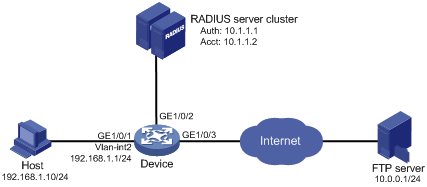

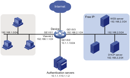

802.1X with ACL assignment configuration example
Network requirements
As shown in Figure 14, the host that connects to GigabitEthernet 1/0/1 must pass 802.1X authentication to access the Internet.
Perform 802.1X authentication on GigabitEthernet 1/0/1. Use the RADIUS server at 10.1.1.1 as the authentication and authorization server, and the RADIUS server at 10.1.1.2 as the accounting server.
Configure ACL assignment on GigabitEthernet 1/0/1 to deny access of 802.1X users to the FTP server from 8:00 to 18:00 on weekdays.
Figure 14 Network diagram
For information about the RADIUS commands used on the access device in this example, see Security Command Reference.
1.     Configure the RADIUS servers to provide authentication, authorization, and accounting services. Add user accounts and specify the ACL (ACL 3000 in this example) for the users. (Details not shown.)
2.     Assign an IP address to each interface, as shown in Figure 14. (Details not shown.)
3.     Configure a RADIUS scheme on the access device:
# Create RADIUS scheme 2000 and enter RADIUS scheme view.
<Device> system-view
[Device] radius scheme 2000
# Specify the server at 10.1.1.1 as the primary authentication server, and set the authentication port to 1812.
[Device-radius-2000] primary authentication 10.1.1.1 1812
# Specify the server at 10.1.1.2 as the primary accounting server, and set the accounting port to 1813.
[Device-radius-2000] primary accounting 10.1.1.2 1813
# Set the shared key to abc in plain text for secure communication between the authentication server and the device.
[Device-radius-2000] key authentication simple abc
# Set the shared key to abc in plain text for secure communication between the accounting server and the device.
[Device-radius-2000] key accounting simple abc
# Exclude the ISP domain names from the usernames sent to the RADIUS server.
[Device-radius-2000] user-name-format without-domain
[Device-radius-2000] quit
4.     Configure an ISP domain on the access device:
# Create ISP domain bbb and enter ISP domain view.
[Device] domain bbb
# Apply RADIUS scheme 2000 to the ISP domain for authentication, authorization, and accounting.
[Device-isp-bbb] authentication lan-access radius-scheme 2000
[Device-isp-bbb] authorization lan-access radius-scheme 2000
[Device-isp-bbb] accounting lan-access radius-scheme 2000
[Device-isp-bbb] quit
5.     Configure a time range named ftp from 8:00 to 18:00 on weekdays on the access device.
[Device] time-range ftp 8:00 to 18:00 working-day
6.     Configure ACL 3000 to deny packets destined for the FTP server at 10.0.0.1 during the specified time range on the access device.
[Device] acl advanced 3000
[Device-acl-ipv4-adv-3000] rule 0 deny ip destination 10.0.0.1 0 time-range ftp
[Device-acl-ipv4-adv-3000] quit
7.     Configure 802.1X on the access device:
# Enable 802.1X on GigabitEthernet 1/0/1.
[Device-GigabitEthernet1/0/1] dot1x
# Enable 802.1X globally.
[Device] dot1x
8.     Configure the 802.1X client. Make sure the client is able to update its IP address after the access port is assigned to the 802.1X guest VLAN or an authorization VLAN. (Details not shown.)
# Use the user account to pass authentication. (Details not shown.)
# Verify that the user cannot ping the FTP server at any time from 8:00 to 18:00 on any weekday.
C:\>ping 10.0.0.1
Pinging 10.0.0.1 with 32 bytes of data:
Request timed out.
Request timed out.
Request timed out.
Request timed out.
Ping statistics for 10.0.0.1:
    Packets: Sent = 4, Received = 0, Lost = 4 (100% loss),
The output shows that ACL 3000 is active on the user, and the user cannot access the FTP server.
802.1X guest VSI and authorization VSI configuration example
As shown in Figure 15:
·     The device acts as both a VXLAN VTEP and a network access device. It uses the RADIUS server to perform authentication, authorization, and accounting for 802.1X users that connect to GigabitEthernet 1/0/2.
·     GigabitEthernet 1/0/2 uses MAC-based access control and is configured with the 802.1X guest VSI. VXLAN 10 is created on the guest VSI. Users in the guest VSI can access the update server in VXLAN 10 and download the 802.1X client software.
·     The RADIUS server assigns an authorization VSI to the host. The VSI is associated with VXLAN 5 on the device. After passing authentication, the host can access the Internet.
Figure 15 Network diagram
1.     Configure the RADIUS server to provide authentication, authorization, and accounting services. Configure user accounts and authorization VSI (VSI vpn5 in this example) for the users. (Details not shown.)
If an H3C ADCAM server is used for authentication and authorization, configure VSIs on the server. The server will assign these VSIs to the device. You do not need to configure VSIs on the device.
2.     Enable L2VPN on the access device.
[Device] l2vpn enable
3.     Create VSIs and the corresponding VXLANs on the access device.
[Device] vsi vpn10
[Device-vsi-vpn10] vxlan 10
[Device-vsi-vpn10-vxlan-10] quit
[Device-vsi-vpn10] quit
[Device] vsi vpn5
[Device-vsi-vpn5] vxlan 5
[Device-vsi-vpn5-vxlan-5] quit
[Device-vsi-vpn5] quit
4.     Configure a RADIUS scheme on the access device:
# Specify the server at 10.11.1.1 as the primary authentication server, and set the authentication port to 1812.
[Device-radius-2000] primary authentication 10.11.1.1 1812
# Specify the server at 10.11.1.1 as the primary accounting server, and set the accounting port to 1813.
[Device-radius-2000] primary accounting 10.11.1.1 1813
# Exclude the ISP domain names from the usernames sent to the authentication and accounting servers.
5.     Configure an ISP domain on the access device:
[Device] domain bbb
# Apply RADIUS scheme 2000 to the ISP domain for authentication, authorization, and accounting of LAN users.
6.     Configure 802.1X on the access device:
# Enable 802.1X on GigabitEthernet 1/0/2.
[Device] interface gigabitethernet 1/0/2
[Device-GigabitEthernet1/0/2] dot1x
# Set the port authorization mode to auto. By default, the port uses the auto mode.
[Device-GigabitEthernet1/0/2] dot1x port-control auto
# Enable MAC-based traffic match mode for dynamic Ethernet service instances on GigabitEthernet 1/0/2.
[Device-GigabitEthernet1/0/2] mac-based ac
# Enable 802.1X unicast trigger on GigabitEthernet 1/0/2.
[Device-GigabitEthernet1/0/2] dot1x unicast-trigger
# Specify VSI vpn10 as the 802.1X guest VSI on GigabitEthernet 1/0/2.
[Device-GigabitEthernet1/0/2] dot1x guest-vsi vpn10
[Device-GigabitEthernet1/0/2] quit
[Device] dot1x
7.     Configure the 802.1X client. Make sure the 802.1X client can update its IP address after the access port is assigned to the guest VSI or an authorization VSI. (Details not shown.)
# Verify that GigabitEthernet 1/0/2 is assigned to VSI vpn10 if no responses are received from the client after 802.1X authentication is triggered.
[Device] display l2vpn forwarding ac verbose
# Verify that GigabitEthernet 1/0/2 is assigned to VSI vpn5 after a user passes authentication on the port.
802.1X with EAD assistant configuration example (with DHCP relay agent)
As shown in Figure 16:
·     The intranet 192.168.1.0/24 is attached to GigabitEthernet 1/0/1 of the access device.
·     The hosts use DHCP to obtain IP addresses.
·     A DHCP server and a Web server are deployed on the 192.168.2.0/24 subnet for users to obtain IP addresses and download client software.
Deploy an EAD solution for the intranet to meet the following requirements:
·     Allow unauthenticated users and users that have failed 802.1X authentication to access 192.168.2.0/24. The users can obtain IP addresses and download software.
·     If these users use a Web browser to access a network other than 192.168.2.0/24, redirect them to the Web server for 802.1X client downloading.
·     Allow authenticated 802.1X users to access the network.
Figure 16 Network diagram
1.     Make sure the DHCP server, the Web server, and the authentication servers have been configured correctly. (Details not shown.)
2.     Configure an IP address for each interface. (Details not shown.)
3.     Configure DHCP relay:
# Enable DHCP.
[Device] dhcp enable
# Enable the DHCP relay agent on VLAN-interface 2.
[Device] interface vlan-interface 2
[Device-Vlan-interface2] dhcp select relay
# Specify the DHCP server 192.168.2.2 on the relay agent interface VLAN-interface 2.
[Device-Vlan-interface2] dhcp relay server-address 192.168.2.2
[Device-Vlan-interface2] quit
4.     Configure a RADIUS scheme:
5.     Configure an ISP domain:
[Device] domain bbb
6.     Configure 802.1X:
# Configure the free IP.
[Device] dot1x ead-assistant free-ip 192.168.2.0 24
# Configure the redirect URL for client software download.
[Device] dot1x ead-assistant url http://192.168.2.3
# Enable the EAD assistant feature.
[Device] dot1x ead-assistant enable
[Device] dot1x
# Verify the 802.1X configuration.
[Device] display dot1x
# Verify that you can ping an IP address on the free IP subnet from a host.
C:\>ping 192.168.2.3
Pinging 192.168.2.3 with 32 bytes of data:
Reply from 192.168.2.3: bytes=32 time<1ms TTL=128
Ping statistics for 192.168.2.3:
    Minimum = 0ms, Maximum = 0ms, Average = 0ms
The output shows that you can access the free IP subnet before passing 802.1X authentication.
# Verify that you are redirected to the Web server when you enter in your Web browser an IP address not on the free IP. (Details not shown.)
802.1X with EAD assistant configuration example (with DHCP server)
As shown in Figure 17:
·     A Web server is deployed on the 192.168.2.0/24 subnet for users to download client software.
·     Allow unauthenticated users and users that have failed 802.1X authentication to access 192.168.2.0/24. The users can download software.
