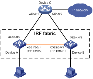

The Intelligent Resilient Framework (IRF) technology virtualizes multiple physical devices at the same layer into one virtual fabric to provide data center class availability and scalability. IRF virtualization technology offers processing power, interaction, unified management, and uninterrupted maintenance of multiple devices.

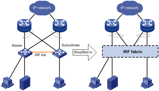

Figure 1 shows an IRF fabric that has two member devices, which appear as a single node to the upper-layer and lower-layer devices.
Figure 1 IRF application scenario
IRF provides the following benefits:
·     Simplified topology and easy management—An IRF fabric appears as one node and is accessible at a single IP address on the network. You can use this IP address to log in at any member device to manage all the members of the IRF fabric. In addition, you do not need to run the spanning tree feature among the IRF members.
·     1:N redundancy—In an IRF fabric, one member acts as the master to manage and control the entire IRF fabric. All the other members process services while backing up the master. When the master fails, all the other member devices elect a new master from among them to take over without interrupting services.
·     IRF link aggregation—You can assign several physical links between neighboring members to their IRF ports to create a load-balanced aggregate IRF connection with redundancy.
·     Multichassis link aggregation—You can use the Ethernet link aggregation feature to aggregate the physical links between the IRF fabric and its upstream or downstream devices across the IRF members.
·     Network scalability and resiliency—Processing capacity of an IRF fabric equals the total processing capacities of all the members. You can increase ports, network bandwidth, and processing capacity of an IRF fabric simply by adding member devices without changing the network topology.
As shown in Figure 2, Device A and Device B form a two-chassis IRF fabric. The fabric has four MPUs (one active and three standbys), and two times the number of interface modules that a single device provides. The IRF fabric manages the physical and software resources of Device A and Device B in a centralized manner.
Figure 2 Two-chassis IRF fabric implementation schematic diagram

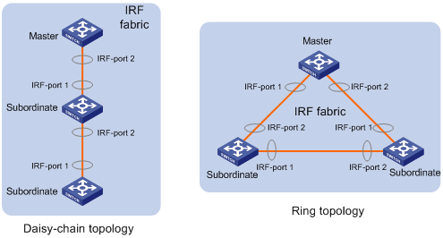

The device supports daisy-chain or ring topology for IRF fabrics. IRF does not support the full mesh topology. For information about connecting IRF member devices, see "Connecting IRF physical interfaces."

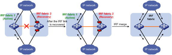

An IRF link failure causes an IRF fabric to split in two IRF fabrics operating with the same Layer 3 configurations, including the same IP address. To avoid IP address collision and network problems, IRF uses multi-active detection (MAD) mechanisms to detect the presence of multiple identical IRF fabrics, handle collisions, and recover from faults.
IRF domain ID

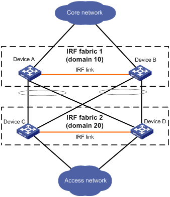

One IRF fabric forms one IRF domain. IRF uses IRF domain IDs to uniquely identify IRF fabrics and prevent IRF fabrics from interfering with one another.

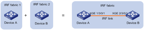

As shown in Figure 3, IRF fabric 1 contains Device A and Device B, and IRF fabric 2 contains Device C and Device D. Both fabrics use the LACP aggregate links between them for MAD. When a member device receives an extended LACPDU for MAD, it checks the domain ID to see whether the packet is from the local IRF fabric. Then, the device can handle the packet correctly.
Figure 3 A network that contains two IRF domains
IRF split

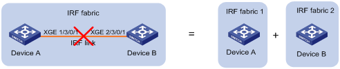

IRF split occurs when an IRF fabric breaks up into multiple IRF fabrics because of IRF link failures, as shown in Figure 4. The split IRF fabrics operate with the same IP address. IRF split causes routing and forwarding problems on the network. To quickly detect a multi-active collision, configure a minimum of one MAD mechanism (see "Configuring MAD").
Figure 4 IRF split
IRF merge
IRF merge occurs when two split IRF fabrics reunite or when two independent IRF fabrics are united, as shown in Figure 5.
Figure 5 IRF merge

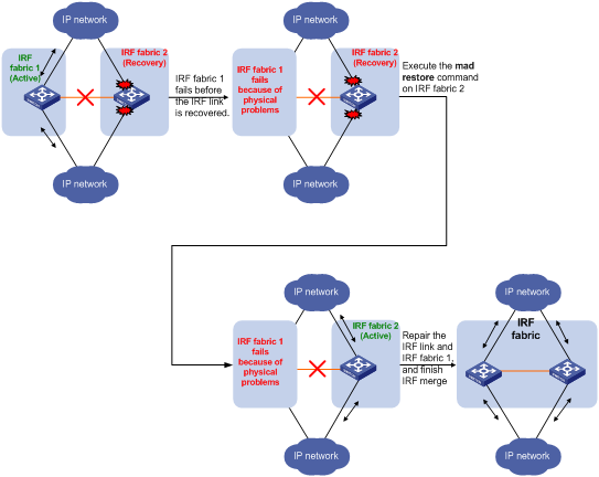

Failure recovery
To merge two split IRF fabrics, first repair the failed IRF link and remove the IRF link failure.
·     If the IRF fabric in Recovery state fails before the failure is recovered, repair the failed IRF fabric and the failed IRF link.
·     If the active IRF fabric fails before the failure is recovered, enable the inactive IRF fabric to take over the active IRF fabric. Then, recover the MAD failure.

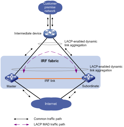

LACP MAD
As shown in Figure 6, LACP MAD has the following requirements:
·     Every IRF member must have a link with an intermediate device.
·     All the links form a dynamic link aggregation group.
·     The intermediate device must be a device that supports extended LACP for MAD.
The IRF member devices send extended LACPDUs that convey a domain ID and an active ID (the member ID of the master). The intermediate device transparently forwards the extended LACPDUs received from one member device to all the other member devices.
·     If the domain IDs and active IDs sent by all the member devices are the same, the IRF fabric is integrated.
·     If the extended LACPDUs convey the same domain ID but different active IDs, a split has occurred. LACP MAD handles this situation as described in "Collision handling."
Figure 6 LACP MAD scenario

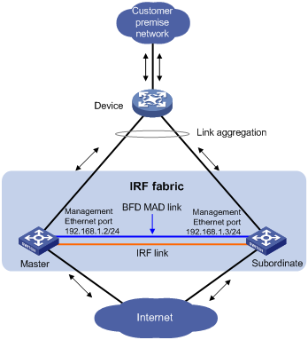

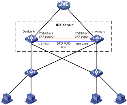

BFD MAD
On a two-chassis IRF fabric, BFD MAD can work with or without an intermediate device. On a three- or four-chassis IRF fabric, BFD MAD must work with an intermediate device.
BFD MAD can be used on common Ethernet ports or management Ethernet ports. If management Ethernet ports are used, you must select a management Ethernet port on the active MPU of each member device for BFD MAD links.
Figure 7 shows a typical BFD MAD application scenario on common Ethernet ports. Figure 8 shows a typical BFD MAD application scenario on management Ethernet ports.
To use BFD MAD:
·     Set up dedicated BFD MAD link between each pair of IRF members or between each IRF member and the intermediate device. Do not use the BFD MAD links for any other purposes.
·     If common Ethernet ports are used for BFD MAD links, you must configure BFD MAD on a VLAN interface. Perform the following tasks:
¡     Assign the ports connected by BFD MAD links to the same VLAN. The VLAN must be unique across MDCs and the network.
¡     Create a VLAN interface for the VLAN, and assign a MAD IP address to each member on the VLAN interface.
On the intermediate device (if any), you must create the VLAN and assign the ports on the BFD MAD links to the VLAN.
·     If management Ethernet ports are used for BFD MAD, assign a MAD IP address to each member device on the management Ethernet port of the global active MPU. On the intermediate device (if any), assign the ports on the BFD links to the same VLAN.
·     The MAD addresses identify the member devices and must belong to the same subnet.
·     Of all management Ethernet ports on an IRF fabric, only the management Ethernet port on the global active MPU is accessible.
Figure 7 BFD MAD scenario for common Ethernet ports
Figure 8 BFD MAD scenario for management Ethernet ports
With BFD MAD, the master attempts to establish BFD sessions with other member devices by using its MAD IP address as the source IP address.
·     If the IRF fabric is integrated, only the MAD IP address of the master takes effect. The master cannot establish a BFD session with any other member. If you execute the display bfd session command, the state of the BFD sessions is Down.
·     When the IRF fabric splits, the IP addresses of the masters in the split IRF fabrics take effect. The masters can establish a BFD session. If you execute the display bfd session command, the state of the BFD session between the two devices is Up.

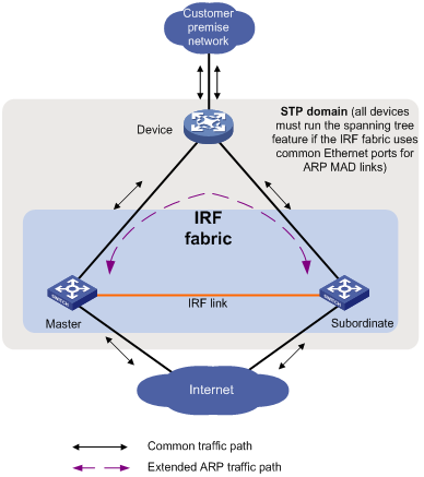

ARP MAD
ARP MAD detects multi-active collisions by using extended ARP packets that convey the IRF domain ID and the active ID (the member ID of the master).
You can use common or management Ethernet ports for ARP MAD.
If management Ethernet ports are used, ARP MAD must work with an intermediate device. Make sure the following requirements are met:
·     Connect a management Ethernet port on each member device to the intermediate device.
·     On the intermediate device, you must assign the ports used for ARP MAD to the same VLAN.
If common Ethernet ports are used, ARP MAD can work with or without an intermediate device. Make sure the following requirements are met:
·     If an intermediate device is used, connect each IRF member device to the intermediate device, as shown in Figure 9. Run the spanning tree feature between the IRF fabric and the intermediate device. In this situation, data links can be used.
·     If no intermediate device is used, connect each IRF member device to all other member devices. In this situation, IRF links cannot be used for ARP MAD.
Each IRF member compares the domain ID and the active ID in incoming extended ARP packets with its domain ID and active ID.
·     If the domain IDs are different, the extended ARP packet is from a different IRF fabric. The device does not continue to process the packet with the MAD mechanism.
·     If the domain IDs are the same, the device compares the active IDs.
¡     If the active IDs are different, the IRF fabric has split.
¡     If the active IDs are the same, the IRF fabric is integrated.
Figure 9 ARP MAD scenario

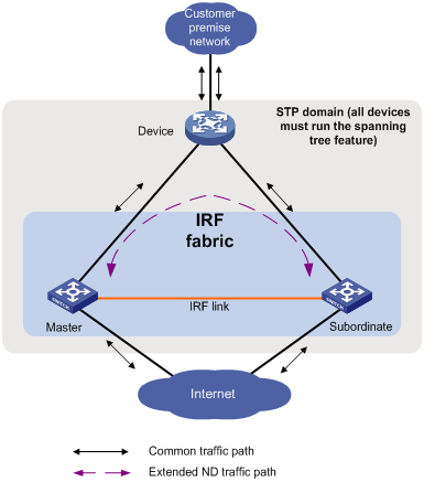

ND MAD
ND MAD detects multi-active collisions by using NS packets to transmit the IRF domain ID and the active ID (the member ID of the master).
You can set up ND MAD links between neighbor IRF member devices or between each IRF member device and an intermediate device (see Figure 10). If an intermediate device is used, you must also run the spanning tree protocol between the IRF fabric and the intermediate device.
Each IRF member device compares the domain ID and the active ID in incoming NS packets with its domain ID and active ID:
·     If the domain IDs are different, the NS packet is from a different IRF fabric. The device does not continue to process the packet with the MAD mechanism.
·     If the domain IDs are the same, the device compares the active IDs:
Figure 10 ND MAD scenario

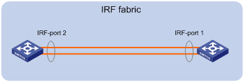

Binding physical interfaces to IRF ports
To establish an IRF connection between two devices, you must bind a minimum of one physical interface to IRF-port 1 on one device and to IRF-port 2 on the other.
You must configure IRF physical interfaces as Layer 2 interfaces. Layer 3 interfaces cannot be bound to IRF ports. To configure a physical interface as a Layer 2 interface, use the port link-mode bridge command. For more information about this command, see Interface Configuration Guide.
In standalone mode, IRF port binding operations do not affect the current configuration of the interface. However, when the operating mode changes to IRF mode, the default configuration is restored on the physical interface. You can only execute the following commands on the physical interface:
·     Basic Ethernet interface commands, including:
¡     description
¡     flow-interval
¡     shutdown
For more information about these commands, see Interface Command Reference.
·     LLDP commands, including:
¡     lldp admin-status
¡     lldp check-change-interval
¡     lldp enable
¡     lldp encapsulation snap
¡     lldp notification remote-change enable
¡     lldp tlv-enable
For more information about these commands, see Layer 2—LAN Switching Command Reference.
·     MAC address table commands, including the mac-address static source-check enable command. To ensure successful forwarding of Layer 3 traffic across member devices, use the undo mac-address static source-check enable command on each IRF physical interface. For information about this command, see Layer 2—LAN Switching Command Reference.
·     The port service-loopback group command, which assigns the physical interface to a service loopback group.
CAUTION
CAUTION:
Do not execute the port service-loopback group command on an IRF physical interface if that interface is the only member interface of an IRF port. Doing so will split the IRF fabric, because this command removes the binding between a physical interface and an IRF port. For more information about this command, see Layer 2—LAN Switching Command Reference.
To bind physical interfaces to IRF ports:
Step
Remarks
N/A
2.     Enter IRF port view.
irf-port irf-port-number
N/A
3.     Bind a physical interface to the IRF port.
port group interface interface-type interface-number [ mode { enhanced | extended } ]
By default, no physical interfaces are bound to an IRF port.
Repeat this step to assign multiple physical interfaces to the IRF port.
You can bind physical interfaces on different modules to the same IRF port.
In an S7503X IRF fabric, each IRF port can have a maximum of eight physical interfaces. In an IRF fabric formed by other S7500X switches, each IRF port can have a maximum of 16 physical interfaces.
Make sure the two ends of an IRF link use the same binding mode.
Make sure all physical interfaces bound to an IRF port use the same binding mode. In standalone mode, you can configure the IRF physical interfaces of an IRF port to use different binding modes. However, only one binding mode takes effect after the operating mode changes from standalone to IRF. The binding mode of the first IRF physical interface in the configuration file has the highest priority.
If the extended mode is used, an IRF fabric can contain a maximum of two chassis.
The extended mode is not supported by the IRF physical interfaces on the SA interface modules.

When you connect two neighboring IRF members, connect the physical interfaces of IRF-port 1 on one member to the physical interfaces of IRF-port 2 on the other (see Figure 11).
For example, you have four chassis: A, B, C, and D. IRF-port 1 and IRF-port 2 are represented by A1 and A2 on chassis A, represented by B1 and B2 on chassis B, and so on. To connect the four chassis into a ring topology of A-B-C-D(A), the IRF link cabling scheme must be one of the following:
·     A1-B2, B1-C2, C1-D2, and D1-A2.
·     A2-B1, B2-C1, C2-D1, and D2-A1.
Figure 11 Connecting IRF physical interfaces
Connect the devices into a daisy-chain topology or a ring topology. A ring topology is more reliable (see Figure 12). In ring topology, the failure of one IRF link does not cause the IRF fabric to split as in daisy-chain topology. Rather, the IRF fabric changes to a daisy-chain topology without interrupting network services.
To use the ring topology, you must have a minimum of three member devices.
IMPORTANT
IMPORTANT:
Optical transmission devices can be deployed to relay the IRF links. No other devices are allowed between neighboring IRF member devices.
Figure 12 Daisy-chain topology vs. ring topology

·     If LACP MAD, ARP MAD, or ND MAD runs between two IRF fabrics, assign each fabric a unique IRF domain ID. (For BFD MAD, this task is optional.)
·     An IRF fabric has only one IRF domain ID.

Configuring LACP MAD
When you use LACP MAD, follow these guidelines:
·     If the intermediate device is also an IRF fabric, assign the two IRF fabrics different domain IDs for correct split detection.
·     Use dynamic link aggregation mode. MAD is LACP dependent. Even though LACP MAD can be configured on both static and dynamic aggregate interfaces, it takes effect only on dynamic aggregate interfaces.
·     Configure link aggregation settings on the intermediate device.
To configure LACP MAD:
Step
Remarks
N/A
2.     Assign a domain ID to the IRF fabric.
irf domain domain-id
The default IRF domain ID is 0.
3.     Create an aggregate interface and enter aggregate interface view.
·     Enter Layer 2 aggregate interface view:
·     Enter Layer 3 aggregate interface view:
interface route-aggregation interface-number
Perform this step also on the intermediate device.
4.     Configure the aggregation group to operate in dynamic aggregation mode.
link-aggregation mode dynamic
By default, an aggregation group operates in static aggregation mode.
5.     Enable LACP MAD.
mad enable
By default, LACP MAD is disabled.
6.     Return to system view.
N/A
7.     Enter Ethernet interface view or interface range view.
·     Enter interface range view:
¡     Method 1:
interface range { interface-type interface-number [ to interface-type interface-number ] } &<1-
24>
¡     Method 2:
interface range name name [ interface { interface-type interface-number [ to interface-type interface-number ] } &<1-
24> ]
·     Enter Ethernet interface view:
To assign a range of ports to the aggregation group, enter interface range view.
To assign one port to the aggregation group, enter Ethernet interface view.
8.     Assign the Ethernet port or the range of Ethernet ports to the specified aggregation group.
port link-aggregation group group-id
Multichassis link aggregation is allowed.
Configuring BFD MAD
Before you configure BFD MAD, choose a BFD MAD link scheme as described in "BFD MAD."
As a best practice, connect the BFD MAD links after you finish the BFD MAD configuration.
Configuring BFD MAD that uses common Ethernet ports
Configure BFD MAD on a VLAN interface if you use common Ethernet ports for BFD MAD.
When you configure BFD MAD settings, follow these restrictions and guidelines:
Category
BFD MAD VLAN
·     Do not enable BFD MAD on VLAN-interface 1.
·     If you are using an intermediate device, perform the following tasks on both the IRF fabric and the intermediate device:
¡     Create a VLAN and VLAN interface for BFD MAD.
¡     Assign the ports of BFD MAD links to the BFD MAD VLAN.
·     Make sure the BFD MAD VLAN ID is unique across MDCs.
·     Make sure the IRF fabrics on the network use different BFD MAD VLANs.
·     Make sure the BFD MAD VLAN contains only ports on the BFD MAD links. Exclude a port from the BFD MAD VLAN if the port is not on the BFD MAD link. For example, if you have assigned the port to all VLANs by using the port trunk permit vlan all command, use the undo port trunk permit command to exclude the port from the BFD MAD VLAN.
BFD MAD VLAN and feature compatibility
Do not use the BFD MAD VLAN for any purpose other than configuring BFD MAD.
·     Use only the mad bfd enable and mad ip address commands on the BFD MAD-enabled VLAN interface. If you configure other features, both BFD MAD and other features on the interface might run incorrectly.
·     Disable the spanning tree feature on any Layer 2 Ethernet ports in the BFD MAD VLAN. The MAD feature is mutually exclusive with the spanning tree feature.
·     Do not bind a BFD MAD-enabled VLAN interface to a VPN instance. The MAD feature is mutually exclusive with VPN.
MAD IP address
·     To avoid network issues, only use the mad ip address command to configure IP addresses on the BFD MAD-enabled VLAN interface. Do not configure an IP address by using the ip address command or configure a VRRP virtual address on the BFD MAD-enabled VLAN interface.
·     Make sure all the MAD IP addresses are on the same subnet.
·     MAD IP addresses must be unique among all IP addresses on the IRF fabric.
BFD MAD and IRF link down report delay restrictions
Set the IRF link down report delay to 0 seconds to avoid unnecessary recalculations.
To configure BFD MAD that uses common Ethernet ports:
Step
Remarks
N/A
2.     (Optional.) Assign a domain ID to the IRF fabric.
By default, the domain ID of an IRF fabric is 0.
3.     Create a VLAN dedicated to BFD MAD.
vlan vlan-id
The default VLAN on the device is VLAN 1.
4.     Return to system view.
N/A
5.     Enter interface view or interface range view.
¡     Method 1:
24>
¡     Method 2:
24> ]
·     Enter interface view:
To assign a range of ports to the BFD MAD VLAN, enter interface range view.
To assign one port to the BFD MAD VLAN, enter Ethernet interface view.
6.     Assign the port or the range of ports to the BFD MAD VLAN.
·     Assign the ports to the VLAN as access ports:
port access vlan vlan-id
·     Assign the ports to the VLAN as trunk ports:
vlan-id
·     Assign the ports to the VLAN as hybrid ports:
port hybrid vlan
vlan-id { tagged | untagged }
The link type of BFD MAD ports can be access, trunk, or hybrid.
The default link type of a port is access.
7.     Return to system view.
N/A
8.     Enter VLAN interface view.
interface vlan-interface vlan-interface-id
N/A
9.     Enable BFD MAD.
mad bfd enable
By default, BFD MAD is disabled.
10.     Assign a MAD IP address to a member device on the VLAN interface.
mad ip address ip-address { mask | mask-length } member member-id
By default, no MAD IP address is configured for a member device on a VLAN interface.
Repeat this step to assign a MAD IP address to each member device on the VLAN interface.
Configuring BFD MAD that uses management Ethernet ports
When you configure BFD MAD that uses management Ethernet ports, follow these restrictions and guidelines:
Category
Management Ethernet ports for BFD MAD
If you are using an intermediate device, connect a management Ethernet port on each member device to the common Ethernet ports on the intermediate device. To avoid BFD MAD failure caused by an active/standby MPU switchover, connect the management Ethernet port on each MPU to the intermediate device.
BFD MAD VLAN
·     On the intermediate device (if any), create a VLAN for BFD MAD, and assign the ports used for BFD MAD to the VLAN. On the IRF fabric, you do not need to assign the management Ethernet ports to a VLAN.
·     As a best practice, do not configure other features on the VLAN used for BFD MAD.
·     Make sure the BFD MAD VLAN on the intermediate device contains only ports on the BFD MAD links.
BFD MAD-enabled management Ethernet port and feature compatibility
Do not bind a BFD MAD-enabled management Ethernet port to a VPN instance. The MAD feature is mutually exclusive with VPN.
MAD IP address
·     Use the mad ip address command instead of the ip address command to configure MAD IP addresses on the BFD MAD-enabled management Ethernet ports.
To configure BFD MAD that uses management Ethernet ports:
Step
Remarks
N/A
3.     Enter management Ethernet interface view.
interface M-GigabitEthernet interface-number
Enter the view of the management Ethernet port on the global active MPU to perform the subsequent steps.
4.     Enable BFD MAD.
mad bfd enable
5.     Assign a MAD IP address to each member device.
By default, no MAD IP address is assigned to any member device.
Configuring ARP MAD
Before you configure ARP MAD, choose an ARP MAD link scheme as described in "ARP MAD."
As a best practice, connect the ARP MAD links after you finish the ARP MAD configuration if you are not using existing data links as ARP MAD links.
Configuring ARP MAD that uses common Ethernet ports
Configure ARP MAD on a VLAN interface if you use common Ethernet ports for ARP MAD.
When you configure ARP MAD that uses common Ethernet ports, follow these restrictions and guidelines:
Category
ARP MAD VLAN
·     Do not enable ARP MAD on VLAN-interface 1.
·     If you are using an intermediate device, perform the following tasks:
¡     On both the IRF fabric and the intermediate device, create a VLAN for ARP MAD.
¡     On both the IRF fabric and the intermediate device, assign the ports of ARP MAD links to the ARP MAD VLAN.
¡     On the IRF fabric, create a VLAN interface for the ARP MAD VLAN.
·     Do not use the ARP MAD VLAN for any other purposes.
ARP MAD and feature configuration
If an intermediate device is used, make sure the following requirements are met:
·     Run the spanning tree feature between the IRF fabric and the intermediate device to ensure that there is only one ARP MAD link in forwarding state. For more information about the spanning tree feature and its configuration, see Layer 2—LAN Switching Configuration Guide.
·     Enable the IRF fabric to change its bridge MAC address as soon as the address owner leaves.

When you use ND MAD, follow these guidelines:
·     Do not configure ND MAD on VLAN-interface 1.
·     Do not use the VLAN configured for ND MAD for any other purposes.
·     If an intermediate device is used, you can use common data links as ND MAD links. If no intermediate device is used, set up dedicated ND MAD links between IRF member devices.
·     If an intermediate device is used, make sure the following requirements are met:
¡     Run the spanning tree feature between the IRF fabric and the intermediate device. Make sure there is only one ND MAD link in forwarding state. For more information about the spanning tree feature and its configuration, see Layer 2—LAN Switching Configuration Guide.
¡     Enable the IRF fabric to change its bridge MAC address as soon as the bridge MAC owner leaves.
¡     Create an ND MAD VLAN and assign the ports on the ND MAD links to the VLAN.
¡     If the intermediate device is also an IRF fabric, assign the two IRF fabrics different domain IDs for correct split detection.

Recovering an IRF fabric
After the failed IRF link between two split IRF fabrics is recovered, log in to the inactive IRF fabric to reboot its member devices if the system requires you to do so. After these member devices join the active IRF fabric as subordinate devices, the IRF merge is complete, as shown in Figure 13. The network interfaces that have been shut down by MAD automatically restore their original state.
CAUTION
CAUTION:
If you inadvertently reboot the active IRF fabric after the failed IRF link recovers, its member devices will join the inactive IRF fabric with their network interfaces shut down by MAD. To restore the original states of the network interfaces in the merged IRF fabric, use the mad restore command.
If the IRF auto-merge feature is enabled, the inactive IRF member devices will automatically reboot after the failed IRF link recovers and a manual reboot is typically not required.
Figure 13 Recovering the IRF fabric
If the active IRF fabric fails before the IRF link is recovered (see Figure 14), use the mad restore command on the inactive IRF fabric to recover the inactive IRF fabric. The command brings up all network interfaces that were shut down by MAD. After you repair the IRF link, the two parts merge into a unified IRF fabric.
Figure 14 Active IRF fabric fails before the IRF link is recovered
To manually recover an inactive IRF fabric:
Step
2.     Recover the inactive IRF fabric.
mad restore
After the IRF fabric is recovered, all network interfaces that have been shut down by MAD come up automatically.

3.     Configure LACP MAD:
# Assign domain ID 1 to the IRF fabric.
<Sysname> system-view
[Sysname] irf domain 1
# Create a dynamic aggregate interface and enable LACP MAD.
[Sysname] interface bridge-aggregation 2
[Sysname-Bridge-Aggregation2] link-aggregation mode dynamic
[Sysname-Bridge-Aggregation2] mad enable
You need to assign a domain ID (range: 0-4294967295)
[Current domain is: 1]:
The assigned domain ID is: 1
MAD LACP only enable on dynamic aggregation interface.
[Sysname-Bridge-Aggregation2] quit
# Assign GigabitEthernet 1/4/0/2 and GigabitEthernet 2/4/0/2 to the aggregate interface.
[Sysname] interface gigabitethernet 1/4/0/2
[Sysname-GigabitEthernet1/4/0/2] port link-aggregation group 2
[Sysname-GigabitEthernet1/4/0/2] quit
[Sysname] interface gigabitethernet 2/4/0/2
[Sysname-GigabitEthernet2/4/0/2] port link-aggregation group 2
4.     Configure Device C as the intermediate device:
CAUTION
CAUTION:
If the intermediate device is also an IRF fabric, assign the two IRF fabrics different domain IDs for correct split detection. False detection causes IRF split.
# Create a dynamic aggregate interface.
# Assign GigabitEthernet 4/0/1 and GigabitEthernet 4/0/2 to the aggregate interface.
[Sysname] interface gigabitethernet 4/0/1
[Sysname-GigabitEthernet4/0/1] port link-aggregation group 2
[Sysname-GigabitEthernet4/0/1] quit
[Sysname] interface gigabitethernet 4/0/2
[Sysname-GigabitEthernet4/0/2] port link-aggregation group 2
BFD MAD-enabled IRF configuration example for a two-chassis IRF fabric
Network requirements
As shown in Figure 16, set up an IRF fabric at the distribution layer of the network.
·     Configure BFD MAD in the IRF fabric and set up BFD MAD links between the member devices.
·     Disable the spanning tree feature on the ports used for BFD MAD, because the two features conflict with each other.
Figure 16 Network diagram
Configuration procedure
1.     Configure Device A:
# Assign member ID 1 to Device A, and bind Ten-GigabitEthernet 3/0/1 to IRF-port 2.
[Sysname] irf member 1
[Sysname] irf-port 2
[Sysname-irf-port2] port group interface ten-gigabitethernet 3/0/1
[Sysname-irf-port2] quit
# Save the configuration.
[Sysname] quit
<Sysname> save
# Enable IRF mode.
[Sysname] chassis convert mode irf
The device will switch to IRF mode and reboot.
You are recommended to save the current running configuration and specify the configuration file for the next startup. Continue? [Y/N]:y
Please input the file name(*.cfg)[flash:/startup.cfg]
(To leave the existing filename unchanged, press the enter key):
flash:/startup.cfg exists, overwrite? [Y/N]:y
Validating file. Please wait...
Saved the current configuration to mainboard device successfully.
Do you want to convert the content of the next startup configuration file flash:
/startup.cfg to make it available in IRF mode? [Y/N]:y
Now rebooting, please wait...
2.     Configure Device B:
# Assign member ID 2 to Device B, and bind Ten-GigabitEthernet 3/0/1 to IRF-port 1.
[Sysname] irf member 2
[Sysname] irf-port 1
[Sysname-irf-port1] port group interface ten-gigabitethernet 3/0/1
[Sysname-irf-port1] quit
[Sysname] quit
<Sysname> save
# Connect the two devices as shown in Figure 16.
# Enable IRF mode on Device B.
Device B and Device A form an IRF after Device B reboots.
3.     Configure BFD MAD:
# Set the IRF link down report delay to 0 seconds.
[Sysname] irf link-delay 0
# Create VLAN 3, and add GigabitEthernet 1/4/0/1 and GigabitEthernet 2/4/0/1 to VLAN 3.
[Sysname] vlan 3
[Sysname-vlan3] port gigabitethernet 1/4/0/1 gigabitethernet 2/4/0/1
[Sysname-vlan3] quit
# Create VLAN-interface 3, and configure a MAD IP address for each member device on the VLAN interface.
[Sysname] interface vlan-interface 3
[Sysname-Vlan-interface3] mad bfd enable
[Sysname-Vlan-interface3] mad ip address 192.168.2.1 24 member 1
[Sysname-Vlan-interface3] mad ip address 192.168.2.2 24 member 2
[Sysname-Vlan-interface3] quit
# Disable the spanning tree feature on GigabitEthernet 1/4/0/1 and GigabitEthernet 2/4/0/1.
[Sysname] interface gigabitethernet 1/4/0/1
[Sysname-gigabitethernet1/4/0/1] undo stp enable
[Sysname-gigabitethernet1/4/0/1] quit
[Sysname] interface gigabitethernet 2/4/0/1
[Sysname-gigabitethernet2/4/0/1] undo stp enable
ARP MAD-enabled IRF configuration example for a two-chassis IRF fabric
As shown in Figure 17, set up a two-chassis IRF fabric at the distribution layer of the enterprise network.
·     Configure ARP MAD for the IRF fabric and use Device C as an intermediate device. Device C can come from any vendor.
·     To prevent loops, enable the spanning tree feature between the IRF fabric and Device C.
Figure 17 Network diagram

ND MAD-enabled IRF configuration example for a two-chassis IRF fabric
As shown in Figure 18, set up a two-chassis IRF fabric at the distribution layer of the enterprise network.
·     Configure ND MAD for the IRF fabric and use Device C as an intermediate device. Device C can come from any vendor.
Figure 18 Network diagram

3.     Configure ND MAD on the IRF fabric:
# Enable the spanning tree feature globally, and map the ND MAD VLAN to MSTI 1 in the MST region.
[Sysname] stp global enable
[Sysname] stp region-configuration
[Sysname-mst-region] region-name ndmad
[Sysname-mst-region] instance 1 vlan 3
[Sysname-mst-region] active region-configuration
[Sysname-mst-region] quit
# Configure the bridge MAC address of the IRF fabric to change as soon as the bridge MAC owner leaves.
[Sysname] undo irf mac-address persistent
# Set the domain ID of the IRF fabric to 1.
# Create VLAN 3, and add GigabitEthernet 1/4/0/2 and GigabitEthernet 2/4/0/2 to VLAN 3.
[Sysname] vlan 3
[Sysname-vlan3] port gigabitethernet 1/4/0/2 gigabitethernet 2/4/0/2
# Create VLAN-interface 3, assign it an IP address, and enable ND MAD on the interface.
[Sysname-Vlan-interface3] ipv6 address 2001::1 64
[Sysname-Vlan-interface3] mad nd enable
CAUTION
CAUTION:
<DeviceC> system-view
[DeviceC] stp global enable
[DeviceC] stp region-configuration
[DeviceC-mst-region] region-name ndmad
[DeviceC-mst-region] instance 1 vlan 3
[DeviceC-mst-region] active region-configuration
[DeviceC-mst-region] quit
# Create VLAN 3, and add GigabitEthernet 4/0/1 and GigabitEthernet 4/0/2 to VLAN 3.
[DeviceC] vlan 3
[DeviceC-vlan3] port gigabitethernet 4/0/1 gigabitethernet 4/0/2
[DeviceC-vlan3] quit
Configuration example for restoring standalone mode
Break the IRF fabric in Figure 19, and change the operating mode of Device A and Device B from IRF to standalone.
Figure 19 Network diagram
1.     Identify the master.

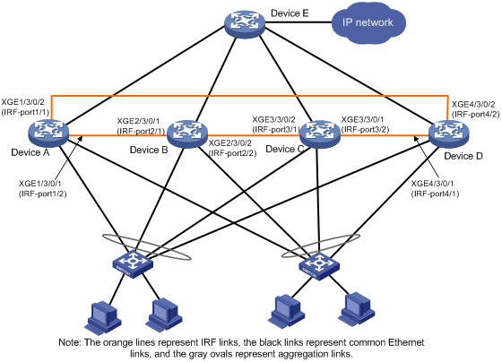

Four-chassis IRF fabric configuration example
As shown in Figure 21, set up a four-chassis IRF fabric at the access layer of the enterprise network.
Figure 20 Network diagram before IRF deployment
Figure 21 Network diagram after IRF deployment
IMPORTANT
IMPORTANT:
Between two neighboring IRF members, IRF links must be bound to IRF-port 1 on one member and to IRF-port 2 on the other.
# Assign member ID 1 and priority 12 to Device A.
[Sysname] irf priority 12
# Bind Ten-GigabitEthernet 3/0/2 and Ten-GigabitEthernet 3/0/1 to IRF-port 1 and IRF-port 2, respectively.
[Sysname-irf-port1] port group interface ten-gigabitethernet 3/0/2
[Sysname] save
# Enable IRF mode.
# Assign member ID 2 and member priority 26 to Device B.
[Sysname] irf priority 26
# Bind Ten-GigabitEthernet 3/0/1 and Ten-GigabitEthernet 3/0/2 to IRF-port 1 and IRF-port 2, respectively.
[Sysname-irf-port2] port group interface ten-gigabitethernet 3/0/2
[Sysname] save
# Connect Device B to Device A, as shown in Figure 21.
Device B and Device A form an IRF fabric after Device B reboots.
3.     Configure Device C:
# Assign member ID 3 and member priority 6 to Device C.
[Sysname] irf member 3
[Sysname] irf priority 6
[Sysname] save
# Connect Device C to Device B, as shown in Figure 21.
# Enable IRF mode on Device C.
Device C reboots to join the IRF fabric.
4.     Configure Device D:
# Assign member ID 4 and member priority 2 to Device D.
[Sysname] irf member 4
[Sysname] save
# Connect Device D to Device A and Device C, as shown in Figure 21.
# Enable IRF mode on Device D.
Device D reboots to join the IRF fabric. A four-chassis IRF fabric is formed.
5.     Configure LACP MAD, BFD MAD, ARP MAD, or ND MAD in the IRF fabric, as described in the previous configuration examples. (Details not shown.)

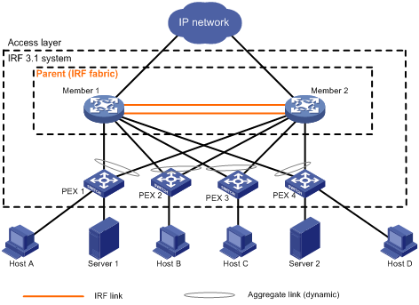

Overview

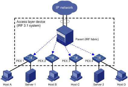

IRF 3.1 integrates multiple lower-layer devices with a higher-layer IRF fabric to provide high-density, low-cost connectivity at the access layer. IRF 3.1 is implemented based on IEEE 802.1BR.
In an IRF 3.1 system, the higher-layer IRF fabric is called the parent fabric and the lower-layer devices are called bridge port extenders (PEXs). You manage and configure the PEXs from the parent fabric as if they were interface modules on the parent fabric.
IRF 3.1 network model

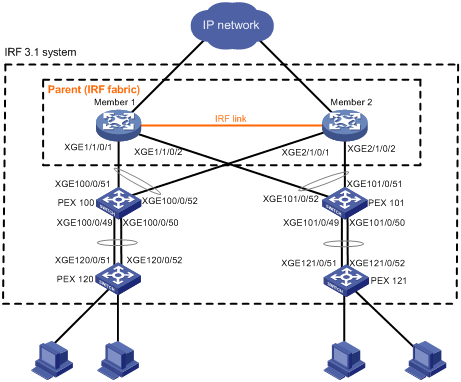

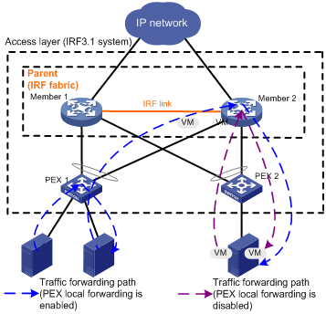

Typically, IRF 3.1 works at the access layer of data centers and large-scale enterprise networks. As shown in Figure 22, the access layer of a network is virtualized into an IRF 3.1 system. The system contains one parent fabric (a two-chassis IRF fabric) and multiple PEXs to provide connectivity for servers and hosts.
Figure 22 IRF 3.1 application scenario
IRF 3.1 benefits
IRF 3.1 provides the following benefits:
·     Simplified topology—Devices in an IRF 3.1 system appear as one node. For redundancy and load balancing, a downstream or upstream device can connect to the IRF 3.1 system through multichassis link aggregation. Together with link aggregation, IRF 3.1 creates a loop-free Layer 2 network. The spanning tree feature is not needed among devices in the IRF 3.1 system or on the link aggregations. IRF 3.1 also simplifies the Layer 3 network topology because it reduces the number of routing peers. The network topology does not change when a device is added to or removed from the IRF 3.1 system.
·     Single point of management—An IRF 3.1 system is accessible at a single IP address on the network. You can use this IP address to log in through any network port to manage all the devices in the system. For an SNMP NMS, an IRF 3.1 system is one managed network node.
·     Network scalability and resiliency—You can increase the number of ports in an IRF 3.1 system by adding PEXs without changing network topology.
·     High availability—Each PEX has multiple high-speed physical ports for uplink connectivity to the parent fabric. The links on these ports are aggregated and load balanced automatically.
·     Decreased TCO—IRF 3.1 decreases hardware investments and management costs. In an IRF 3.1 system, the parent fabric performs all the management and routing functions, and the PEXs only forward traffic. You can add low-performance devices as PEXs to an IRF 3.1 system for network scalability.
·     High software compatibility—The software versions of the parent fabric and PEXs are highly compatible. You can independently upgrade software for the parent and PEXs.

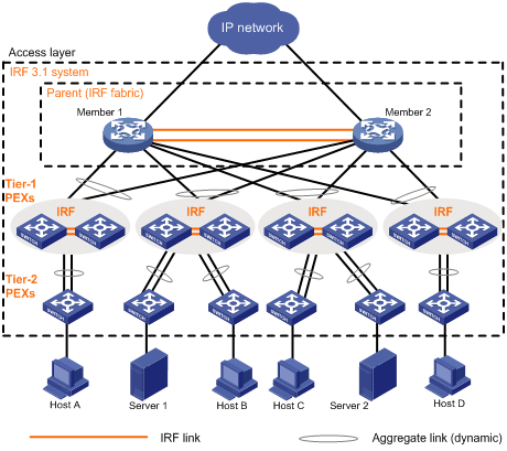

One tier of PEXs
As shown in Figure 23 and Figure 24, you can set up an IRF 3.1 system that contains one tier of PEXs. A PEX can be a single device or an IRF fabric. In this topology, connect each PEX to the parent fabric through a Layer 2 aggregate interface in dynamic aggregation mode.
In this topology, single-device PEXs and IRF-fabric PEXs can coexist. However, you cannot connect one PEX to another PEX.
Figure 23 IRF 3.1 network topology with one tier of PEXs (PEXs are single devices)
Figure 24 IRF 3.1 network topology with one tier of PEXs (PEXs are IRF fabrics)
Multiple tiers of PEXs
An IRF 3.1 system can have a maximum of two tiers of PEXs.
·     The PEXs directly attached to the parent fabric are tier-1 PEXs.
·     The PEXs attached to tier-1 PEXs are tier-2 PEXs.
In this topology, connect each PEX to the parent fabric or to an upper-tier PEX through a Layer 2 aggregate interface in dynamic aggregation mode.
As shown in Figure 25 and Figure 26, follow these guidelines when you connect PEXs:
·     A tier-1 PEX can be a single device or an IRF fabric. Single-device PEXs and IRF-fabric PEXs can coexist at tier 1.
·     A tier-2 PEX can only be a single device and can be attached to only one tier-1 PEX.
·     No links except cascade links are allowed between PEXs.
Figure 25 IRF 3.1 network topology with two tiers of PEXs (all PEXs are single devices)
Figure 26 IRF 3.1 network topology with two tiers of PEXs (tier-1 PEXs are IRF fabrics)

Data forwarding
When PEX local forwarding is enabled for a PEX, the PEX performs local forwarding for Layer 2 unicast packets with known MAC addresses. For other packets, the PEX forwards them to the parent fabric for processing.
When PEX local forwarding is disabled for a PEX, the PEX sends any incoming traffic to the parent fabric. The parent fabric makes forwarding decisions and sends the traffic to the outgoing interfaces (see Figure 27).
When the PEX receives a packet, it tags the packet with an E-tag. The E-tag carries the ECID of the interface that receives the packet. IRF 3.1 forwards the packet based on the ECID within the IRF 3.1 system. When the packet leaves the IRF 3.1 system, the E-tag is removed.
Figure 27 Data forwarding model

Enabling PEX local forwarding
This feature enables a PEX to perform local forwarding for Layer 2 unicast packets with known MAC addresses. The PEX reports other packets to the parent fabric for processing.
If PEX local forwarding is disabled for a PEX, the PEX sends any incoming traffic to the parent fabric. The parent fabric makes forwarding decisions and sends the traffic to the outgoing interfaces.
When you enable or disable PEX local forwarding on a cascade port, the PEX and its lower-tier PEXs will go offline and then come online again.
To enable PEX local forwarding for a PEX:
Step
Remarks
N/A
2.     Enter Layer 2 aggregate interface view of a cascade port.
N/A
3.     Enable PEX local forwarding.
pex local-forwarding
By default, PEX local forwarding is disabled.

IRF 3.1 configuration examples
Configuration example for setting up an IRF 3.1 system with two tiers of PEXs
As shown in Figure 28, set up an IRF 3.1 system that contains a two-chassis parent fabric, two S5130S-52S-HI tier-1 PEXs, and two S5560X-54C-EI tier-2 PEXs.
Figure 28 Network diagram
Setting up the parent fabric
# Set up a two-chassis IRF fabric with Member 1 and Member 2, as described in "Setting up an IRF fabric." (Details not shown.)
Configuring cascade ports for tier-1 PEXs on the parent fabric
# Enter the system view.
# Enable LLDP globally.
[Sysname] lldp global enable
# Create PEX group 1.
[Sysname] pex group 1
[Sysname-pex-group-1] quit
# Create Layer 2 aggregate interface Bridge-Aggregation 100. The aggregate interface will act as the cascade port to the PEX in chassis 100.
[Sysname] interface bridge-aggregation 100
# Enable PEX connection capability on Bridge-Aggregation 100 and assign Bridge-Aggregation 100 to PEX group 1.
[Sysname-Bridge-Aggregation100] pex-capability enable group 1
# Assign virtual chassis number 100 to the PEX.
[Sysname-Bridge-Aggregation100] pex associate chassis 100
[Sysname-Bridge-Aggregation100] quit
# Enable LLDP on Ten-GigabitEthernet 1/1/0/1 and Ten-GigabitEthernet 2/1/0/1 in interface range view, and assign the ports to aggregation group 100. The ports will act as the cascade member interfaces.
[Sysname] interface range ten-gigabitethernet 1/1/0/1 ten-gigabitethernet 2/1/0/1
[Sysname-if-range] lldp enable
[Sysname-if-range] port link-aggregation group 100
[Sysname-if-range] quit
# Create Layer 2 aggregate interface Bridge-Aggregation 101. The aggregate interface will act as the cascade port to the PEX in chassis 101.
[Sysname] interface bridge-aggregation 101
# Enable PEX connection capability on Bridge-Aggregation 101 and assign the interface to PEX group 1.
[Sysname-Bridge-Aggregation101] pex-capability enable group 1
# Assign virtual chassis number 101 to the PEX.
[Sysname-Bridge-Aggregation101] pex associate chassis 101
[Sysname-Bridge-Aggregation101] quit
# Enable LLDP on Ten-GigabitEthernet 1/1/0/2 and Ten-GigabitEthernet 2/1/0/2 in interface range view, and assign the ports to aggregation group 101. The ports will act as the cascade member interfaces.
[Sysname] interface range ten-gigabitethernet 1/1/0/2 ten-gigabitethernet 2/1/0/2
[Sysname-if-range] port link-aggregation group 101
Configuring tier-1 PEXs
Configure the devices to be used as PEXs to operate in auto or PEX mode. This section only describes configuration on PEX 100. Configure PEX 101 in the same way PEX 100 is configured.
·     Configure PEX 100 to operate in auto mode:
# Change the operating mode to auto. This task is optional. By default, the operating mode is auto.
[Sysname] pex system-working-mode auto
# Save the running configuration.
[Sysname] save
The current configuration will be written to the device. Are you sure? [Y/N]:y
# Select upstream member interfaces. In this example, Ten-GigabitEthernet 1/0/51 and Ten-GigabitEthernet 1/0/52 are used. For information about candidate upstream member interfaces, see the manuals for the PEX. (Details not shown.)
# Connect the upstream member interfaces on PEX 100 and the cascade member interfaces on the parent fabric. (Details not shown.)
·     Configure PEX 100 to operate in PEX mode:
# Change the operating mode to PEX.
[Sysname] pex system-working-mode pex
[Sysname] save
[Sysname] quit
# Reboot PEX 100.
<Sysname> reboot
# Display candidate upstream member interfaces.
[Sysname] probe
[Sysname-probe] display system internal pex upstreamport
IfIndex  Interface      LldpPktRcvd  Priority  PeerPort-PE-CSP-Addr
51       XGE1/0/51      No           255       ffff-ffff-ffff
52       XGE1/0/52      No           255       ffff-ffff-ffff
# Connect PEX 100 to the parent fabric, as shown in Figure 28. In this example, Ten-GigabitEthernet 1/0/51 and Ten-GigabitEthernet 1/0/52 are used as upstream member interfaces. (Details not shown.)
Configuring cascade ports for tier-2 PEXs on the parent fabric
# Create Layer 2 extended-link aggregate interface Bridge-Aggregation 120. The aggregate interface will act as the cascade port to the PEX in chassis 120.
[Sysname] interface bridge-aggregation 120 pex
[Sysname-Bridge-Aggregation120] quit
# Enable LLDP on Ten-GigabitEthernet 100/1/0/49 and Ten-GigabitEthernet 100/1/0/50 in interface range view, and assign the ports to aggregation group 120. The ports will act as the cascade member interfaces.
[Sysname] interface range ten-gigabitethernet 100/1/0/49 ten-gigabitethernet 100/1/0/50
[Sysname-if-range] port link-aggregation group 120
# Enable PEX connection capability on Bridge-Aggregation 120 and assign the interface to PEX group 1.
[Sysname-Bridge-Aggregation120] pex-capability enable group 1
# Assign virtual chassis number 120 to the PEX.
[Sysname-Bridge-Aggregation120] pex associate chassis 120
# Create Layer 2 extended-link aggregate interface Bridge-Aggregation 121. The aggregate interface will act as the cascade port to the PEX in chassis 121.
[Sysname] interface bridge-aggregation 121 pex
[Sysname-Bridge-Aggregation121] quit
# Enable LLDP on Ten-GigabitEthernet 101/1/0/49 and Ten-GigabitEthernet 101/1/0/50 in interface range view, and assign the ports to aggregation group 121. The ports will act as the cascade member interfaces.
[Sysname] interface range ten-gigabitethernet 101/1/0/49 ten-gigabitethernet 101/1/0/50
[Sysname-if-range] port link-aggregation group 121
# Enable PEX connection capability on Bridge-Aggregation 121 and assign the interface to PEX group 1.
[Sysname-Bridge-Aggregation121] pex-capability enable group 1
# Assign virtual chassis number 121 to the PEX.
[Sysname-Bridge-Aggregation121] pex associate chassis 121
Configuring tier-2 PEXs
# Configure the devices to be used as tier-2 PEXs to operate in auto or PEX mode. Configure PEX 120 and PEX 121 in the same way PEX 100 is configured. (Details not shown.)
# Display device information on the parent fabric. Verify that the output contains information about both the parent fabric and the PEXs.
<Sysname> display device
Slot   Type                  State    Subslot  Soft Ver            Patch Ver
1/0    NONE                  Absent   0        NONE                None
1/1    NONE                  Absent   0        NONE                None
1/2    LSQM2GT24PTSSC0       Normal   0        S7500X-7536         None
1/3    LSQM1MPUSA0           Master   0        S7500X-7536         None
1/4    NONE                  Fault    0        NONE                None
1/5    NONE                  Absent   0        NONE                None
1/6    NONE                  Absent   0        NONE                None
1/7    NONE                  Absent   0        NONE                None
PEX in virtual chassis 100:
1    S5130S-52S-HI    Master   0        S5130-HI6801L01      None
PEX in virtual chassis 101:
PEX in virtual chassis : 120
1    S5560X-54C-EI    Master   0        S5560X-1202          None
PEX in virtual chassis : 121
# Display PEX topology information.
<Sysname> display pex topology
Group  1
  Tier 1
    PEX 100 -----> Parent
    PEX 101 -----> Parent
  Tier 2
    PEX 120 -----> PEX 100
    PEX 121 -----> PEX 101
