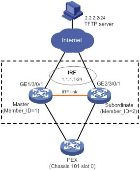

HTTP feature upgrade to an incompatible version
Upgrade requirements
As shown in Figure 2, the IRF fabric has two members. Each member has one MPU in slot 6 (active MPU) and one MPU in slot 7 (standby MPU).
Upgrade the HTTP feature from R0201 to R0202. The two versions are incompatible.
Figure 2 Network diagram
Upgrade procedure

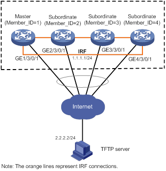

Examples of using issu commands for ISSU on a four-member IRF fabric
Feature upgrade to a compatible version
As shown in Figure 3, the IRF fabric has four members. Each member has one active MPU (slot 6), one standby MPU (slot 7), and one LPU (slot 3).
Upgrade a feature from soft-version1 to soft-version2 on the IRF fabric. The two versions are compatible.
Figure 3 Network diagram
Upgrade procedure

Feature upgrade to an incompatible version (upgrading one subordinate member first)
As shown in Figure 4, the IRF fabric has four members. Each member has one active MPU (slot 6), one standby MPU (slot 7), and one LPU (slot 3).
Upgrade a feature from soft-version1 to soft-version2 on the IRF fabric. The two versions are incompatible.
Figure 4 Network diagram
Upgrade procedure

# Identify the ISSU method and possible impact of the upgrade.
<Sysname> display version comp-matrix file feature flash:/soft-version2.bin
Verifying the file flash:/soft-version2.bin on chassis 1 slot 6...Don
e.
Feature image: flash:/soft-version2.bin
  Version:
  7.1.045-Release 7168
  Version compatibility list:
  Version dependency system list:
Upgrade Way: Incompatible upgrade.
The output shows that the two versions are incompatible. The cards will be rebooted for the upgrade.
# Disable automatic rollback.
<Sysname> system-view
[Sysname] issu rollback-timer 0
# Enable link-aggregation traffic redirection.
[Sysname] link-aggregation lacp traffic-redirect-notification enable
# Enable the IRF bridge MAC address to be permanent.
[Sysname] irf mac-address persistent always
# Set the physical state change suppression interval to 0 on the interfaces.
[Sysname] interface gigabitethernet1/3/0/1
[Sysname-GigabitEthernet1/3/0/1] link-delay 0 mode updown
[Sysname-GigabitEthernet1/3/0/1] quit
[Sysname] interface gigabitethernet2/3/0/1
[Sysname-GigabitEthernet2/3/0/1] link-delay 0 mode updown
[Sysname-GigabitEthernet2/3/0/1] quit
[Sysname] interface gigabitethernet3/3/0/1
[Sysname-GigabitEthernet3/3/0/1] link-delay 0 mode updown
[Sysname-GigabitEthernet3/3/0/1] quit
[Sysname] interface gigabitethernet4/3/0/1
[Sysname-GigabitEthernet4/3/0/1] link-delay 0 mode updown
[Sysname-GigabitEthernet4/3/0/1] quit
[Sysname] quit
# Upgrade the feature on subordinate member 2. After the upgrade, the subordinate member will leave the original IRF fabric and form a new IRF fabric by itself.
<Sysname> issu load file feature flash:/soft-version2.bin chassis 2
This operation will delete the rollback point information for the previous upgrade and maybe get unsaved configuration lost. Continue? [Y/N]:y
Verifying the file flash:/soft-version2.bin on chassis 1 slot 6...Done.
Copying file flash:/soft-version2.bin to chassis2#slot6#flash:/soft-version2.bin
...Done.
Verifying the file flash:/soft-version2.bin on chassis 2 slot 6...Done.
Copying file flash:/soft-version2.bin to chassis2#slot7#flash:/ soft-version2.bin
...Done.
Verifying the file flash:/soft-version2.bin on chassis 2 slot 7...Done.
Upgrade summary according to following table:
  Running Version             New Version
  Release 7168                  Release 7168
  Chassis   Slot              Upgrade Way
  2         3                 Reboot
  2         6                 Reboot
  2         7                 Reboot
Upgrading software images to incompatible versions. Continue? [Y/N]:y
# Perform a master/subordinate switchover to upgrade the original master and the other two subordinate members. The original master and the other two subordinate members will reboot and join the new IRF fabric.
<Sysname> issu run switchover
Copying file flash:/soft-version2.bin to chassis1#slot7#flash:/soft-version2.bin
...Done.
Verifying the file flash:/soft-version2.bin on chassis 1 slot 7...Done.
Copying file flash:/soft-version2.bin to chassis3#slot6#flash:/soft-version2.bin
...Done.
Verifying the file flash:/soft-version2.bin on chassis 3 slot 6...Done.
Copying file flash:/soft-version2.bin to chassis3#slot7#flash:/soft-version2.bin
...Done.
Verifying the file flash:/soft-version2.bin on chassis 3 slot 7...Done.
Copying file flash:/soft-version2.bin to chassis4#slot6#flash:/soft-version2.bin
...Done.
Verifying the file flash:/soft-version2.bin on chassis 4 slot 6...Done.
Copying file flash:/soft-version2.bin to chassis4#slot7#flash:/soft-version2.bin
...Done.
Verifying the file flash:/soft-version2.bin on chassis 4 slot 7...Done.
  1         3                 Reboot
  1         6                 Reboot
  1         7                 Reboot
  3         3                 Reboot
  3         6                 Reboot
  3         7                 Reboot
  4         3                 Reboot
  4         6                 Reboot
  4         7                 Reboot

Feature upgrade to an incompatible version (upgrading multiple subordinate members first)
As shown in Figure 5, the IRF fabric has four members. Each member has one active MPU (slot 6), one standby MPU (slot 7), and one LPU (slot 3).
Figure 5 Network diagram
Upgrade procedure
Verifying the file flash:/soft-version2.bin on chassis 2 slot 4...Done
  Version:

Examples of using issu commands for ISSU on an IRF 3 system
HTTP feature upgrade to a compatible version
As shown in Figure 6, the IRF 3 system contains a two-chassis parent fabric and an S5120HI PEX.
·           The PEX is connected to both the master and the subordinate member.
·           The master has two MPUs (active in slot 6 and standby in slot 7) and two LPUs (in slot 8 and slot 12).
·           The subordinate member has one MPU (in slot 6) and one LPU (in slot 8).
Upgrade the HTTP feature as follows:
·           From a0041 to the compatible version a0042 on the parent IRF fabric.
·           From d2402 to the compatible version d2403 on the PEX.
Figure 6 Network diagram
Upgrade procedure
As shown in Figure 7, the IRF 3 system contains a two-chassis parent fabric and an S5120HI PEX.
·           The master has two MPUs (active in slot 6 and standby in slot 7) and two LPUs (in slot 8 and in slot 12).
·           From a0041 to the incompatible version a0043 on the parent IRF fabric.
·           From d2402 to the incompatible version d2404 on the PEX.
Figure 7 Network diagram
Upgrade procedure

Examples of using install commands for ISSU on an IRF 3 system
HTTP feature upgrade example
As shown in Figure 10, the IRF 3 system contains a two-chassis parent fabric and an S5120HI PEX.
Figure 10 Network diagram
Upgrade procedure

<Sysname> install activate feature flash:/s5120hi-http-d2403.bin chassis 101 slot 0 test
Verifying the file flash:/http-a0042.bin on chassis 1 slot 6...Done.
  Demo 2402                   Demo 2403
  101       0                 Service Upgrade
Influenced service according to following table on chassis 101 slot 0:
         HTTP
The output shows that an incremental upgrade is recommended and the following items will be rebooted during the upgrade:
·           HTTP and CFA modules on the MPUs.
·           HTTP module on the LPU.
·           HTTP module on the PEX.
# Activate the new HTTP image to upgrade the HTTP feature on the MPU in slot 7 of chassis 1.
<Sysname> install activate feature flash:/http-a0042.bin chassis 1 slot 7
flash:/http-a0042.bin already exists on chassis 1 slot 7.
Overwrite it?[Y/N]:Y
Successfully copied flash:/http-a0042.bin to chassis1#slot7#flash:/http-a0042.bin.
Verifying the file flash:/http-a0042.bin on chassis 1 slot 7...Done.
  Alpha 0041                  Alpha 0042
  1         7                 Service Upgrade
Upgrading software images to compatible versions. Continue? [Y/N]:Y
This operation maybe take several minutes, please wait......................Done.
# Activate the new HTTP image to upgrade the HTTP feature on the MPU in slot 6 of chassis 1 and the LPUs in chassis 1.
<Sysname> install activate feature flash:/http-a0042.bin chassis 1 slot 6
flash:/http-a0042.bin already exists on chassis 1 slot 6.
Successfully copied flash:/http-a0042.bin to chassis1#slot6#flash:/http-a0042.bin.
  1         6                 Service Upgrade
  1         8                 Service Upgrade
  1         12                Service Upgrade
# Activate the new HTTP image to upgrade the HTTP feature on the cards in chassis 2.
<Sysname> install activate feature flash:/http-a0042.bin chassis 2 slot 6
flash:/http-a0042.bin already exists on chassis 2 slot 6.
Successfully copied flash:/http-a0042.bin to chassis2#slot6# flash:/http-a0042.bin.
Verifying the file flash:/http-a0042.bin on chassis 2 slot 6...Done.
  2         6                 Service Upgrade
  2         8                 Service Upgrade
# Display active software images.
<Sysname> display install active
Active packages on chassis 1 slot 6:
  flash:/boot-a0041.bin
  flash:/system-a0041.bin
Active packages on chassis 1 slot 7:
Active packages on chassis 1 slot 8:
Active packages on chassis 1 slot 12:
Active packages on chassis 2 slot 6:
Active packages on chassis 2 slot 8:
Active packages on chassis 101 slot 0:
  flash:/s5120hi-boot.bin
  flash:/s5120hi-system.bin
  flash:/s5120hi-http-d2402.bin
# Activate the new HTTP image to upgrade the HTTP feature on the PEX.
flash:/s5120hi-http-d2403.bin already exists on chassis 101 slot 0.
Successfully copied s5120hi-http-d2403.bin to chassis101#slot0#flash:/s5120hi-http-d2403.bin.
Verifying the file flash:/s5120hi-http-d2403.bin on chassis 1 slot 6...Done.
  Demo 2402                   Demo 2403
