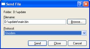

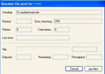

6.      On the configuration terminal, configure the communication settings and transfer the upgrade file. For more information, see "Using XMODEM to upgrade software through the console port."
In this example, the system sets the file as a main software image file when the file transfer is complete. The following is the sample output:
Waiting ...CCC
Download successfully!
47979456 bytes downloaded!
Updating File flash:/test.bin..............................................
..Done.

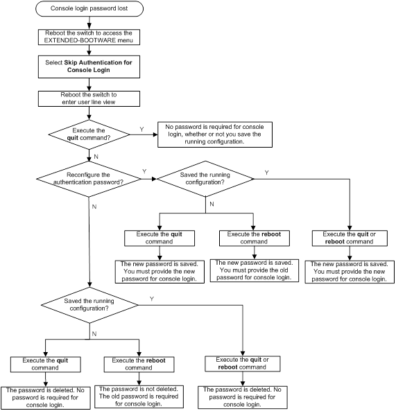

Skipping console login authentication
IMPORTANT
IMPORTANT:
·       To perform this task, make sure password recovery capability is enabled. If the capability is disabled, you cannot perform this task.
·       Perform this task only if the switch has one MPU. If the switch has two MPUs, you cannot skip console login authentication.
If you cannot remember the console login password, enter 8 in the EXTENDED-BOOTWARE menu, and then enter 1 or 0 in the EXTENDED-BOOTWARE menu. The switch will reboot and load the next-startup configuration file with the console login password ignored.
Enter your choice(0-9): 8
Clear Image Password Success!
After the switch starts up, you can configure a new console login password and save the running configuration so the new password takes effect (see Figure 1). If you do not configure a new console login password, the old password continues to take effect for the subsequent reboot.
Figure 1 Skipping console login authentication

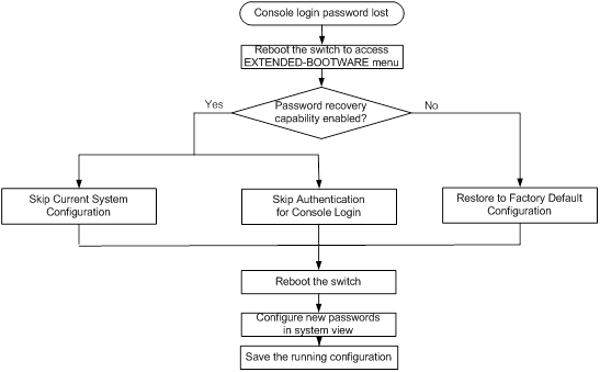

Disabling password recovery capability
Password recovery capability controls console user access to the device configuration and SDRAM from BootWare menus. This feature also decides the method for handling console login password loss (see Figure 2).
If password recovery capability is enabled, a console user can access the device configuration without authentication to configure new passwords.
If password recovery capability is disabled, console users must restore the factory-default configuration before they can configure new passwords. Restoring the factory-default configuration deletes the next-startup configuration files.
To enhance system security, disable password recovery capability.
Figure 2 Handling console login password loss
Table 14 summarizes options whose availability depends on the password recovery capability setting.
Table 14 BootWare options and password recovery capability compatibility matrix
BootWare menu option
Password recovery enabled
Password recovery disabled

4.      Change the baud rate of your terminal to match the setting on the Serial submenu. Then, close your connection to the device and reestablish the connection to make the terminal's baud rate change take effect. Finally, press Enter.
The Serial submenu appears again:
===========================<Enter Serial SubMenu>===========================
|Note:the operating device is flash                                        |
|<1> Download Image Program To SDRAM And Run                               |
|<2> Update Main Image File                                                |
|<3> Update Backup Image File                                              |
|<4> Download Files(*.*)                                                   |
|<5> Modify Serial Interface Parameter                                     |

6.      Select Transfer > Send File in the HyperTerminal window. In the dialog box that appears, click Browse to select the source file, and select Xmodem from the Protocol list. In this example, the file D:\update\main.bin is selected.
Figure 3 File transmission dialog box
7.      Click Send.
The following dialog box appears:
Figure 4 File transfer progress
After the file transfer is complete, the Serial submenu appears again. You can choose other options as required.
