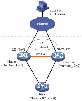

As shown in Figure 2, the IRF fabric has two members. Each member has one MPU in slot 6 (active MPU) and one MPU in slot 7 (standby MPU).
Upgrade the HTTP feature from R0201 to R0202. The two versions are incompatible.
Figure 2 Network diagram
Upgrade procedure

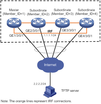

As shown in Figure 3, the IRF fabric has four members. Each member has one active MPU (slot 6), one standby MPU (slot 7), and one LPU (slot 3).
Upgrade a feature from soft-version1 to soft-version2 on the IRF fabric. The two versions are compatible.
Figure 3 Network diagram
Upgrade procedure

Feature upgrade to an incompatible version (upgrading one subordinate member first)
Upgrade requirements
As shown in Figure 4, the IRF fabric has four members. Each member has one active MPU (slot 6), one standby MPU (slot 7), and one LPU (slot 3).
Upgrade a feature from soft-version1 to soft-version2 on the IRF fabric. The two versions are incompatible.
Figure 4 Network diagram
Upgrade procedure

Feature upgrade to an incompatible version (upgrading multiple subordinate members first)
As shown in Figure 5, the IRF fabric has four members. Each member has one active MPU (slot 6), one standby MPU (slot 7), and one LPU (slot 3).
Figure 5 Network diagram
Upgrade procedure

Examples of using issu commands for ISSU on an IRF 3 system
HTTP feature upgrade to a compatible version
As shown in Figure 6, the IRF 3 system contains a two-chassis parent fabric and an S5120HI PEX.
·           The PEX is connected to both the master and the subordinate member.
·           The master has two MPUs (active in slot 6 and standby in slot 7) and two LPUs (in slot 8 and slot 12).
·           The subordinate member has one MPU (in slot 6) and one LPU (in slot 8).
Upgrade the HTTP feature as follows:
·           From a0041 to the compatible version a0042 on the parent IRF fabric.
·           From d2402 to the compatible version d2403 on the PEX.
Figure 6 Network diagram
Upgrade procedure

HTTP feature upgrade to an incompatible version
As shown in Figure 7, the IRF 3 system contains a two-chassis parent fabric and an S5120HI PEX.
·           The master has two MPUs (active in slot 6 and standby in slot 7) and two LPUs (in slot 8 and in slot 12).
·           From a0041 to the incompatible version a0043 on the parent IRF fabric.
·           From d2402 to the incompatible version d2404 on the PEX.
Figure 7 Network diagram

As shown in Figure 10, the IRF 3 system contains a two-chassis parent fabric and an S5120HI PEX.
Figure 10 Network diagram
Upgrade procedure

# Identify the recommended ISSU method for the upgrade and view the possible impact of the upgrade.
<Sysname> install activate feature flash:/http-a0042.bin chassis 1 slot 6 test
Verifying the file flash:/http-a0042.bin on chassis 1 slot 6...Done.
Upgrade summary according to following table:
  Running Version             New Version
  Alpha 0041                  Alpha 0042
  Chassis   Slot              Upgrade Way
  1         6                 Service Upgrade
  1         8                 Service Upgrade
  1         12                Service Upgrade
Influenced service according to following table on chassis 1 slot 6:
         HTTP      CFA
Influenced service according to following table on chassis 1 slot 8:
         HTTP
Influenced service according to following table on chassis 1 slot 12:
         HTTP
<Sysname> install activate feature flash:/http-a0042.bin chassis 1 slot 7 test
Verifying the file flash:/http-a0042.bin on chassis 1 slot 7...Done.
  1         7                Service Upgrade
Influenced service according to following table on chassis 1 slot 7:
         HTTP      CFA
<Sysname> install activate feature flash:/http-a0042.bin chassis 2 slot 6 test
Verifying the file flash:/http-a0042.bin on chassis 2 slot 6...Done.
  2         6                Service Upgrade
  2         8                 Service Upgrade
  2         12                Service Upgrade
Influenced service according to following table on chassis 2 slot 6:
         HTTP      CFA
Influenced service according to following table on chassis 2 slot 8:
         HTTP
<Sysname> install activate feature flash:/s5120hi-http-d2403.bin chassis 101 slot 0 test
  Demo 2402                   Demo 2403
  101       0                 Service Upgrade
Influenced service according to following table on chassis 101 slot 0:
         HTTP
The output shows that an incremental upgrade is recommended and the following items will be rebooted during the upgrade:
·           HTTP and CFA modules on the MPUs.
·           HTTP module on the LPU.
·           HTTP module on the PEX.
# Activate the new HTTP image to upgrade the HTTP feature on the MPU in slot 7 of chassis 1.
flash:/http-a0042.bin already exists on chassis 1 slot 7.
Overwrite it?[Y/N]:Y
Successfully copied flash:/http-a0042.bin to chassis1#slot7#flash:/http-a0042.bin.
  1         7                 Service Upgrade
Upgrading software images to compatible versions. Continue? [Y/N]:Y
This operation maybe take several minutes, please wait......................Done.
# Activate the new HTTP image to upgrade the HTTP feature on the MPU in slot 6 of chassis 1 and the LPUs in chassis 1.
flash:/http-a0042.bin already exists on chassis 1 slot 6.
Successfully copied flash:/http-a0042.bin to chassis1#slot6#flash:/http-a0042.bin.
  1         6                 Service Upgrade
  1         8                 Service Upgrade
# Activate the new HTTP image to upgrade the HTTP feature on the cards in chassis 2.
flash:/http-a0042.bin already exists on chassis 2 slot 6.
Successfully copied flash:/http-a0042.bin to chassis2#slot6# flash:/http-a0042.bin.
  2         6                 Service Upgrade
  2         8                 Service Upgrade
# Display active software images.
<Sysname> display install active
Active packages on chassis 1 slot 6:
  flash:/boot-a0041.bin
  flash:/system-a0041.bin
Active packages on chassis 1 slot 7:
Active packages on chassis 1 slot 8:
Active packages on chassis 1 slot 12:
Active packages on chassis 2 slot 6:
Active packages on chassis 2 slot 8:
Active packages on chassis 101 slot 0:
  flash:/s5120hi-boot.bin
  flash:/s5120hi-system.bin
  flash:/s5120hi-http-d2402.bin
# Activate the new HTTP image to upgrade the HTTP feature on the PEX.
flash:/s5120hi-http-d2403.bin already exists on chassis 101 slot 0.
Successfully copied s5120hi-http-d2403.bin to chassis101#slot0#flash:/s5120hi-http-d2403.bin.
Verifying the file flash:/s5120hi-http-d2403.bin on chassis 1 slot 6...Done.
  Demo 2402                   Demo 2403
  flash:/http-a0041.bin
