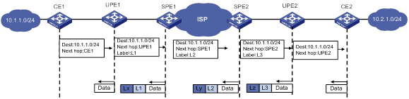

Hierarchy of VPN (HoVPN) divides PEs into underlayer PEs (UPEs) or user-end PEs, and superstratum PEs (SPEs) or service provider-end PEs. UPEs and SPEs form a hierarchical PE structure.
UPEs and SPEs together provide the functions of a conventional PE.
·     UPE—Provides user access. It maintains the routes of directly connected VPN sites. It does not maintain the routes of the remote sites in the VPN, or it only maintains their summary routes. A UPE assigns inner labels to the routes of its directly connected sites, and advertises the labels along with VPN routes to the SPE through MP-BGP.
·     SPE—Manages and advertises VPN routes. It maintains all the routes of the VPNs connected through UPEs, including the routes of both the local and remote sites. An SPE advertises routes along with labels to UPEs, including the default routes of VPN instances or summary routes and the routes permitted by the routing policy. By using routing policies, you can control which sites in a VPN can communicate with each other.
Figure 1 Routing process and label exchange for HoVPN

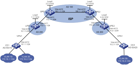

As shown in Figure 2, configure HoVPN and routing policies to allow communication between VLAN 10 and VLAN 30 and to disallow communication between VLAN 20 and VLAN 30.
Figure 2 Network diagram
Analysis
To ensure that VLAN 10 can communicate with VLAN 30 but VLAN 20 cannot, configure a routing policy on SPE 2 to advertise only the route of subnet 172.16.1.0/24 to UPE 2.

6.     Allow CE access to UPEs:
# On UPE 1, configure VPN instance vpn1 to allow CE 1 to access UPE 1.
[UPE1] ip vpn-instance vpn1
[UPE1-vpn-instance-vpn1] route-distinguisher 100:1
[UPE1-vpn-instance-vpn1] vpn-target 100:1 both
[UPE1-vpn-instance-vpn1] quit
[UPE1] interface vlan-interface 12
[UPE1-Vlan-interface12] ip binding vpn-instance vpn1
[UPE1-Vlan-interface12] ip address 10.1.1.2 24
[UPE1-Vlan-interface12] quit
# On UPE 1, establish an EBGP peer relationship with CE 1, and redistribute VPN routes into BGP.
[UPE1] bgp 200
[UPE1-bgp-default] ip vpn-instance vpn1
[UPE1-bgp-default-vpn1] peer 10.1.1.1 as-number 65410
[UPE1-bgp-default-vpn1] address-family ipv4 unicast
[UPE1-bgp-default-ipv4-vpn1] peer 10.1.1.1 enable
[UPE1-bgp-default-ipv4-vpn1] import-route direct
[UPE1-bgp-default-ipv4-vpn1] quit
[UPE1-bgp-default-vpn1] quit
# On CE 1, establish an EBGP peer relationship with UPE 1, and redistribute direct routes into BGP.
<CE1> system-view
[CE1] interface vlan-interface 12
[CE1-Vlan-interface12] ip address 10.1.1.1 255.255.255.0
[CE1-Vlan-interface12] quit
[CE1] bgp 65410
[CE1-bgp-default] peer 10.1.1.2 as-number 200
[CE1-bgp-default] address-family ipv4 unicast
[CE1-bgp-default-ipv4] peer 10.1.1.2 enable
[CE1-bgp-default-ipv4] import-route direct
[CE1-bgp-default-ipv4] quit
[CE1-bgp-default] quit
# On UPE 2, configure VPN instance vpn1 to allow CE 2 to access UPE 2.
[UPE2] ip vpn-instance vpn1
[UPE2-vpn-instance-vpn1] route-distinguisher 100:1
[UPE2-vpn-instance-vpn1] vpn-target 100:1 both
[UPE2-vpn-instance-vpn1] quit
[UPE2] interface vlan-interface 12
[UPE2-Vlan-interface12] ip binding vpn-instance vpn1
[UPE2-Vlan-interface12] ip address 10.2.1.2 24
[UPE2-Vlan-interface12] quit
# On UPE 2, establish an EBGP peer relationship with CE 2, and redistribute VPN routes into BGP.
[UPE2] bgp 200
[UPE2-bgp-default] ip vpn-instance vpn1
[UPE2-bgp-default-vpn1] peer 10.2.1.1 as-number 65420
[UPE2-bgp-default-vpn1] address-family ipv4 unicast
[UPE2-bgp-default-ipv4-vpn1] peer 10.2.1.1 enable
[UPE2-bgp-default-ipv4-vpn1] import-route direct
[UPE2-bgp-default-ipv4-vpn1] quit
[UPE2-bgp-default-vpn1] quit
# On CE 2, establish an EBGP peer relationship with UPE 2, and redistribute direct routes into BGP.
<CE2> system-view
[CE2] interface vlan-interface 12
[CE2-Vlan-interface12] ip address 10.2.1.1 255.255.255.0
[CE2-Vlan-interface12] quit
[CE2] bgp 65420
[CE2-bgp-default] peer 10.2.1.2 as-number 200
[CE2-bgp-default] address-family ipv4 unicast
[CE2-bgp-default-ipv4] peer 10.2.1.2 enable
[CE2-bgp-default-ipv4] import-route direct
[CE2-bgp-default-ipv4] quit
[CE2-bgp-default] quit
# Execute the display bgp peer ipv4 command on the UPEs and CEs to verify that a BGP peer relationship in Established state has been established between each UPE and its connected CE. (Details not shown.)
7.     Configure routing policies on SPEs to filter VPN routes to be advertised:
# On SPE 1, advertise the routes permitted by routing policy policy2 (the routes of CE 2) to UPE 1.
[SPE1] ip prefix-list list1 index 10 permit 172.16.3.0 24
[SPE1] route-policy policy2 permit node 0
[SPE1-route-policy-policy2-0] if-match ip address prefix-list list1
[SPE1-route-policy-policy2-0] quit
[SPE1] bgp 100
[SPE1-bgp-default] address-family vpnv4
[SPE1-bgp-default-vpnv4] peer 1.1.1.9 upe route-policy policy2 export
# On SPE 2, advertise the routes permitted by routing policy policy2 (the routes of subnet 172.16.1.0 connected to CE 1) to UPE 2.
[SPE2] ip prefix-list list1 index 10 permit 172.16.1.0 24
[SPE2] route-policy policy2 permit node 0
[SPE2-route-policy-policy2-0] if-match ip address prefix-list list1
[SPE2-route-policy-policy2-0] quit
[SPE2] bgp 100
[SPE2-bgp-default] address-family vpnv4
[SPE2-bgp-default-vpnv4] peer 4.4.4.9 upe route-policy policy2 export
# Verify that CE 1 has learned the route to subnet 172.16.3.0/24 of CE 2.
[CE1]display ip routing-table
Destinations : 25        Routes : 25
172.16.1.0/24       Direct 0    0            172.16.1.1      VLAN10
172.16.1.0/32       Direct 0    0            172.16.1.1      VLAN10
172.16.1.1/32       Direct 0    0            127.0.0.1       InLoop0
172.16.1.255/32     Direct 0    0            172.16.1.1      VLAN10
172.16.2.0/24       Direct 0    0            172.16.2.1      VLAN20
172.16.2.0/32       Direct 0    0            172.16.2.1      VLAN20
172.16.2.1/32       Direct 0    0            127.0.0.1       InLoop0
172.16.2.255/32     Direct 0    0            172.16.2.1      VLAN20
172.16.3.0/24       BGP    255  0            10.1.1.2        VLAN12
# Verify that CE 2 has learned the route to subnet 172.16.1.0/24 of CE 1, but it has not learned the route to 172.16.2.0/24 of CE 1.
[CE2] display ip routing-table
Destinations : 21        Routes : 21
172.16.1.0/24       BGP    255  0            10.2.1.2        VLAN13
172.16.3.0/24       Direct 0    0            172.16.3.1      VLAN30
172.16.3.0/32       Direct 0    0            172.16.3.1      VLAN30
172.16.3.1/32       Direct 0    0            127.0.0.1       InLoop0
172.16.3.255/32     Direct 0    0            172.16.3.1      VLAN30
# Verify that VLAN 10 and VLAN 30 can ping each other, and VLAN 20 and VLAN 30 cannot ping each other. (Details not shown.)
