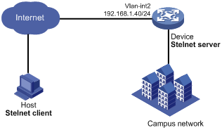

As shown in Figure 1:
·     The device uses local password authentication.
·     The login username and password are client001 and aabbcc, respectively.
Establish an Stelnet connection between the host and the device, so you can log in to the device to manage the campus network.
Figure 1 Network diagram

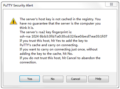

The dialog box shown in Figure 3 appears.
Figure 3 PuTTY Security Alert dialog box
5.     Click Yes.

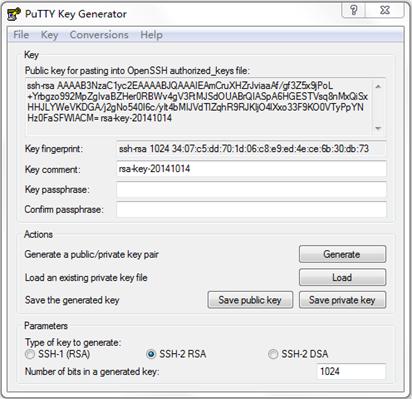

1.     Run PuTTYGen.exe, select SSH-2 RSA, and click Generate.
Figure 5 Generating a key pair on the client
2.     Continuously move the mouse and do not place the mouse over the green process bar shown in Figure 6. Otherwise, the process bar stops moving and the key pair generating process stops.
Figure 6 Generating process
3.     After the key pair is generated, click Save public key.
A file saving window appears.
4.     Select the saving directory (disk D in this example), enter a file name (key.pub in this example), and click Save.
Figure 7 Saving a key pair on the client

The dialog box shown in Figure 11 appears.
Figure 11 PuTTY Security Alert dialog box
10.     Click Yes.

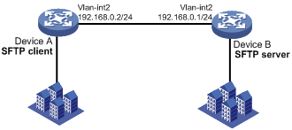

Example: Configuring SFTP with password-publickey authentication
As shown in Figure 13:
·     Device B uses password-publickey authentication and RSA public key algorithm.
Establish an SFTP connection between Device A and Device B, so you can log in to Device B to perform file and directory operations.
Import the client's host public key to the server to ensure correct format and content of the public key.
Figure 13 Network diagram

Configuring Device A as the SFTP client
# Create VLAN 2, and assign GigabitEthernet 3/0/2 to VLAN 2.
<DeviceA> system-view
[DeviceA] vlan 2
[DeviceA-vlan2] port gigabitethernet 3/0/2
[DeviceA-vlan2] quit
# Assign an IP address to VLAN-interface 2. The client uses this address to connect to the server.
[DeviceA] interface vlan-interface 2
[DeviceA-Vlan-interface2] ip address 192.168.0.2 255.255.255.0
[DeviceA-Vlan-interface2] quit
# Generate RSA key pairs.
[DeviceA] public-key local create rsa
The range of public key size is (512 ~ 2048).
If the key modulus is greater than 512, it will take a few minutes.
Press CTRL+C to abort.
Input the modulus length [default = 1024]:
Generating Keys...
Create the key pair successfully.
# Export the host public key to the file key.pub.
[DeviceA] public-key local export rsa ssh2 key.pub
[DeviceA] quit
Configuring Device B as the FTP server
<DeviceB> system-view
[DeviceB] vlan 2
[DeviceB-vlan2] port gigabitethernet 3/0/2
[DeviceB-vlan2] quit
[DeviceB] interface vlan-interface 2
[DeviceB-Vlan-interface2] ip address 192.168.0.1 255.255.255.0
[DeviceB-Vlan-interface2] quit
# Create a local user ftp.
[DeviceB] local-user ftp class manage
New local user added.
# Set the password to ftp in plain text for the local user ftp.
[DeviceB-luser-manage-ftp] password simple ftp
# Assign the user role network-admin to the local user ftp.
[DeviceB-luser-manage-ftp] authorization-attribute user-role network-admin
# Assign the working directory flash:/ to the local user ftp.
[DeviceB-luser-manage-ftp] authorization-attribute work-directory flash:/
# Authorize the local user ftp to use the FTP service.
[DeviceB-luser-manage-ftp] service-type ftp
[DeviceB-luser-manage-ftp] quit
# Enable the FTP server function.
[DeviceB] ftp server enable
[DeviceB] quit
Uploading the public key file from the FTP client
# Log in to the FTP server from Device A and upload the public key file key.pub to the server.
<DeviceA>ftp 192.168.0.1
Connected to 192.168.0.1 (192.168.0.1).
220 FTP service ready.
User (192.168.0.2:(none)): ftp
331 Password required for ftp.
Password:
230 User logged in.
Remote system type is UNIX.
Using binary mode to transfer files.
ftp> put flash:/key.pub
227 Entering Passive Mode (192,168,0,1,41,116)
150 Accepted data connection
226 File successfully transferred
301 bytes sent in 0.000 seconds (1.05 Mbytes/s)
ftp> quit
221-Goodbye. You uploaded 1 and downloaded 0 kbytes.
221 Logout.
Configuring Device B as the SFTP server
[DeviceB] public-key local create rsa
Generating Keys...
# Generate a DSA key pair.
[DeviceB] public-key local create dsa
Generating Keys...
# Generate an ECDSA key pair.
[DeviceB] public-key local create ecdsa
Generating Keys...
# Enable the SFTP server function.
[DeviceB] sftp server enable
# Import the client's public key from the file key.pub, and name the public key devicekey.
[DeviceB] public-key peer devicekey import sshkey key.pub
# Create an SSH user client001. Specify the authentication type as password-publickey for the user, and assign the public key devicekey to the user.
[DeviceB] ssh user client001 service-type sftp authentication-type password-publickey assign publickey devicekey
# Create a local user client001.
[DeviceB] local-user client001 class manage
# Set the password to aabbcc in plain text for the local user client001.
[DeviceB-luser-manage-client001] password simple aabbcc
# Authorize the local user client001 to use the SSH service.
[DeviceB-luser-manage-client001] service-type ssh
# Assign the user role network-admin and working directory flash:/ to the local user client001.
[DeviceB-luser-manage-client001] authorization-attribute user-role network-admin work-directory flash:/
[DeviceB-luser-manage-client001] quit
1.     Verify that you can log in to the SFTP server from the SFTP client.
<DeviceA >sftp 192.168.0.1 identity-key rsa
Username: client001
Connecting to 192.168.0.1 port 22.
The server is not authenticated. Continue? [Y/N]:y
Do you want to save the server public key? [Y/N]:n
[email protected]'s password:
After you enter the password, you are placed in SFTP client view.
sftp>
2.     Verify that you can perform file and directory operations after logging in to the SFTP server:
# Display files under the current directory of the server, delete the file z, and verify the result.
sftp> dir -l
-rwxrwxrwx    1 1        1              1759 Aug 23 06:52 config.cfg
-rw-rw----    1 1        1               301 Aug  7 16:52 key.pub
-rwxrwxrwx    1 1        1                0 Sep 01 06:22 new
-rwxrwxrwx    1 1        1              225 Sep 01 06:55 pub
-rwxrwxrwx    1 1        1              225 Aug 24 08:01 pubkey2
-rwxrwxrwx    1 1        1                0 Sep 01 08:00 z
sftp> delete z
Removing /z
sftp> dir -l
# Add a directory new1 and verify the result.
sftp> mkdir new1
sftp> dir -l
drwxrwxrwx    1 1        1                0 Sep 02 06:30 new1
# Rename directory new1 to new2 and verify the result.
sftp> rename new1 new2
sftp> dir -l
drwxrwxrwx    1 1        1                0 Sep 02 06:33 new2
# Download the file pubkey2 from the server and change the name to public.
sftp> get pubkey2 public
Fetching /pubkey2 to public
/public                                       100%  301     0.3KB/s   00:00
# Upload the local file public to the server, and verify the result.
sftp> put public
Uploading public to /public
sftp> dir -l
-rwxrwxrwx    1 1        1              301 Jul 30 16:21 public
sftp>
# Exit SFTP client view.
sftp> quit
<DeviceA>

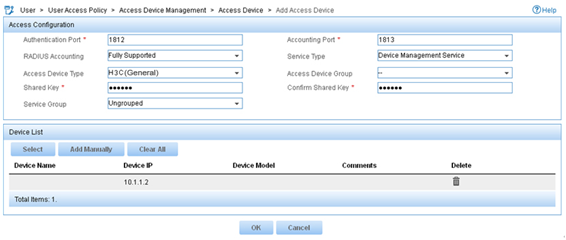

5.     Configure an access device, as shown in Figure 15:
a.     Set the ports for authentication and accounting to 1812 and 1813, respectively.
b.     Select the service type Device Management Service.
c.     Select the access device type H3C(General).
d.     Set the shared key to expert for secure RADIUS communication.
e.     Select Device B from the device list or manually add Device B. (The IP address of Device B is 10.1.1.2).
f.     Use the default settings for other parameters.
6.     Click OK.
Figure 15 Adding Device B as an access device

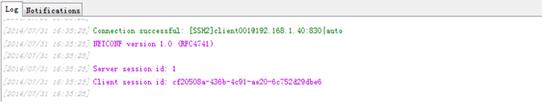

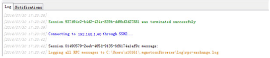

This example uses NetConf Browser 2013 (version 3.1).
To verify that you can log in to the NETCONF-over-SSH server and perform NETCONF operations:

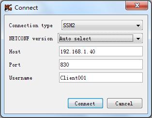

1.     Launch NetConf Browser 2013 (version 3.1).
2.     Select File > Connect… from the menu.
a.     Select Auto select from the NETCONF version list.
b.     Enter 192.168.1.40 in the Host field.
c.     Enter 830 in the Port field.
d.     Enter Client001 in the Username field.
3.     Click Connect.
Figure 18 Connecting to the device
4.     Enter the password aabbcc, and click OK.
The page shown in Figure 20 appears, and you enter the NETCONF configuration interface.
Figure 19 Entering the password
Figure 20 Logging in to the device
5.     Enter <get-sessions/> in the Command XML area.
The following message is displayed in the Output XML area.
