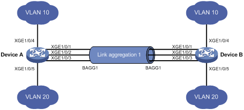

Example: Configuring Layer 2 link aggregation
As shown in Figure 1, both Device A and Device B forward traffic from VLAN 10 and VLAN 20.
Configure link aggregation on Device A and Device B to meet the following requirements:
·     VLAN 10 on Device A can communicate with VLAN 10 on Device B.
·     VLAN 20 on Device A can communicate with VLAN 20 on Device B.
Figure 1 Network diagram

1.     Configure Device A:
# Create VLAN 10, and assign port Ten-GigabitEthernet 1/0/4 to VLAN 10.
<DeviceA> system-view
[DeviceA] vlan 10
[DeviceA-vlan10] port ten-gigabitethernet 1/0/4
[DeviceA-vlan10] quit
# Create VLAN 20, and assign port Ten-GigabitEthernet 1/0/5 to VLAN 20.
[DeviceA] vlan 20
[DeviceA-vlan20] port ten-gigabitethernet 1/0/5
[DeviceA-vlan20] quit
# Create Layer 2 aggregate interface Bridge-aggregation 1. Use one of the following methods as needed.
¡     Use the static aggregation mode to create Layer 2 aggregate interface Bridge-aggregation 1.
[DeviceA] interface bridge-aggregation 1
[DeviceA-Bridge-Aggregation1] quit
¡     Use the dynamic aggregation mode to create Layer 2 aggregate interface Bridge-aggregation 1.
[DeviceA-Bridge-Aggregation1] link-aggregation mode dynamic
# Assign ports Ten-GigabitEthernet 1/0/1 through Ten-GigabitEthernet 1/0/3 to aggregation group 1.
[DeviceA] interface range ten-gigabitethernet 1/0/1 to ten-gigabitethernet 1/0/3
[DeviceA-if-range] port link-aggregation group 1
[DeviceA-if-range] quit
# Configure Layer 2 aggregate interface Bridge-aggregation 1 as a trunk port.
[DeviceA-Bridge-Aggregation1] port link-type trunk
 Configuring Ten-GigabitEthernet1/0/1 done.
 Configuring Ten-GigabitEthernet1/0/2 done.
 Configuring Ten-GigabitEthernet1/0/3 done.
# Assign the aggregate interface to VLANs 10 and 20.
[DeviceA-Bridge-Aggregation1] port trunk permit vlan 10 20
2.     Configure Device B in the same way Device A is configured. (Details not shown.)

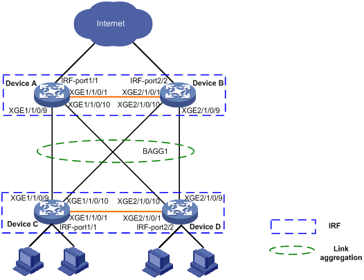

Example: Configuring Layer 2 link aggregation in an IRF fabric
On the network as shown in Figure 2, perform the following tasks:
·     Set up a two-chassis IRF fabric at the access layer and a two-chassis IRF fabric at the distribution layer of the enterprise network.
·     Configure link aggregation to improve the reliability of the links between the access-layer and distribution-layer IRF fabrics and implement load sharing.
·     Run LACP MAD on the two IRF fabrics to detect IRF split.
Figure 2 Network diagram

1.     Configure IRF on Device A:
# Shut down ports Ten-GigabitEthernet 1/0/1 through Ten-GigabitEthernet 1/0/4.
# Assign member ID 1 to Device A.
[DeviceA] irf member 1
# Bind Ten-GigabitEthernet 1/0/1 to IRF port 1.
[DeviceA] irf-port 1
[DeviceA-irf-port1] port group interface ten-gigabitethernet 1/0/1
[DeviceA-irf-port1] quit
# Save the configuration
[DeviceA] quit
<DeviceA> save
# Enable IRF mode.
[DeviceA] chassis convert mode irf
The device will switch to IRF mode and reboot.
You are recommended to save the current running configuration and specify the configuration file for the next startup. Continue? [Y/N]:y
Do you want to convert the content of the next startup configuration file flash:/startup.cfg to make it available in IRF mode? [Y/N]:y
 Please wait...
 Saving the converted configuration file to the main board succeeded.
Slot 1:
 Saving the converted configuration file succeeded.
 Now rebooting, please wait...
After the reboot, Device A forms a one-chassis IRF fabric. The interface number of Ten-GigabitEthernet 1/0/1 changes to Ten-GigabitEthernet 1/1/0/1.
2.     Configure IRF on Device B:
# Assign member ID 2 to Device B.
<DeviceB> system-view
[DeviceB] irf member 2
# Bind Ten-Gigabitethernet 1/0/1 to IRF port 2.
[Sysname] irf-port 2
[DeviceB-irf-port2] port group interface ten-gigabitethernet 1/0/1
[DeviceB-irf-port2] quit
# Save the configuration.
[DeviceB] quit
<DeviceB> save
# Connect the Device A and Device B as shown in Figure 2.
# Enable IRF mode.
[DeviceB] chassis convert mode irf
Please wait...
Slot 1:
After the reboot, Device B forms a two-chassis IRF fabric with Device A. The interface number of Ten-GigabitEthernet 1/0/1 changes to Ten-GigabitEthernet 2/1/0/1.
3.     Configure a Layer 2 aggregation group on Device A:
# Create Layer 2 aggregate interface Bridge-Aggregation 1, and configure the link aggregation mode as dynamic.
# Configure Layer 2 aggregation group 1 to load share packets based on source IP addresses.
[DeviceA-Bridge-Aggregation1] link-aggregation load-sharing mode source-ip
# Assign ports Ten-GigabitEthernet 1/1/0/9, Ten-GigabitEthernet 1/1/0/10, Ten-GigabitEthernet 2/1/0/9, and Ten-GigabitEthernet 2/1/0/10 to link aggregation group 1.
[DeviceA] interface range ten-gigabitethernet 1/1/0/9 to ten-gigabitethernet 1/1/0/10
ten-gigabitethernet 2/1/0/9 to ten-gigabitethernet 2/1/0/10
[DeviceA]
4.     Configure LACP MAD on the IRF fabric:
# Set the domain ID of the IRF fabric to 1.
[DeviceA] irf domain 1
# Enable LACP MAD on Bridge-Aggregation 1.
[DeviceA] interface Bridge-Aggregation 1
[DeviceA-Bridge-Aggregation1] mad enable
You need to assign a domain ID (range: 0-4294967295)
[Current domain is: 1]:
The assigned domain ID is: 1
MAD LACP only enable on dynamic aggregation interface.
5.     Configure IRF on Device C in the same way IRF is configured on Device A. (Details not shown.)
6.     Configure IRF on Device D in the same way IRF is configured on Device B. (Details not shown.)
Device C and Device D perform master election, and the one that has lost the election reboots to form an IRF fabric with the master. In this example, Device C reboots.
7.     Configure a Layer 2 dynamic aggregation group Bridge-Aggregation 1 on Device C in the same way Bridge-Aggregation 1 is configured on Device A. (Details not shown.)
8.     Configure LACP MAD on the IRF fabric:
# Set the domain ID of the IRF fabric to 2.
<DeviceC> system-view
[DeviceC] irf domain 2
[DeviceC] interface Bridge-Aggregation 1
[DeviceC-Bridge-Aggregation1] mad enable
[Current domain is: 2]:
The assigned domain ID is: 2
# Display the information about the link aggregation groups on Device A.
[DeviceA] display link-aggregation verbose
Loadsharing Type: Shar -- Loadsharing, NonS -- Non-Loadsharing
Port Status: S -- Selected, U -- Unselected, I -- Individual
Port: A -- Auto port, M -- Management port, R -- Reference port
Flags:  A -- LACP_Activity, B -- LACP_Timeout, C -- Aggregation,
        G -- Defaulted, H -- Expired
Aggregate Interface: Bridge-Aggregation1
Aggregation Mode: Dynamic
Management VLANs: None
System ID: 0x8000, 00a0-fc00-5800
Local:
  Port                Status   Priority Index    Oper-Key               Flag
  XGE1/0/9            S        32768    10       1                      {ACG}
  XGE1/0/10           S        32768    11       1                      {ACG}
  XGE2/0/9            S        32768    138      1                      {ACG}
  XGE2/0/10           S        32768    139      1                      {ACG}
Remote:
  Actor               Priority Index    Oper-Key SystemID               Flag
  XGE1/0/9            32768    0        0        0x8000, 0000-0000-0000 {EF}
  XGE1/0/10           32768    0        0        0x8000, 0000-0000-0000 {EF}
  XGE2/0/9            32768    0        0        0x8000, 0000-0000-0000 {EF}
  XGE2/0/10           32768    0        0        0x8000, 0000-0000-0000 {EF}
The output shows that the local member ports and the corresponding peer member ports are all Selected. In the dynamic link aggregation mode, each local member port and its peer member port have the same Selected state through exchanging LACPDUs. The user data traffic can be forwarded correctly.
# Display the load sharing mode of Layer 2 aggregation group 1 on Device A.
[DeviceA] display link-aggregation load-sharing mode interface Bridge-Aggregation 1
Bridge-Aggregation1 load-sharing mode:
source-ip address
The output shows that Layer 2 aggregation group 1 load shares packets based on source IP addresses.
# Shut down physical IRF port Ten-GigabitEthernet 2/0/1 on Device B.
A log message appears on Device A.
[DeviceA]%Jul  9 16:52:41:734 2016 H3C STM/3/STM_LINK_DOWN: -MDC=1; IRF port 1 went down.
%Jul  9 16:52:41:800 2016 H3C IFNET/3/PHY_UPDOWN: -MDC=1; Physical state on the interface Ten-GigabitEthernet1/0/1 changed to down.
%Jul  9 16:52:41:854 2016 H3C IFNET/5/LINK_UPDOWN: -MDC=1; Line protocol state on the interface Ten-GigabitEthernet1/0/1 changed to down.
%Jul  9 16:52:41:867 2016 H3C DEV/3/BOARD_REMOVED: -MDC=1; Board was removed from slot 2, type is Simware.
The output shows that IRF split occurs on the distribution layer because Ten-GigabitEthernet 2/1/0/1 that is bound to IRF port 2 is physically down.
