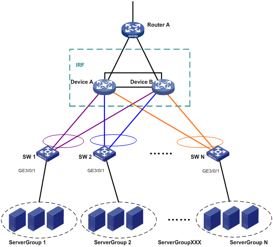

Introduction

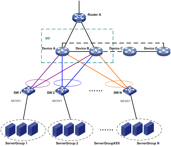

This document provides examples for deploying two-chassis IRF fabrics and four-chassis IRF fabrics.
This document assumes that you have basic knowledge of H3C IRF.

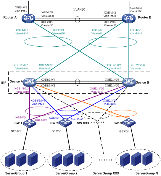

Example: Setting up a LACP MAD-enabled two-chassis IRF fabric
As shown in Figure 1:
·     Set up a two-chassis IRF fabric at the core layer of the network.
·     Use multichassis link aggregations to connect the IRF fabric to the access switches and the upstream egress routers.
·     Use LACP MAD to detect IRF split.
·     Run OSPF between the IRF fabric and the egress routers.
Figure 1 LACP MAD-enabled two-chassis IRF fabric
Table 1 VLAN and IP address assignment
Device
VLAN interface
IP address
Router A
VLAN-interface 30
172.24.2.2/24
Router A
VLAN-interface 40
172.24.40.2/24
Router A
VLAN-interface 50
172.24.1.2/24
Router B
VLAN-interface 30
172.24.2.3/24
Router B
VLAN-interface 41
172.24.41.3/24
Router B
VLAN-interface 50
172.24.4.2/24
IRF fabric
VLAN-interface 10
172.24.10.254/24
IRF fabric
VLAN-interface 20
172.24.20.254/24
IRF fabric
VLAN-interface 40
172.24.40.254/24
IRF fabric
VLAN-interface 41
172.24.41.254/24
Analysis
For LACP MAD to run correctly, ensure that the intermediate device supports extended LACPDUs for LACP MAD.
To avoid single points of failure, use multichassis link aggregations to connect the IRF fabric to the downstream and upstream devices.
You do not need to run LACP MAD on all link aggregations. You can detect IRF split effectively by running LACP MAD on one dynamic link aggregation.
Software versions used
This configuration example was created and verified on S10500-CMW710-R7536P05.
When you configure LACP MAD on a link aggregation, follow these restrictions and guidelines:
·     The link aggregation must use dynamic aggregation mode.
·     The link aggregation must have a minimum of one member link from each member chassis.
·     If the intermediate device is also an IRF fabric, you must assign the two IRF fabrics different domain IDs for correct split detection.
Procedures
Setting up the IRF fabric
1.     Configure Device A:
# Assign member ID 1 to Device A.
<DeviceA> system-view
[DeviceA] irf member 1
# Bind Ten-GigabitEthernet 3/0/1 and Ten-GigabitEthernet 3/0/2 to IRF-port 2.
[DeviceA] irf-port 2
[DeviceA-irf-port2] port group interface ten-gigabitethernet 3/0/1
[DeviceA-irf-port2] port group interface ten-gigabitethernet 3/0/2
[DeviceA-irf-port2] quit
# Save the running configuration to the main next-startup configuration file before changing the operating mode to IRF.
IMPORTANT
IMPORTANT:
The mode change requires a system reboot, which causes all unsaved settings to be lost.
[DeviceA] save
# Enable IRF mode.
[DeviceA] chassis convert mode irf
The device will switch to IRF mode and reboot.
You are recommended to save the current running configuration and specify the co
nfiguration file for the next startup. Continue? [Y/N]:y
 Do you want to convert the content of the next startup configuration file cfa0:/
irf.cfg to make it available in stack mode? [Y/N]:y
 Now rebooting, please wait...
2.     Configure Device B:
# Assign member ID 2 to Device B.
<DeviceB> system-view
[DeviceB] irf member 2
# Bind Ten-GigabitEthernet 3/0/1 and Ten-GigabitEthernet 3/0/2 to IRF-port 1.
[DeviceB] irf-port 1
[DeviceB-irf-port1] port group interface ten-gigabitethernet 3/0/1
[DeviceB-irf-port1] port group interface ten-gigabitethernet 3/0/2
[DeviceB-irf-port1] quit
# Save the configuration.
[DeviceB] save
# Connect IRF-port 2 on Device A to IRF-port 1 on Device B, as shown in Figure 1.
# Enable IRF mode.
[DeviceB] chassis convert mode irf
Configuring software features
This example provides only basic software feature configuration.
Configuring the IRF fabric
After the IRF fabric is formed, the master's system name becomes the fabric's system name. You can configure software features on the fabric as you do on a standalone device.
1.     Configure link aggregations:
# Create a Layer 2 dynamic aggregate interface Bridge-Aggregation 1. Enable LACP MAD on the aggregate interface.
[DeviceA] interface bridge-aggregation 1
[DeviceA-Bridge-Aggregation1] link-aggregation mode dynamic
[DeviceA-Bridge-Aggregation1] mad enable
You need to assign a domain ID (range: 0-4294967295)
[Current domain is: 0]:
The assigned domain ID is: 0
MAD LACP only enable on dynamic aggregation interface.
[DeviceA-Bridge-Aggregation1] quit
# Assign the downlink ports that connect to SW 1 to the aggregation group of Bridge-Aggregation 1.
[DeviceA] interface ten-gigabitethernet 1/3/0/3
[DeviceA-Ten-GigabitEthernet1/3/0/3] port link-aggregation group 1
[DeviceA-Ten-GigabitEthernet1/3/0/3] quit
[DeviceA] interface ten-gigabitethernet 2/3/0/3
[DeviceA-Ten-GigabitEthernet2/3/0/3] port link-aggregation group 1
[DeviceA-Ten-GigabitEthernet2/3/0/3] quit
# Create Bridge-Aggregation 2. Assign the downlink ports that connect to SW 2 to the aggregation group.
[DeviceA] interface bridge-aggregation 2
[DeviceA-Bridge-Aggregation2] quit
[DeviceA] interface ten-gigabitethernet 1/3/0/4
[DeviceA-Ten-GigabitEthernet1/3/0/4] port link-aggregation group 2
[DeviceA-Ten-GigabitEthernet1/3/0/4] quit
[DeviceA] interface ten-gigabitethernet 2/3/0/4
[DeviceA-Ten-GigabitEthernet2/3/0/4] port link-aggregation group 2
[DeviceA-Ten-GigabitEthernet2/3/0/4] quit
# Create Bridge-Aggregation 1023. Assign the uplink ports that connect to Router A to Bridge-Aggregation 1023.
[DeviceA] interface bridge-aggregation 1023
[DeviceA-Bridge-Aggregation1023] quit
[DeviceA] interface ten-gigabitethernet 1/3/0/7
[DeviceA-Ten-GigabitEthernet1/3/0/7] port link-aggregation group 1023
[DeviceA-Ten-GigabitEthernet1/3/0/7] quit
[DeviceA] interface ten-gigabitethernet 2/3/0/7
[DeviceA-Ten-GigabitEthernet2/3/0/7] port link-aggregation group 1023
[DeviceA-Ten-GigabitEthernet2/3/0/7] quit
# Create Bridge-Aggregation 1024. Assign the uplink ports that connect to Router B to Bridge-Aggregation 1024.
[DeviceA] interface bridge-aggregation 1024
[DeviceA-Bridge-Aggregation1024] quit
[DeviceA] interface ten-gigabitethernet 1/3/0/8
[DeviceA-Ten-GigabitEthernet1/3/0/8] port link-aggregation group 1024
[DeviceA-Ten-GigabitEthernet1/3/0/8] quit
[DeviceA] interface ten-gigabitethernet 2/3/0/8
[DeviceA-Ten-GigabitEthernet2/3/0/8] port link-aggregation group 1024
[DeviceA-Ten-GigabitEthernet2/3/0/8] quit
2.     Configure VLANs, ports, and IP addresses:
# Create VLAN 10, assign an IP address to VLAN-interface 10, and assign Bridge-Aggregation 1 to VLAN 10.
[DeviceA]vlan 10
[DeviceA-vlan10] quit
[DeviceA] interface vlan-interface 10
[DeviceA-Vlan-interface10] ip address 172.24.10.254 24
[DeviceA-Vlan-interface10] quit
[DeviceA-Bridge-Aggregation1] port link-type trunk
[DeviceA-Bridge-Aggregation1] undo port trunk permit vlan 1
[DeviceA-Bridge-Aggregation1] port trunk permit vlan 10
# Create VLAN 20, assign an IP address to VLAN-interface 20, and assign Bridge-Aggregation 2 to VLAN 20.
[DeviceA] vlan 20
[DeviceA-vlan20] quit
[DeviceA] interface vlan-interface 20
[DeviceA-Vlan-interface20] ip address 172.24.20.254 24
[DeviceA-Vlan-interface20] quit
[DeviceA-Bridge-Aggregation2] port link-type trunk
[DeviceA-Bridge-Aggregation2] undo port trunk permit vlan 1
[DeviceA-Bridge-Aggregation2] port trunk permit vlan 20
# Create VLAN 40, assign an IP address to VLAN-interface 40, and assign Bridge-Aggregation 1023 to VLAN 40.
[DeviceA] vlan 40
[DeviceA-vlan40] quit
[DeviceA] interface vlan-interface 40
[DeviceA-Vlan-interface40] ip address 172.24.40.254 24
[DeviceA-Vlan-interface40] quit
[DeviceA-Bridge-Aggregation1023] port access vlan 40
# Create VLAN 41, assign an IP address to VLAN-interface 41, and assign Bridge-Aggregation 1024 to VLAN 41.
[DeviceA] vlan 41
[DeviceA-vlan41] quit
[DeviceA] interface vlan-interface 41
[DeviceA-Vlan-interface41] ip address 172.24.41.254 24
[DeviceA-Vlan-interface41] quit
[DeviceA-Bridge-Aggregation1024] port access vlan 41
3.     Configure OSPF between the IRF fabric and the egress routers.
[DeviceA] ospf
[DeviceA-ospf-1] import-route direct
[DeviceA-ospf-1] area 0
[DeviceA-ospf-1-area-0.0.0.0] network 172.24.40.0 0.0.0.255
[DeviceA-ospf-1-area-0.0.0.0] network 172.24.41.0 0.0.0.255
[DeviceA-ospf-1-area-0.0.0.0] quit
[DeviceA-ospf-1] quit
Configuring SW 1
1.     Configure a link aggregation:
# Create Bridge-Aggregation 1 and enable the dynamic aggregation mode. You must enable the dynamic aggregation mode because this link aggregation will be used for LACP MAD.
<SW1> system-view
[SW1] interface bridge-aggregation 1
[SW1-Bridge-Aggregation1] link-aggregation mode dynamic
[SW1-Bridge-Aggregation1] quit
# Assign the uplink ports that connect to the IRF fabric to Bridge-Aggregation 1.
[SW1] interface ten-gigabitethernet 4/0/1
[SW1-Ten-GigabitEthernet4/0/1] port link-aggregation group 1
[SW1-Ten-GigabitEthernet4/0/1] quit
[SW1] interface ten-gigabitethernet 4/0/2
[SW1-Ten-GigabitEthernet4/0/2] port link-aggregation group 1
[SW1-Ten-GigabitEthernet4/0/2] quit
# Create all VLANs.
[SW1] vlan all
# Configure VLAN settings on the uplink aggregate interface that connects to the IRF fabric.
[SW1-Bridge-Aggregation1] port link-type trunk
[SW1-Bridge-Aggregation1] undo port trunk permit vlan 1
[SW1-Bridge-Aggregation1] port trunk permit vlan 10
# Configure VLAN settings on the port that connects to Server Group 1.
[SW1] interface gigabitethernet 3/0/1
[SW1-GigabitEthernet3/0/1] port link-type trunk
[SW1-GigabitEthernet3/0/1] port trunk permit vlan all
[SW1-GigabitEthernet3/0/1] undo port trunk permit vlan 1
[SW1-GigabitEthernet3/0/1] quit
Configuring SW 2
# Create Bridge-Aggregation 1.
<SW2>system-view
[SW2] interface bridge-aggregation 1
[SW2-Bridge-Aggregation1] quit
[SW2] interface ten-gigabitethernet 4/0/1
[SW2-Ten-GigabitEthernet4/0/1] port link-aggregation group 1
[SW2-Ten-GigabitEthernet4/0/1] quit
[SW2] interface ten-gigabitethernet 4/0/2
[SW2-Ten-GigabitEthernet4/0/2] port link-aggregation group 1
[SW2-Ten-GigabitEthernet4/0/2] quit
# Create all VLANs.
[SW2] vlan all
[SW2-Bridge-Aggregation1] port link-type trunk
[SW2-Bridge-Aggregation1] undo port trunk permit vlan 1
[SW2-Bridge-Aggregation1] port trunk permit vlan 20
# Configure VLAN settings on the port that connects to Server Group 2.
[SW2] interface gigabitethernet 3/0/1
[SW2-GigabitEthernet3/0/1] port link-type trunk
[SW2-GigabitEthernet3/0/1] port trunk permit vlan all
[SW2-GigabitEthernet3/0/1] undo port trunk permit vlan 1
[SW2-GigabitEthernet3/0/1] quit
Configuring Router A
In this example, the egress router configuration only includes the connection to the IRF fabric.
# Create Bridge-Aggregation 1. Assign the downlink ports that connect to the IRF fabric to Bridge-Aggregation 1.
<RouterA> system-view
[RouterA] interface bridge-aggregation 1
[RouterA-Bridge-Aggregation1] quit
[RouterA] interface ten-gigabitethernet 4/0/1
[RouterA-Ten-GigabitEthernet4/0/1] port link-mode bridge
[RouterA-Ten-GigabitEthernet4/0/1] port link-aggregation group 1
[RouterA-Ten-GigabitEthernet4/0/1] quit
[RouterA] interface ten-gigabitethernet 2/0/1
[RouterA-Ten-GigabitEthernet2/0/1] port link-mode bridge
[RouterA-Ten-GigabitEthernet2/0/1] port link-aggregation group 1
[RouterA-Ten-GigabitEthernet2/0/1] quit
# Create Bridge-Aggregation 2. Assign the ports that connect to Router B to Bridge-Aggregation 2.
[RouterA] interface bridge-aggregation 2
[RouterA-Bridge-Aggregation2] quit
[RouterA] interface ten-gigabitethernet 4/0/2
[RouterA-Ten-GigabitEthernet4/0/2] port link-mode bridge
[RouterA-Ten-GigabitEthernet4/0/2] port link-aggregation group 2
[RouterA-Ten-GigabitEthernet4/0/2] quit
[RouterA] interface ten-gigabitethernet 2/0/2
[RouterA-Ten-GigabitEthernet2/0/2] port link-mode bridge
[RouterA-Ten-GigabitEthernet2/0/2] port link-aggregation group 2
[RouterA-Ten-GigabitEthernet2/0/2] quit
# Create VLAN 40, assign an IP address to VLAN-interface 40, and assign Bridge-Aggregation 1 to VLAN 40.
[RouterA] vlan 40
[RouterA-vlan40] quit
[RouterA] interface vlan-interface 40
[RouterA-vlan-interface40] ip address 172.24.40.2 24
[RouterA-vlan-interface40] quit
[RouterA-Bridge-Aggregation1] port access vlan 40
# Create VLAN 30, assign an IP address to VLAN-interface 30, and assign Bridge-Aggregation 2 to VLAN 30.
[RouterA] vlan 30
[RouterA-vlan30] quit
[RouterA] interface vlan-interface 30
[RouterA-vlan-interface30] ip address 172.24.2.2 24
[RouterA-vlan-interface30] quit
[RouterA-Bridge-Aggregation2] port link-type access
[RouterA-Bridge-Aggregation2] port access vlan 30
# Create VLAN 50, assign an IP address to VLAN-interface 50, and assign Ten-GigabitEthernet 4/0/3 to VLAN 50.
[RouterA] vlan 50
[RouterA-vlan50] quit
[RouterA] interface vlan-interface 50
[RouterA-vlan-interface50] ip address 172.24.1.2 24
[RouterA-vlan-interface50] quit
[RouterA] interface ten-gigabitethernet 4/0/3
[RouterA-Ten-GigabitEthernet4/0/3] port link-mode bridge
[RouterA-Ten-GigabitEthernet4/0/3] port access vlan 50
[RouterA-Ten-GigabitEthernet4/0/3] quit
3.     Configure OSPF between Router A and the IRF fabric.
[RouterA] ospf
[RouterA-ospf-1] import-route direct
[RouterA-ospf-1] area 0
[RouterA-ospf-1-area-0.0.0.0] network 172.24.40.0 0.0.0.255
[RouterA-ospf-1-area-0.0.0.0] network 172.24.2.0 0.0.0.255
[RouterA-ospf-1-area-0.0.0.0] quit
[RouterA-ospf-1] quit
Configuring Router B
<RouterB> system-view
[RouterB] interface bridge-aggregation 1
[RouterB-Bridge-Aggregation1] quit
[RouterB] interface ten-gigabitethernet 4/0/1
[RouterB-Ten-GigabitEthernet4/0/1] port link-mode bridge
[RouterB-Ten-GigabitEthernet4/0/1] port link-aggregation group 1
[RouterB-Ten-GigabitEthernet4/0/1] quit
[RouterB] interface ten-gigabitethernet 2/0/1
[RouterB-Ten-GigabitEthernet2/0/1] port link-mode bridge
[RouterB-Ten-GigabitEthernet2/0/1] port link-aggregation group 1
[RouterB-Ten-GigabitEthernet2/0/1] quit
# Create Bridge-Aggregation 2. Assign the ports that connect to Router A to Bridge-Aggregation 2.
[RouterB] interface bridge-aggregation 2
[RouterB-Bridge-Aggregation2] quit
[RouterB] interface ten-gigabitethernet 4/0/2
[RouterB-Ten-GigabitEthernet4/0/2] port link-mode bridge
[RouterB-Ten-GigabitEthernet4/0/2] port link-aggregation group 2
[RouterB-Ten-GigabitEthernet4/0/2] quit
[RouterB] interface ten-gigabitethernet 2/0/2
[RouterB-Ten-GigabitEthernet2/0/2] port link-mode bridge
[RouterB-Ten-GigabitEthernet2/0/2] port link-aggregation group 2
[RouterB-Ten-GigabitEthernet2/0/2] quit
# Create VLAN 41, assign an IP address to VLAN-interface 41, and assign Bridge-Aggregation 1 to VLAN 41.
[RouterB] vlan 41
[RouterB-vlan41] quit
[RouterB] interface vlan-interface 41
[RouterB-vlan-interface41] ip address 172.24.41.3 24
[RouterB-vlan-interface41] quit
[RouterB-Bridge-Aggregation1] port access vlan 41
[RouterB] vlan 30
[RouterB-vlan30] quit
[RouterB] interface vlan-interface 30
[RouterB-vlan-interface30] ip address 172.24.2.3 24
[RouterB-vlan-interface30] quit
[RouterB-Bridge-Aggregation2] port link-type access
[RouterB-Bridge-Aggregation2] port access vlan 30
[RouterB] vlan 50
[RouterB-vlan50] quit
[RouterB] interface vlan-interface 50
[RouterB-vlan-interface50] ip address 172.24.4.3 24
[RouterB-vlan-interface50] quit
[RouterB] interface ten-gigabitethernet 4/0/3
[RouterB-Ten-GigabitEthernet4/0/3] port link-mode bridge
[RouterB-Ten-GigabitEthernet4/0/3] port access vlan 50
[RouterB-Ten-GigabitEthernet4/0/3] quit
3.     Configure OSPF between Router B and the IRF fabric.
[RouterB] ospf
[RouterB-ospf-1] import-route direct
[RouterB-ospf-1] area 0
[RouterB-ospf-1-area-0.0.0.0] network 172.24.41.0 0.0.0.255
[RouterB-ospf-1-area-0.0.0.0] network 172.24.2.0 0.0.0.255
[RouterB-ospf-1-area-0.0.0.0] quit
[RouterB-ospf-1] quit
Verify the IRF function, multichassis link aggregation configuration, and the IRF link redundancy backup function.
Verifying the IRF function
# Execute the display irf command in any view.
[DeviceA] display irf
MemberID  Slot  Role    Priority  CPU-Mac         Description
 *+1      0     Master  1         0210-fc01-0000  ---
   2      0     Standby 1         0210-fc02-0000  ---
 * indicates the device is the master.
 + indicates the device through which the user logs in.
 The Bridge MAC of the IRF is: 3822-d60f-2800
 Auto upgrade                : yes
 Mac persistent              : always
 Domain ID                   : 0
 Auto merge                  : yes
The command output shows that the member chassis have formed an IRF fabric.
Verifying the link backup function of multichassis aggregations
# Shut down Ten-GigabitEthernet 1/3/0/8, the port connected to the egress router.
[DeviceA-Ten-GigabitEthernet1/3/0/8] shutdown
# Ping an IP address on the public network from a PC in Server Group 1.
C:\Users>ping 202.108.22.5 -t
Pinging 202.108.22.5 with 32 bytes of data:
Reply from 202.108.22.5: bytes=32 time=1ms TTL=122
Reply from 202.108.22.5: bytes=32 time=13ms TTL=122
Reply from 202.108.22.5: bytes=32 time<1ms TTL=122
Request timed out.
Request timed out.
Request timed out.
The output shows that the address can be pinged after transient traffic disruption.
# Bring up Ten-GigabitEthernet 1/3/0/8 and shut down Ten-GigabitEthernet 2/3/0/8.
[DeviceA-Ten-GigabitEthernet1/3/0/8] undo shutdown
[DeviceA-Ten-GigabitEthernet2/3/0/8] shutdown
# Ping the IP address on the public network from the PC.
Request timed out.
Request timed out.
Request timed out.
Verifying the link backup function of IRF connections
Verify that the IRF fabric is integrated and can forward traffic across member chassis after one IRF connection cable is removed.
Configuration files
·     IRF fabric:
irf mac-address persistent always
irf auto-update enable
irf auto-merge enable
undo irf link-delay
irf member 1 priority 1
irf member 2 priority 1
ospf 1
 import-route direct
 area 0.0.0.0
vlan 10
vlan 20
vlan 40
vlan 41
irf-port 1/2
 port group interface Ten-GigabitEthernet1/3/0/1 mode enhanced
 port group interface Ten-GigabitEthernet1/3/0/2 mode enhanced
irf-port 2/1
 port group interface Ten-GigabitEthernet2/3/0/1 mode enhanced
 port group interface Ten-GigabitEthernet2/3/0/2 mode enhanced

Example: Setting up a LACP MAD-enabled four-chassis IRF fabric
As shown in Figure 2:
·     Set up a four-chassis IRF fabric at the core layer of the network.
·     Use multichassis link aggregations to connect the IRF fabric to the distribution layer switches and the upstream egress router.
·     Run OSPF between the IRF fabric and the egress router.
Figure 2 LACP MAD-enabled four-chassis IRF fabric
Table 2 through Table 4 show the VLAN and IP address assignment, IRF port bindings, and network topology scheme.

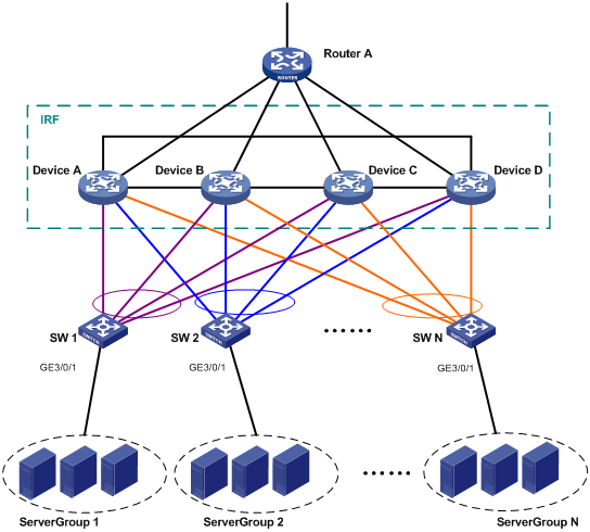

# Connect Device D to Device C and Device A, as shown in Figure 2.
# Enable IRF mode.
[DeviceD] chassis convert mode irf
Device D reboots to join the IRF fabric. A four-chassis IRF fabric is formed.
[DeviceA] interface range ten-gigabitethernet 1/3/0/3 ten-gigabitethernet 2/3/0/3 ten-gigabitethernet 3/3/0/3 ten-gigabitethernet 4/3/0/3
[DeviceA-if-range] port link-aggregation group 1
[DeviceA-if-range] quit
[DeviceA] interface ten-gigabitethernet 1/3/0/4 ten-gigabitethernet 2/3/0/4 ten-gigabitethernet 3/3/0/4 ten-gigabitethernet 4/3/0/4
[DeviceA-if-range] port link-aggregation group 2
# Create Bridge-Aggregation 1024. Assign the uplink ports that connect to Router A to the aggregation group.
[DeviceA] interface range ten-gigabitethernet 1/3/0/8 ten-gigabitethernet 2/3/0/8 ten-gigabitethernet 3/3/0/8 ten-gigabitethernet 4/3/0/8
[DeviceA-if-range] port link-aggregation group 1024
[DeviceA] vlan 10
[DeviceA] vlan 20
[DeviceA] vlan 41
3.     Configure OSPF between the IRF fabric and Router A.
[DeviceA] interface loopback 0
[DeviceA-LoopBack0] ip address 172.24.254.1 255.255.255.255
[DeviceA-LoopBack0] quit
[DeviceA] ospf 1 router-id 172.24.254.1
Configuring SW 1
# Create Bridge-Aggregation 1, and enable the dynamic aggregation mode. You must enable the dynamic aggregation mode because this link aggregation will be used for LACP MAD.
<SW1> system-view
# Assign uplink ports to Bridge-Aggregation 1.
[SW1] interface range ten-gigabitethernet 2/0/21 to ten-gigabitethernet 2/0/24
[SW1-if-range] port link-aggregation group 1
[SW1-if-range] quit
# Create all VLANs.
[SW1] vlan all
# Configure the aggregate interface that connects to the IRF fabric.
# Configure the port that connects to Server Group 1.
Configuring SW 2
<SW2> system-view
[SW2] interface range ten-gigabitethernet 2/0/21 to ten-gigabitethernet 2/0/24
[SW2-if-range] port link-aggregation group 1
[SW2-if-range] quit
# Create all VLANs.
[SW2] vlan all
1.     Configure link aggregation:
# Assign the downlink ports that connect to the IRF fabric to Bridge-Aggregation 1.
[RouterA] interface range ten-gigabitethernet 2/0/1 to ten-gigabitethernet 2/0/4
[RouterA-if-range] port link-aggregation group 1
[RouterA-if-range] quit
[RouterA] vlan 41
[RouterA-vlan41] quit
[RouterA] interface vlan-interface 41
[RouterA-vlan-interface41] ip address 172.24.41.2 24
[RouterA-vlan-interface41] quit
[RouterA-Bridge-Aggregation1] port access vlan 41
[RouterA] vlan 50
[RouterA] interface loopback 0
[RouterA-LoopBack0] ip addresss 172.24.254.2 255.255.255.255
[RouterA-LoopBack0] quit
[RouterA] ospf 1 router-id 172.24.254.2
[RouterA-ospf-1-area-0.0.0.0] network 172.24.41.0 0.0.0.255
Verify the IRF and multichassis link aggregation configuration.
# Execute the display irf topology command.
<DeviceA> display irf topology
                           Topology Info
               IRF-Port1                IRF-Port2
 Switch    Link       neighbor      Link       neighbor    Belong To
 1         UP         4             UP         2           0210-fc01-0000
 4         UP         3             UP         1           0210-fc01-0000
 3         UP         2             UP         4           0210-fc01-0000
 2         UP         1             UP         3           0210-fc01-0000
The output shows that all the IRF links are in UP state. The four-chassis IRF fabric is established.

Example: Upgrading a two-chassis IRF fabric to a four-chassis IRF fabric (BFD MAD)
Upgrade a two-chassis IRF fabric (see Figure 3) to a four-chassis IRF fabric (see Figure 5) by performing one of the following tasks:
·     Merge two two-chassis IRF fabrics.
·     Add two chassis to the existing two-chassis IRF fabric.

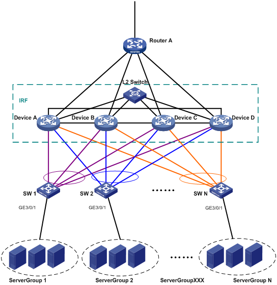

Configure BFD MAD on the four-chassis IRF fabric, and set up a BFD MAD link between the intermediate device and each member device.
Figure 3 Two-chassis IRF fabric
Figure 4 Upgrading the two-chassis IRF fabric to a four-chassis IRF fabric
Figure 5 BFD MAD-enabled four-chassis IRF fabric
Table 5 Network topology (partial)
Device
Neighboring device
Port
VLAN
IRF fabric
Layer 2 switch
XGE 1/3/0/1
XGE 2/3/0/1
XGE 3/3/0/1
XGE 4/3/0/1
VLAN 13 (BFD MAD VLAN)
Layer 2 switch
IRF fabric
XGE 1/0/41
XGE 1/0/42
XGE 1/0/43
XGE 1/0/44
VLAN 13
For more information about the VLAN and IP assignment, port bindings, and network topology scheme, see Table 2, Table 3, and Table 4.
Analysis
Because each IRF member must have a unique member ID on the IRF fabric, you must verify that the member ID assignment schemes of the two IRF fabrics do not conflict. If the schemes conflict, renumber the member devices in one IRF fabric to ensure that the two IRF fabrics can merge.
If a downstream or upstream device can process extended LACPDUs for LACP MAD, you can use LACP MAD for IRF split detection. If none of the upstream or downstream devices can process extended LACPDUs, you can use BFD MAD instead.
You can deploy BFD MAD by using the following methods:
·     Connect all member chassis with dedicated BFD MAD links into a full mesh topology. This method is suitable for two-chassis IRF fabrics.
·     Set up a dedicated BFD MAD link with an intermediate device for each IRF member chassis. This method is suitable for three- or four-chassis IRF fabrics because it uses fewer physical ports than the previous method.
The intermediate device forwards BFD MAD packets transparently. You must assign all BFD MAD links to the VLAN used for BFD MAD.

Use one of the following methods to upgrade a two-chassis IRF fabric to a four-chassis IRF fabric:
·     Adding two chassis to a two-chassis IRF fabric
·     Merging two two-chassis IRF fabrics
1.     Configure the IRF fabric:
# Bind Ten-GigabitEthernet 1/2/0/4 to IRF-port 1/1.
[DeviceA] interface ten-gigabitethernet 1/2/0/4
[DeviceA-Ten-GigabitEthernet1/2/0/4] shutdown
[DeviceA-Ten-GigabitEthernet1/2/0/4] quit
[DeviceA] irf-port 1/1
[DeviceA-irf-port1/1] port group interface ten-gigabitethernet 1/2/0/4
[DeviceA-irf-port1/1] quit
[DeviceA-Ten-GigabitEthernet1/2/0/4] undo shutdown
# Bind Ten-GigabitEthernet 2/3/0/30 to IRF-port 2/2.
[DeviceA] interface ten-gigabitethernet 2/3/0/30
[DeviceA-Ten-GigabitEthernet2/3/0/30] shutdown
[DeviceA-Ten-GigabitEthernet2/3/0/30] quit
[DeviceA] irf-port 2/2
[DeviceA-irf-port2/2] port group interface ten-gigabitethernet 2/3/0/30
[DeviceA-irf-port2/2] quit
[DeviceA-Ten-GigabitEthernet2/3/0/30] undo shutdown
[DeviceA] save
The current configuration will be written to the device. Are you sure? [Y/N]:y
Please input the file name(*.cfg)[cfa0:/irf.cfg]
(To leave the existing filename unchanged, press the enter key):
cfa0:/irf.cfg exists, overwrite? [Y/N]:y
 Validating file. Please wait.....................................
 Saved the current configuration to mainboard device successfully.
# Activate the IRF port configuration.
[DeviceA] irf-port-configuration active
2.     Configure IRF on Device C:
# Assign member ID 3 to Device C.
<DeviceC> system-view
[DeviceC] irf member 3
# Bind Ten-GigabitEthernet 3/0/15 to IRF-port 1.
[DeviceC] irf-port 1
[DeviceC-irf-port1] port group interface ten-gigabitethernet 3/0/15
[DeviceC-irf-port1] quit
# Bind Ten-GigabitEthernet 12/0/1 to IRF-port 2.
[DeviceC] irf-port 2
[DeviceC-irf-port2] port group interface ten-gigabitethernet 12/0/1
[DeviceC-irf-port2] quit
[DeviceC] save
# Connect Device C to Device B, as shown in Figure 5.
# Enable IRF mode.
[DeviceC] chassis convert mode irf
Device C reboots to join the IRF fabric. A three-chassis IRF fabric is formed.
3.     Configure IRF on Device D:
# Assign member ID 4 to Device D.
<DeviceD> system-view
[DeviceD] irf member 4
# Bind Ten-GigabitEthernet 6/0/4 to IRF-port 1.
[DeviceD] irf-port 1
[DeviceD-irf-port1] port group interface ten-gigabitethernet 6/0/4
[DeviceD-irf-port1] quit
# Bind Ten-GigabitEthernet 6/0/2 to IRF-port 2.
[DeviceD] irf-port 2
[DeviceD-irf-port2] port group interface ten-gigabitethernet 6/0/2
[DeviceD-irf-port2] quit
[DeviceD] save
# Connect Device D to Device A and Device C, as shown in Figure 5.
# Enable IRF mode.

# Connect Device C to Device B, and connect Device A to Device D, as shown in Figure 5.
The two IRF fabrics perform master election. The one that lost the master election reboots to join the IRF fabric. A four-chassis IRF fabric is formed.

2.     Configure BFD MAD:
# Create VLAN 13, and enable BFD MAD on VLAN-interface 13.
[DeviceA] vlan 13
[DeviceA-vlan13] quit
[DeviceA] interface Vlan-interface 13
[DeviceA-Vlan-interface13] mad bfd enable
# Configure a MAD IP address for each member device on VLAN-interface 13.
[DeviceA-Vlan-interface13] mad ip address 172.1.1.1 24 member 1
[DeviceA-Vlan-interface13] mad ip address 172.1.1.2 24 member 2
[DeviceA-Vlan-interface13] mad ip address 172.1.1.3 24 member 3
[DeviceA-Vlan-interface13] mad ip address 172.1.1.4 24 member 4
[DeviceA-Vlan-interface13] undo shutdown
[DeviceA-Vlan-interface13] quit
# Assign the ports that connect to the Layer 2 switch to VLAN 13. Disable the spanning tree feature on the ports.
[DeviceA] interface range ten-gigabitethernet 1/3/0/1 ten-gigabitethernet 2/3/0/1 ten-gigabitethernet 3/3/0/1 ten-gigabitethernet 4/3/0/1
[DeviceA-if-range] undo stp enable
[DeviceA-if-range] port access vlan 13
                           Topology Info
               IRF-Port1                IRF-Port2
