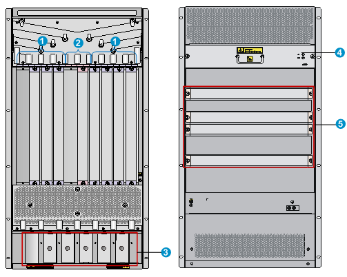

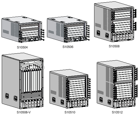

Chassis views
Figure 1 Chassis
Figure 2 S10508-V switch front and rear panels
(1) LPU slots
(2) MPU slots
(3) Power module slots
(4) Fan tray slot
(5) Switching fabric module slots
Technical specifications
Table 1 Switch dimensions
Model
Height
Width
Depth
S10504
353 mm (13.90 in) (8 RU)
440 mm (17.32 in)
660 mm (25.98 in)
S10506
440 mm (17.32 in)
660 mm (25.98 in)
S10508
620 mm (24.41 in) (14 RU)
440 mm (17.32 in)
660 mm (25.98 in)
S10508-V
886 mm (34.88 in) (20 RU)
440 mm (17.32 in)
660 mm (25.98 in)
S10510
440 mm (17.32 in)
660 mm (25.98 in)
S10512
797 mm (31.38 in) (18 RU)
440 mm (17.32 in)
660 mm (25.98 in)

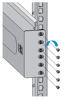

4.     Align the installation holes on the front end of a slide rail with the cage nuts on a front rack post, and use six screws to attach the slide rail to the front rack post. Figure 6 uses the right slide rail as an example.
Figure 6 Attaching the right slide rail to the front right rack post

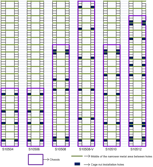

Installing cage nuts

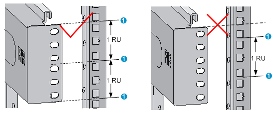

1.     Determine and mark the cage nut installation holes in either of the following methods:
?     Mark the cage nut installation holes as shown in Figure 7.
?     Use other tools such as a tape. Align the tape with a mounting bracket. Mark the tape according to the cage nut installation holes on the mounting bracket. Align the tape with the rack posts and mark the installation holes on the rack posts.
For the S10506 and S10510 switches, you can use the cage nut installation template to determine the cage nut installation holes on the rack posts. For more information about the cage nut installation template, see H3C S10506&S10510 Switches Installation Quick Start.
Figure 7 Cage nut installation holes
Figure 8 Marking the cage nut installation holes

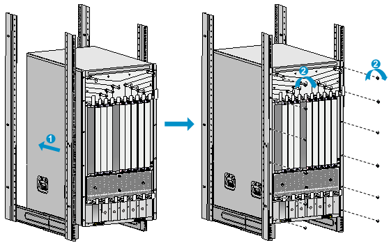

Installing the switch in the rack
Follow these guidelines when you install the switch in the rack:
·     To avoid equipment damage or bodily injury, use a minimum of two people to lift the switch. H3C recommends that you use a mechanical lift to move the switch.
·     Do not hold the filler panels, filler panel handles, or the air vents of chassis to carry the chassis. Any attempt to carry the switch with these parts might cause equipment damage or even bodily injury.
·     After placing the switch on the slide rails, do not leave go of your hands immediately because this might tip the switch. Tipping the switch can cause switch damage and even bodily injury.
Figure 9 Installing the switch in the rack

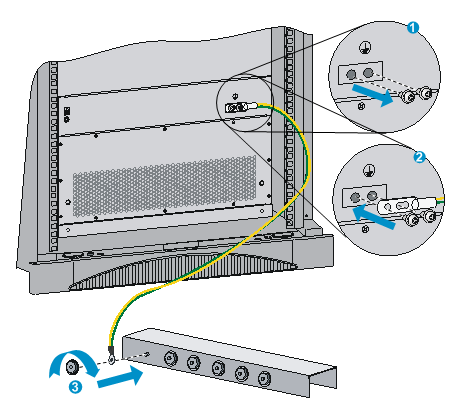

Grounding the switch
CAUTION
CAUTION:
·     Use the provided grounding cable (yellow-green grounding cable).
·     Connect the grounding cable to the grounding system in the equipment room. Do not connect it to a fire main or lightning rod.
Figure 10 Grounding the switch

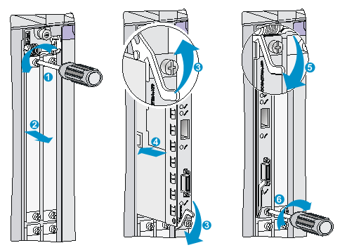

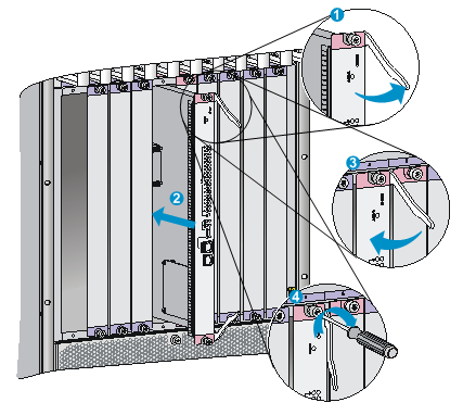

Installing a card
CAUTION
CAUTION:
Before installing a card in the chassis, make sure the connectors on the card are not broken or blocked.
Figure 11 Installing a card

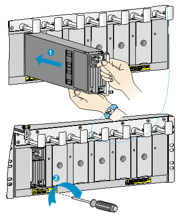

Installing a power module
CAUTION
CAUTION:
·     Provide a circuit breaker for each power module and verify that the circuit breaker is off before installation.
·     Do not install power modules of different models on the same switch.
·     To avoid power module damage, move the power module by supporting its bottom instead of holding its handle.

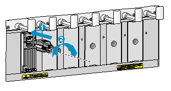

After you push the power module into the slot, press the power module handle inward until it is secured in place, and then fasten the captive screws on the power module.
Figure 13 Installing a power module

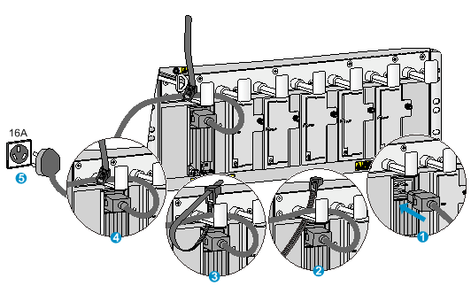

Connecting power cords
Connecting an AC power cord
CAUTION
CAUTION:
Before you connect an AC power cord, make sure the circuit breaker for the power cord is switched off.
Figure 14 Connecting an AC power cord

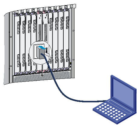

Accessing the switch for the first time
Connecting the console cable
The first time you access the switch you must use a console cable to connect a console terminal, for example, a PC, to the console port or USB console port on the switch.
On an S10506 or S10510 switch, if both the console port and USB console port are connected to terminals, you can only access the switch through the USB console port.
To connect the console cable to the console port:
1.     Connect the DB-9 connector of the console cable to the 9-core serial port on the terminal.
2.     Connect the crimped RJ-45 connector of the console cable to the console port on the switch.
To connect the console cable to the USB console port:
1.     Connect the USB A connector of the console cable to the USB port on the terminal.
2.     Connect the mini-USB A/B connector of the console cable to the USB console port on the switch.
Figure 16 Connecting the console port to a PC (S10508-V switch)
