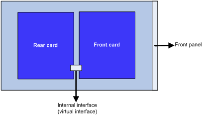

An OAP module integrates a front card and a rear card. The front card provides value-added security services, such as firewall, intrusion prevention, and application control. The rear card is responsible for data exchange between the front card and the switch. The rear card communicates with the front card through the internal interface, as shown in Figure 1.
Figure 1 Internal interface diagram
