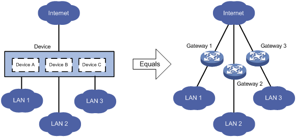

The MDC technology can be widely used for such applications as device renting, service hosting, and student labs. Instead of purchasing new devices, you can configure more MDCs on existing network devices to expand the network.
As shown in Figure 1, LAN 1, LAN 2, and LAN 3 are three companies' LANs. To provide access service for the three companies, you can deploy a single physical device and configure an MDC for each company on the device. Then, the administrators of each company can log in only to their own MDC to maintain their own network, without affecting any other MDCs or networks. This has the same effect as deploying a separate gateway for each company.
Figure 1 Network diagram

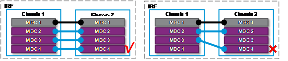

·     Assigning an IRF physical interface of the default MDC to a non-default MDC clears all IRF settings on the interface and disconnects the IRF link. To avoid IRF fabric split, make sure there are IRF links in up state between the member devices at any time.
·     For an IRF link to be established correctly, make sure the two IRF physical interfaces belong to the same MDC.
Figure 2 Two IRF physical interfaces of an IRF link must belong to the same MDC

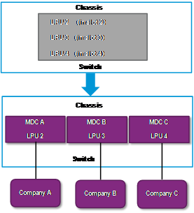

Network requirements
As shown in Figure 3, a service provider wants to use the device to meet the Internet access requirements of three companies.
Company A has a lot of servers and storage devices. It has a large amount of traffic and requires a large amount of disk space on the Internet gateway.
Company B and Company C do not need a large amount of disk space. The default disk space is enough to meet their disk space requirements.
Company C has less Internet traffic, and needs only a small amount of CPU resources.
Configure an MDC for each company. Specify a disk space quota for Company A to limit its disk space usage. Specify a CPU weight for Company C to limit its CPU resource usage.
Figure 3 Network diagram
As shown in Figure 4, a service provider wants to use the IRF fabric to meet the Internet access requirements of two companies.
The IRF fabric has two members. The master uses member ID 1. The subordinate member uses member ID 2. Each member device has one LPU in slot 2 and one LPU in slot 3. Each LPU has 16 10-GE interfaces.
Company A has a large amount of traffic and requires a large amount of disk space.
Figure 4 Network diagram
