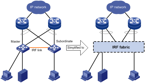

The Intelligent Resilient Framework (IRF) technology virtualizes multiple physical devices at the same layer into one virtual fabric to provide data center class availability and scalability. IRF virtualization technology offers processing power, interaction, unified management, and uninterrupted maintenance of multiple devices.
Figure 1 shows an IRF fabric that has two member devices, which appear as a single node to the upper-layer and lower-layer devices.
Figure 1 IRF application scenario
IRF provides the following benefits:
·     Simplified topology and easy management—An IRF fabric appears as one node and is accessible at a single IP address on the network. You can use this IP address to log in at any member device to manage all the members of the IRF fabric. In addition, you do not need to run the spanning tree feature among the IRF members.
·     1:N redundancy—In an IRF fabric, one member acts as the master to manage and control the entire IRF fabric. All the other members process services while backing up the master. When the master fails, all the other member devices elect a new master from among them to take over without interrupting services.
·     IRF link aggregation—You can assign several physical links between neighboring members to their IRF ports to create a load-balanced aggregate IRF connection with redundancy.
·     Multichassis link aggregation—You can use the Ethernet link aggregation feature to aggregate the physical links between the IRF fabric and its upstream or downstream devices across the IRF members.
·     Network scalability and resiliency—Processing capacity of an IRF fabric equals the total processing capacities of all the members. You can increase ports, network bandwidth, and processing capacity of an IRF fabric simply by adding member devices without changing the network topology.

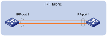

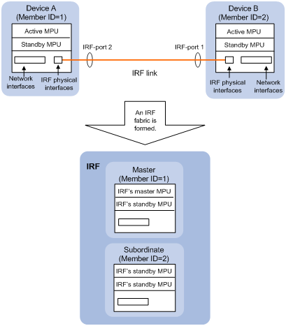

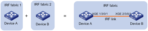

As shown in Figure 2, Device A and Device B form a two-chassis IRF fabric. The fabric has four MPUs (one active and three standbys), and two times the number of interface modules that a single device provides. The IRF fabric manages the physical and software resources of Device A and Device B in a centralized manner.
Figure 2 Two-chassis IRF fabric implementation schematic diagram

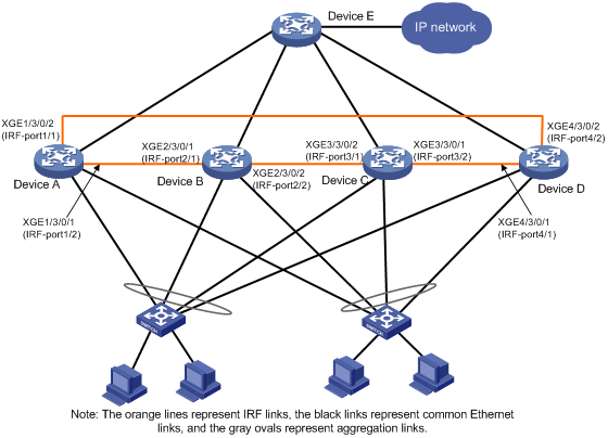

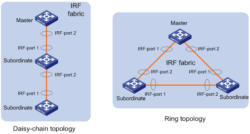

The device supports daisy-chain or ring topology for IRF fabrics. IRF does not support the full mesh topology. For information about connecting IRF member devices, see "Connecting IRF physical interfaces."

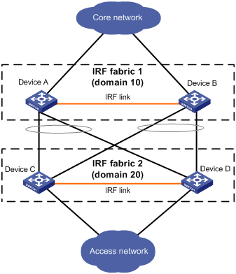

As shown in Figure 3, IRF fabric 1 contains Device A and Device B, and IRF fabric 2 contains Device C and Device D. Both fabrics use the LACP aggregate links between them for MAD. When a member device receives an extended LACPDU for MAD, it checks the domain ID to see whether the packet is from the local IRF fabric. Then, the device can handle the packet correctly.

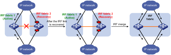

IRF merge occurs when two split IRF fabrics reunite or when two independent IRF fabrics are united, as shown in Figure 5.
Figure 5 IRF merge

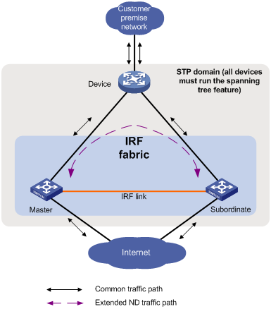

Loop elimination mechanism
Loop control protocols such as the spanning tree feature cannot be configured on IRF physical interfaces. However, IRF has its own mechanism to eliminate loops. Before an IRF member device forwards a packet, it identifies whether loops exist on the forwarding path based on the source and destination physical interfaces and the IRF topology. If a loop exists, the device discards the packet on the source interface of the looped path. This loop elimination mechanism will drop a large number of broadcast packets on the IRF physical interfaces. When you use SNMP tools, do not monitor packet forwarding on the IRF physical interfaces to reduce SNMP notifications of packet drops.

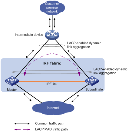

LACP MAD and BFD MAD use the following process to handle a multi-active collision:
1.     Compare the number of members in each fabric.
2.     Set all fabrics to the Recovery state except the one that has the most members.
3.     Compare the member IDs of their masters if all IRF fabrics have the same number of members.
4.     Set all fabrics to the Recovery state except the one that has the lowest numbered master.
5.     Shut down all network ports and interfaces in the Recovery-state fabrics except for the following ports and interfaces:
¡     IRF physical interfaces.
¡     Ports and interfaces you have specified with the mad exclude interface command.
In contrast, ARP MAD and ND MAD do not compare the number of members in fabrics. These MAD mechanisms use the following process to handle a multi-active collision:
1.     Compare the member IDs of the masters in the IRF fabrics.
2.     Set all fabrics to the Recovery state except the one that has the lowest numbered master.
3.     Take the same action on the network ports and interfaces in Recovery-state fabrics as LACP MAD and BFD MAD.

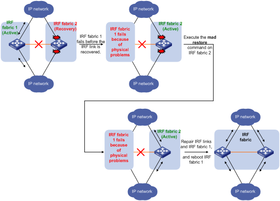

Failure recovery
To merge two split IRF fabrics, first repair the failed IRF link and remove the IRF link failure.
·     If the IRF fabric in Recovery state fails before the failure is recovered, repair the failed IRF fabric and the failed IRF link.
·     If the active IRF fabric fails before the failure is recovered, enable the inactive IRF fabric to take over the active IRF fabric. Then, recover the MAD failure.

LACP MAD
As shown in Figure 6, LACP MAD has the following requirements:
·     Every IRF member must have a link with an intermediate device.
·     All the links form a dynamic link aggregation group.
·     The intermediate device must be a device that supports extended LACP for MAD.
The IRF member devices send extended LACPDUs that convey a domain ID and an active ID. The intermediate device transparently forwards the extended LACPDUs received from one member device to all the other member devices.
·     If the domain IDs and active IDs sent by all the member devices are the same, the IRF fabric is integrated.
·     If the extended LACPDUs convey the same domain ID but different active IDs, a split has occurred. LACP MAD handles this situation as described in "Collision handling."
Figure 6 LACP MAD scenario

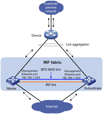

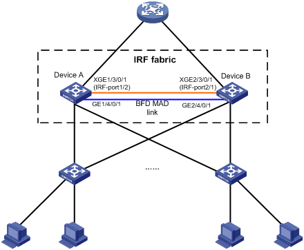

BFD MAD
IMPORTANT
IMPORTANT:
BFD MAD is supported only on the default MDC.
On a two-chassis IRF fabric, BFD MAD can work with or without an intermediate device. On a three- or four-chassis IRF fabric, BFD MAD must work with an intermediate device.
BFD MAD can be used on common Ethernet ports or management Ethernet ports. If management Ethernet ports are used, you must select the management Ethernet port on the active MPU of each member device for BFD MAD links.
Figure 7 shows a typical BFD MAD application scenario on common Ethernet ports. Figure 8 shows a typical BFD MAD application scenario on management Ethernet ports.
To use BFD MAD:
·     Set up dedicated BFD MAD link between each pair of IRF members or between each IRF member and the intermediate device. Do not use the BFD MAD links for any other purposes.
·     If common Ethernet ports are used for BFD MAD links, you must configure BFD MAD on a VLAN interface. Perform the following tasks:
¡     Assign the ports connected by BFD MAD links to the same VLAN. The VLAN must be unique across MDCs and the network.
¡     Create a VLAN interface for the VLAN, and assign a MAD IP address to each member on the VLAN interface.
On the intermediate device (if any), you must create the VLAN and assign the ports on the BFD MAD links to the VLAN.
·     If management Ethernet ports are used for BFD MAD, assign a MAD IP address to each member device on the management Ethernet port of the global active MPU. On the intermediate device (if any), assign the ports on the BFD links to the same VLAN.
·     The MAD addresses identify the member devices and must belong to the same subnet.
·     Of all management Ethernet ports on an IRF fabric, only the management Ethernet port on the global active MPU is accessible.
Figure 7 BFD MAD scenario for common Ethernet ports
Figure 8 BFD MAD scenario for management Ethernet ports
With BFD MAD, the master attempts to establish BFD sessions with other member devices by using its MAD IP address as the source IP address.
·     If the IRF fabric is integrated, only the MAD IP address of the master takes effect. The master cannot establish a BFD session with any other member. If you execute the display bfd session command, the state of the BFD sessions is Down.
·     When the IRF fabric splits, the IP addresses of the masters in the split IRF fabrics take effect. The masters can establish a BFD session. If you execute the display bfd session command, the state of the BFD session between the two devices is Up.

ND MAD
ND MAD detects multi-active collisions by using NS packets to transmit the IRF domain ID and the active ID.
You can set up ND MAD links between neighbor IRF member devices or between each IRF member device and an intermediate device (see Figure 10). If an intermediate device is used, you must also run the spanning tree protocol between the IRF fabric and the intermediate device.
Figure 10 ND MAD scenario
Each IRF member device compares the domain ID and the active ID in incoming NS packets with its domain ID and active ID:
·     If the domain IDs are different, the NS packet is from a different IRF fabric. The device does not continue to process the packet with the MAD mechanism.
·     If the domain IDs are the same, the device compares the active IDs:
¡     If the active IDs are different, the IRF fabric has split.
¡     If the active IDs are the same, the IRF fabric is integrated.

·     You must connect the physical interfaces of IRF-port 1 on one member to the physical interfaces of IRF-port 2 on the other.
·     Do not connect physical interfaces of both IRF ports on one member device to the physical interfaces of both IRF ports on the other device.
·     Make sure the two ends of an aggregate IRF link have the same number of IRF physical interfaces.
When you connect two neighboring IRF members, connect the physical interfaces of IRF-port 1 on one member to the physical interfaces of IRF-port 2 on the other (see Figure 11).
For example, you have four chassis: A, B, C, and D. IRF-port 1 and IRF-port 2 are represented by A1 and A2 on chassis A, represented by B1 and B2 on chassis B, and so on. To connect the four chassis into a ring topology of A-B-C-D(A), the IRF link cabling scheme must be one of the following:
·     A1-B2, B1-C2, C1-D2, and D1-A2.
·     A2-B1, B2-C1, C2-D1, and D2-A1.
Figure 11 Connecting IRF physical interfaces
Connect the devices into a daisy-chain topology or a ring topology. A ring topology is more reliable (see Figure 12). In ring topology, the failure of one IRF link does not cause the IRF fabric to split as in daisy-chain topology. Rather, the IRF fabric changes to a daisy-chain topology without interrupting network services.
To use the ring topology, you must have a minimum of three member devices.
IMPORTANT
IMPORTANT:
Optical transmission devices can be deployed to relay the IRF links. No other devices are allowed between neighboring IRF member devices.
Figure 12 Daisy-chain topology vs. ring topology

·     If ARP MAD or ND MAD is used with the spanning tree feature, you must configure IRF bridge MAC persistence by using the undo irf mac-address persistent command. Do not specify a MAC address as the IRF bridge MAC address.

Configuring LACP MAD
When you use LACP MAD, follow these guidelines:
·     If the intermediate device is also an IRF fabric, assign the two IRF fabrics different domain IDs for correct split detection.
·     Use dynamic link aggregation mode. MAD is LACP dependent. Even though LACP MAD can be configured on both static and dynamic aggregate interfaces, it takes effect only on dynamic aggregate interfaces.
·     Configure link aggregation settings on the intermediate device.
To configure LACP MAD:
Step
Remarks
N/A
2.     Assign a domain ID to the IRF fabric.
irf domain domain-id
The default IRF domain ID is 0.
3.     Create an aggregate interface and enter aggregate interface view.
·     Enter Layer 2 aggregate interface view:
·     Enter Layer 3 aggregate interface view:
interface route-aggregation interface-number
Perform this step also on the intermediate device.
4.     Configure the aggregation group to operate in dynamic aggregation mode.
link-aggregation mode dynamic
By default, an aggregation group operates in static aggregation mode.
5.     Enable LACP MAD.
mad enable
By default, LACP MAD is disabled.
6.     Return to system view.
N/A
7.     Enter Ethernet interface view or interface range view.
·     Enter interface range view:
¡     Method 1:
interface range { interface-type interface-number [ to interface-type interface-number ] } &<1-
24>
¡     Method 2:
interface range name name [ interface { interface-type interface-number [ to interface-type interface-number ] } &<1-
24> ]
·     Enter Ethernet interface view:
To assign a range of ports to the aggregation group, enter interface range view.
To assign one port to the aggregation group, enter Ethernet interface view.
8.     Assign the Ethernet port or the range of Ethernet ports to the specified aggregation group.
port link-aggregation group group-id
Multichassis link aggregation is allowed.
Also perform this step on the intermediate device.
Configuring BFD MAD that uses common Ethernet ports
Configure BFD MAD on a VLAN interface if you use common Ethernet ports for BFD MAD.
When you configure BFD MAD settings, follow these restrictions and guidelines:
Category

Configuring BFD MAD that uses management Ethernet ports
When you configure BFD MAD that uses management Ethernet ports, follow these restrictions and guidelines:
Category
Management Ethernet ports for BFD MAD
·     If you are using an intermediate device, connect the management Ethernet ports on each member device to the common Ethernet ports on the intermediate device. To avoid BFD MAD failure caused by an active/standby MPU switchover, connect the management Ethernet port on each MPU to the intermediate device.
·     The management Ethernet ports on the LSU1SUPB0 and LSUM1SUPD0 MPUs do not support BFD MAD.
BFD MAD VLAN
·     On the intermediate device (if any), create a VLAN for BFD MAD, and assign the ports used for BFD MAD to the VLAN. On the IRF fabric, you do not need to assign the management Ethernet ports to a VLAN.
·     As a best practice, do not configure other features on the VLAN used for BFD MAD.
·     Make sure the IRF fabrics on the network use different BFD MAD VLANs.
·     Make sure the BFD MAD VLAN on the intermediate device contains only ports on the BFD MAD links.
BFD MAD-enabled management Ethernet port and feature compatibility
Do not bind a BFD MAD-enabled management Ethernet port to a VPN instance. The MAD feature is mutually exclusive with VPN.
MAD IP address
·     Use the mad ip address command instead of the ip address command to configure MAD IP addresses on the BFD MAD-enabled management Ethernet ports.
·     Make sure all the MAD IP addresses are on the same subnet.
·     MAD IP addresses must be unique among all IP addresses on the IRF fabric.
BFD MAD and IRF link down report delay restrictions
Set the IRF link down report delay to 0 seconds to avoid unnecessary recalculations.
To configure BFD MAD that uses management Ethernet ports:
Step
Remarks
N/A
2.     (Optional.) Assign a domain ID to the IRF fabric.
By default, the domain ID of an IRF fabric is 0.
3.     Enter management Ethernet interface view.
interface M-GigabitEthernet interface-number
Enter the view of the management Ethernet port on the global active MPU to perform the subsequent steps.
4.     Enable BFD MAD.
mad bfd enable
By default, BFD MAD is disabled.
5.     Assign a MAD IP address to each member device.
mad ip address ip-address { mask | mask-length } member member-id
By default, no MAD IP address is assigned to any member device.

Recovering an IRF fabric
After the failed IRF link between two split IRF fabrics is recovered, log in to the inactive IRF fabric, and use the reboot command to reboot all its members. If the irf auto-merge enable command has been configured, the inactive IRF member devices automatically reboot after the failed link is recovered. After these member devices join the active IRF fabric as subordinates, IRF merge is complete, as shown in Figure 13.
Figure 13 Recovering the IRF fabric
If the active IRF fabric fails before the IRF link is recovered (see Figure 14), use the mad restore command on the inactive IRF fabric to recover the inactive IRF fabric. The command also brings up all network ports and interfaces that were shut down by MAD. After you repair the IRF link, the two parts merge into a unified IRF fabric.
Figure 14 Active IRF fabric fails before the IRF link is recovered
To manually recover an inactive IRF fabric:
Step
2.     Recover the inactive IRF fabric.
mad restore
After the IRF fabric is recovered, all ports and interfaces that have been shut down by MAD come up automatically.

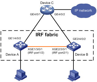

LACP MAD-enabled IRF configuration example for a two-chassis IRF fabric
Network requirements
As shown in Figure 15, set up a two-chassis IRF fabric at the access layer of the enterprise network.
Configure LACP MAD on the multichassis aggregation to Device C, an H3C device that supports extended LACP.
Figure 15 Network diagram
Configuration procedure
IMPORTANT
IMPORTANT:
Between two neighboring IRF members, IRF links must be bound to IRF-port 1 on one member and to IRF-port 2 on the other.
1.     Configure Device A:
# Assign member ID 1 to Device A, and bind Ten-GigabitEthernet 3/0/1 to IRF-port 2.
<Sysname> system-view
[Sysname] irf member 1
[Sysname] irf-port 2
[Sysname-irf-port2] port group interface ten-gigabitethernet 3/0/1
[Sysname-irf-port2] quit
# Save the configuration.
[Sysname] quit
<Sysname> save
# Enable IRF mode.
[Sysname] chassis convert mode irf
The device will switch to IRF mode and reboot. You are recommended to save the current running configuration and specify the configuration file for the next startup. Continue? [Y/N]:y
 Do you want to convert the content of the next startup configuration file flash:/startup.cfg to make it available in IRF mode? [Y/N]:y
 Please wait...
 Saving the converted configuration file to the main board succeeded.
Slot 1:
 Saving the converted configuration file succeeded.
 Now rebooting, please wait...
2.     Configure Device B:
# Assign member ID 2 to Device B, and bind Ten-GigabitEthernet 3/0/1 to IRF-port 1.
[Sysname] irf member 2
[Sysname] irf-port 1
[Sysname-irf-port1] port group interface ten-gigabitethernet 3/0/1
[Sysname-irf-port1] quit
[Sysname] quit
<Sysname> save
# Connect the two devices as shown in Figure 15.
# Enable IRF mode on Device B.
 Please wait...
Slot 1:
Device B and Device A form an IRF fabric after Device B reboots.
3.     Configure LACP MAD:
# Assign domain ID 1 to the IRF fabric.
[Sysname] irf domain 1
# Create a dynamic aggregate interface and enable LACP MAD.
[Sysname] interface bridge-aggregation 2
[Sysname-Bridge-Aggregation2] link-aggregation mode dynamic
[Sysname-Bridge-Aggregation2] mad enable
You need to assign a domain ID (range: 0-4294967295)
 [Current domain is: 1]:
 The assigned  domain ID is: 1
 MAD LACP only enable on dynamic aggregation interface.
[Sysname-Bridge-Aggregation2] quit
# Assign GigabitEthernet 1/4/0/2 and GigabitEthernet 2/4/0/2 to the aggregate interface.
[Sysname] interface gigabitethernet 1/4/0/2
[Sysname-GigabitEthernet1/4/0/2] port link-aggregation group 2
[Sysname-GigabitEthernet1/4/0/2] quit
[Sysname] interface gigabitethernet 2/4/0/2
[Sysname-GigabitEthernet2/4/0/2] port link-aggregation group 2
4.     Configure Device C as the intermediate device:
CAUTION
CAUTION:
If the intermediate device is also an IRF fabric, assign the two IRF fabrics different domain IDs for correct split detection. False detection causes IRF split.
# Create a dynamic aggregate interface.
# Assign GigabitEthernet 4/0/1 and GigabitEthernet 4/0/2 to the aggregate interface.
[Sysname] interface gigabitethernet 4/0/1
[Sysname-GigabitEthernet4/0/1] port link-aggregation group 2
[Sysname-GigabitEthernet4/0/1] quit
[Sysname] interface gigabitethernet 4/0/2
[Sysname-GigabitEthernet4/0/2] port link-aggregation group 2
BFD MAD-enabled IRF configuration example for a two-chassis IRF fabric
As shown in Figure 16, set up an IRF fabric at the distribution layer of the network.
·     Configure BFD MAD in the IRF fabric and set up BFD MAD links between the member devices.
·     Disable the spanning tree feature on the ports used for BFD MAD, because the two features conflict with each other.
Figure 16 Network diagram

3.     Configure BFD MAD:
# Set the IRF link down report delay to 0 seconds.
[Sysname] irf link-delay 0
# Create VLAN 3, and add GigabitEthernet 1/4/0/1 and GigabitEthernet 2/4/0/1 to VLAN 3.
[Sysname] vlan 3
[Sysname-vlan3] port gigabitethernet 1/4/0/1 gigabitethernet 2/4/0/1
[Sysname-vlan3] quit
# Create VLAN-interface 3, and configure a MAD IP address for each member device on the VLAN interface.
[Sysname] interface vlan-interface 3
[Sysname-Vlan-interface3] mad bfd enable
[Sysname-Vlan-interface3] mad ip address 192.168.2.1 24 member 1
[Sysname-Vlan-interface3] mad ip address 192.168.2.2 24 member 2
[Sysname-Vlan-interface3] quit
# Disable the spanning tree feature on GigabitEthernet 1/4/0/1 and GigabitEthernet 2/4/0/1.
[Sysname] interface gigabitethernet 1/4/0/1
[Sysname-gigabitethernet1/4/0/1] undo stp enable
[Sysname-gigabitethernet1/4/0/1] quit
[Sysname] interface gigabitethernet 2/4/0/1
[Sysname-gigabitethernet2/4/0/1] undo stp enable
ARP MAD-enabled IRF configuration example for a two-chassis IRF fabric
As shown in Figure 17, set up a two-chassis IRF fabric at the distribution layer of the enterprise network.
·     Configure ARP MAD for the IRF fabric and use Device C as an intermediate device. Device C can come from any vendor.
·     To prevent loops, enable the spanning tree feature between the IRF fabric and Device C.
Figure 17 Network diagram

ND MAD-enabled IRF configuration example for a two-chassis IRF fabric
As shown in Figure 18, set up a two-chassis IRF fabric at the distribution layer of the enterprise network.
·     Configure ND MAD for the IRF fabric and use Device C as an intermediate device. Device C can come from any vendor.
Figure 18 Network diagram

Four-chassis IRF fabric configuration example
As shown in Figure 21, set up a four-chassis IRF fabric at the access layer of the enterprise network.
Figure 20 Network diagram before IRF deployment
Figure 21 Network diagram after IRF deployment
# Assign member ID 2 and member priority 26 to Device B.
[Sysname] irf priority 26
# Bind Ten-GigabitEthernet 3/0/1 and Ten-GigabitEthernet 3/0/2 to IRF-port 1 and IRF-port 2, respectively.
[Sysname-irf-port2] port group interface ten-gigabitethernet 3/0/2
[Sysname] save
# Connect Device B to Device A, as shown in Figure 21.
 Please wait...
Slot 1:
3.     Configure Device C:
# Assign member ID 3 and member priority 6 to Device C.
[Sysname] irf member 3
[Sysname] irf priority 6
# Bind Ten-GigabitEthernet 3/0/2 and Ten-GigabitEthernet 3/0/1 to IRF-port 1 and IRF-port 2, respectively.
[Sysname-irf-port1] port group interface ten-gigabitethernet 3/0/2
[Sysname] save
# Connect Device C to Device B, as shown in Figure 21.
# Enable IRF mode on Device C.
 Please wait...
Slot 1:
Device C reboots to join the IRF fabric.
4.     Configure Device D:
# Assign member ID 4 and member priority 2 to Device D.
[Sysname] irf member 4
[Sysname] save
# Connect Device D to Device A and Device C, as shown in Figure 21.
# Enable IRF mode on Device D.
 Please wait...
Slot 1:
Device D reboots to join the IRF fabric. A four-chassis IRF fabric is formed.

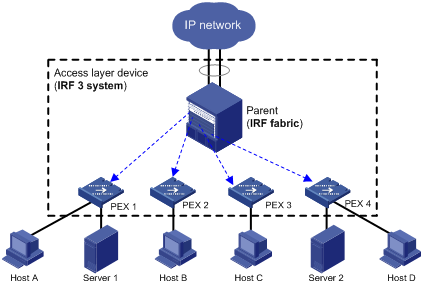

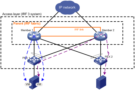

Overview

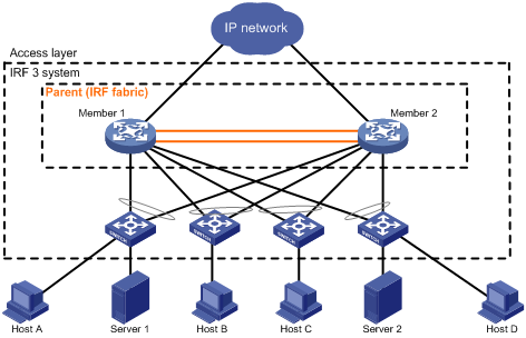

IRF 3 integrates multiple lower-layer devices with a higher-layer IRF fabric to provide high-density, low-cost connectivity at the access layer.
In an IRF 3 system, the higher-layer IRF fabric is called the parent fabric and the lower-layer devices are called port extenders (PEXs). You can manage and configure the PEXs from the parent fabric as if they were interface cards on the parent fabric.
Typically, IRF 3 works at the access layer of data centers. As shown in Figure 22, the access layer of a network is virtualized into an IRF 3 system. The system contains one parent fabric (a two-chassis IRF fabric) and multiple PEXs to provide connectivity for servers and hosts.
Figure 22 IRF 3 application scenario
IRF 3 provides the following benefits:
·     Simplified topologyDevices in an IRF 3 system appear as one node. For redundancy and load balancing, a downstream or upstream device can connect to the IRF 3 system through multichassis link aggregation. Together with link aggregation, IRF 3 creates a loop-free Layer 2 network. The spanning tree feature is not needed among devices in the IRF 3 system or on the link aggregations. IRF 3 also simplifies the Layer 3 network topology because it reduces the number of routing peers. The network topology does not change when a device is added to or removed from the IRF 3 system.
·     Single point of managementAn IRF 3 system is accessible at a single IP address on the network. You can use this IP address to log in through any network port to manage all the devices in the system. For an SNMP NMS, an IRF 3 system is one managed network node.
·     Network scalability and resiliency—You can increase the number of ports in an IRF 3 system by adding PEXs without changing network topology.
·     High availability—PEXs have multiple high-speed physical interfaces for uplink connectivity to the parent fabric. The links on these ports are aggregated and load balanced automatically.
·     Decreased TCO—IRF 3 decreases hardware investments and management costs. In an IRF 3 system, the parent fabric performs all the management and routing functions, and the PEXs only forwards traffic. You can add low-performance devices as PEXs to an IRF 3 system for network scalability. In addition, PEXs can load software and synchronize configuration from the parent fabric without administrative intervention.

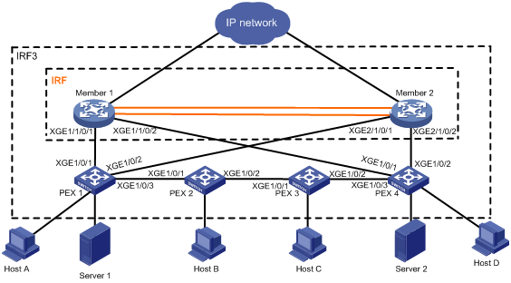

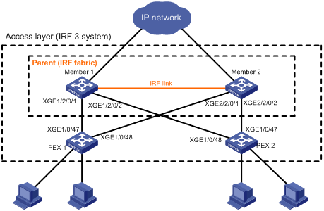

Network topology
The following are the methods to connect PEXs to the parent fabric:
·     One tier of PEXs—Each PEX is directly connected to the parent fabric. PEXs cannot be connected to each other, as shown in Figure 23.

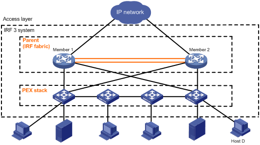

·     Two-tier PEX stack—One tier of PEXs (tier-2 PEXs) are attached to the tier-1 PEXs (the PEXs that are directly connected to the parent fabric). The two tiers of PEXs are connected and configured to form a PEX stack. Figure 24 shows a typical PEX stack access topology.
Figure 23 IRF 3 network topology with one tier of PEXs
Figure 24 IRF 3 network topology (PEX stack)

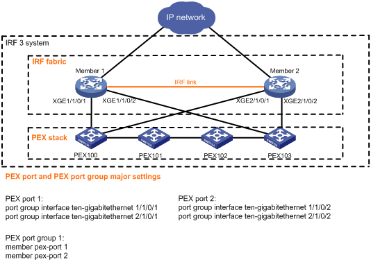

A PEX port is a logical port created on the parent fabric for managing PEXs attached to the port.
In PEX independent access mode, you must create a unique PEX port for each PEX, and assign all physical interfaces connected to the PEX to the PEX port.
In PEX stack access mode, you must create a unique PEX port for each tier-1 PEX and its tier-2 PEX.
PEX port group
A PEX port group represents a PEX stack. The PEX ports that connect to the same PEX stack must be assigned to the same PEX port group. For example, to build the PEX stack in Figure 25, you must assign PEX port 1 and PEX port 2 to the same PEX port group.

·     PEXs and PEX stacks can coexist. However, PEXs of the same PEX port must use the same connection method.
·     A PEX stack can contain a maximum of two tiers of PEXs. Each tier-1 PEX can be connected to a maximum of one tier-2 PEX.
·     Connect PEXs in the same stack in daisy-chain topology. Do not connect PEXs of different stacks to each other.
·     On the parent fabric side, connect a PEX port's all physical interfaces to the same tier-1 PEX.

IRF 3 system setup and configuration task list
To set up an IRF 3 system with one tier of PEXs:
Tasks at a glance
Remarks
1.     (Required.) Planning the IRF 3 system setup
N/A
2.     (Required.) Setting up the parent fabric
The parent fabric must be a single-chassis or multichassis IRF fabric.
3.     (Required.) Enabling IRF 3 capability on the parent device
N/A
4.     (Required.) Configuring IRF 3 settings on the parent fabric for PEXs:
a.     Creating PEX ports
b.     Assigning virtual chassis numbers to one tier of PEXs
c.     Assigning physical interfaces to PEX ports
d.     Configuring PEX link load sharing mode
e.     Specifying startup software images for PEXs
Specifying startup software images for PEXs is optional if the PEXs have storage media and can load PEX-capable startup software images locally. For more information about PEX software specification, see software upgrade in Fundamentals Configuration Guide.
Configuring PEX link load sharing mode is optional.
5.     (Required.) Connecting the PEXs to the parent fabric
Make sure the PEX cabling is consistent with the PEX physical interface assignment on the parent fabric.
PEXs join the IRF 3 system when PEX links come up.
To remove PEXs from the IRF 3 system, see "Removing PEXs from an IRF 3 system."
To set up an IRF 3 system with PEX stacks:
Tasks at a glance
Remarks
N/A
N/A
b.     Assigning virtual chassis numbers to a PEX stack
c.     Creating a PEX port group and assigning the PEX ports of a PEX stack to the group
d.     Assigning physical interfaces to PEX ports
e.     Configuring PEX link load sharing mode
f.     Specifying startup software images for PEXs
Make sure the PEX cabling is consistent with the PEX physical interface assignment on the parent fabric. Connect PEXs to each other for the PEX stack.
On each PEX port, you can configure one tier-1 PEX and one tier-2 PEX.
You must assign a unique virtual chassis number to each PEX.
You cannot change the chassis number of a PEX while it is starting up.
The PEX will reboot if you change or delete its virtual chassis number after the PEX has started up.
To assign a virtual chassis number to a PEX:
Step
Remarks
N/A
2.     Enter PEX port view.
pex-port pex-port-id
N/A
3.     Assign a virtual chassis number to the tier-1 PEX.
associate chassis-number
By default, no virtual chassis numbers are assigned to PEXs.
If you execute this command multiple times, the most recent configuration takes effect.
4.     Assign a virtual chassis number to the tier-2 PEX.
associate order chassis-number
To change the assigned number, you must first remove the old number.
To set up a PEX stack, you must assign all its PEX ports to the same PEX port group. For example, the physical topology of a PEX stack is (PEX port 1)—PEX 100—PEX 101—PEX 102—PEX 103—(PEX port 2). To set up the PEX stack, you must assign PEX port 1 and PEX port 2 to the same PEX port group.
When you assign PEX ports to a PEX port group, follow these restrictions and guidelines:
·     The PEX ports must exist.
·     A PEX port can be assigned only to one PEX port group.
·     The assignment fails if the number of PEX ports has reached the upper limit for the PEX port group.
To create a PEX port group and assign PEX ports to the group:
Step
Remarks
N/A
2.     Create a PEX port group and enter PEX port group view.
pex-port-group group-id
By default, no PEX port groups exist.
The device supports a maximum of 60 PEX port groups.
3.     (Optional.) Configure a description for the PEX port group.
description text
By default, the description is pex-port-group group-id. For example, pex-port-group 0002.
4.     Assign a PEX port to the PEX port group.
member pex-port pex-port-id
By default, a PEX port group does not contain PEX ports.
Repeat this step to assign multiple PEX ports to the PEX port group.
A PEX port must have a minimum of one physical interface in Forwarding state for its PEXs to communicate with the parent fabric correctly. If a PEX port has only one physical interface in Forwarding state, the attached PEXs will reboot when any of the following events occur:
·     The interface is removed from the PEX port.
·     The interface goes down.
For more information about physical interfaces that can be used for PEX links, see "PEX physical interface requirements."
To assign physical interfaces to a PEX port:
Step
Remarks
N/A
2.     Enter interface view or interface range view.
·     Enter interface view:
24>
To configure one interface, enter interface view.
To configure a range of interfaces, enter interface range view.
3.     Shut down the physical interface or interfaces.
shutdown
By default, all physical interfaces are up.
4.     Return to system view.
N/A
5.     Enter PEX port view.
N/A
6.     Assign a physical interface to the PEX port.
port group interface interface-type interface-number
By default, a PEX port does not contain physical interfaces.
Repeat this step to assign multiple physical interfaces to the PEX port. A physical interface's configuration is automatically restored to the default after you assign the interface to a PEX port.
Each PEX port can have a maximum of six physical interfaces.
Connect all the PEX physical interfaces to the physical interfaces assigned to the same PEX port on the parent fabric.
For more information about connection restrictions and guidelines, see "PEX cabling for one tier of PEXs" and "PEX cabling for PEX stack."

IRF 3 system with a PEX stack configuration example
As shown in Figure 28, set up an IRF 3 system that contains a two-chassis parent fabric and a stack of four S5130-EI PEXs.
Figure 28 Network diagram
IMPORTANT
IMPORTANT:
Make sure the switches to be used as PEXs run PEX-capable Boot ROM and Comware images. For software versions that support PEX, see the release notes for the switches.
1.     Configure the parent fabric:
# Set up a two-chassis IRF fabric, as described in "Setting up an IRF fabric." (Details not shown.)
# Create PEX port 1.
[Sysname] pex-port 1
# Assign virtual chassis number 100 to PEX 1 at tier 1.
[Sysname-pex-port1] associate 100
# Assign virtual chassis number 101 to PEX 2 (the tier-2 PEX attached to PEX 1).
[Sysname-pex-port1] associate order 101
[Sysname-pex-port1] quit
# Shut down two ranges of ports: Ten-GigabitEthernet 1/1/0/1 through Ten-GigabitEthernet 1/1/0/4, and Ten-GigabitEthernet 2/1/0/1 through Ten-GigabitEthernet 2/1/0/4.
[Sysname] interface range ten-gigabitethernet 1/1/0/1 to ten-gigabitethernet 1/1/0/4 ten-gigabitethernet 2/1/0/1 to ten-gigabitethernet 2/1/0/4
[Sysname-if-range] shutdown
[Sysname-if-range] quit
# Assign Ten-GigabitEthernet 1/1/0/1 and Ten-GigabitEthernet 2/1/0/1 to PEX port 1.
[Sysname-pex-port1] port group interface ten-gigabitethernet 1/1/0/1
[Sysname-pex-port1] port group interface ten-gigabitethernet 2/1/0/1
# Create PEX port 2.
[Sysname] pex-port 2
# Assign virtual chassis number 103 to PEX 4 at tier 1.
[Sysname-pex-port2] associate 103
# Assign virtual chassis number 102 to PEX 3 (the tier-2 PEX attached to PEX 4).
[Sysname-pex-port2] associate order 102
# Assign Ten-GigabitEthernet 1/1/0/2 and Ten-GigabitEthernet 2/1/0/2 to PEX port 2.
[Sysname-pex-port2] port group interface ten-gigabitethernet 1/1/0/2
[Sysname-pex-port2] port group interface ten-gigabitethernet 2/1/0/2
[Sysname-pex-port2] quit
# Bind all idle physical interfaces in the same group to PEX port 1 and PEX port 2.
[Sysname-pex-port1] port group interface ten-gigabitethernet 1/1/0/3
[Sysname-pex-port1] port group interface ten-gigabitethernet 1/1/0/4
[Sysname-pex-port2] port group interface ten-gigabitethernet 2/1/0/3
[Sysname-pex-port2] port group interface ten-gigabitethernet 2/1/0/4
To shut down or bring up any SFP+ ports in a group, make sure all the SFP+ ports have been assigned to or removed from PEX ports.
# Bring up the ports Ten-GigabitEthernet 1/1/0/1 through Ten-GigabitEthernet 1/1/0/4 and Ten-GigabitEthernet 2/1/0/1 through Ten-GigabitEthernet 2/1/0/4.
[Sysname-if-range] undo shutdown
# Create PEX port group 1.
[Sysname] pex-port-group 1
# Assign PEX port 1 and PEX port 2 to PEX port group 1.
[Sysname-pex-port-group1] member pex-port 1
[Sysname-pex-port-group1] member pex-port 2

2.     Connect the PEXs and the parent fabric, as shown in Figure 28. (Details not shown.)

4.     Configure PEX 2, PEX 3, and PEX 4 in the same way PEX 1 is configured. As a best practice, first configure the tier-1 PEXs and then the tier-2 PEXs. (Details not shown.)
# Verify that the IRF 3 system has been set up. You can configure the PEXs from the parent fabric if the PEXs are in Online state and each have a minimum of one PEX link in Forwarding state.
<Sysname>dis pex-port verbose
PEX port 1:
  Description: pex-port 0001
  Group: 1
  Associated chassis numbers: 2
    Chassis             PEX status
    *100                Online
     101                Online
  Member interfaces: 2
    Member interface        Status          Peer interface
    XGE1/1/0/1              Forwarding      PEX100/0/0/1
    XGE2/1/0/1              Forwarding      PEX100/0/0/2
PEX port 2:
  Description: pex-port 0002
  Group: 1
    Chassis             PEX status
    *103                Online
     102                Online
    XGE1/1/0/2              Forwarding      PEX103/0/0/1
    XGE2/1/0/2              Forwarding      PEX103/0/0/2
# Verify that the PEX stack topology is correct on PEX port 1.
<Sysname> display pex-port 1 topology
PEX port 1:
PEX            Neighbors       Local interfaces     Peer interfaces
Chassis 100    PEX port 1      PEX100/0/0/1         XGE1/1/0/1
                               PEX100/0/0/2         XGE2/1/0/1
               Chassis 101     PEX100/0/0/3         PEX101/0/0/1
Chassis 101    Chassis 100     PEX101/0/0/1         PEX100/0/0/3
               Chassis 102     PEX101/0/0/2         PEX102/0/0/1
Chassis 102    Chassis 101     PEX102/0/0/1         PEX101/0/0/2
               Chassis 103     PEX102/0/0/2         PEX103/0/0/1
Chassis 103    Chassis 102     PEX103/0/0/3         PEX102/0/0/2
               PEX port 2      PEX103/0/0/1         XGE1/1/0/2
                               PEX103/0/0/2         XGE2/1/0/2
# Verify that the PEX stack topology is correct on PEX port 2. (Details not shown.)
