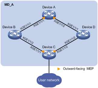

Configuring collaboration between Smart Link and Track
Smart Link collaborates with the CC function of CFD through track entries to implement link detection. Before configuring the collaboration between Smart Link and Track on a port, make sure the port has been added to the specified smart link group.
To configure collaboration between Smart Link and Track:
Step
Remarks
N/A
2.     Enter Layer 2 Ethernet interface view or Layer 2 aggregate interface view.
N/A
3.     Configure collaboration between Smart Link and Track on the port.
port smart-link group group-id track track-entry-number
By default, collaboration between Smart Link and Track is not configured.
The track entry specified in the command must be a track entry that has been associated with the CC function of CFD.

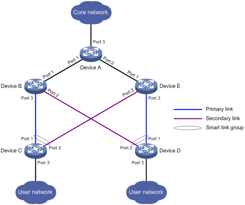

Single smart link group configuration example
Network requirements
As shown in Figure 2:
·     Device C and Device D are Smart Link devices. Device A, Device B, and Device E are associated devices. Traffic of VLANs 1 through 30 on Device C and Device D is dually uplinked to Device A.
·     Configure Smart Link on Device C and Device D for dual uplink backup.
Figure 2 Network diagram
Configuration procedure
1.     Configure Device C:
# Create VLANs 1 through 30.
<DeviceC> system-view
[DeviceC] vlan 1 to 30
# Map these VLANs to MSTI 1.
[DeviceC] stp region-configuration
[DeviceC-mst-region] instance 1 vlan 1 to 30
# Activate the MST region configuration.
[DeviceC-mst-region] active region-configuration
[DeviceC-mst-region] quit
# Shut down Ten-GigabitEthernet 1/1/1.
[DeviceC] interface ten-gigabitethernet 1/1/1
[DeviceC-Ten-GigabitEthernet1/1/1] shutdown
# Disable the spanning tree feature on the port.
[DeviceC-Ten-GigabitEthernet1/1/1] undo stp enable
# Configure the port as a trunk port.
[DeviceC-Ten-GigabitEthernet1/1/1] port link-type trunk
# Assign the port to VLANs 1 through 30.
[DeviceC-Ten-GigabitEthernet1/1/1] port trunk permit vlan 1 to 30
[DeviceC-Ten-GigabitEthernet1/1/1] quit
# Configure Ten-GigabitEthernet 1/1/2 in the same way Ten-GigabitEthernet 1/1/1 is configured.
[DeviceC] interface ten-gigabitethernet 1/1/2
[DeviceC-Ten-GigabitEthernet1/1/2] shutdown
[DeviceC-Ten-GigabitEthernet1/1/2] undo stp enable
[DeviceC-Ten-GigabitEthernet1/1/2] port link-type trunk
[DeviceC-Ten-GigabitEthernet1/1/2] port trunk permit vlan 1 to 30
[DeviceC-Ten-GigabitEthernet1/1/2] quit
# Create smart link group 1, and configure all VLANs mapped to MSTI 1 as the protected VLANs.
[DeviceC] smart-link group 1
[DeviceC-smlk-group1] protected-vlan reference-instance 1
# Configure Ten-GigabitEthernet 1/1/1 as the primary port and Ten-GigabitEthernet 1/1/2 as the secondary port for smart link group 1.
[DeviceC-smlk-group1] port ten-gigabitethernet1/1/1 primary
[DeviceC-smlk-group1] port ten-gigabitethernet1/1/2 secondary
# Enable flush message sending in smart link group 1, and configure VLAN 10 as the transmit control VLAN.
[DeviceC-smlk-group1] flush enable control-vlan 10
[DeviceC-smlk-group1] quit
# Bring up Ten-GigabitEthernet 1/1/1 and Ten-GigabitEthernet 1/1/2 again.
[DeviceC-Ten-GigabitEthernet1/1/1] undo shutdown
[DeviceC-Ten-GigabitEthernet1/1/2] undo shutdown
2.     Configure Device D:
<DeviceD> system-view
[DeviceD] vlan 1 to 30
[DeviceD] stp region-configuration
[DeviceD-mst-region] instance 1 vlan 1 to 30
[DeviceD-mst-region] active region-configuration
[DeviceD-mst-region] quit
[DeviceD] interface ten-gigabitethernet 1/1/1
[DeviceD-Ten-GigabitEthernet1/1/1] shutdown
[DeviceD-Ten-GigabitEthernet1/1/1] undo stp enable
[DeviceD-Ten-GigabitEthernet1/1/1] port link-type trunk
[DeviceD-Ten-GigabitEthernet1/1/1] port trunk permit vlan 1 to 30
[DeviceD-Ten-GigabitEthernet1/1/1] quit
[DeviceD] interface ten-gigabitethernet 1/1/2
[DeviceD-Ten-GigabitEthernet1/1/2] shutdown
[DeviceD-Ten-GigabitEthernet1/1/2] undo stp enable
[DeviceD-Ten-GigabitEthernet1/1/2] port link-type trunk
[DeviceD-Ten-GigabitEthernet1/1/2] port trunk permit vlan 1 to 30
[DeviceD-Ten-GigabitEthernet1/1/2] quit
[DeviceD] smart-link group 1
[DeviceD-smlk-group1] protected-vlan reference-instance 1
[DeviceD-smlk-group1] port ten-gigabitethernet1/1/1 primary
[DeviceD-smlk-group1] port ten-gigabitethernet1/1/2 secondary
# Enable flush message sending in smart link group 1, and configure VLAN 20 as the transmit control VLAN.
[DeviceD-smlk-group1] flush enable control-vlan 20
[DeviceD-smlk-group1] quit
[DeviceD-Ten-GigabitEthernet1/1/1] undo shutdown
[DeviceD-Ten-GigabitEthernet1/1/2] undo shutdown
3.     Configure Device B:
<DeviceB> system-view
[DeviceB] vlan 1 to 30
# Configure Ten-GigabitEthernet 1/1/1 as a trunk port.
[DeviceB] interface ten-gigabitethernet 1/1/1
[DeviceB-Ten-GigabitEthernet1/1/1] port link-type trunk
[DeviceB-Ten-GigabitEthernet1/1/1] port trunk permit vlan 1 to 30
# Enable flush message receiving and configure VLAN 10 and VLAN 20 as the receive control VLANs on the port.
[DeviceB-Ten-GigabitEthernet1/1/1] smart-link flush enable control-vlan 10 20
[DeviceB-Ten-GigabitEthernet1/1/1] quit
# Configure Ten-GigabitEthernet 1/1/2 as a trunk port.
[DeviceB] interface ten-gigabitethernet 1/1/2
[DeviceB-Ten-GigabitEthernet1/1/2] port link-type trunk
[DeviceB-Ten-GigabitEthernet1/1/2] port trunk permit vlan 1 to 30
[DeviceB-Ten-GigabitEthernet1/1/2] undo stp enable
# Enable flush message receiving and configure VLAN 20 as the receive control VLAN on the port.
[DeviceB-Ten-GigabitEthernet1/1/2] smart-link flush enable control-vlan 20
[DeviceB-Ten-GigabitEthernet1/1/2] quit
# Configure Ten-GigabitEthernet 1/1/3 as a trunk port.
[DeviceB] interface ten-gigabitethernet 1/1/3
[DeviceB-Ten-GigabitEthernet1/1/3] port link-type trunk
[DeviceB-Ten-GigabitEthernet1/1/3] port trunk permit vlan 1 to 30
[DeviceB-Ten-GigabitEthernet1/1/3] undo stp enable
# Enable flush message receiving and configure VLAN 10 as the receive control VLAN on the port.
[DeviceB-Ten-GigabitEthernet1/1/3] smart-link flush enable control-vlan 10
[DeviceB-Ten-GigabitEthernet1/1/3] quit
4.     Configure Device E:
<DeviceE> system-view
[DeviceE] vlan 1 to 30
[DeviceE] interface ten-gigabitethernet 1/1/1
[DeviceE-Ten-GigabitEthernet1/1/1] port link-type trunk
[DeviceE-Ten-GigabitEthernet1/1/1] port trunk permit vlan 1 to 30
[DeviceE-Ten-GigabitEthernet1/1/1] smart-link flush enable control-vlan 10 20
[DeviceE-Ten-GigabitEthernet1/1/1] quit
[DeviceE] interface ten-gigabitethernet 1/1/2
[DeviceE-Ten-GigabitEthernet1/1/2] port link-type trunk
[DeviceE-Ten-GigabitEthernet1/1/2] port trunk permit vlan 1 to 30
[DeviceE-Ten-GigabitEthernet1/1/2] undo stp enable
[DeviceE-Ten-GigabitEthernet1/1/2] smart-link flush enable control-vlan 10
[DeviceE-Ten-GigabitEthernet1/1/2] quit
[DeviceE] interface ten-gigabitethernet 1/1/3
[DeviceE-Ten-GigabitEthernet1/1/3] port link-type trunk
[DeviceE-Ten-GigabitEthernet1/1/3] port trunk permit vlan 1 to 30
[DeviceE-Ten-GigabitEthernet1/1/3] undo stp enable
[DeviceE-Ten-GigabitEthernet1/1/3] smart-link flush enable control-vlan 20
[DeviceE-Ten-GigabitEthernet1/1/3] quit
5.     Configure Device A:
<DeviceA> system-view
[DeviceA] vlan 1 to 30
[DeviceA] interface ten-gigabitethernet 1/1/1
[DeviceA-Ten-GigabitEthernet1/1/1] port link-type trunk
[DeviceA-Ten-GigabitEthernet1/1/1] port trunk permit vlan 1 to 30
[DeviceA-Ten-GigabitEthernet1/1/1] smart-link flush enable control-vlan 10 20
[DeviceA-Ten-GigabitEthernet1/1/1] quit
[DeviceA] interface ten-gigabitethernet 1/1/2
[DeviceA-Ten-GigabitEthernet1/1/2] port link-type trunk
[DeviceA-Ten-GigabitEthernet1/1/2] port trunk permit vlan 1 to 30
[DeviceA-Ten-GigabitEthernet1/1/2] smart-link flush enable control-vlan 10 20
[DeviceA-Ten-GigabitEthernet1/1/2] quit
# Display the smart link group configuration on Device C.
[DeviceC] display smart-link group 1
Smart link group 1 information:
  Device ID       : 000f-e23d-5af0
  Preemption mode : NONE
  Preemption delay: 1(s)
  Control VLAN    : 10
  Protected VLAN  : Reference Instance 1
  Member                  Role      State   Flush-count     Last-flush-time
  XGE1/1/1                PRIMARY   ACTIVE  5               16:45:20 2012/04/21
  XGE1/1/2                SECONDARY STANDBY 1               16:37:20 2012/04/21
# Display the flush messages received on Device B.
[DeviceB] display smart-link flush
 Received flush packets                             : 5
 Receiving interface of the last flush packet       : Ten-GigabitEthernet1/1/3
 Receiving time of the last flush packet            : 16:50:21 2012/04/21
 Device ID of the last flush packet                 : 000f-e23d-5af0
 Control VLAN of the last flush packet              : 10

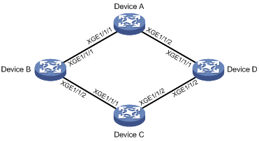

4.     Configure Device A:
# Create VLAN 1 through VLAN 200.
[DeviceA] vlan 1 to 200
# Assign the port to VLANs 1 through 200.
[DeviceA-Ten-GigabitEthernet1/1/1] port trunk permit vlan 1 to 200
# Enable flush message receiving and configure VLAN 10 and VLAN 110 as the receive control VLANs on the port.
[DeviceA-Ten-GigabitEthernet1/1/1] smart-link flush enable control-vlan 10 110
[DeviceA-Ten-GigabitEthernet1/1/2] port trunk permit vlan 1 to 200
[DeviceA-Ten-GigabitEthernet1/1/2] smart-link flush enable control-vlan 10 110
[DeviceC] display smart-link group all
  Preemption mode : ROLE
  Control VLAN    : 10
Smart link group 2 information:
  Control VLAN    : 110
  Protected VLAN  : Reference Instance 2
  XGE1/1/2                PRIMARY   ACTIVE  5               16:45:20 2012/04/21
  XGE1/1/1                SECONDARY STANDBY 1               16:37:20 2012/04/21
 Receiving interface of the last flush packet       : Ten-GigabitEthernet1/1/2
 Receiving time of the last flush packet            : 16:25:21 2012/04/21
Smart Link and Track collaboration configuration example
As shown in Figure 4:
·     Device A, Device B, Device C, and Device D form maintenance domain (MD) MD_A of level 5. Device C is a Smart Link device, and Device A, Device B, and Device D are associated devices. Traffic of VLANs 1 through 200 on Device C is dually uplinked to Device A by Device B and Device D.
·     Configure the collaboration between Smart Link the CC function of CFD through track entries to meet the following requirements:
¡     Traffic of VLANs 1 through 100 is uplinked to Device A by Device C through Ten-GigabitEthernet 1/1/1 (primary port of smart link group 1).
¡     Traffic of VLANs 101 through 200 is uplinked to Device A by Device C through Ten-GigabitEthernet 1/1/2 (primary port of smart link group 2).
¡     When the link between Device C and Device A fails, traffic is quickly switched to the secondary port of each smart link group. After the fault is cleared, traffic is switched back to the primary ports.
For more information about CFD, see "Configuring CFD."
Figure 4 Network diagram
1.     Configure Device A:
# Enable CFD and create MD MD_A of level 5.
[DeviceA] cfd enable
[DeviceA] cfd md MD_A level 5
# Create service instance 1 in which the MA name is based on the VLAN ID in MD_A and configure the MA to serve VLAN 10.
[DeviceA] cfd service-instance 1 ma-id vlan-based md MD_A vlan 10
# Create a MEP list in service instance 1, create outward-facing MEP 1002, and enable CCM sending in service instance 1 on Ten-GigabitEthernet 1/1/1.
[DeviceA] cfd meplist 1001 1002 service-instance 1
[DeviceA-Ten-GigabitEthernet1/1/1] cfd mep 1002 service-instance 1 outbound
[DeviceA-Ten-GigabitEthernet1/1/1] cfd cc service-instance 1 mep 1002 enable
# Create service instance 2 in which the MA name is based on the VLAN ID in MD_A and configure the MA to serve VLAN 110.
[DeviceA] cfd service-instance 2 ma-id vlan-based md MD_A vlan 110
# Create a MEP list in service instance 2, create outward-facing MEP 1002, and enable CCM sending in service instance 2 on Ten-GigabitEthernet 1/1/2.
[DeviceA] cfd meplist 2001 2002 service-instance 2
[DeviceA-Ten-GigabitEthernet1/1/2] cfd mep 2002 service-instance 2 outbound
[DeviceA-Ten-GigabitEthernet1/1/2] cfd cc service-instance 2 mep 2002 enable
2.     Configure Device B:
[DeviceB] vlan 1 to 200
[DeviceB-Ten-GigabitEthernet1/1/1] port trunk permit vlan 1 to 200
[DeviceB-Ten-GigabitEthernet1/1/1] smart-link flush enable control-vlan 10 110
[DeviceB-Ten-GigabitEthernet1/1/2] port trunk permit vlan 1 to 200
[DeviceB-Ten-GigabitEthernet1/1/2] smart-link flush enable control-vlan 10 110
3.     Configure Device C:
[DeviceC] vlan 1 to 200
# Map VLANs 1 through 100 to MSTI 1 and VLANs 101 through 200 to MSTI 2.
[DeviceC-mst-region] instance 1 vlan 1 to 100
[DeviceC-mst-region] instance 2 vlan 101 to 200
[DeviceC-Ten-GigabitEthernet1/1/1] port trunk permit vlan 1 to 200
[DeviceC-Ten-GigabitEthernet1/1/2] port trunk permit vlan 1 to 200
# Create smart link group 1, and configure all VLANs mapped to MSTI 1 as the protected VLANs for smart link group 1.
# Enable role preemption in smart link group 1, enable flush message sending, and configure VLAN 10 as the transmit control VLAN.
[DeviceC-smlk-group1] preemption mode role
# Create smart link group 2, and configure all VLANs mapped to MSTI 2 as the protected VLANs for smart link group 2.
[DeviceC] smart-link group 2
[DeviceC-smlk-group2] protected-vlan reference-instance 2
# Configure Ten-GigabitEthernet 1/1/1 as the secondary port and Ten-GigabitEthernet 1/1/2 as the primary port for smart link group 2.
[DeviceC-smlk-group2] port ten-gigabitethernet1/1/2 primary
[DeviceC-smlk-group2] port ten-gigabitethernet1/1/1 secondary
# Enable role preemption in smart link group 2, enable flush message sending, and configure VLAN 110 as the transmit control VLAN.
[DeviceC-smlk-group2] preemption mode role
[DeviceC-smlk-group2] flush enable control-vlan 110
[DeviceC-smlk-group2] quit
[DeviceC] cfd enable
[DeviceC] cfd md MD_A level 5
[DeviceC] cfd service-instance 1 ma-id vlan-based md MD_A vlan 10
# Create a MEP list in service instance 1. Create outward-facing MEP 1001, and enable CCM sending in service instance 1 on Ten-GigabitEthernet 1/1/1.
[DeviceC] cfd meplist 1001 1002 service-instance 1
[DeviceC-Ten-GigabitEthernet1/1/1] cfd mep 1001 service-instance 1 outbound
[DeviceC-Ten-GigabitEthernet1/1/1] cfd cc service-instance 1 mep 1001 enable
[DeviceC] cfd service-instance 2 ma-id vlan-based md MD_A vlan 110
# Create a MEP list in service instance 2. Create outward-facing MEP 2001. Enable CCM sending in service instance 2 on Ten-GigabitEthernet 1/1/2.
[DeviceC] cfd meplist 2001 2002 service-instance 2
[DeviceC-Ten-GigabitEthernet1/1/2] cfd mep 2001 service-instance 2 outbound
[DeviceC-Ten-GigabitEthernet1/1/2] cfd cc service-instance 2 mep 2001 enable
# Create track entry 1 that is associated with the CFD CC function of MEP 1001 in service instance 1.
[DeviceC] track 1 cfd cc service-instance 1 mep 1001
# Configure the collaboration between the primary port Ten-GigabitEthernet 1/1/1 of smart link group 1 and the CC function of CFD through track entry 1, and bring up the port.
[DeviceC-Ten-GigabitEthernet1/1/1] port smart-link group 1 track 1
[DeviceC] track 2 cfd cc service-instance 2 mep 2001
# Configure the collaboration between the primary port Ten-GigabitEthernet 1/1/2 of smart link group 2 and the CC function of CFD through track entry 2, and bring up the port.
[DeviceC-Ten-GigabitEthernet1/1/2] port smart-link group 2 track 2
4.     Configure Device D:
[DeviceD] vlan 1 to 200
[DeviceD-Ten-GigabitEthernet1/1/1] port trunk permit vlan 1 to 200
[DeviceD-Ten-GigabitEthernet1/1/1] smart-link flush enable control-vlan 10 110
[DeviceD-Ten-GigabitEthernet1/1/2] port trunk permit vlan 1 to 200
[DeviceD-Ten-GigabitEthernet1/1/2] smart-link flush enable control-vlan 10 110
# When the optical fiber between Device A and Device B fails, display the smart link group configuration on Device C.
  Control VLAN    : 10
  XGE1/1/1                PRIMARY   DOWN    5               16:45:20 2012/04/21
  XGE1/1/2                SECONDARY ACTIVE  1               16:37:20 2012/04/21
  Control VLAN    : 110
The output shows that the primary port Ten-GigabitEthernet 1/1/1 of smart link group 1 fails, and the secondary port Ten-GigabitEthernet 1/1/2 is in forwarding state.
