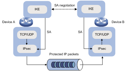

IPsec implementation
To implement IPsec protection for packets between two peers, complete the following tasks on each peer:
·     Configure an IPsec policy, which defines the range of packets to be protected by IPsec and the security parameters used for the protection.
·     Apply the IPsec policy to an interface or an application.
When you apply an IPsec policy to an interface, you implement IPsec based on the interface. Packets received and sent by the interface are protected according to the IPsec policy. When you apply an IPsec policy to an application, you implement IPsec based on the application. Packets of the application are protected according to the IPsec policy, regardless of the receiving and sending interface of the packets.
IPsec protects packets as follows:
·     When an IPsec peer identifies the packets to be protected according to the IPsec policy, it sets up an IPsec tunnel and sends the packet to the remote peer through the tunnel. The IPsec tunnel can be manually configured beforehand, or it can be set up through IKE negotiation triggered by the packet. The IPsec tunnels are actually the IPsec SAs. The inbound packets are protected by the inbound SA, and the outbound packets are protected by the outbound SA.
·     When the remote IPsec peer receives the packet, it drops, de-encapsulates, or directly forwards the packet according to the configured IPsec policy.
Interface-based IPsec supports setting up IPsec tunnels based on ACLs.

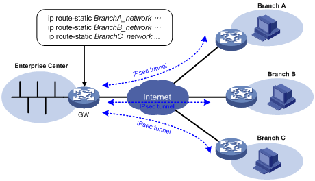

IPsec RRI
As shown in Figure 4, the traffic between the enterprise center and the branches are protected by IPsec. The gateway at the enterprise center is configured with static routes to route traffic to the IPsec-protected interfaces. It is difficult to add or modify static routes on the gateway at the enterprise center if the IPsec VPN has a large number of branches or if the network structure changes.
Figure 4 IPsec VPN
IPsec Reverse Route Injection (RRI) enables an IPsec tunnel gateway to automatically add static routes destined for protected private networks or static routes destined for peer IPsec tunnel gateways to a routing table. As shown in Figure 4, you can enable IPsec RRI on the gateway at the enterprise center. After an IPsec tunnel is established, the gateway automatically adds a static route to the routing table, which can be looked up. The destination IP address is the protected private network, and the next hop is the remote IP address of the IPsec tunnel. The traffic destined for the peer end is routed to the IPsec tunnel interface and thereby protected by IPsec.
You can advertise the static routes created by IPsec RRI in the internal network, and the internal network device can use them to forward traffic in the IPsec VPN.
In an MPLS L3VPN network, IPsec RRI can add static routes to VPN instances' routing tables.
IPsec RRI is applicable to gateways that must provide many IPsec tunnels (for example, a headquarters gateway).

Configuring IPsec RRI
Configuration guidelines
When you enable or disable IPsec RRI for an IPsec policy, the device deletes all IPsec SAs created by this IPsec policy, and the associated static routes.
If you change the preference value or tag value for an IPsec policy, the device deletes all IPsec SAs created by this IPsec policy, and the associated static routes. Your change takes effect for future IPsec RRI-created static routes.
You can set preferences for the static routes created by IPsec RRI to flexibly apply route management policies. For example, you can set the same preference for multiple routes to the same destination to implement load sharing, or you can set different preferences to implement route backup.
You can also set tags for the static routes created by IPsec RRI to implement flexible route control through routing policies.
IPsec RRI does not generate a static route to a destination address to be protected if the destination address is not defined in the ACL used by an IPsec policy or an IPsec policy template. You must manually configure a static route to the destination address.
Configuration procedure
To configure IPsec RRI:
Step
Remarks
N/A
2.     Enter IPsec policy view or IPsec policy template view.
·     To enter IPsec policy view:
ipsec { policy | ipv6-policy } policy-name seq-number  isakmp
·     To enter IPsec policy template view:
ipsec { policy-template | ipv6-policy-template } template-name seq-number
N/A
3.     Enable IPsec RRI.
reverse-route dynamic
By default, IPsec RRI is disabled.
IPsec RRI is supported in both tunnel mode and transport mode.
4.     (Optional.) Set the preference value for the static routes created by IPsec RRI.
reverse-route preference number
The default value is 60.
5.     (Optional.) Set the tag value for the static routes created by IPsec RRI.
reverse-route tag tag-value
The default value is 0.

Configuring a manual mode IPsec tunnel for IPv4 packets
Network requirements
As shown in Figure 5, establish an IPsec tunnel between Switch A and Switch B to protect the data flows in between. Configure the tunnel as follows:
·     Specify the encapsulation mode as tunnel, the security protocol as ESP, the encryption algorithm as 128-bit AES, and the authentication algorithm as HMAC-SHA1.
·     Manually set up IPsec SAs.
Figure 5 Network diagram

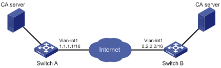

Configuring an IKE-based IPsec tunnel for IPv4 packets
As shown in Figure 6, establish an IPsec tunnel between Switch A and Switch B to protect the data flows in between. Configure the IPsec tunnel as follows:
·     Set up SAs through IKE negotiation.
Figure 6 Network diagram

Configuring an IKE-based IPsec tunnel for IPv6 packets
As shown in Figure 7, establish an IPsec tunnel between Switch A and Switch B to protect the data flows in between. Configure the IPsec tunnel as follows:
Figure 7 Network diagram

Built on a framework defined by ISAKMP, Internet Key Exchange (IKE) provides automatic key negotiation and SA establishment services for IPsec.
IKE provides the following benefits for IPsec:
·     Automatically negotiates IPsec parameters.
·     Performs DH exchanges to calculate shared keys, making sure each SA has a key that is independent of other keys.
·     Automatically negotiates SAs when the sequence number in the AH or ESP header overflows, making sure IPsec can provide the anti-replay service by using the sequence number.
As shown in Figure 9, IKE negotiates SAs for IPsec and transfers the SAs to IPsec, and IPsec uses the SAs to protect IP packets.

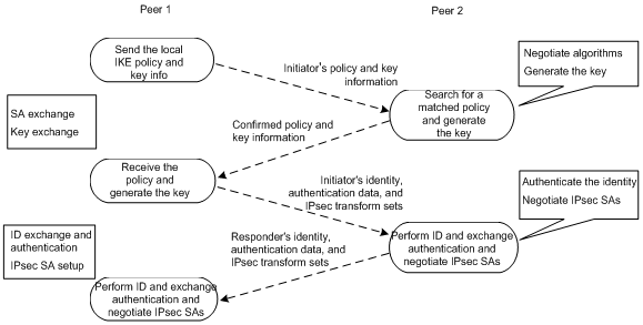

IKE negotiation process
IKE negotiates keys and SAs for IPsec in two phases:
1.     Phase 1—The two peers establish an IKE SA, a secure, authenticated channel for communication. In this phase, two modes are available: main mode and aggressive mode.
2.     Phase 2—Using the IKE SA established in phase 1, the two peers negotiate to establish IPsec SAs.
Figure 10 IKE exchange process in main mode
As shown in Figure 10, the main mode of IKE negotiation in phase 1 involves three pairs of messages:
·     SA exchange—Used for negotiating the IKE security policy.
·     Key exchange—Used for exchanging the DH public value and other values, such as the random number. The two peers use the exchanged data to generate key data and use the encryption key and authentication key to ensure the security of IP packets.
·     ID and authentication data exchange—Used for identity authentication.
The main difference between the main mode and the aggressive mode is that the aggressive mode does not provide identity information protection and exchanges only three messages, rather than three pairs. The main mode provides identity information protection but is slower.

Configuring an IKE profile
An IKE profile is intended to provide a set of parameters for IKE negotiation. To configure an IKE profile, you can do the following:
1.     Configure peer IDs. When an end needs to select an IKE profile, it compares the received peer ID with the peer IDs of its local IKE profiles. If a match is found, it uses the IKE profile with the matching peer ID for IKE negotiation.
2.     Configure the IKE keychain or PKI domain for the IKE proposals to use:
¡     To use digital signature authentication, configure a PKI domain.
¡     To use pre-shared key authentication, configure an IKE keychain.
3.     Specify the negotiation mode (main or aggressive) that the device uses as the initiator. When the device acts as the responder, it uses the IKE negotiation mode of the initiator.
4.     Specifies the IKE proposals that the device can use as the initiator. An IKE proposal specified earlier has a higher priority. When the device acts as the responder, it uses the IKE proposals configured in system view to match the IKE proposals received from the initiator. If a match is not found, the negotiation fails.
5.     Configure the local ID, the ID that the device uses to identify itself to the peer during IKE negotiation:
¡     For digital signature authentication, the device can use any type of ID. If the local ID is an IP address that is different from the IP address in the local certificate, the device uses the FQDN (the device name configured by using the sysname command) instead.
¡     For pre-shared key authentication, the device can use any type of ID other than the DN.
6.     Configure the IKE DPD feature to detect dead IKE peers. You can also configure this feature in system view. The IKE DPD settings configured in the IKE profile takes precedence over those configured in system view.
7.     Specify a local interface or IP address for the IKE profile so the profile can be applied only to the specified interface or IP address. For this task, specify the local address configured in IPsec policy or IPsec policy template view (using the local-address command). If no local address is configured, specify the IP address of the interface to which the IPsec policy is applied.
8.     Specify an inside VPN instance. This setting determines where the device should forward received IPsec protected data. If you specify an inside VPN instance, the device looks for a route in the specified VPN instance to forward the data. Otherwise, the device looks for a route in the VPN instance where the receiving interface resides and forwards the data to the VPN instance.
9.     Specify a priority number for the IKE profile. To determine the priority of an IKE profile:
a.     First, the device examines the existence of the match local address command. An IKE profile with the match local address command configured has a higher priority.
b.     If a tie exists, the device compares the priority numbers. An IKE profile with a smaller priority number has a higher priority.
c.     If a tie still exists, the device prefers an IKE profile configured earlier.
To configure an IKE profile:
Step
Remarks
N/A
2.     Create an IKE profile and enter its view.
ike profile profile-name
By default, no IKE profile is configured.
3.     Configure a peer ID.
match remote { certificate policy-name | identity { address { { ipv4-address [ mask | mask-length ] | range low-ipv4-address high-ipv4-address } | ipv6 { ipv6-address [ prefix-length ] | range low-ipv6-address high-ipv6-address } } [ vpn-instance vpn-name ] | fqdn fqdn-name | user-fqdn user-fqdn-name } }
By default, an IKE profile has no peer ID.
Each of the two peers must have at least one peer ID configured.
4.     Specify the keychain for pre-shared key authentication or the PKI domain used to request a certificate for digital signature authentication.
·     To specify the keychain for pre-shared key authentication:
keychain keychain-name
·     To specify the PKI domain used to request a certificate for digital signature authentication:
certificate domain domain-name
Configure at least one command as required.
By default, no IKE keychain or PKI domain is specified for an IKE profile.
5.     Specify the IKE negotiation mode for phase 1.
·     In non-FIPS mode:
exchange-mode { aggressive | main }
·     In FIPS mode:
exchange-mode main
By default, the main mode is used during IKE negotiation phase 1.
6.     Specify IKE proposals for the IKE profile.
proposal proposal-number&<1-6>
By default, no IKE proposals are specified for an IKE profile. The IKE proposals configured in system view are used for IKE negotiation.
7.     Configure the local ID.
local-identity { address { ipv4-address | ipv6 ipv6-address } | dn | fqdn [ fqdn-name ] | user-fqdn [ user-fqdn-name ] }
By default, no local ID is configured for an IKE profile, and an IKE profile uses the local ID configured in system view. If the local ID is not configured in system view, the IKE profile uses the IP address of the interface to which the IPsec policy or IPsec policy template is applied as the local ID.
8.      (Optional.) Configure IKE DPD.
dpd interval interval-seconds [ retry seconds ] { on-demand | periodic }
By default, the IKE DPD feature is not configured for an IKE profile and an IKE profile uses the DPD settings configured in system view. If the IKE DPD feature is not configured in system either, the device does not perform dead IKE peer detection.
9.      (Optional.) Specify the local interface or IP address to which the IKE profile can be applied.
match local address { interface-type interface-number | { ipv4-address | ipv6 ipv6-address } [ vpn-instance vpn-name ] }
By default, an IKE profile can be applied to any local interface or IP address.
10.     (Optional.) Specify an inside VPN instance.
inside-vpn vpn-instance vpn-name
By default, no inside VPN instance is specified for an IKE profile, and the device forwards protected data to the VPN instance where the interface receiving the data resides.
11.     (Optional.) Specify a priority for the IKE profile.
priority number
By default, the priority of an IKE profile is 100.
Configuring an IKE proposal
An IKE proposal defines a set of attributes describing how IKE negotiation in phase 1 should take place. You can create multiple IKE proposals with different priorities. The priority of an IKE proposal is represented by its sequence number. The lower the sequence number, the higher the priority.
Two peers must have at least one matching IKE proposal for successful IKE negotiation. During IKE negotiation:
·     The initiator sends its IKE proposals to the peer.
¡     If the initiator is using an IPsec policy with an IKE profile, the initiator sends all IKE proposals specified for the IKE profile to the peer. An IKE proposal specified earlier for the IKE profile has a higher priority.
¡     If the initiator is using an IPsec policy with no IKE profile, the initiator sends all its IKE proposals to the peer. An IKE proposal with a smaller number has a higher priority.
·     The peer searches its own IKE proposals for a match. The search starts from the IKE proposal with the highest priority and proceeds in descending order of priority until a match is found. The matching IKE proposals are used to establish the IKE SA. If all user-defined IKE proposals are found mismatching, the two peers use their default IKE proposals to establish the IKE SA.
Two matching IKE proposals have the same encryption algorithm, authentication method, authentication algorithm, and DH group. The SA lifetime takes the smaller one of the two proposals' SA lifetime settings.
As shown in Figure 12, configure an IKE-based IPsec tunnel between Switch A and Switch B to secure the communication in between.
Configure Switch A and Switch B to use aggressive mode for IKE negotiation phase 1 and use RSA signature authentication.
Figure 12 Network diagram

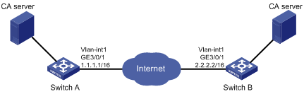

[SwitchB-acl-adv-3101] quit
# Create an IPsec transform set named tran1.
[SwitchB] ipsec transform-set tran1
# Set the packet encapsulation mode to tunnel.
[SwitchB-ipsec-transform-set-tran1] encapsulation-mode tunnel
# Use the ESP protocol for the IPsec transform set.
[SwitchB-ipsec-transform-set-tran1] protocol esp
# Specify the encryption and authentication algorithms.
[SwitchB-ipsec-transform-set-tran1] esp encryption-algorithm des-cbc
[SwitchB-ipsec-transform-set-tran1] esp authentication-algorithm sha1
[SwitchB-ipsec-transform-set-tran1] quit
# Create a PKI entity named entity2.
[SwitchB] pki entity entity2
# Set the common name as switchb for the PKI entity.
[SwitchB-pki-entity-entity2] common-name switchb
[SwitchB-pki-entity-entity1] quit
# Create a PKI domain named domain2.
[SwitchB] pki domain domain2
# Set the certificate request mode to auto and set the password to 123 for certificate revocation.
[SwitchB-pki-domain-domain2] certificate request mode auto password simple 123
# Set an MD5 fingerprint for verifying the validity of the CA root certificate.
[SwitchB-pki-domain-domain2] root-certificate fingerprint md5 50c7a2d282ea710a449eede6c56b102e
# Specify the trusted CA 8088.
[SwitchB-pki-domain-domain2] ca identifier 8088
# Specify the URL of the registration server for certificate request through the SCEP protocol. This example uses the URL of http://192.168.222.1:446/eadbf9af4f2c4641e685f7a6021e7b298373feb7.
[SwitchB-pki-domain-domain2] certificate request url http://192.168.222.1:446/eadbf9af4f2c4641e685f7a6021e7b298373feb7
# Specify the CA to accept certificate requests.
[SwitchB-pki-domain-domain2] certificate request from ca
# Specify the PKI entity for certificate request as entity2.
[SwitchB-pki-domain-domain2] certificate request entity entity2
# Specify the RSA key pair rsa1 with the general purpose for certificate request.
[SwitchB-pki-domain-domain2] public-key rsa general name rsa1
[SwitchB-pki-domain-domain2] quit
# Create an IKE profile named profile2.
[SwitchB] ike profile profile2
# Specify PKI domain domain2.
[SwitchB-ike-profile-profile2] certificate domain domain2
# Set the local identity to the FQDN name www.switchb.com.
[SwitchB-ike-profile-profile2] local-identity fqdn www.switchb.com
# Configure a peer ID with the identity type of FQDN name and the value of www.switcha.com.
[SwitchB-ike-profile-profile2] match remote identity fqdn www.switcha.com
[SwitchB-ike-profile-profile2] quit
# Create an IKE proposal named 10.
[SwitchB] ike proposal 10
# Specify the authentication algorithm as HMAC-MD5.
[SwitchB-ike-proposal-10] authentication-algorithm md5
# Specify the RSA authentication method.
[SwitchB-ike-proposal-10] authentication-method rsa-signature
[SwitchB-ike-proposal-10] quit
# Create an IPsec policy template with the name template1 and the sequence number 1.
[SwitchB] ipsec policy-template template1 1
# Specify IPsec transform set tran1 for the IPsec policy template.
[SwitchB-ipsec-policy-template-template1-1] transform-set tran1
# Specify IKE profile profile2 for the IPsec policy template.
[SwitchB-ipsec-policy-template-template1-1] ike-profile profile2
[SwitchB-ipsec-policy-template-template1-1] quit
# Create an IKE-based IPsec policy entry with the name use1 and the sequence number 1 by using the IPsec policy template template1.
[SwitchB] ipsec policy use1 1 isakmp template template1
# Apply IPsec policy use1 to VLAN-interface 1.
[SwitchB] interface vlan-interface 1
[SwitchB-Vlan-interface1] ipsec apply policy use1
# Specify a service module or an Ethernet interface module for forwarding the traffic on the interface.
[SwitchB-Vlan-interface1] service slot 3
[SwitchB-Vlan-interface1] quit
# Initiate a connection from Switch A to Switch B to trigger IKE negotiation. After IPsec SAs are successfully negotiated by IKE, traffic between the two switches is IPsec protected.

IKEv2 negotiation process
Compared with IKEv1, IKEv2 simplifies the negotiation process and is much more efficient.
IKEv2 defines three types of exchanges: initial exchanges, CREATE_CHILD_SA exchange, and INFORMATIONAL exchange.
As shown in Figure 13, IKEv2 uses two exchanges during the initial exchange process: IKE_SA_INIT and IKE_AUTH, each with two messages.
·     IKE_SA_INIT exchange—Negotiates IKE SA parameters and exchanges keys.
·     IKE_AUTH exchange—Authenticates the identity of the peer and establishes IPsec SAs.
After the four-message initial exchanges, IKEv2 sets up one IKE SA and one pair of IPsec SAs. For IKEv1 to set up one IKE SA and one pair of IPsec SAs, it must go through two phases that use a minimum of six messages.
To set up one more pair of IPsec SAs within the IKE SA, IKEv2 goes on to perform an additional two-message exchange—the CREATE_CHILD_SA exchange. One CREATE_CHILD_SA exchange creates one pair of IPsec SAs. IKEv2 also uses the CREATE_CHILD_SA exchange to rekey IKE SAs and Child SAs.
IKEv2 uses the INFORMATIONAL exchange to convey control messages about errors and notifications.

IKEv2 configuration examples
IKEv2 with pre-shared key authentication configuration example
As shown in Figure 14, configure an IKE-based IPsec tunnel between Switch A and Switch B to secure the communication between them.
·     Configure Switch A and Switch B to use the default IKEv2 proposal and the default IKEv2 policy in IKEv2 negotiation to set up IPsec SAs.
·     Configure the two switches to use the pre-shared key authentication method in IKEv2 negotiation.
Figure 14 Network diagram
Configuration procedures

# Initiate a connection between Switch A and Switch B to trigger IKEv2 negotiation. After IPsec SAs are successfully negotiated by IKEv2, traffic between the switches is IPsec protected.
IKEv2 with RSA signature authentication configuration example
As shown in Figure 15, configure an IKE-based IPsec tunnel between Switch A and Switch B to secure the communication between them.
Configure Switch A and Switch B to use IKEv2 negotiation and RSA signature authentication.
Figure 15 Network diagram
# Create an IKEv2 profile named profile2.
[SwitchB] ikev2 profile profile2
# Specify the local authentication method as RSA signatures.
[SwitchB-ikev2-profile-profile2] authentication-method local rsa-signature
# Specify the remote authentication method as RSA signatures.
[SwitchB-ikev2-profile-profile2] authentication-method remote rsa-signature
# Set the local identity to the FQDN name b.example.com.
[SwitchB-ikev2-profile-profile2] identity local fqdn b.example.com
# Specify the peer ID that the IKEv2 profile matches. The peer ID is the FQDN name www.switcha.com.
[SwitchB-ikev2-profile-profile2] match remote identity fqdn www.switcha.com
[SwitchB-ikev2-profile-profile2] quit
# Create an IKEv2 proposal named 10.
[SwitchB] ikev2 proposal 10
# Specify the integrity protection algorithm as HMAC-MD5.
[SwitchB-ikev2-proposal-10] integrity md5
# Specify the encryption algorithm as 3DES-CBC.
[SwitchB-ikev2-proposal-10] encryption 3des-cbc
# Specify the DH group as Group 1.
[SwitchB-ikev2-proposal-10] dh group1
# Specify the PRF algorithm as HMAC-MD5.
[SwitchB-ikev2-proposal-10] prf md5
[SwitchB-ikev2-proposal-10] quit
# Create an IKEv2 policy named 1.
[SwitchB] ikev2 policy 1
# Specify the IKEv2 proposal 10 for the IKEv2 policy.
[SwitchB-ikev2-policy-1] proposal 10
[SwitchB-ikev2-policy-1] quit
# Create an IPsec policy template entry with the name template1 and the sequence number 1.
# Specify the remote IP address 1.1.1.1 for the IPsec tunnel.
[SwitchB-ipsec-policy-template-template1-1] remote-address 1.1.1.1
# Specify ACL 3101 to identify the traffic to be protected.
[SwitchB-ipsec-policy-template-template1-1] security acl 3101
# Specify the IPsec transform set tran1 for the IPsec policy template.
# Specify the IKEv2 profile profile2 for the IPsec policy template.
[SwitchB-ipsec-policy-template-template1-1] ikev2-profile profile2
# Specify an Ethernet interface module or a service module for forwarding the traffic on the interface.
