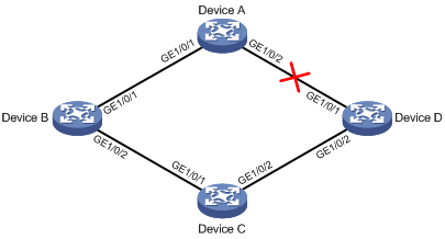

Monitor Link configuration example
Network requirements
As shown in Figure 2:
·     Device C is a Smart Link device, and Device A, Device B, and Device D are associated devices. Traffic of VLANs 1 through 30 on Device C is dual-uplinked to Device A through a smart link group.
·     Implement dual uplink backup on Device C. When the link between Device A and Device B (or Device D) fails, Device C can detect the link fault. It then performs uplink switchover in the smart link group.
For more information about Smart Link, see "Configuring Smart Link."
Figure 2 Network diagram
Configuration procedure

[DeviceD-mtlk-group1] port gigabitethernet 1/0/1 uplink
# Configure GigabitEthernet 1/0/2 as a downlink interface for monitor link group 1.
[DeviceD-mtlk-group1] port gigabitethernet 1/0/2 downlink
[DeviceD-mtlk-group1] quit
# When GigabitEthernet 1/0/2 on Device A goes down because of a link fault, verify information about monitor link group 1 on Device B.
[DeviceB] display monitor-link group 1
Monitor link group 1 information:
  Group status     : UP
  Downlink up-delay: 0(s)
  Last-up-time     : 16:38:26 2012/4/21
  Last-down-time   : 16:37:20 2012/4/21
  Up-port-threshold: 1
  Member                    Role       Status
  GE1/0/1                   UPLINK     UP
  GE1/0/2                   DOWNLINK   UP
# Verify information about monitor link group 1 on Device D.
[DeviceD] display monitor-link group 1
  Group status     : DOWN
  Last-up-time     : 16:37:20 2012/4/21
  Last-down-time   : 16:38:26 2012/4/21
  Member                    Role       Status
  GE1/0/1                   UPLINK     DOWN
  GE1/0/2                   DOWNLINK   DOWN
